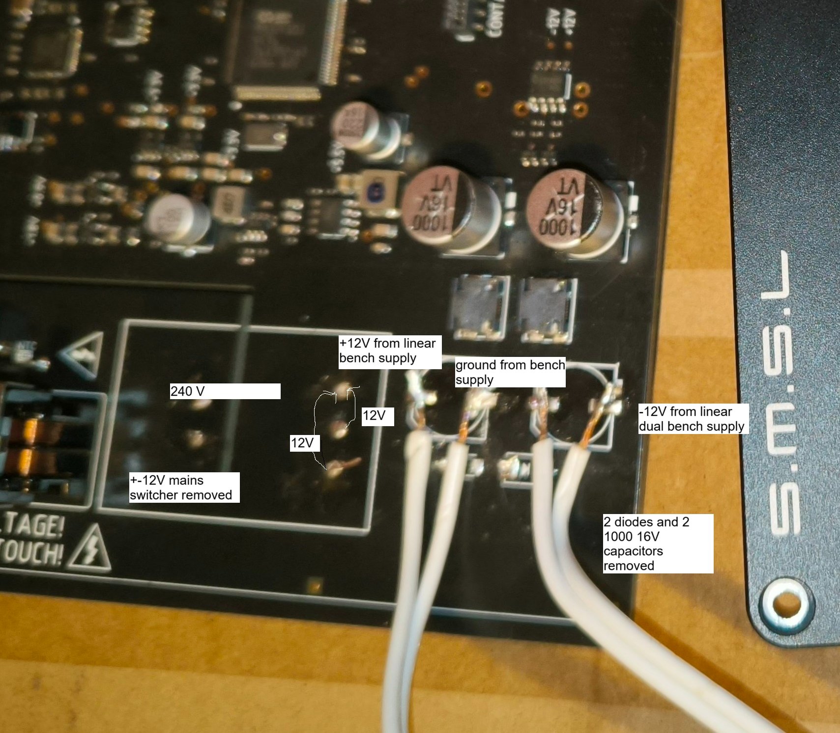

Have replaced the switcher supply in my SMSL DO300 with +=12V supply from a dual bench supply (have ordered a dual linear supply), think the switcher module was producing 2 x 12V supplies and then 2 diodes and 2 caps were used as an inverting charge pump circuit to produce the -12V.
This seems to be the same switcher and circuit used in a lot of the smsl models and wondered if this is the best way to connect the linear +-12 V supply.
It does make a nice improvement to the SQ, even just using a bench supply.

There exist a few versions of that +/- 12V switcher. You can connect a linear PSU like you did but I would make sure stuff is all switched on simultaneously. And the new PSU must of course be able to deliver the same power.
Edit: I see yours has a 230V AC to +/- 12V DC SMPS. The devices I know have a DC xV to +/- 12V DC switcher.
What is the typenumber of that SMPS? It probably delivers a symmetrical + and - 12V. You could have measured that. You still can if it is not thrown away. That is what DMMs are for. If that SMPS delivers +/- 12V you can solder in solder pins in the existing PCB pads and make stuff tidy.

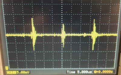

And what do you think about this spikes after good linear regulator at XMOS core supply ? This is caused by regulators reaction for frequently high current surges of cpu core ?
thanks, will ensure all switched on at same time.
no type no on SMPS, expected to get 24 V across pins if it was +-12 V. Instead say pin 3 was ground then pin 3 to pin 1 was 12V and pin 2 to pin 1 was 12 V, pin 2 to pin 3 had 0 V.
Pin 1 was connected to the +12 V rail.
Pin 3 was connected to the ground.
Pin 2 was connected to the charge pump circuit, was 0 V before the first diode and -12 V the other side of that diode with reference to ground.
thing is those charge pump circuits are known to be noisy so a bit cheeky for the smps to have Ultra Low Noise Power Supply text on it.
OK the very small DC-DC ones by SMSL are symmetrical. Their modus operandi is to create various voltages with several relatively unknown chinese switching ICs.
Once had an SMSL DAC that was new/unopened but it had the wrong adapter with it. To my surprise a message appeared in the display indicating “overvoltage”.
Reactions: sbgk

And what do you think about this spikes after good linear regulator at XMOS core supply ? This is caused by reaction of regulator for frequently high current surges of cpu core ?
There could be many reasons, including radiation to the oscilloscope probe.
Was this picture taken with a spring or a wire + crocodile clip on the ground?
Alex.
