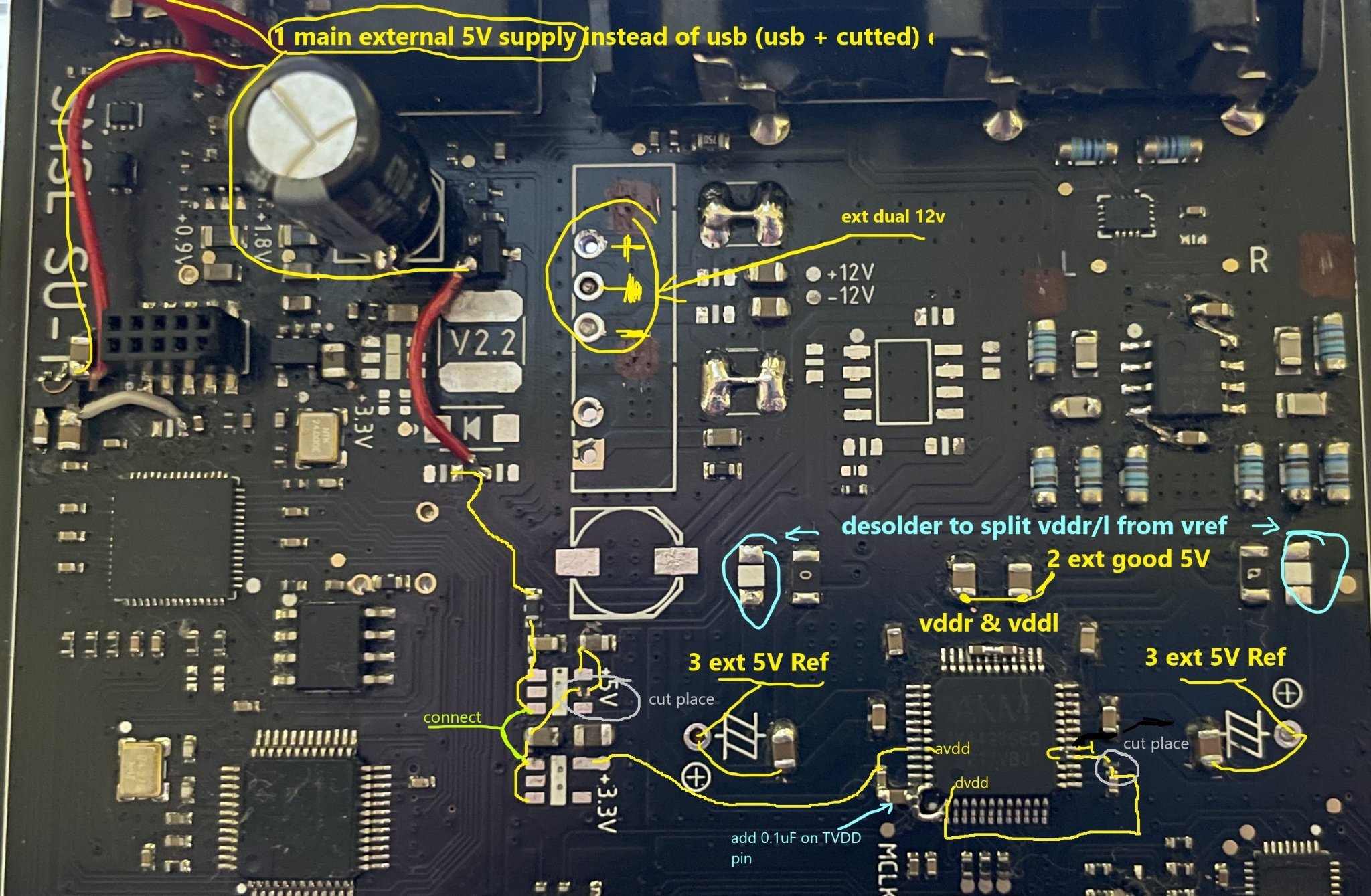

This info is appliable to owners of SU in external housing with a few independed power supplies, like an example of jean-paul device in start post.

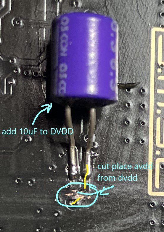

After some experiments with my DIY board on AK4493S I've found that disabling the internal LDO for digital rail dac supply also brings good improvements in sound.
In case of SU we will get an additional benefit in deviding AVDD and DVDD power supplies (analog and digital parts of DAC). Also in this way we came closer to manufacturer datasheet recommended circuit.
1. We have unnecessary 5.5V DC-DC step-up converter
2. We have unnecessary 5.0V LDO
3. To devide AVDD and DVDD we need to cut some places shown at photo between old 5V LDO and 3.3V LDO and also on the bottom side of board (always use multimeter and verify all what you see and all what you do).

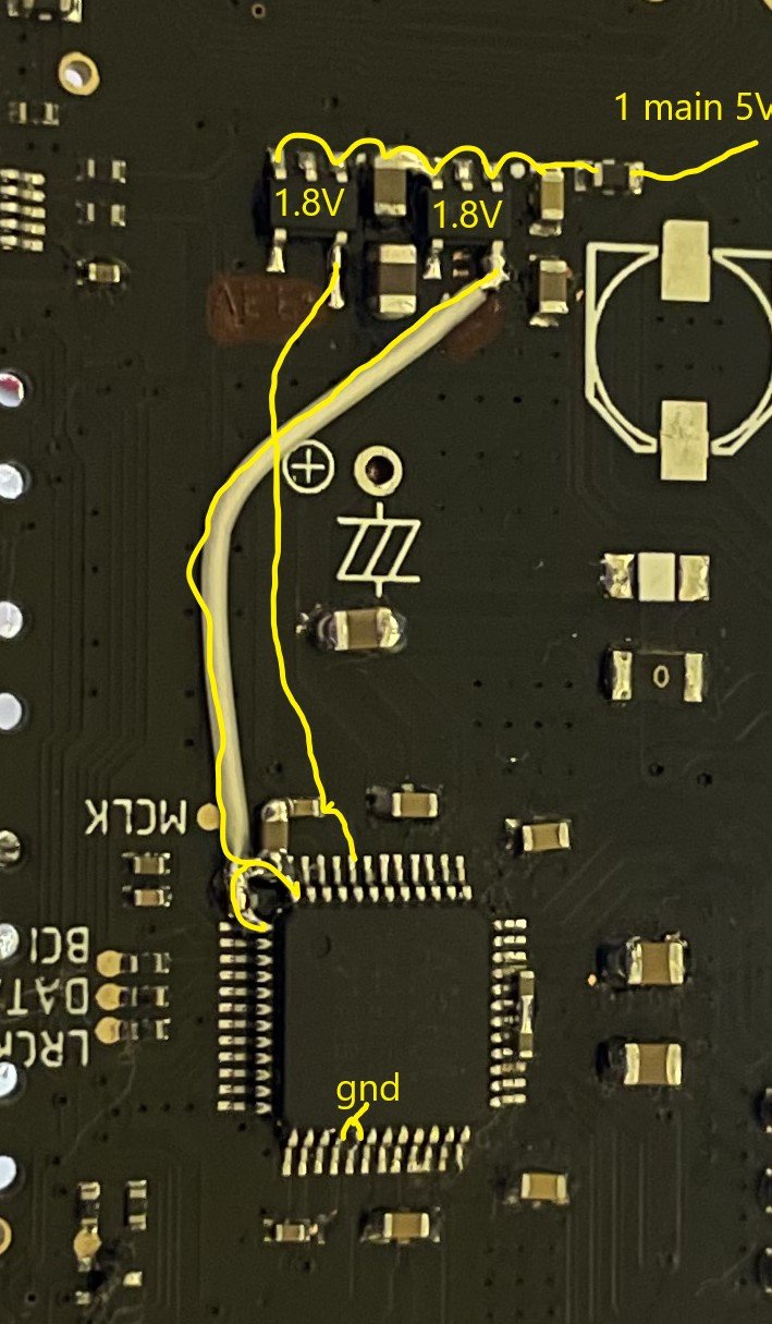

4. To disable internal LDO we need to put 2pcs 1.8V LDO's instead 3.3V and 5V and to cut 16 pin (LDOE) of DAC chip from DVDD and put it to GND, also connect together 1 and 48 pins (TVDD and DVDD). Both of 1.8V LDOs we need to connect 1 and 3 pins together with 5V main input.
Big capacitance not necessary on VREF only when using 2 individual very good LDOS for each side of vref. When we share one supply with both sides capacitance matters in some way.
Dont forget about individual supply for XMOS AVDD PLL

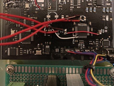

OK we know how it works, soon, as people implement the little board I hope reports will come in. Maybe someone has a good ADC and can record a snippet with and without the mod?
All my three devices with different XMOS chips are with switchers at core and PLL, and I get a good result with additional LDO for PLL supply on all of them. Lets wait for jean-paul mod and review. Unfortunately I don't have good ADC.
BTW I didn't invent the wheel, here at forum we can find information about it, but I hadn't read this before and came to this simply through experimentation
