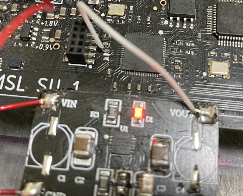

Hi ! Try to put 0.9-1V to PLL_AVDD pin with additional regulator. You should cut 0.9V from VDD. There is very low consumption, so you can take input for reg directly from 5V. You'll get sound x2.
It's very simple with small LT3042 board (don't forget to adjust voltage by correct resistor value). I've check it on XMOS U8, XMOS XU208 and here will be the same situation I think. All of them are need very clean analog power for PLL. You can take an oscilloscope and look at that clean power from DC-DC PWM converter at 0.9V.

OK so you say: don't do a filter but hook up a LT3042 and of course cut the previous PLL-AVdd supply?
Did you do this in your SU-1?

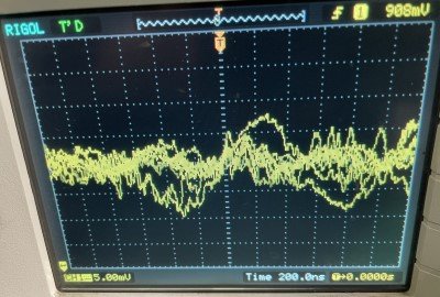

No, but I can, I have such one but don't use it. I did it on two another XMOS boards and it brings awesome result. XMOS in SU-1 has the same requirement according to datasheet. I'm not lazy today, so I make a photo of clean power at cap near PLL_AVDD pin at SU-1. Just try my advice upper and you will be surprised with your device.

Of course I will check when I have the time but for now I see a linear 0.9V regulator (and a 1.8V and 2 x 3.3V ones) on the PCB of SU-1.
You don't believe to oscillogram ?
Sorry, I cant really interpret your oscilloscope picture. The scales indicates mV and the screen is more or less half full so we see some traces indicating mV level disturbances on what I interpret is what is present between ground and PLL_AVDD when a LT3042 is connected - if so, its not very clean. Is this scope picture really with a LT 3042? It seem dirty. On a scope that should be a straight line if clean. But we would like to se uV and not really possible to measure with a simple scope in the first place...
How is it?
This is a picture of dc-dc converter supply at PLL_AVDD pin. Neighbor VDD pin is a supply of processor core

This is modification of XMOS. I don't need to prove something to someone, but you give me a very good advice at this forum, so I think I should share some good advice with you, so all is working as expected. (Main external power supply is linear 5V 7805 and vref/vddl/vddr are supplied by two LT3045). This is not personal my SU but my friends, so I've checked this XMOS tweak also for him, despite the fact that he doesn't need this device either

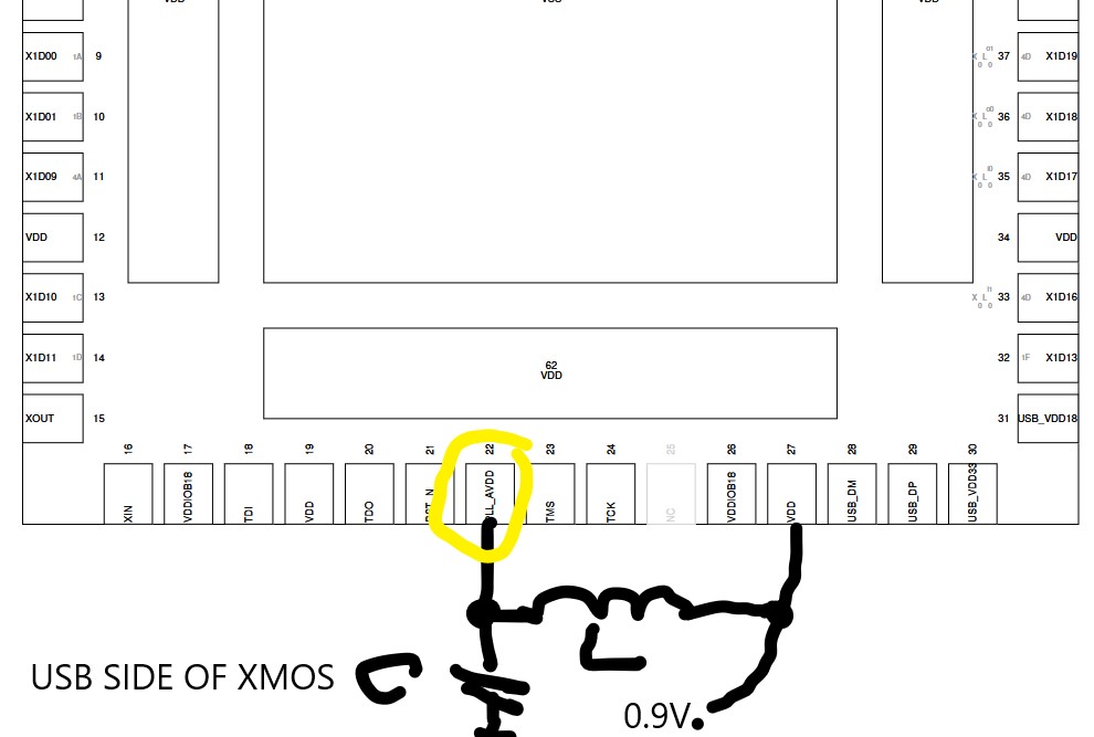

Ah that is not what you wrote earlier. Is that 0.9V regulators output really dirty? So it is a switcher putting out 0.9V just for the XMOS? Using and LC filter from pin 27 of the XMOS to pin 22? And how does the new board perform versus the old situation? What about using 2 linear regulators for both 0.9V supplies then?
If the connector block there also carries that needed 0.9V then a small PCB with extra regulator seems better than long wiring (can't be OK in such an environment). I can make such a small add on PCB even if it just would be for mounting and not electrical purposes.

Yes, oscillogramm at photo. And that LC filter is far not enough to make it clean ))
Yes.
More sound, cleaner, details, bigger soundstage, deeper soundstage and so on. CPU core doesn't need clean power supply, so that dc-dc is enough for it (also here is big consumption, so any linear regs will be very very hot on this so big voltage drop).

Anyway I think I will make a tiny plug in PCB for TPS7A2009PDBVR just to try out.

Don't waste your time with any coils, that rail is very dirty. Just desolder one coil and put 0.9-0.95V at 22pin (according to datasheet absolute max value is 1.05V but in my case it works great with 1.0V, with LT3042 it's very simple to find 10K resistor for 1V for it's adjustment)
