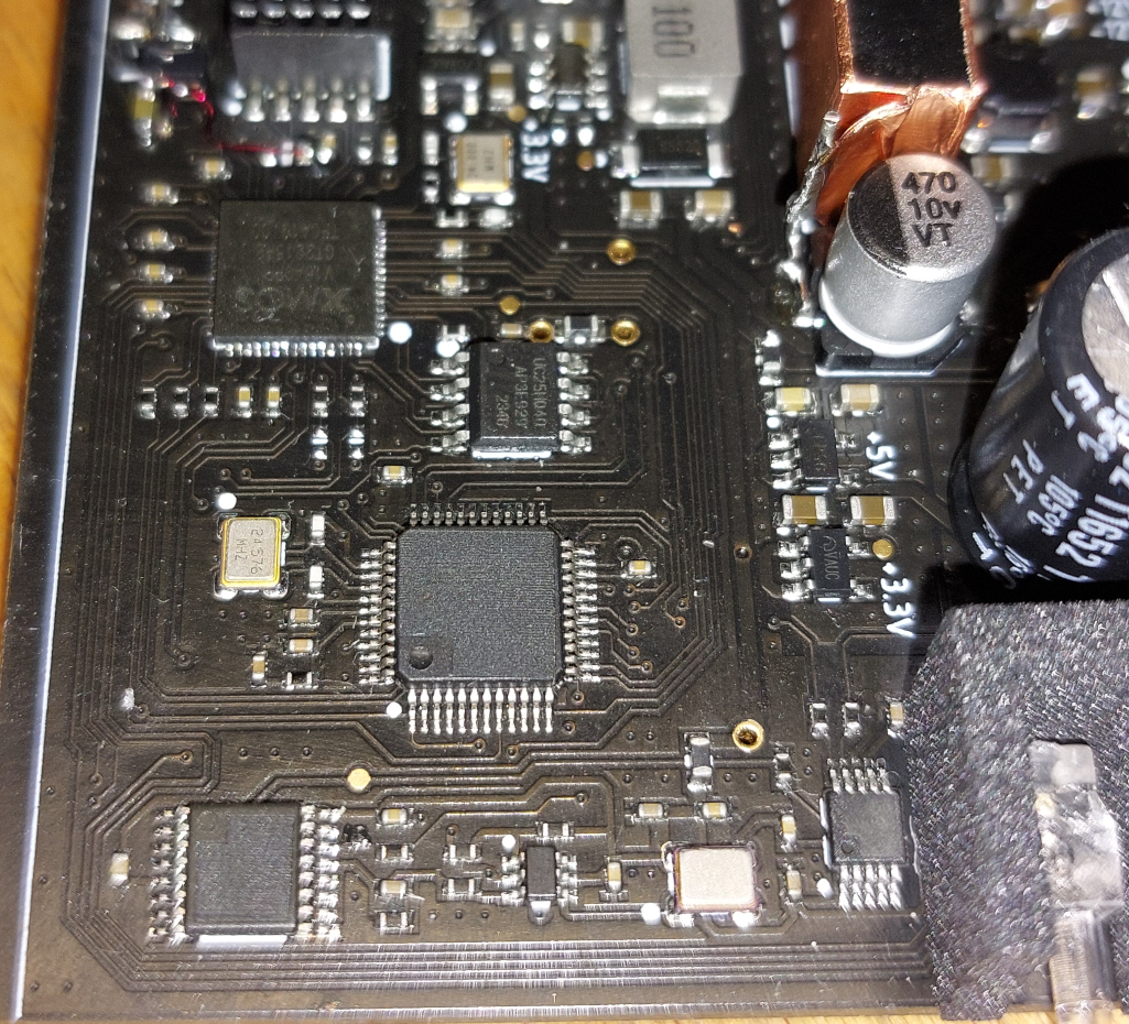

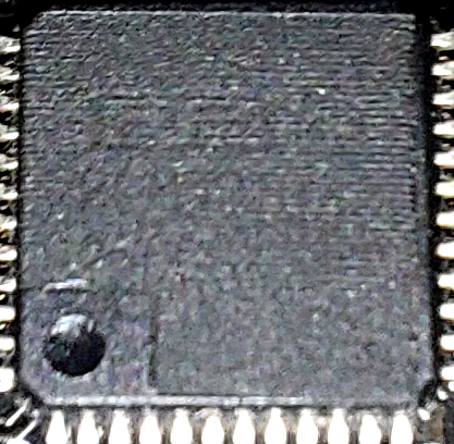

I may have overlooked the info here, but on my unit, I was able to identify a PCM9211 - hence there's only one sample rate crystal.
I don't have a macro lens, so on the photos only the "BB" logo is barely visible, but with magnifying glasses I could clearly read PCx921x. That leaves only the PCM9211.

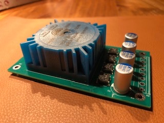

The new one is garbage too (imagine telling granddad that you made a PSU for a headphone amp with 50 mV ripple 🙂) but both will benefit from the onboard CLC filter. Easily bettered by literally anything low range linear though. I made a set of boards for such (SU-1) with a toroid and built it last week. It has 4 voltages from 4 separate windings but I did not implement it yet. Made a thinking error by not including regulators. It should have regulated 5..6V, and 3 x 3.3...5V. The idea was to have separate supplies for the relevant sections but I mixed up stuff with another project. Probably also because of other stuff coming inbetween. It happens.
