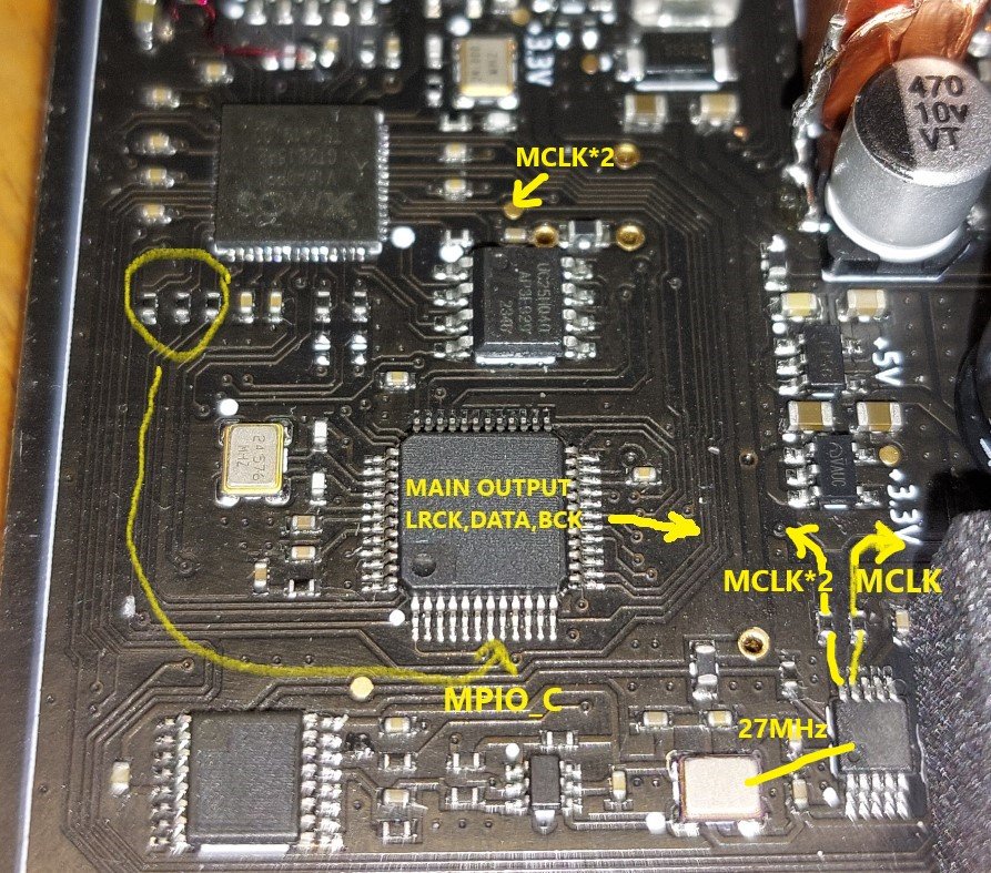

I found that the all data from XMOS goes to the input C of the transceiver, then goes to the DAC from the main output of the transceiver, and the DAC MCLK input is connected to an unknown IC in soic-10(?) case. This IC works on active 27Mhz crystal and makes master clock and also doubled MCLK for XMOS. By the way, the rest of crystals are passive, so the main improvement for USB users will be upgrade this 27Mhz and XMOS 24Mhz crystals. 24.576Mhz near transceiver is needed only for SPDIFMe too...
Maybe this is PLL-chip, providing audio clock frequencies (44.1x/48x) from 27MHz OSC.
I'm personally prefer to use 2 separate oscillators with audio frequencies.

Because this (about power supply and clock) belongs to all XMOS. Here you can listen (please don't flood that topic, I just show another XMOS owner device about processor clock affects and there are examples with attributions) how XMOS clock affects on sound (even with swapping XO with XO on another XMOS board). The effect with swapping XTAL with XO in SMSL is the same. And here is example how to make it. Don't do it if you don't understand what exactly you do in schematic at the board. XU316 accept 1.8V level at XI, so you need to make 1.8V low noise power supply for XO (I reccomend Kyocera K series). Don't put 1.8V from regulators near USB connector, it is noisy DC-DC switcher. Another way without adding 1.8V LDO is to change AKM supply voltages to 1.8V with disabling internal LDO, about it here and put it for XO from AKMs DVDD.
