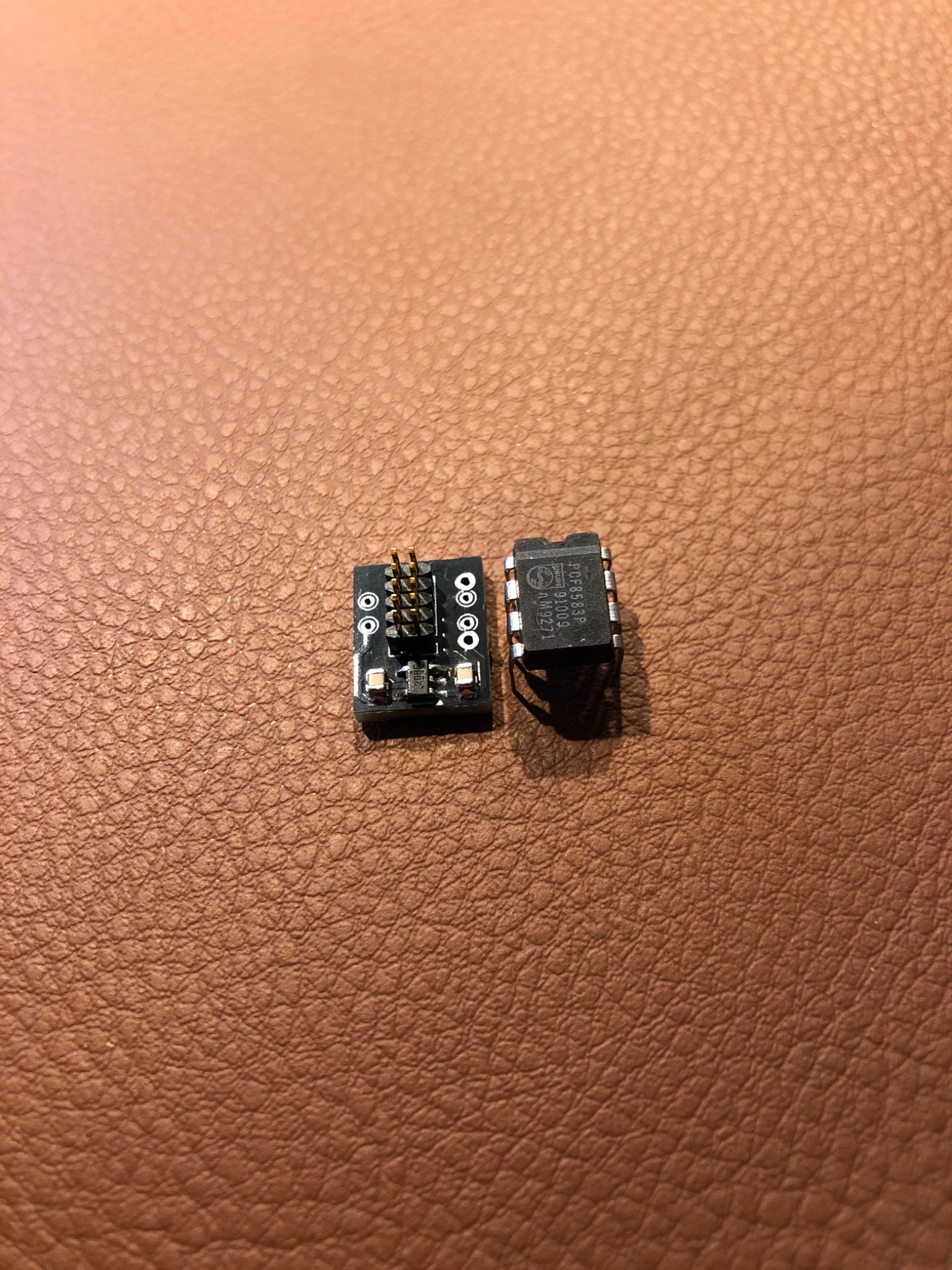

hi guys,
i am tempted to buy one of these su-1 and put a dip socket in place place of the opamp, Anyone knows what the other 8soic iC is next to the OP stage opamp?
by the way, one of the best reg i tested for audio devices, whatever they may be, is the lm317 with some additional current bias (around 300mA). Also putting a small around something like 20uH air inductor afterwards improves the sound even further.
the absolute best i tried is salas shunt but it's only good for 5V and above. I use the simplest circuit salas made for the shunt portion.... and for the ccs beforehand, i use the one with the bjt that sets the current with the reference Vbe voltage and the mosfet as pass transistor. This is subjective, but i tested a heap of them regulators. My favs. regs. may measure not best but sound the more like music to my ears.
if you mean this, it's op amp that makes two 5V voltage references for left and right AKM sideswhat the other 8soic iC is next to the OP stage opamp?
