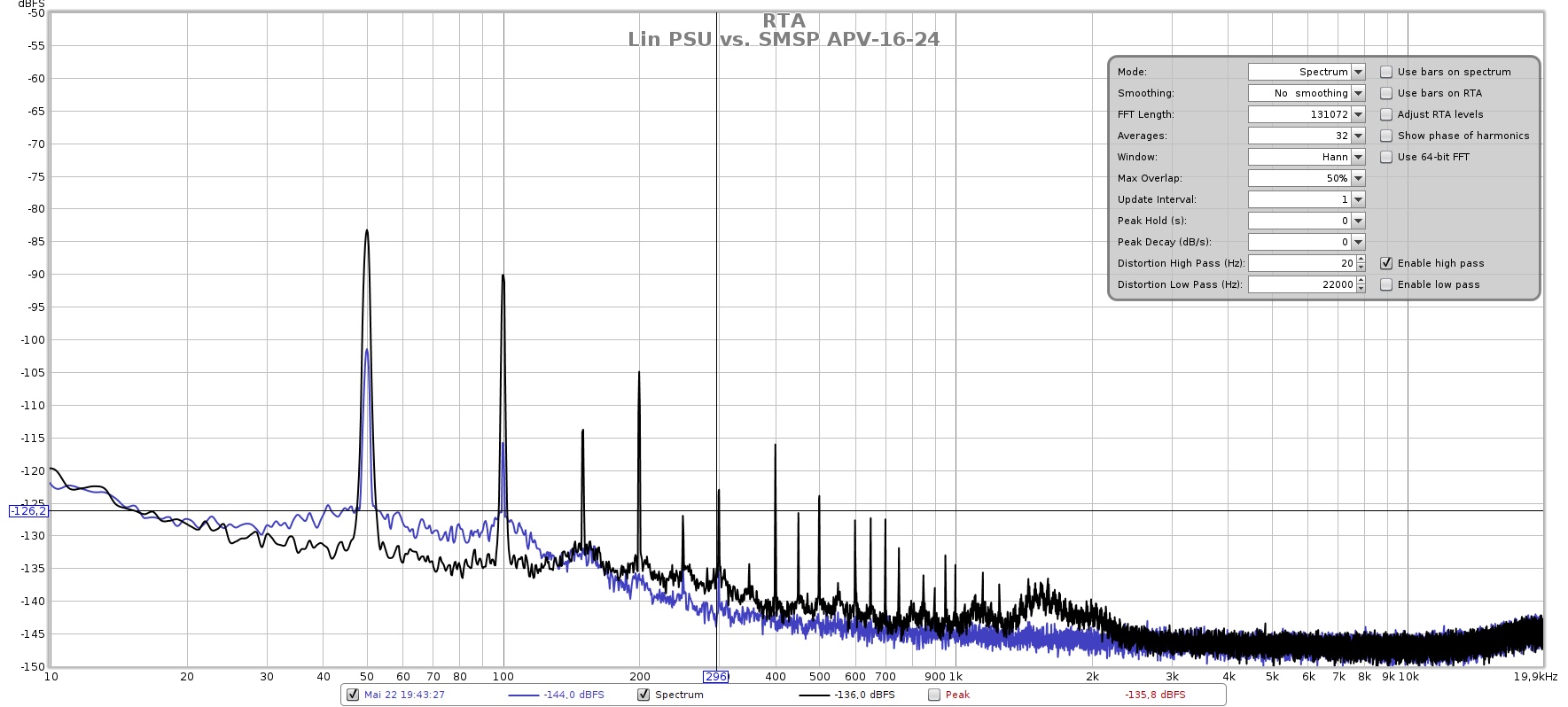

Thank you for bringing up this topic. I am also very interested in SMPS for power amps.
I made a first try with SMPS on my Pass XO24-6 but I am not fully convinced.
I had quite a bit of residual 50Hz hum and its harmonics. This was audible when close to the speaker.
The linear PSU which I put together from simple LM317 based regulator was much better. Interestingly for me: The lin PSU benefitted a lot from connecting the transformer shield winding to saftey ground.
Attached is a sound card measurement (on the XO-24-6 low pass output) which shows the LM317 supply compared to a Meanwell APV-18. Also tried Meanwell IRM-60 which was slightly better but still much worse than the lin PSU. Adding additional RC elements to the SMPS output were only slightly better.

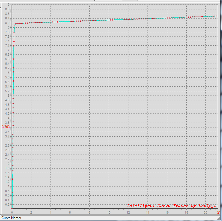

I've been experimenting with the idea of inserting a specially optimized Darlington capacitance multiplier, between the SMPS and an enormously large bank of electrolytic capacitors.
The voltage waveform at the input of the Darlington is filtered by a simple RC lowpass, so it's a rising exponential
The fourth row attempts to carve out a bit of safety margin, by assuming a higher than normal SMPS output voltage and a lower than normal SMPS "hiccup mode" threshold. The math says 0.2 sec, so be conservative and choose an R*C timeconstant significantly longer, such as 0.5 sec or even more.

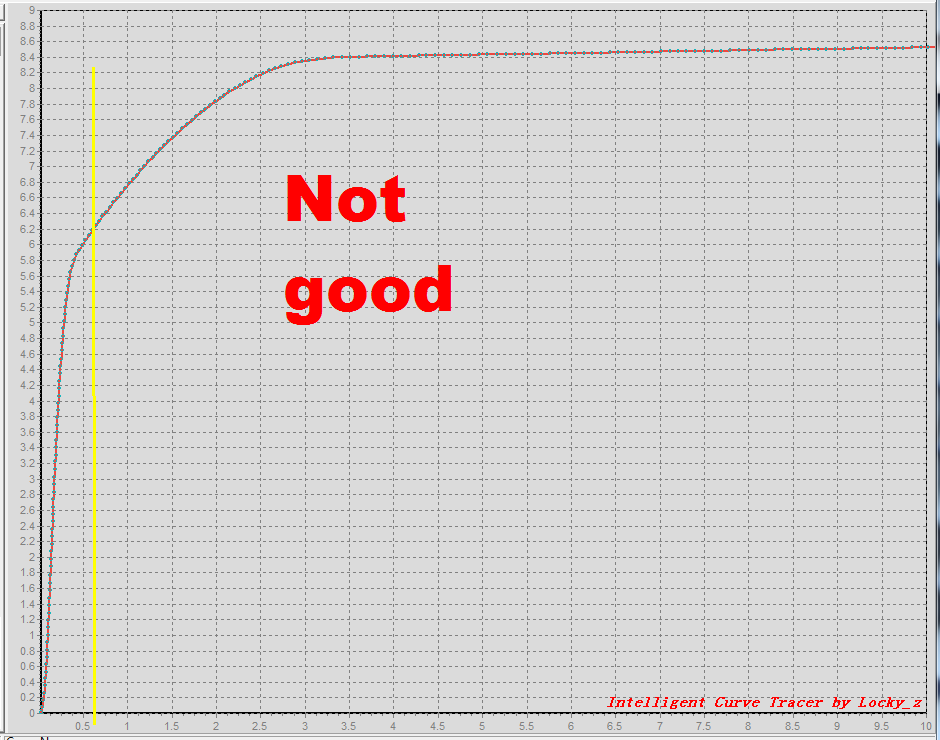

Clearly for such large timeconstants we'll need large values of Rbase . . . and that's why I'v chosen a Darlington arrangement -- Darlingtons need very little base current so they can operate with very large base resistors. Yes you lose two diode drops going thru a Darlington. And that's in the best case scenario, where the input transistor operates at a VCE of only 0.6V, while the output transistor operates at a VCE of only 1.2V. Plenty of transistors defecate the bedsheets at these low values of VCE, so measure them beforehand and choose wisely.
Here's what a good candidate looks like. VCE on the horizontal axis, ICE in milliamps on the vertical axis. Notice that it behaves nicely even below VCE=0.6 volts.
Finally, remember that at the instant of switch-on, the Darlington will have 36V across it while it conducts 4.2 amperes. That's an instantaneous power dissipation of 151 watts. It will be very important to study the SOA curves, and also to select a suitable heatsink!
