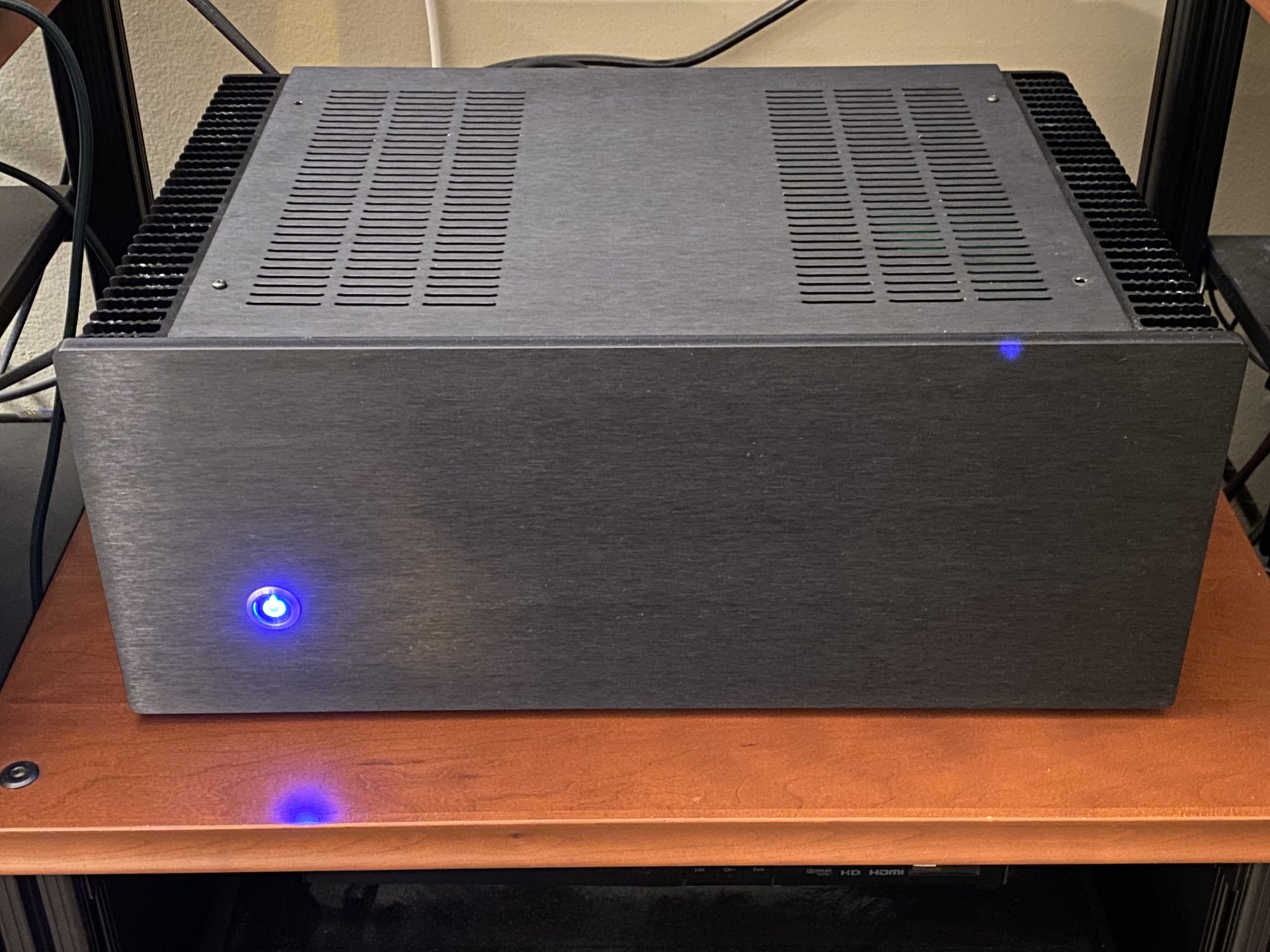

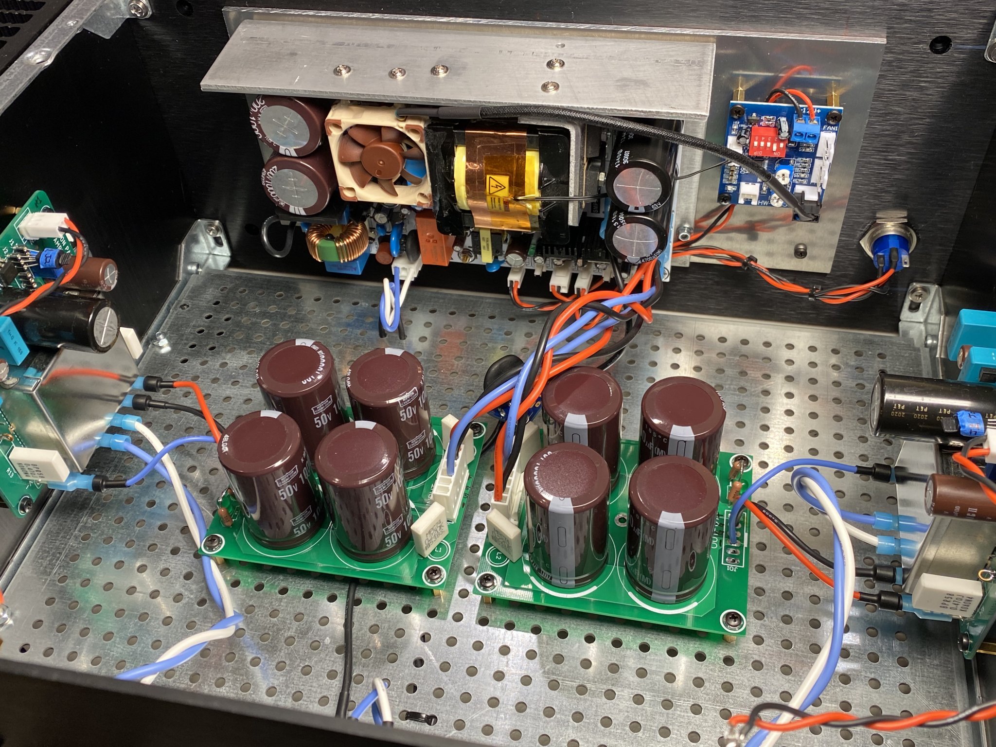

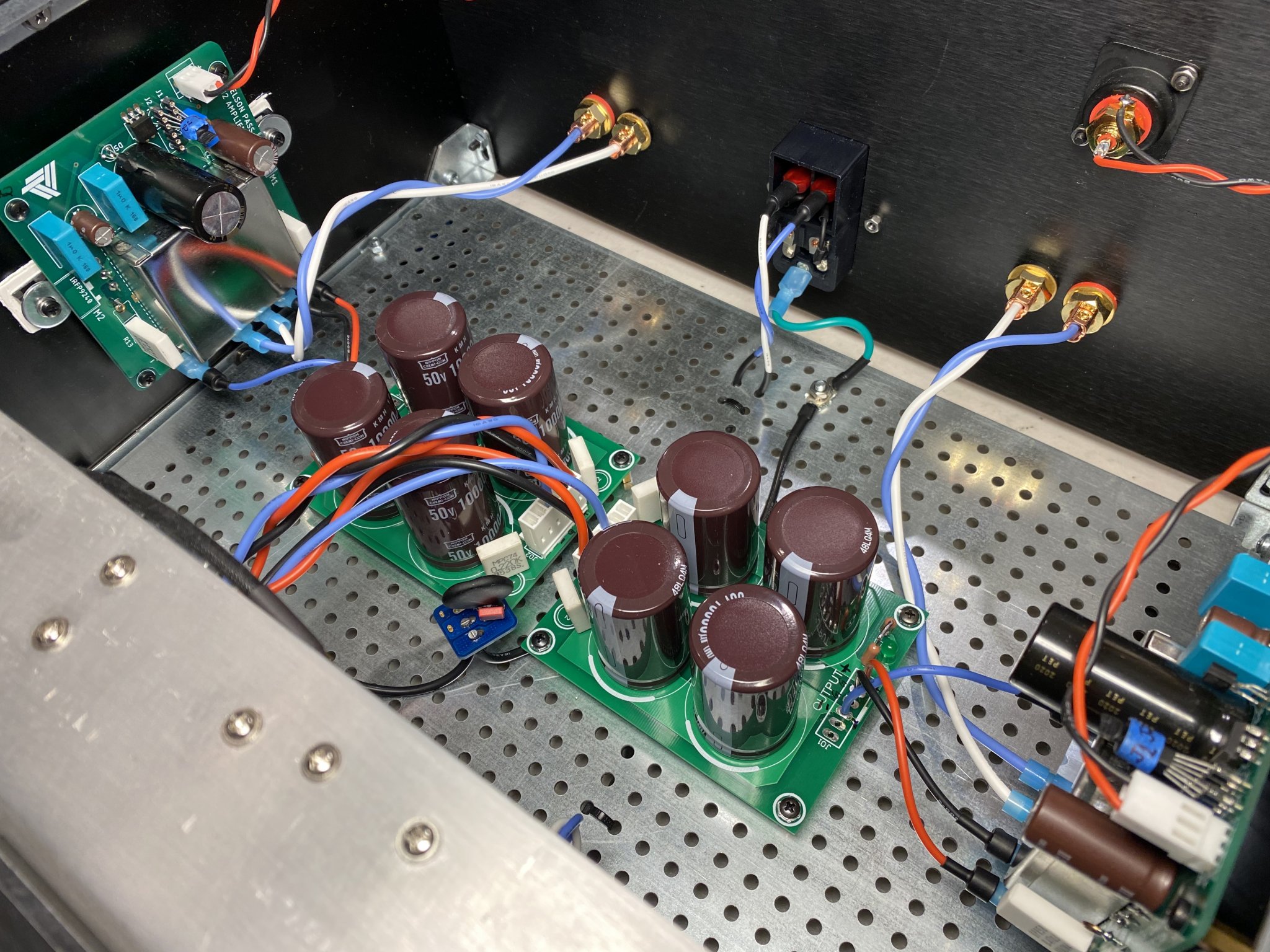

Its been a while, but wanted to add my SMPS powered Class A Pass M2 clone (Prasi pcb layout).
I’m using the same Micro-Audio SMPS500-CLA for power as Meanie. Each channel has it’s own 40,000uF cap bank, sort of a “poor man’s” dual mono psu setup.
I don’t have experience with any other type of M2 amplifier, but this set up is dead quiet, zero noise/hum from the speakers with my ear right up to the drivers. I couldn’t be happier with this combo. I’m closer to curing my fear of SMPS based power with builds like this.

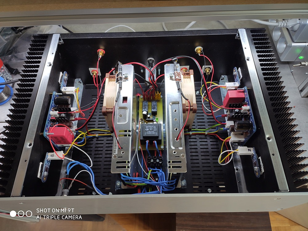

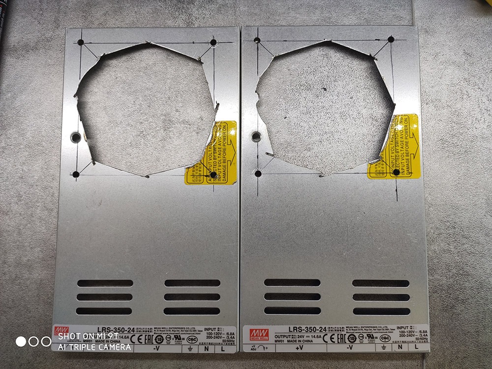

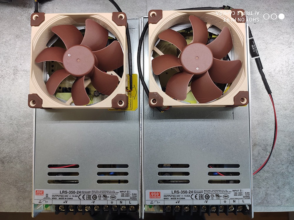

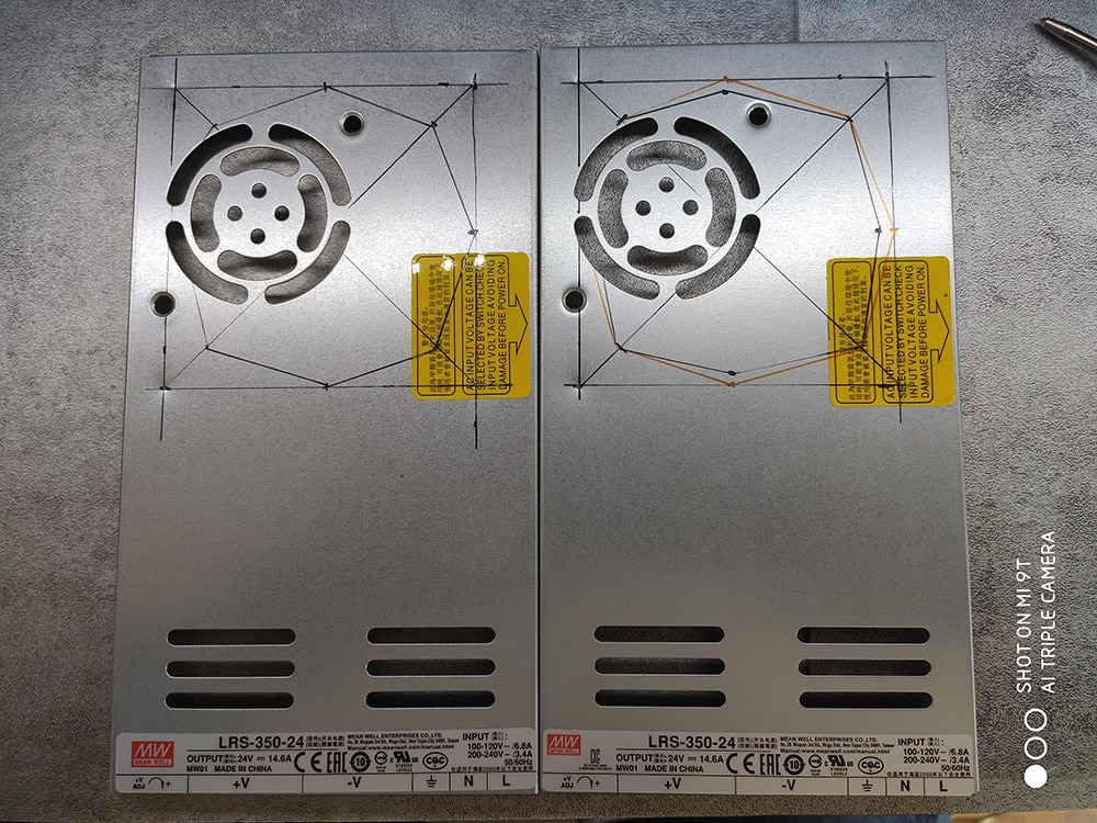

Jacques,My version of the Class A Alpha Nirvana uses two Meanwell SMPS.
The SMPS required a fan transplant with low noise Noctua's.
Works great, very quiet.
What are the part numbers of the Meanwell SMPS and Noctua fan you used.
Thanks,
brian
Hi Brian,
Noctua NF-A9 FLX 92mm
MEANWELL LRS-350-24 (trimmed to 27V)
The Noctua fans are powered directly from the same 12V pins as the original noisy fans.
The transplant required some heavy butchering
Jacques
Jacques
