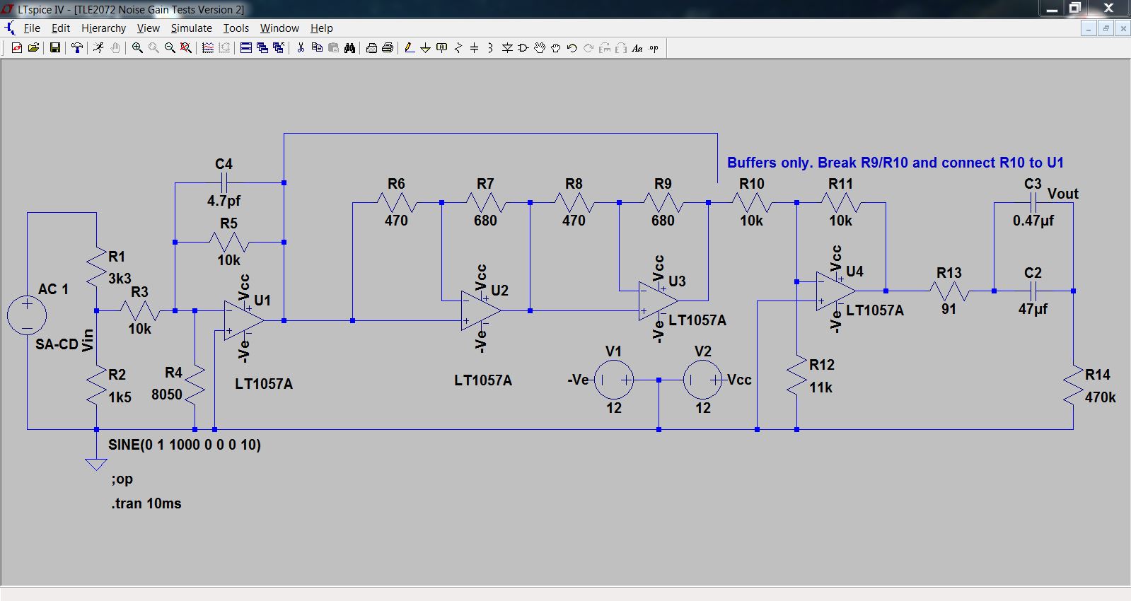

This is the circuit.
There are four opamps. Opamp type for this test was the TLE2072. The first and the last are the common buffers which were in place place for both tests. These were configured as inverting stages which have a reputation for performing better in certain circumstances. R4 and R12 are the two "unique" components which "throw away" a little of the open loop gain at the expense of increasing distortion and noise.
The two non inverting buffers use the same technique with R6 and R8 having the effect of "throwing away" some of the open loop gain. The connection between R9 and R10 was broken to allow either configuration to be tested.
This technique of increasing the noise gain is used by manufacturers to enable the distortion of opamps to be measured. Without this technique the distortion can be below measurable limits. The big question for audio is whether or not it has advantages for sonics. Some designers believe it does because it enables the opamp to have more stability, whereas even unity gain stable opamps used with 100% nfb are running right on the verge of instability.... and I'm trying to find out where the truth might be. And I have absolutely no idea what might be the sweet spot for doing this. There is huge possibility in the choice of resistor values that can be used.

Yes, aaa was the full path from left to right with all four stages in circuit as drawn. bbb was just U1 as the input buffer and U4 as the output buffer. For this the circuit was broken at the point where R9 and R10 join and the left hand side of R10 connected directly to U1 output.

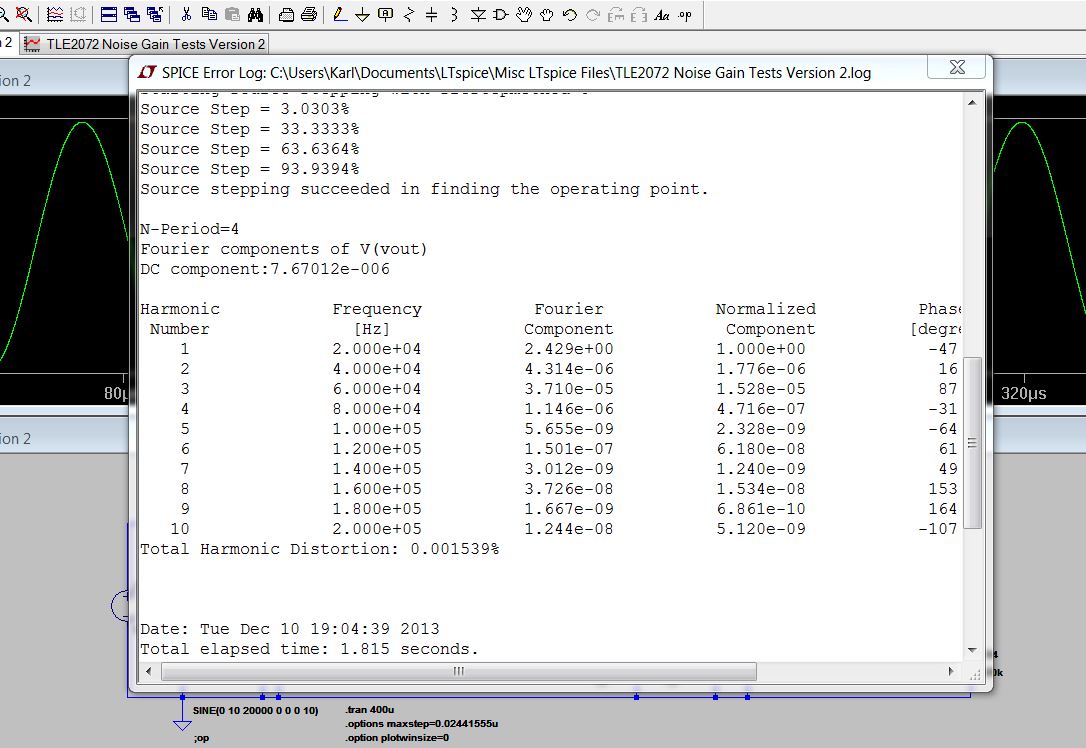

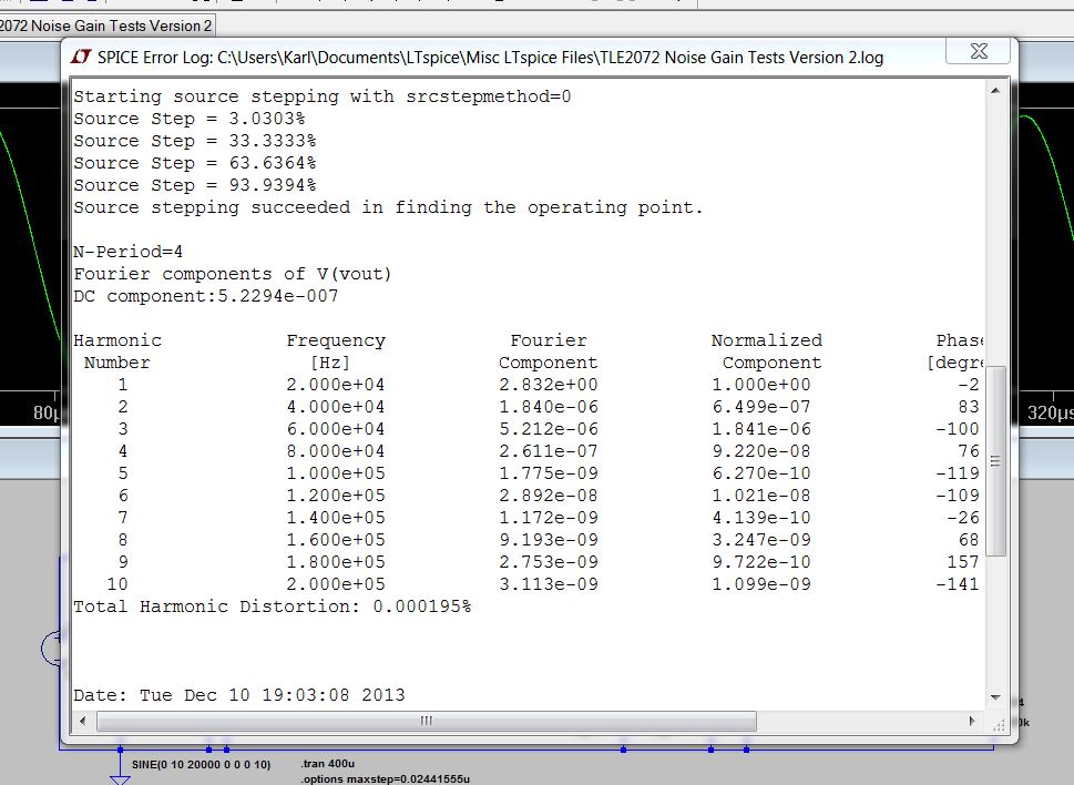

OK, here's what LTspice makes of the distortion for the whole chain and then with all the "noise gain" resistors decreased to 100 ohm. And this is at 20kHz and 2 volts RMS output. Trouble is, I don't believe it 🙂

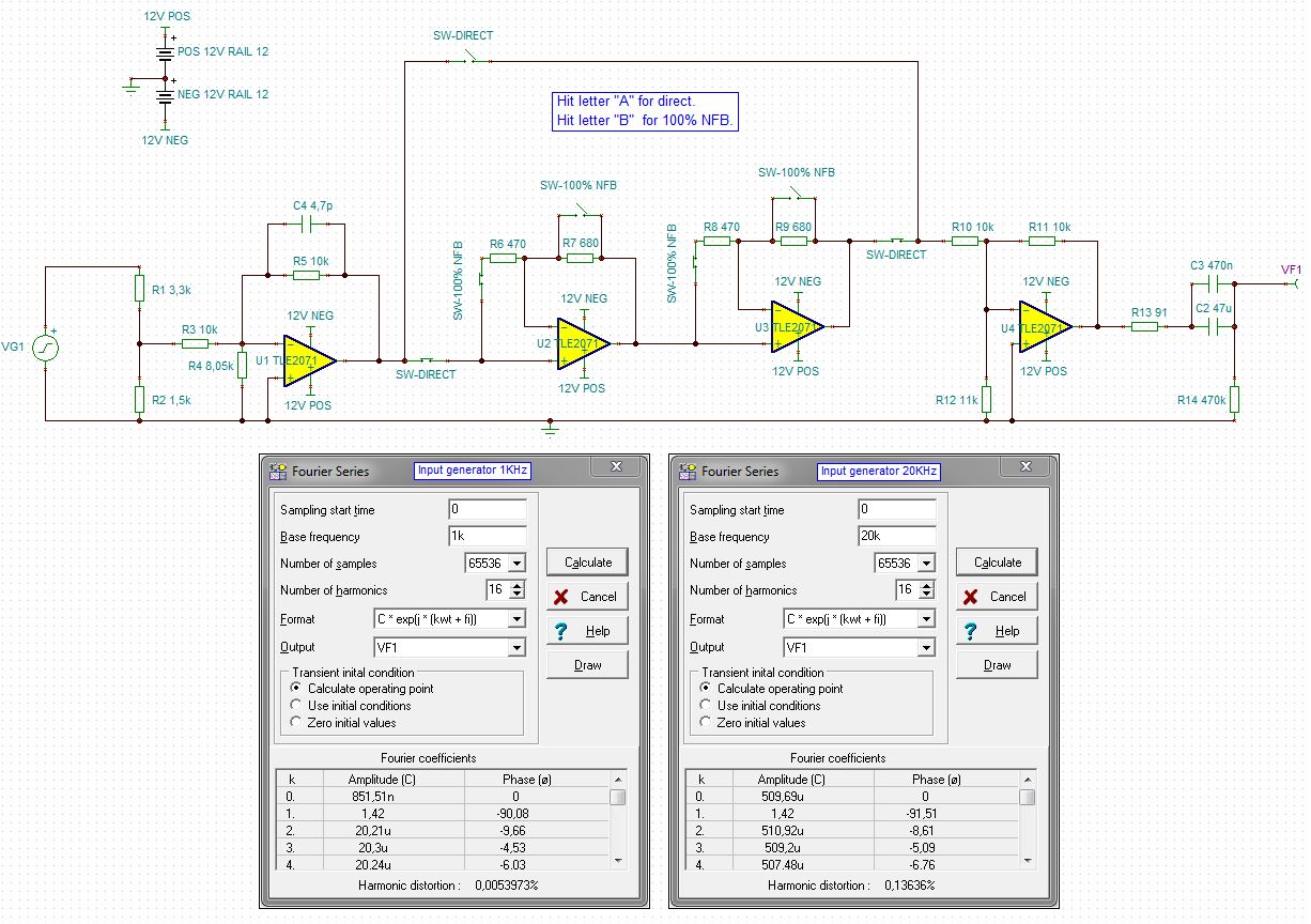

Nice specs you get, i try set your schematic up in freware "TINA" from Texas Instruments to compare with your simu and then get back.
To defend simu little, here some things to consider simu verse real world:
Standard source used in simu is 0R z out and pretty nicer than real world, unless you set up complicated nets for simu the real world source you have and also complicated net for the cable used.
Standard load is nothing or a nice resistor without cable and pretty nicer than real World, unless you set up complicated nets for simu the real world load you have and also complicated net for the cable used.
Layout in simu doesn't matter as in real world where clever thinking needed, unless you set up complicated nets for simu the real world layout.

Simulating behaviour of opamps in LTspice or any other software is useless, because the models aren't accurate, or detailed enough - GIGO. There are just a couple of models freely available which truly reflect what's inside the chip - discrete models, with every transistor included - but these are for obsolete devices. Do you think the makers of the latest and best opamps are going to give away all the 'magic' little details that make their chips work 'better', 🙂?
Using these precise models does show interesting behaviour - for example, PSR is not straightforward, easily predictable - changing gain alters the characteristics quite strongly.
Jay, hat off for your FET prediction.

I build many amps and I can here differences. So what I need is any variable within LTSpice simulation that has correlation with what I hear. Such THD log shown here has no correlation.
There is correlation tho, in the FFT plot drawn with certain parameters (han windowing, sample size, etc). Even by plotting simultaneously several input of close amplitudes (where you can see the "linearity" of distortion).
From my limited experience listening to opamps and correlating them with FFT, the correlation was "perfect". That's why I was curious to see the pomegranate in LTSpice (but my computer is broken right now) to see what I have heard.

Mooly here is distortion simu from program TINA with schematic as post #82, 7,07V RMS input 1KHz and 20KHz, output no load 2V RMS.
I rarely work with preamp circuits. But I don't understand why Mooly chose such a high load impedance (470kHz)? Imagine if the preamp has to drive 3 VSSA amps in parallel (for multi amping)!
Okay, it's the buffer. But may be difficult load matters?
