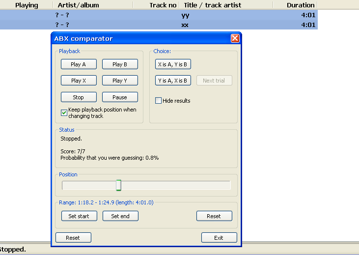

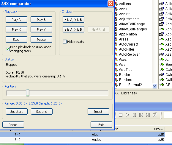

Mooly gave me 2 files of XX and YY, which were equivalence of ALPS and ANDES, and I said to Mooly that if I ABX them through my transparent speakers I believe I can get perfect result (when we talk about statistics, perfect means zero mistake), because they are so obviously different. XX/ALPS is sooo much better in hi-fi terms (except in fatigue I found that XX/ALPS is slightly fatiguing, but nobody here I believe can "feel" the fatigue component).
When I tried the ABX, I found out that my speakers are sooo transparent (actually I'm proud of my speakers. A result of breaking that barrier between those speaker builders who have no idea and those who can see it all 😀 ).
Differentiating through Foobar ABX (with $2 headphone that I had to "hijack" from somebody) is many many times more difficult. But surprisingly, I still can guarantee that I can do zero mistake here. But it takes a lot of effort, so I stop at 10/10 (0.1% probability of guessing). But if you want to pay me for doing 100/100 I will do it 😀
Now, please tell me what you have learned, and how you would like to build your conclusion from this.
Thanks Jay. Your listening impressions and ABX results are useful information 🙂 (and that is an impressive result)

The xx and yy files (I thought at first that was what your ABX result showed 😀) were just sent to a small handful of listeners... and I know your impressions of those from your pm's 🙂

Oh yeah, I choose ALPS/ANDES (instead of XX/YY) to ABX because everybody else have tried this and only PMA can get 5/6, which is not good at all if you understand statistics. I have suggested 8/8. If I "can" do 100/100 with this file, why 8/8 is so hard for everybody else?

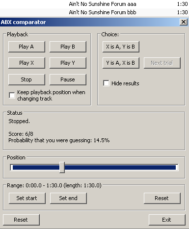

This is something a little bit different and is an attempt to take variables out of the chain. I'm accutely aware that feeding the A/D convertor via a resistive divider as the direct path and via the circuitry under test is not the same thing.
I have prepared two files for the forum. The signal path is SA-CD into a buffer of my choosing. The output of this buffer then feeds the circuit under test. The output of the circuit under test then feeds into another buffer of my choosing and into the A/D convertor.
So what we have is a chain of constant and known input characteristics and also constant and known output characteristics. The device or circuit under test slots into that chain preserving the known input/output specifications. This means that the SA-CD player and the A/D convertor see the same circuit in all test conditions.
Hope that makes sense.
ABX on this one would be much welcomed.
Ain't No Sunshine aaa
Ain't No Sunshine bbb
