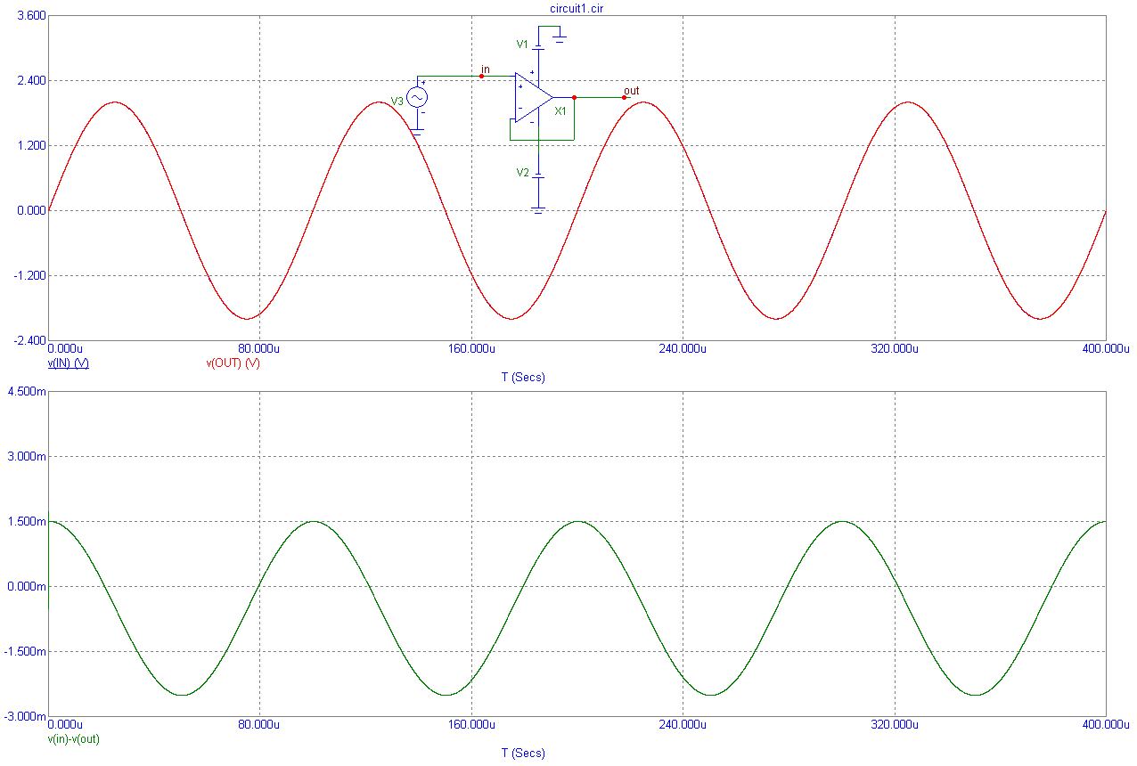

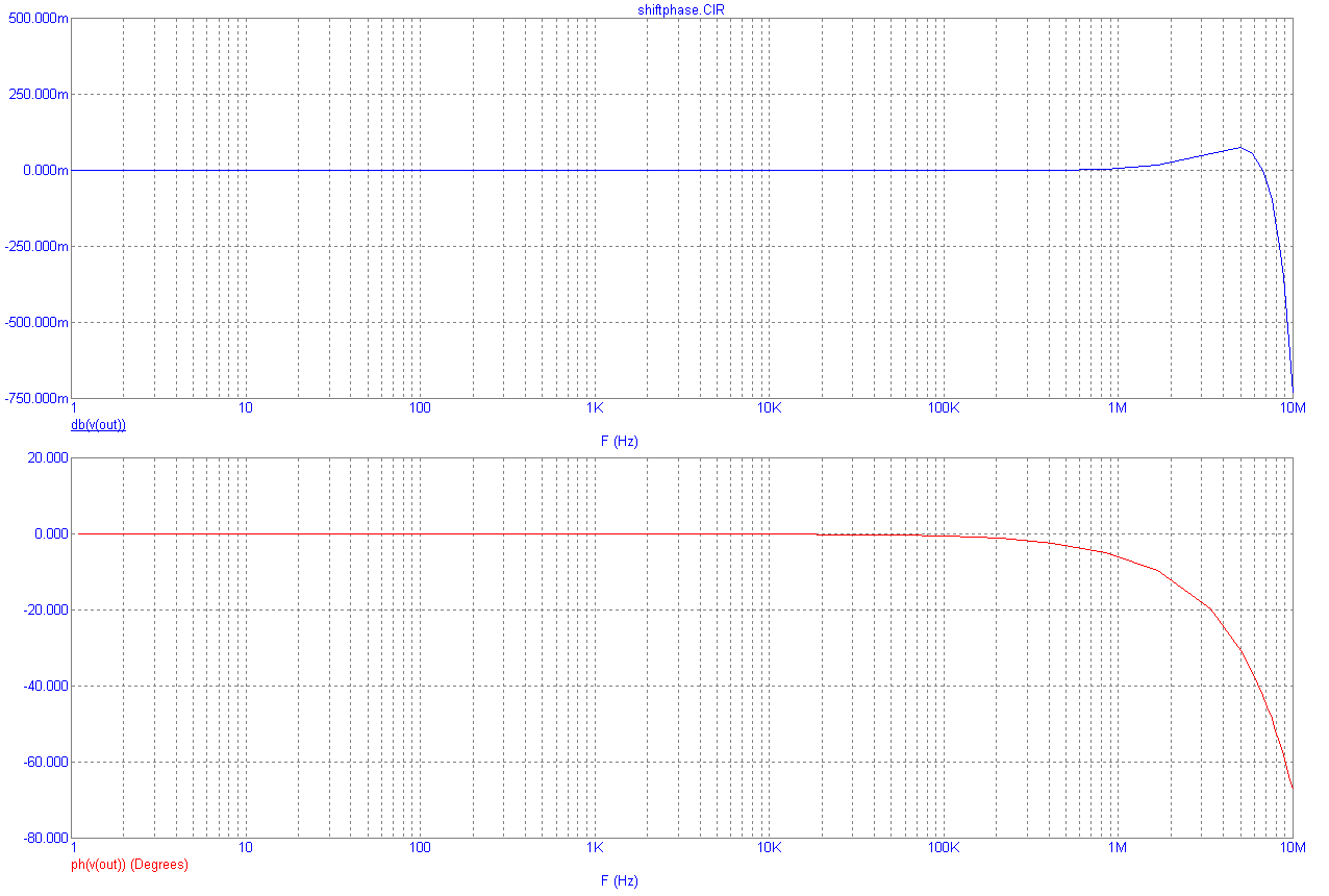

But please let me show you that the case might not be that straightforward. Even in case of 'visually' low phase shift the difference signal is not negligible and will be easily visible in logarithmic dB scale (FFT). Image attached.

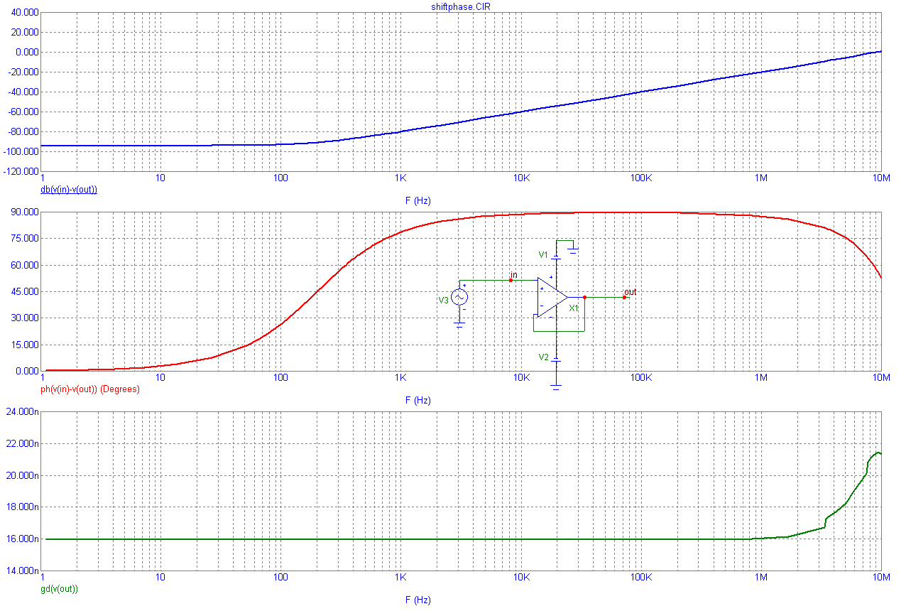

You can see the amplitude and phase response of the difference v(in) - v(out) in the attached image. It may be surprising that it is caused only by group delay of 16ns. But it is logical, depends on ratio of group delay and half-period of sinusoidal signal.

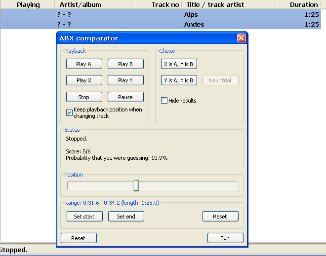

Alps was the direct feed into the A/D convertor.
Andes was the signal passing through five NE5532's each configured as a unity gain buffer, the output of each feeding direct into the input of the next. The output of the 5th opamp was fed to the A/D convertor. One listener reported that this was the preferred version in that it seemed to have more musical content compared with Alps.
This was a very important test to me because there is much discussion and feeling that even unity gain stable opamps are running right up to the point of "instability" when used with 100% feedback. Some designers suggest that throwing away a little gain (increasing the noise gain) can have benefits to sonics. So it was of interest to me to see what the reality might be with the classic unity gain follower. The scope shot in post #18 shows the curious effect that occurs when the 5532 is fed a fast slewing input signal however nothing in music approaches those speeds. It is easily fixed by adding a small R/C input filter but many designs don't do that and so I wanted to see (or hear) it worst case.
The other question mark over bjt input opamps, and particularly the 5532, is that they can misbehave when fed with hf noise, and as this test track was straight from an SACD that situation arises. SACD players can have (relatively) high levels of hf noise on the audio output. This could be one possible reason that 5532 gets a poor reception generally because its commonly used as an I/V convertor/filter in many CD players, possibly a role to which it isn't best suited.
So thanks to all that took part, and I hope we all can take something away from these tests. It has certainly been very interesting to me.
That was me ... I dips me lid to Pavel, good ears there! Just relistening, I can now pick how Pavel picked it, and also why I chose Andes. If one uses equipment which is less than optimum, which is certainly the case for what I have, the combination of the characteristics of the track and the equipment tune will be such that certain sounds will be conveyed better. So, for me, even now the combination of voice and piano work "better" over the NE5532 path, the greater "correctness" of the direct path registers less, subjectively. But, noting Pavel's comments about the hi-hat I can now hear the better rendition of the latter in the direct path, the couple of times when it's struck ...

That's fine, but even possible DC coupled hardware circuit will introduce frequency dependent phase shifts due to its own high frequency roll-off. This is to explain the difference spectrum. Regarding audibility, I am not sure, but probably a combination of both linear and non-linear distortions makes the audible discernible (though not easily) difference.
How is the difference spectrum being generated? File alignments indicate time base mismatch.
Would you show a difference spectrum?
If these are DC coupled circuits, how has impulse response been measured?
Data?

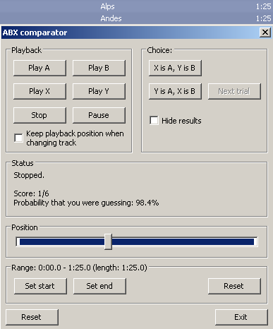

Here is an ABX result for Alps v Andes:
Probability that I was guessing of 98.4%? Riding the horse facing backwards.
