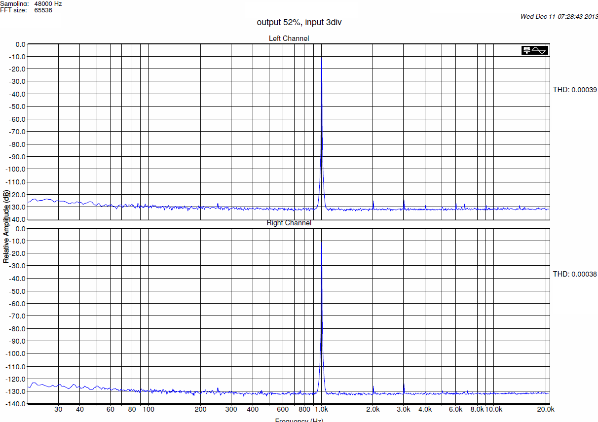

Mooly here is distortion simu from program TINA with schematic as post #82, 7,07V RMS input 1KHz and 20KHz, output no load 2V RMS.
Interesting to see it simmed in another program. Those distortion figures are orders of magnitude higher and probably far more realistic.

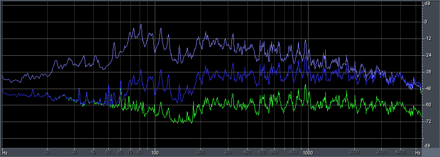

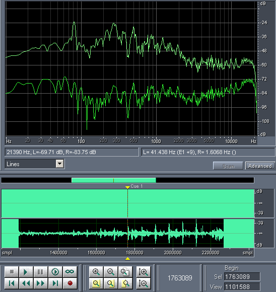

With well aligned tracks of A and B the subtracted tracks for aaa and bbb are on the order of 36dB difference. Lots of people seem to have difficulty discerning two tones at that degree of difference.
If aaa and bbb differ only in amplitude, difference is identical track of lower amplitude. If aaa and bbb differ only by noise content, then difference track reveals noise and it's relative level. If both aaa and bbb have only different noise then difference track would show this too.
In real case, phase differences are involved across spectrum that result in amplitude differences seen in display.
In previously posted example for bbb-aaa with improved alignment:
dips and peaks of reference spectra and difference spectra are extensively lined up above about 200Hz. Below 200Hz peaks and valleys show divergence. In this picture single 65k fft was used. In this case snapshot of spectra is of insufficient resolution. With 262k fft and averaging across entire waveform, resolution goes up and noise is reduced as well:
In the above overlays show reference spectrum, difference spectrum of original bbb-aaa, and bbb-aaa with improvement using 2 sample offset between aaa and bbb; aaa was delayed 2 samples.
For original aaa-bbb with 262k window averaged across track, the peak and dip alignment with reference extends down to about 70Hz. Peaking in difference tracks is seen; 60Hz line, 50Hz line with little side bands, and also lines at about 33Hz and 36Hz. For sample adjusted difference spectrum, sharp lines are visible immediately above 70Hz; with a 100Hz and 180Hz line also apparent. None of these details are apparent in spectra of aaa and bbb when viewed directly as overlays.

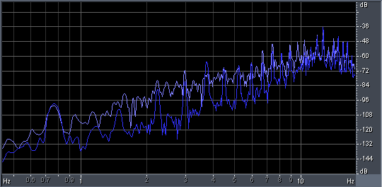

Audacity spectrum display is clunky. No overlay features or display zooming. With vinyl example, bigger fft or fewer data point by down sampling is require to see turntable havoc:
Nothing sounds quite like vinyl. Lots of super LF stuff to modulate brain wave activity. I think some of those LF patterns are addictive.
