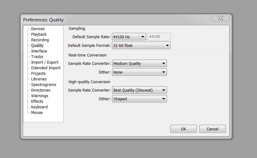

Hi Karl, I am with Jay here, it is very difficult to assess quality of anything that goes out of the analog output of the CD player and then it is digitized with 16-bit precision.
Fair comment... and I'm showing my ignorance now. With Audacity that I used to capture the files I do have 24 bit as an option. These are the default setting I have used.
32 bit float is perfect. The key is when you save files. You can save them as 16 bit or 24 bit. You also should say your card in the card driver which resolution it should use. And then it is good to make loopback test with 24-bit test file to make sure your card really works at 24-bit resolution. You may also download my 'sigtest110', 24bit -110dBFS sine.

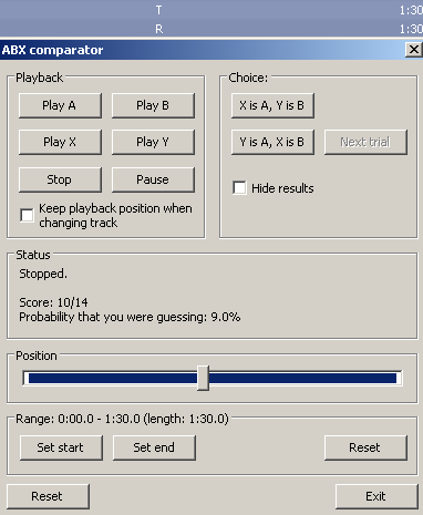

ABX T v S
ABX T v S:
I find my own performance hard to believe. If difference is apparent, it is right after switching. A few seconds of A, then X or Y, then answer or stop. After answer or stop, pause before next trial.
No way to make preference. Bad choices are often made this way in showrooms. Extended listening with diverse music selection
ABX T v S:

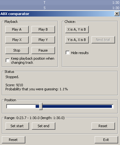

ABX T v S:
I told ya! It's the only pair I can differentiate with 100% confidence. The reason I believe is:
1) the two opamS with 100% feedback make the sound THIN.
2) the two opamps with resistor trick make the sound FAT (due to noise?).
So it is very very easy to differentiate. Thin versus fat.
