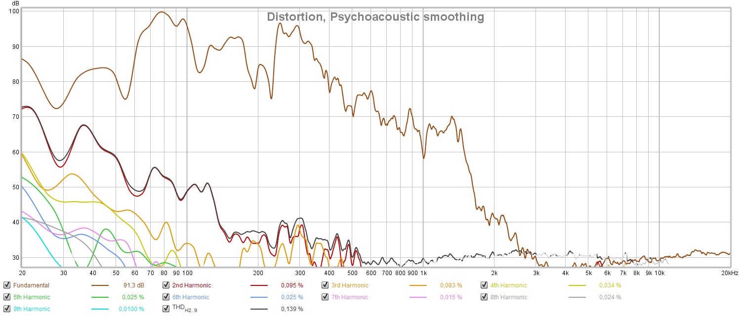

Is this what you are looking for?
This is a near field measurment (10 cm) of the raw driver (no EQ or crossover) in the cabinet.

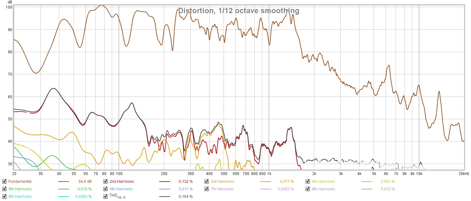

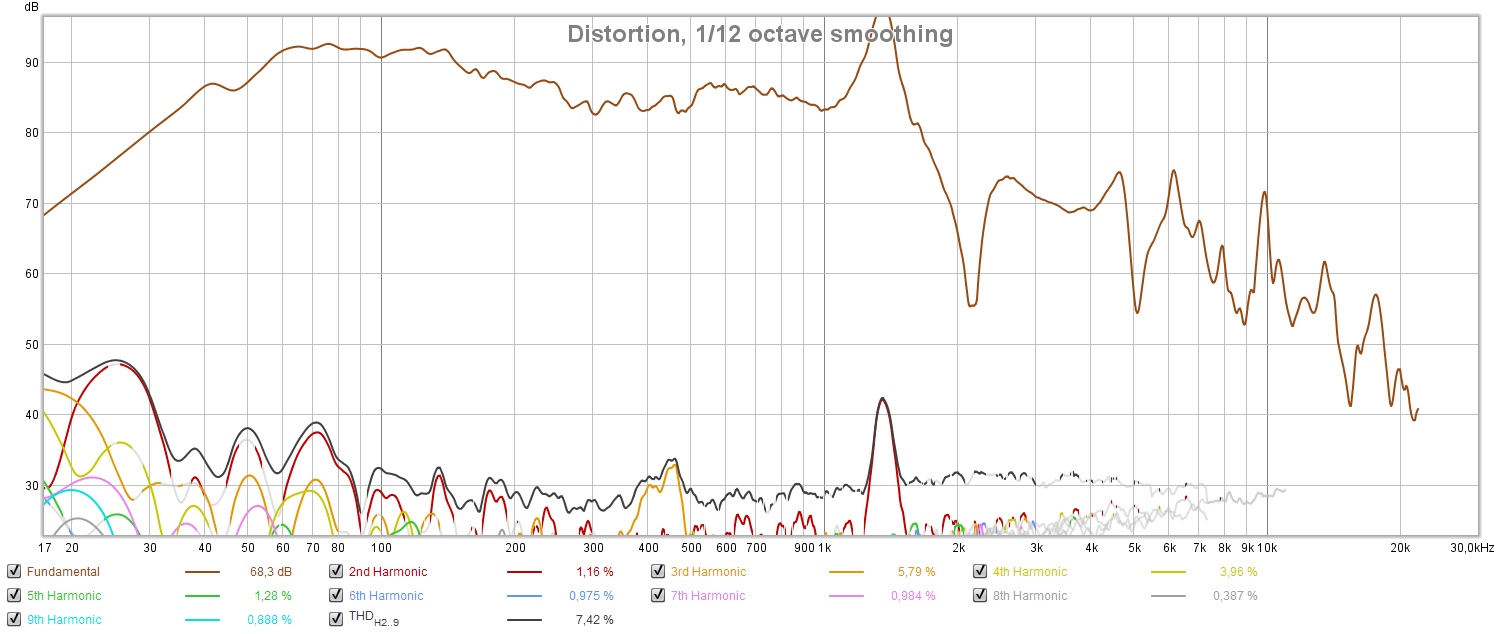

Please take distortion at 1m, spl 95dB. Now all we see is room's ambient noise.
In nearfield it is impossible to use high enough spl, the mic starts to distort. At 1m response has some reflections too, but we don't look at them now! REW sets IR gating independently for distortion graph.

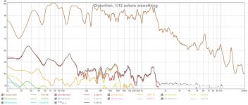

I try again. 1m distance with speaker raised off the floor. This is the best I can do for now.
First attachment is raw driver with no EQ. Second is as used with EQ and crossover at 180 Hz.
