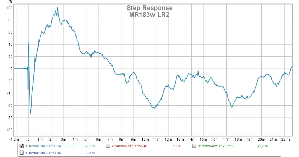

Each driver's equalization is very important! Without it response with XO-filters doesn't work! You don't have to try to be too precise, sharp peaks and dips are mostly caused by reflections and they should be left as is. Baffle step eq is needed for both woofer and midrange.
With HFD, high-/lowpass 2 gives LR2 slope, for LR4 use it twice like said in Help file.
I use 11dB attenuation for midrange!
Here is ideal step response for LR4 3-way (Magico S5) All drivers in same polarity.
Peaks from left to right are tweeter, mid, woofer and all peaks point up
This is how a LR2 3-way looks. Mid must have inverted polarity relative to woofer and tweeter.
Mid is peaking down here. Peak direction depends on speaker's and amp's polarity. Notice different time scale!
