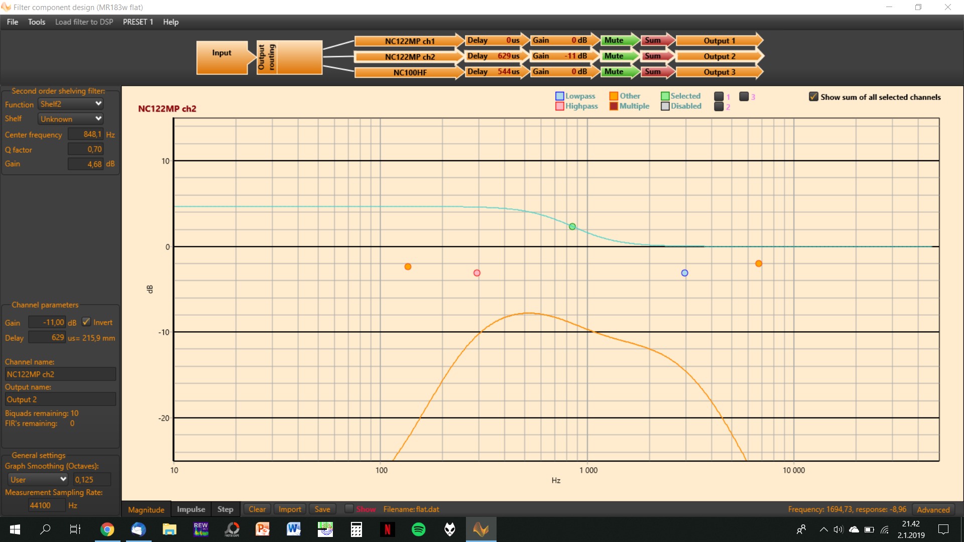

- For BSC set Shelf2 at 400Hz for +5dB.
- Another Shelf2 around 4kHz different direction, Q of 3 or 4 and gain -10dB. This is not so critical to get straight because the driver is beaming and this is quite far out of passband.
- BoostCut around 1khz, Q 1, -2dB This is very delicate range, small changes can be heard!
- Lowest tail eq carefully with Shelf or LT - do it later on if needed, measurement must have IR gating of at least 20ms
- Gain -6dB (in left column) I don't think it is a good idea to use +5,5dB unity gain for tweeter!
- Delay by simulation for a start (set as microseconds, shown also as mm)
This is just guessing, take new measurement after uploading the settings. Then set new parameters or add filters, upload and measure again etc. When it looks fine, save settings!
This is my MR183w midrange settings
- BSC shown, at 850Hz
- Boost/cut at 135Hz, below passband to attenuate peak at driver's resonance
- Highpass2 at 300Hz
- Lowpass2 at 3000Hz
- BoostCut at 6500Hz to tame cone resonance above passband
Because I use LR2 filters, it is very important to do precise eq one octave past the xo point - xo 300/3000Hz means straight response from 150Hz to 6000Hz, which is a real challenge and I don't quite reach that with these settings! With higher order xo this is easier and mid's and tweeter's low end won't get so stressed (lower distortion)

Thanks for your input! I gave it a try.
The raw midrange response:
The response with your suggested EQ settings:
I made some adjustments:
The total EQ is now:
Summation of tweeter and driver with the 9.5mm delay is pretty nice i think!:
Did I miss anything?
- +5dB low shelf at 400Hz
- High shelf at 4kHz with Q of 2 and gain -6dB
- -1dB cut at 880Hz with Q of 3
- -2dB cut at 1700Hz with Q of 1
- -2.5dB cut at 3800Hz with Q of 9
- (And a low shelf boost of +6dB at 55Hz to extend it flat to 40Hz without crossover)
- LR4 at 150Hz and 2000Hz

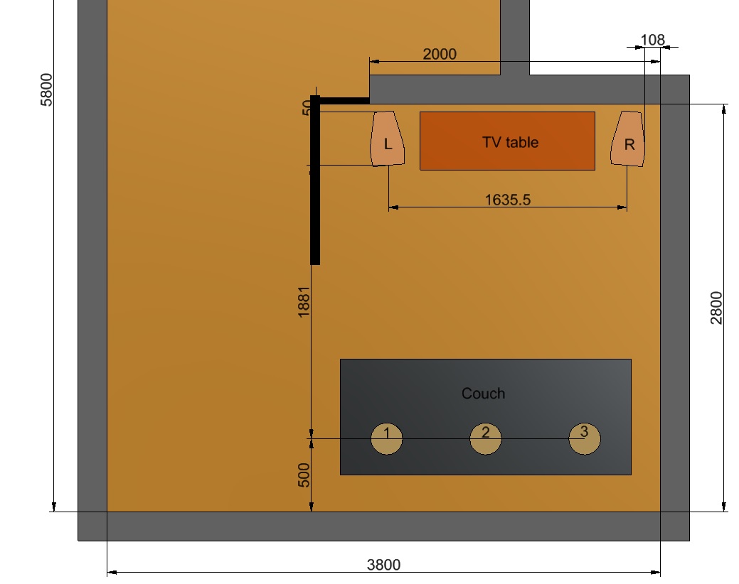

I will try to follow your guide, even though I don't have a big room.. I have a small(3,6 x 4ish m) almost empty room though. Maybe that will work?
Problem with my listening position is that I am sitting in a couch really close to the back wall :/ I know this is not ideal, at all, but it is how it is.

In you room this will be difficult! What material are walls, brick/concrete , gypsum board with insulation, wood? Material affects how much of bass energy goes through the wall.
If you listen next to wall, you must let low end response to rise 5-10dB (plus modes) in measurements (below 100Hz). Your brains will compensate for this and reverberant/decayed sound energy is more important to how it sounds to you. With hard wall there will also be destructive reflection nulling the response sharply at some frequency, just like what happens with the front wall. SBIR calculator
Be patient and try different placements of speaker and mic, this way you will learn how the speaker and room interact. One trick to test is to play sine wave of certain problematic frequency from a single speaker and walk around the room to hear how amplitude changes. Remember that also height position matters!

Walls are brick walls with wallpaper/tapestry/wall covering (don't know the right word).
Floors are wood, so is ceiling.
Okay, thanks for the tip.
There is sadly no real option to move my speakers around, even though the placement is the opposite of ideal. This is a sketch of my living room (the circles 1, 2 and 3 are listening positions - All measurements are estimates, only a sketch. But the right speaker is close to the wall!):
The corner placed speaker (right speaker) is in a really bad spot I know, but I have nowhere else to put it. The other speaker (left) is placed in a way no simulation software can handle (and I don't know how it actually affects sound).
Would I benefit from removing the woofer facing the side wall and only have one woofer pointing towards the TV? Then I won't have the force cancellation anymore though.
I can do this by (on both speakers of course):
Removing one woofer (would create a open back/dipole/ported configuration)
Removing one woofer and block the hole (sealed enclosure again but twice the volume pr driver.)
Disconnect the woofer but leave it installed. (Passive radiator design).
However, I was hoping I could simply design the speakers for this actual placement (knowing it would be a redo of crossover if they where ever to be moved - !).
DigitalThor#
With the information above, would you think there would be any benefit from having one (or two) of the same 10 in subs in my mains (Shallow SB subs - only kind of 10" driver that fits under my low couch -15 cm of air) under the couch?
DigitalThor#
Difficult room and positioning. Can you rotate clockwise 90¤? Now R speaker bets bass boost from two walls and also midrange has lots of early refections from sidewall. L speaker gets very little boost from wall. 90¤ turned setup would be symmetrical.
I think that anyway you should make the speakers to have double active woofers and forget the subwoofer. With dsp you can do different eq corrections to L/R. Still stereo image surely won't be symmetrical through spectrum. Multiple subwoofers might be better, but require enormous effort and trials to play really well - I don't recommend that in this case.
p.s. Trick to WM xo : Put the speaker in the door opening to corridor or another room, this way backside radiation and reflection will get eliminated almost totally! Also wall boost is smaller. Helps a lot to set timing/delay.
I know this is a difficult room. I cannot do much about the layout. This is an apartment and at some point in the not too far future we will move to a house. So until then I don't expect perfect results. Just as good as possible under given circumstances.
That is a good tip with the doorway. Didn't think about that way of making the setup symetrical.
How big a difference do you think it will make once i get the second speaker build? Won't it be a little like multiple subs? (2 compared to 1).
I'm a big believer in symmetrical front speaker placement so if you absolutely cannot alter the room configuration (which I'll assume to be true otherwise you probably would have done it already), I would add a sort of moveable/foldable 'wall' of some type to the left of the speakers. Something as shown in the pic below (that would be with it open). I'd then center the front setup in the new space. I did something like this in an old place of mine using a folding closet door that I pulled from a spot where it wasn't needed, but you can probably build something better than that with your skills.
Also in a small space like that, I've found absorption panels on the wall behind the couch to be very helpful.
