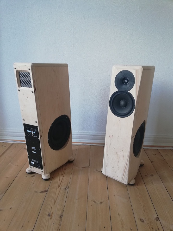

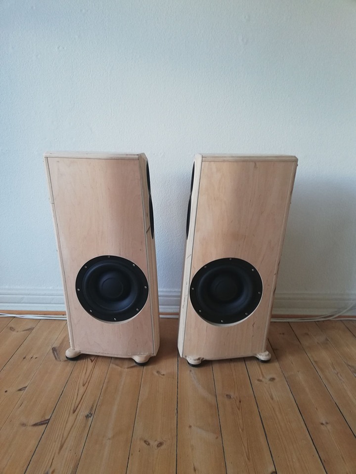

Finally Stereo and great sound!
Finally!
I finished the second speaker!!! 😀😀
I also got to do some outdoor measurements, trying not to bother my neighbors too much xD
And i am very, VERY ******* happy with the result, both looks and sound! 😀😀
The final result is this:
Tweeter - SB SATORI TW29RN-B - In home made 140mm WG
Midwoofer - SB SATORI MW19P04 - In13.2l aperiodic enclosure
Subwoofers - 2 x SB SW26DBAC76-8 - Two drivers sharing 18-19l sealed enclosure. The 18l is with bracing subtracted, but NOT with driver displacement subtracted.
Amplifier - FA253
Mid and high crossed with Harsch crossover at 1700Hz
Mid and low crossed with LR24 crossover at 180Hz
And this is what the pair looks like:

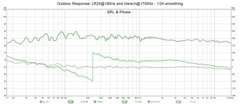

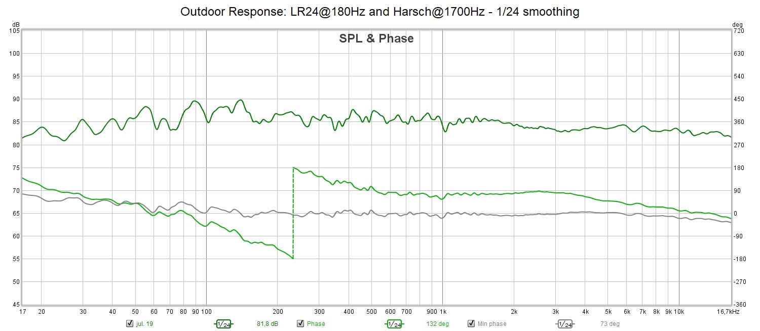

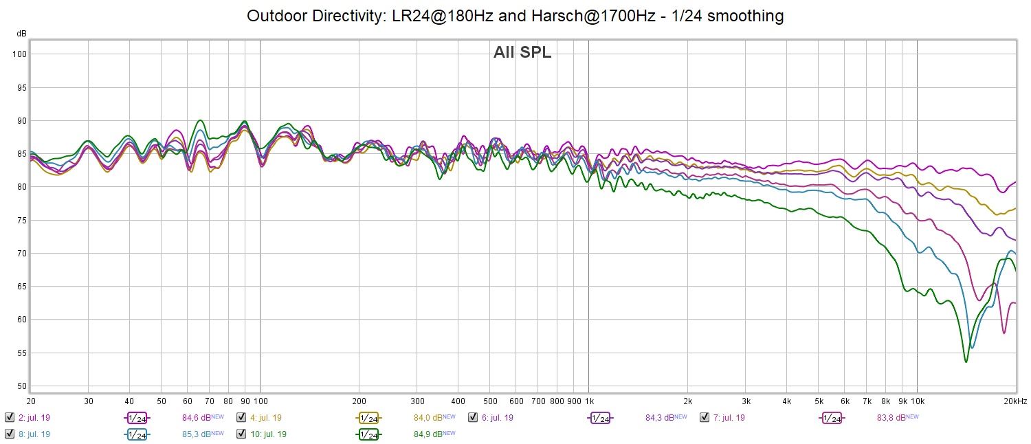

"Final" Measurments
And for the "final" (As i that ever happens xD) measurments!
They were done outdoor like this:
The speaker was raised 145cm above ground. Meaning that the center of the subwoofers were 177cm off ground. Center of the mid 205cm and tweeter 220 cm.
The microphone was placed at 1m and pointing at tweeter.
Here are the on axis response with phase and minimum phase (What is this even showing compared to normal phase?):

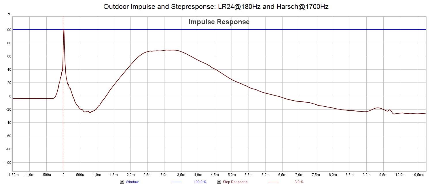

And the corresponding step response:

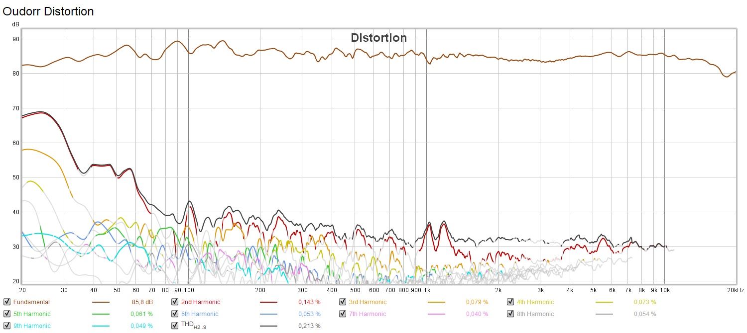

And distortion (values in the bottom are for 1kHz):
And finally some off axis measurements. They start at 0 degrees and end at 80ish degrees in roughly equal steps.. I had no way to do it accurately:

Very impressive!
What is the grill in the back a vent for - a driver? air duct for the amp?
Interesting set of bass drivers, where do you divide between the bass and mid/bass?

cph2000# Thanks! 😀
The grill is just hiding a port stuffed with dampening material - Creating the aperiodic enclosure for the middriver. 🙂
Yes, they are not so commonly used on here, but helped by the DSP they pack a serious punch in a VERY small box! No boomy subwoofer here!! 😀
