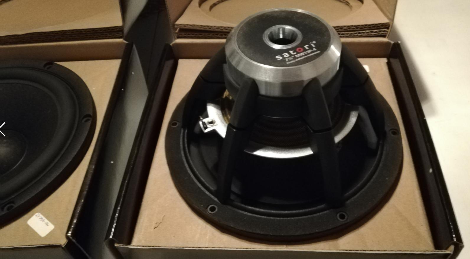

I have been impressed with SB so far; I have some Satori 6 inch mids that really put many other higher priced drivers to shame! I have a few of there very basic drivers as well; same story though, much better than some other brands in their price range and above. My SB sub-woofer project isn't finished yet but I find it amazing that a "9 inch" driver in a small, closed box can put out very deep bass. Of course, the Hypex plate amplifier has numerous EQ, gain, X/O, etc. adjustments and plenty of power to "push" the SB that low. 16Hz is hard to come by; I am getting this in the small room. I have several recordings of pipe organ, 16 Hz comes from the 32 feet pipes!

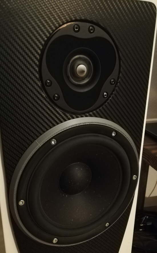

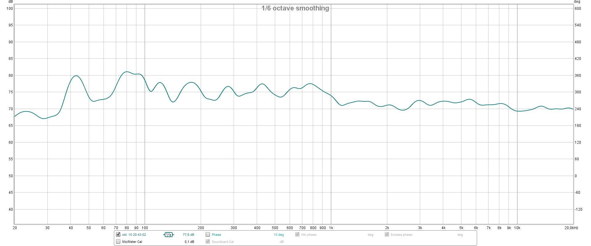

I actually just recieved my MW19P's and started testing with them. They sure have a amazing build quality and also seem promising when it comes to sound! I still haven't had time to pay that much but currently this is my reponse at listening position with a MW19P in 22L.

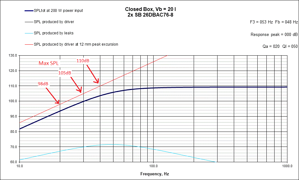

Actually I think 2 of those 26DBAC76-8 subs sealed in about 20L will do even better than you think they will. Attached is what Unibox shows for max SPL without exceeding xmax.
You're looking at more like 105dB at 30Hz and about 110dB at 40Hz.

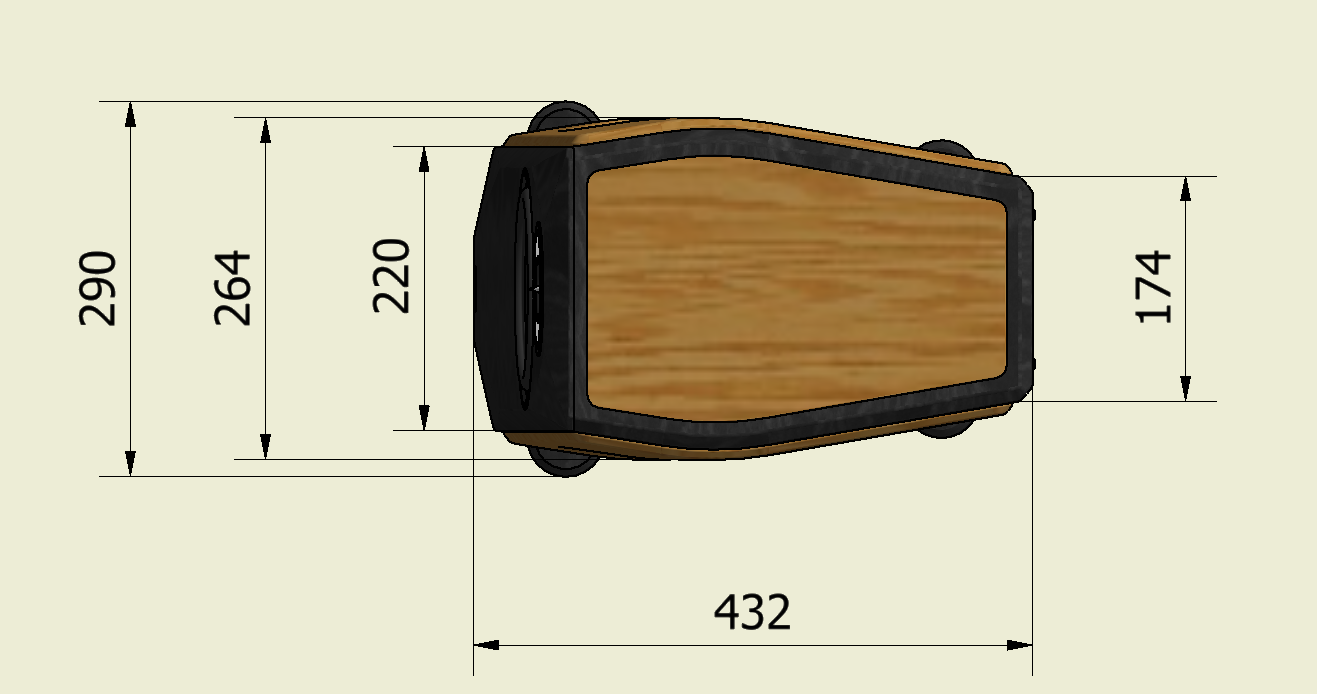

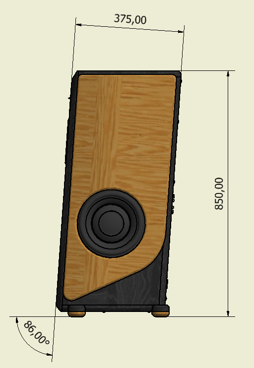

I have attached some pictures with outside dimensions. They are really small!
