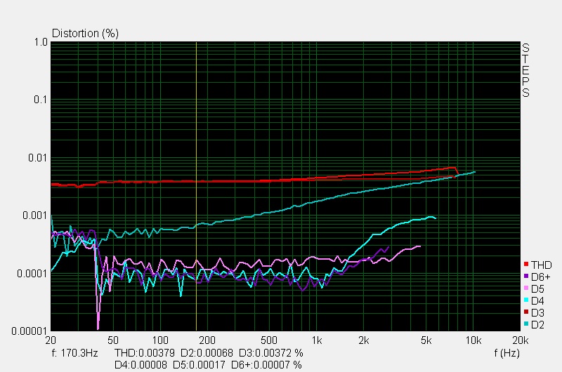

I tried measuring the VAS output on its own and got the attached image.
Measuring the input stage would be a tad harder I presume as it's got a current output.
I'm not entirely sure how useful this is as the 2nd harmonic is clearly not showing what goes on at the output. Also this was done with zero load on the output, whenever the output was loaded the distortion fell to pieces.
Either way it shows the same flat line 3rd harmonic. I assume this shows that the problem is located either in the VAS or input stage.

Yeah this is the confusing part. Whether the amp is driving the sound card alone, or a load the 3rd order remains roughly unchanged.
At 30 volts p-p is when the 3rd order starts to dominate. Driving the sound card, distortion is low...
If you then attach a 9,4 ohm load the distortion increases by a small amount, but this is as expected...
Then once again it increases as I drive the 4.7 ohm load, but that's to be expected also...
The absolute magnitude of the 3rd order at low frequencies actually decreases a little as the output current goes up.

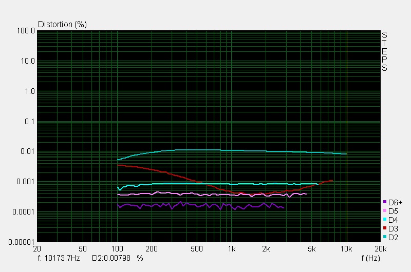

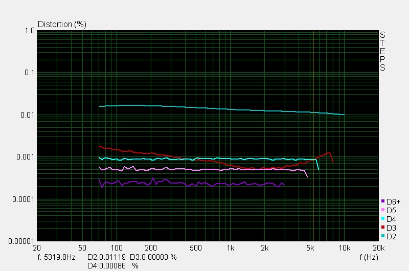

If I drop the drive level down to 20v p-p the third order blends in with the 2nd @ 0.0003-5%, until around 5khz.
No load...
Driving 9.4 ohm, showing increased distortion from the output stage.
As of now the output current doesn't affect the third order much at all. It seems, just like you said...

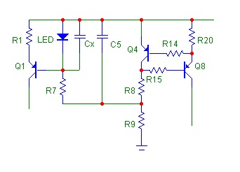

Perhaps nonlinear cb capacitance of Q8, try to place capacitor (47uF?) between base Q8 and Vcc bus..Or cascoding current source for VAS.
would the performance improve if Q8 was changed to become the complement to Q6.
I dislike Self's use of the CCS control voltage (Q8,Q4) to also set an uncontrolled voltage for Q3. If Q4 is actively reacting to Q8's needs then that variation is needlessly being fed to Q3 as well. Although I dislike it I have no evidence to show it cannot work. Reading of Self's slew rate asymmetry and the steps he took to improve slew rate seem to show he did not understand the full workings of this dual CCS.

Sure, it is much better to use two independent CCS for input and VAS. And replacing R15 with short (jumper) can also help.
I've read here that the coupled CCS for LTP and VAS has a protection/shutdown effect when driven into overload.
Is this paramount and can this protection be provided in a better sound quality way, if the two stages have separate CCS?

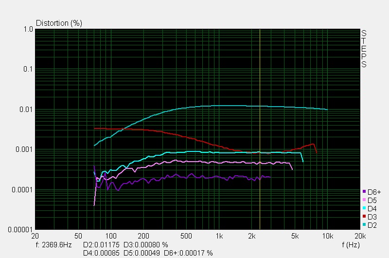

This was interesting. And not just because the performance literally turned to cow dung. But more for what it ended up doing to the third harmonic. My guess is that this is just some form of cancellation from somewhere. But I don't fully agree with the results based simply on that.
All of the other harmonics increased as a result of adding in that cap, but they do not vary much with frequency. You'd figure that adding the cap would result in a net increase of 3rd harmonic too.
The old third harmonic problem doesn't vary much with frequency. If adding in the cap would have produced another source that remained flat with frequency, then surely the net result should be a flat increase (if constructive), or decrease (if destructive) or the overall distortion performance.
Now induction distortion changes with frequency, but if adding in the cap caused this to happen, surely all the harmonics would change as a result, rather then just one.
Either way the level of third harmonic from 800hz onwards does what I'd expect it to do if the amp was behaving properly in the first place.
I can easily add in another transistor and create two separate current sources. One thing Slone does well (at least according to me) is his descriptions of various constant current designs.
I never intend driving the amplifiers into overload, except in testing. Or are you implying that due to a failure in another stage it could cause the CCS to go out of control and this version is self limiting so wont blow up 😛
D1 should never have an AC voltage across it when the amp is operating within it's specification. The DC voltage is ~output offset voltage.
Have you checked the effects of D1 in the feedback circuit to the distortion performance?
I thought D1 was present to prevent the rail voltage from being thrown at C5 in the event of a some sort of failure. I did try disconnecting D1 a few days ago, just to see if it was doing anything and indeed it was not.
Currently I'm looking at two separate constant current sources along with a few PCB changes that put the VAS closer to the input stage.

I tried this again with different sized caps.
The first attachment is with a 22u the second is with a 220u.
I don't exactly know what's going on here but the larger the cap is made the better the third harmonic becomes, even though everything else is significantly worse.
Also when a load is placed on the amp all the distortion products rise.

Maybe you've misunderstood what's going on here. The high frequency response is improved by increasing the capacitor value (for third order), decreasing it improves low frequency performance.
Using just a 1.5uf film cap yields no real effect on the third harmonic at high frequencies, because it is not big enough.
If you look at the response with the 22uf lytic you can see that it's almost as if a high pass has been placed on the distortion. Decreasing this down to a 1.5uf causes the corner frequency to increase, but as the cap isn't large enough it has almost zero effect on the third order and this is at all frequencies.

that's not what I see.
Above 1kHz, it appears that all harmonics are lower with the 22uF, except the 3rd.
Below 1kHz, it appears that all the harmonics are lower with the 22uF, again except the 3rd, but in this lower frequency region the 3rd is much worse.

Please bare in mind that the scale is different for some of those graphs. Some of them have 1% as the max some have 100%. I apologise for the mix up but sometimes I forget to put it from 100 to 1%.
There are some minor changes at high frequency with regards to cap size, but not a lot.
