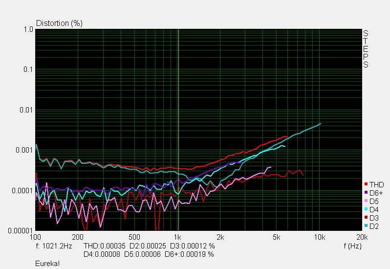

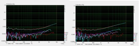

And what solved the problem? Changing the 10k resistor in the feedback network.
I was browsing Farnell and I noticed that the normal super saver 1206 1% 0.5 watt buy 50 a time, surface mount resistors that I buy were rated at 50 volts. This hadn't even crossed my mind as being a source for the distortion. I didn't figure that resistors really cared about the voltage they were given - unless they were going to be exposed to very high voltages.
Anyway, attached are two pictures showing the distortion with no load and then with the 9.4ohm load at almost 80v p-p.
I'm glad it turned out to be something like this, because quite frankly it wasn't making much sense.

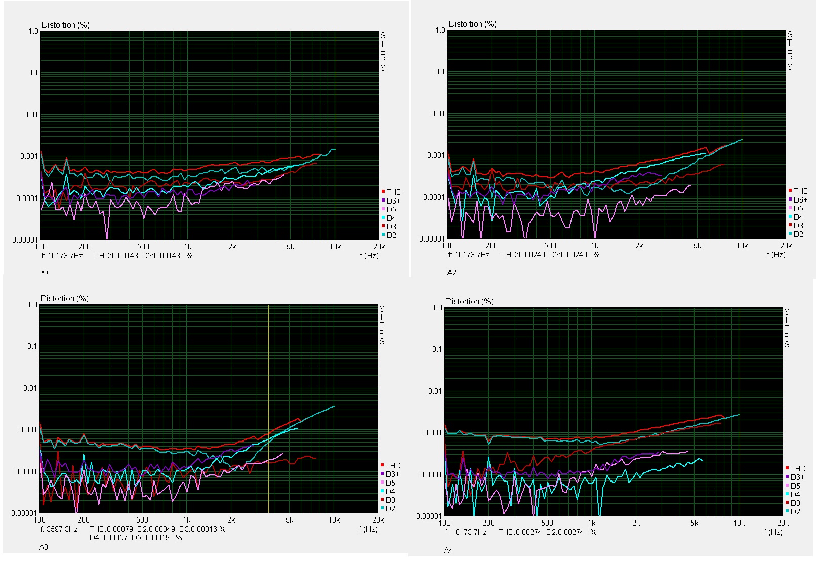

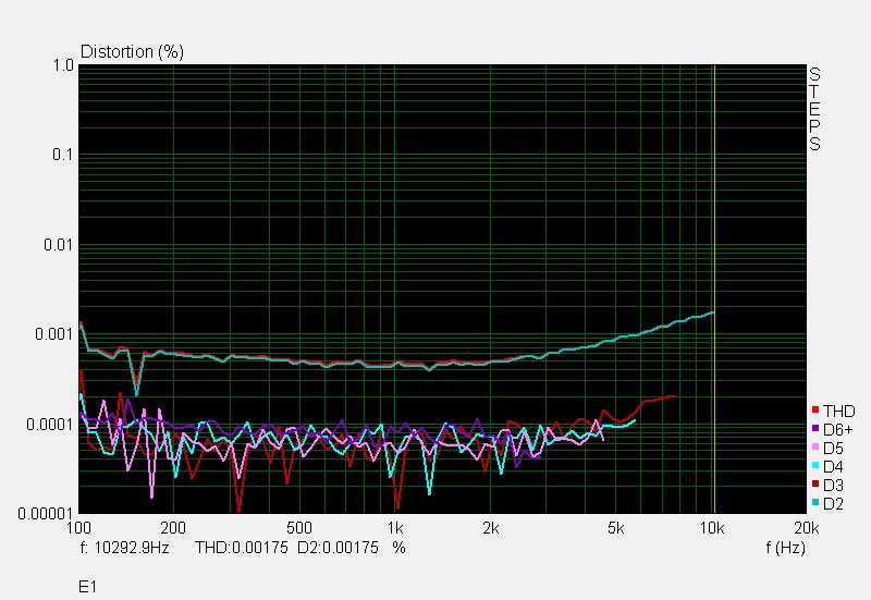

And just for completion here's the distortion plots for all 4 channels, same order as the last one. They are all driving the 9.4 ohm load at just under 80v p-p.
They all perform well, with perhaps no 1. taking prizes for the best. Either way at distortion levels this low small differences in the position of wiring can alter things quite dramatically, so it's hard to say if it's really the PCB itself that's causing the differences.
No.4 is the worst out of the lot and I think this is because I put some traces and the one component on the copper bottom. I feed the +ve and -ve power into the boards via a twisted cable that connects to the copper bottom. Moving the power cable around a bit changes the performance quite dramatically, so for the remaining boards I will certainly move those traces back to the top.

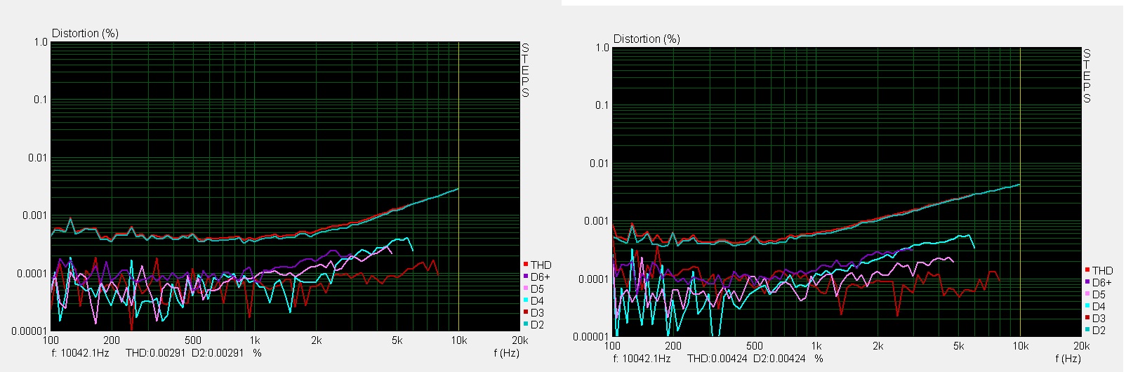

As promised here are the distortion plots for the last two channels of the 6 channel amplifier. Nothing surprising here.

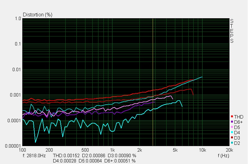

And for completeness, here's also the amp driving 120 watts into the 4.7 ohm load. I can squeeze 140-150 out of it before clipping, but at that point the distortion deteriorates down to around -85dB, still decent enough. A 2.35 ohm load? No, thank you!
The most immediate improvement over the previous 6 channels is the noise level. There's less hiss and far less low level 'buzz/hum' then with Slone's boards. This is most likely down to proper grounding within the entire amplifier and I'm pleased with that result. The noise the system produced always irritated me and I had always assumed it the fault of the active xover, but it appears that the amp was as much to blame.

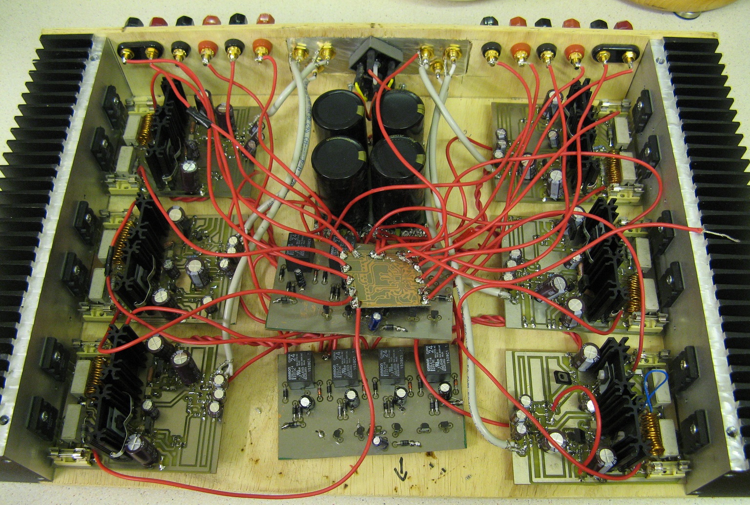

Here's the inside of the amp. 😀
A fine example of organised chaos if I do say so myself.
But it does show at least, that you can arrive at 0.000x% THD between channels without any significant degradation in performance via, what Self calls, Induction or Rail decoupling distortion.
For example one channel driving 1khz into no load at 80 volts p-p would have 0.00035% THD. If another channel is asked to do the same, however this time driving a 9.4 ohm load, the performance of the first channel decreases to 0.00045%. There is some coupling but nothing that's any cause for concern.
The bridge rectifier is mounted in the middle of the input connectors, this doesn't appear to do anything to harm the performance.
Grounding.
The first thing to mention is the aluminium plate at the back of the amp. All of the input connector grounds are connected together via this.
From this point shielded cables are taken to the individual amplifier boards. The screen is connected to the aluminium plate, then at the other end connected to the signal ground of the amplifier.
In this case R4, D1 and C7 are the only things that make up the signal ground.
R9 connects to -ve instead of ground as recommended by Andrew, with R8 and R9 increased in value to 20k.
From the metal plate 1 wire is taken to the star point.
The amplifier boards have a separate connection for power ground. This is made up of C3, C4, C11, C12 and the ground connection of Q5.
Connecting Q5 to either the signal ground or power ground didn't change the performance. In the final board design it was easier to connect this to the power ground, but either will do.
After the bridge rectifier are the smoothing caps. These are soldered to a PCB. The PCB is made from 2oz copper with a fat trace down the middle of it creating a ground point. I've taken two wires from this fat trace, back to a separate piece of PCB that I am using for the star ground point.
The ground return for the relays and the power ground from the amplifier boards are taken back to the fat trace on the smoothing cap PCB.
The ground connection for the output and the zobel connect back to the star ground.

Andrew the amps can deliver about 55 watts into a 2.35ohm load.

about your 'organised chaos', I mean once the cover is closed nobody will see that and finally the performance is what counts.

I assume you are referring to these. As I am in the process of getting a higher powered version of these built, I certainly want to make sure that the same thing doesn't happen again.😀
you have a nice measurement tool, the Neutrik A2 I can use doesn't support individual distortion components like yours. need to think about investing there... 😉
It's nothing special really, just a high performance DAC/ADC hooked up to the PCI interface chip on an M-Audio sound card.
The simplest way to get similar performance would most likely be an Asus Xonar card of some sort.
Stereophile measured one here and it's certainly up to the task.
Indeed. I think its a hidden inevitability with DIY, that no matter how much care you take, you will always end up with spaghetti junction inside the box 😀
