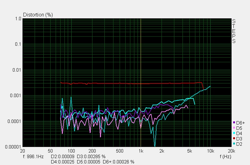

The overall performance didn't really change.
Attached image is at full power into 9.4 ohms. All the faffing about with the test equipment did allow me to improve the situation a little, although I'm sure this could just be down to a little harmonic cancellation.
For instance the left and right inputs to the ADC give slightly different results and lifting the ground also changes the 2nd harmonic. Nowt much changes the third harmonic though, its always prominent.

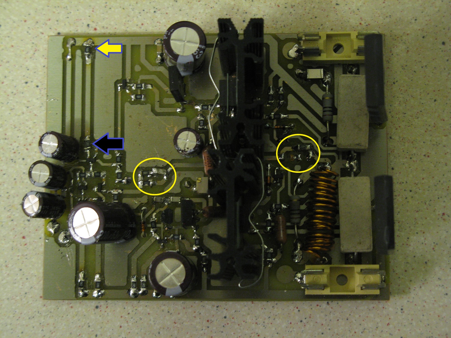

I have recently redrawn the PCB for the 11.4 amplifier, guided by some of Douglas' groundind technics, and also other minor improvements.
This is what I ended with:
The construction notes, schematics, BOM, along with the layout, can be foud here: http://www.nabucoeletronica.com.br/files/slone-mods-by-Nabuco.pdf
I would really appreciate your comments!

Okay.
I'll say what I see, others can correct me if I'm talking cods-wallop.
First of all you do not need heat sinks on Q8,Q5 and Q6. They are barely even warm to the touch, so save your pennies!
You've separated out the power and signal grounds in a decent enough way, this is something that Slone's board severely lacked in.
*Q5, Q6*– *mounted back to back on the same heatsink.*Should*be matched in Hfe and Vbe.
This is not important, in fact these two devices don't even need to be of the same type. This is one area where Slone's transistors could be improved upon. If you read the rest of this thread you will see recommendations for the parameters of Q5 and Q6.
Q1, Q2*– *mounted back to back. Should be tied together and matched in Hfe and Vbe.
This is a good idea as it will help reduce thermal drift effects on the DC offset. Matching Hfe will keep the pair balanced, reducing DC offset again and ensuring good cancellation of 2nd order from the input pair.
Q9, Q10*– *mounted back to back on the same heatsink. Should.be matched in Hfe and Vbe.
Q9 and Q10 do not need a heat sink. Matching Hfe should help to keep DC offset low. In practise though I don't think this is that important. You should be able to easily get below 5mV DC offset with a well matched input pair.
Q11, *Q12,*Q13,*Q14*–*Mounted on main heatsink.* Q7*–*mounted on a small thermal bar, made of aluminum or copper, wich should be screwed to the front of Q12 ans Q14.
This is the main problem. This amplifier uses a complementary feedback output stage. Q7 is required the thermally track Q11 or Q13 not the output pair.
As you will see in my design, Q11 and Q13 are mounted to individual heat sinks, with Q7 mounted directly on top of Q11.
This is one area I disliked about the Slone PCB. In effect I don't think having Q11-Q14 + Q7 mounted on the main heat sink would decrease the overall performance by that much. However it's a royal pain in the behind to fasten each transistor + thermal pad to the main heat sink, and makes it a pain if you ever need to remove the amplifier from the heat sink. Having only the output pair attached makes this far easier.
You've changed the input filter, I think you still need to make sure to maintain balance between R4 and R10.
The feedback take off point is ill-advised and I dislike Slone carrying the output of one of the RE resistors through a wire link.
You also have C13 from the zobel returning through the power ground, I don't know if this will do any harm. I definitely can tell you that my amplifiers need the zobel for stability, I tried removing it and they were not happy.

5th element said:This is the main problem. This amplifier uses a complementary feedback output stage. Q7 is required the thermally track Q11 or Q13 not the output pair
You're absolutely right, thank you! Well, I could use a small thermal bar mounted on front of Q11 and Q13, and having Q7 mounted directly over that bar. A thin aluminum or copper bar would make heat trasnfer to Q7 more efficient.
Would you recommend that? I have already etched the boards, so I'd like to use them...
5th element said:The feedback take off point is ill
I'm sorry, I don't understand what you meant, could you say what's wrong?
5th element said:You also have C13 from the zobel returning through the power ground
I can separate that from power ground and run a separate return to HQG instead. Would you think it's worthy?
Thank you very much my friend, you've been of great help. 🙂
There's no harm in giving it a go. Ideally you should have Q7 mounted directly on top of Q11 or Q13. You could attach wires to Q7 and have it mounted free from the PCB, that way you could attach it directly to one of the pre drivers.
Feedback works by taking a portion of the output signal and feeding it back into the input. The two signals are then compared and anything the amplifier can do to get them as close to being equal as it can, it will do.
In this sense it's vital that the feedback signal be as accurate a representation of the output as is possible. If some grunge gets into the feedback and contaminates the signal, the comparison is now flawed and hence the performance suffers.
The junction between the RE resistors R33 and R34 is the point where the output from the positive and the negative side of the amplification process are summed. This specific point, according to Self, is a turbulent place to be and I guess you could sort of liken it to the junction between two reservoir capacitors in the power supply. You don't connect anything to that junction, but take a tee off of it and this point is used as the HQSG, or in this case used as the output of the amplifier.
You then take the feedback off of this point too, but slightly before the output inductor.
Slone has the feedback point at one side of the RE resistors, before they've summed, this is wrong. In fact he connects the output from one of the RE resistors through a wire junction J4 in your schematic. The start of the feedback take off circuit is C6 R11 and R10. Follow the trace common to R10 and C6 and follow it back toe J4, that's the feedback take off point Slone has used.
Slone has to use this junction because he's got the traces from Q7 running down the middle of the board. If you were to attach Q7 to individual wires instead, you wouldn't need this junction and you could redesign the output and junction between the RE resistors in a much better way.
It might help, I don't really know. You'd need to measure the amp to determine if it was needed. It certainly wouldn't hurt to have a separate connection back to the star point.

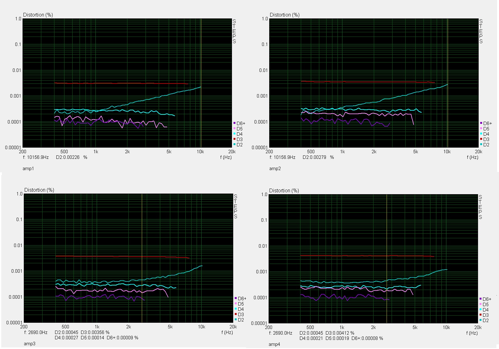

So now I've got 4 channels built.
In the 4th iteration I went back to the combined current source for the VAS and input stage. Separating them out appeared to do virtually nothing to solve the third order problem.
I also altered the case that would eventually hold the 6 channel version. This allowed me to wire up the 4 channels together, rather then only being able to wire up 2 as per the other chassis. Like this I measured each version one after the other and plotted their distortion performance next to each other. These were all taken close to 80v p-p with no load. Also the 4 channels perform as well as they did before. The wiring arrangement I'm using shows almost complete immunity between the channels. There is crosstalk, but this isn't induced or coupled via sine pulses through the grounding or from the power supply.
First of all the 4th, 5th and 6th+ harmonics are comfortably low enough down for all of the 4 channels. There's a bit of variation, but I'd be surprised if there wasn't.
The second order is also acceptable, even though there is a slight difference in the trend that the different channels show.
Then there's the third harmonic.
Ironically the amplifier that shows the best performance is the 1st one I built, but then there's only a small difference between the four.
Ranging from about 0.003% - 0.004%. This isn't a fluke of the measurements either. Channel 1 is consistently better then channel 4 and they both showed the same performance when in the other case too.
Channel 1 was built as is shown in the first PCB layout I posted. In this case the ground connection of the CCS has been connected to -ve power via a wire and the component values changed as Andrew suggested.
Channel 2 was identical to channel 1, except it had options to alter the position of various components - as shown in post 117 - also included was Andrews suggestion of splitting R22 into two smaller values, to provide better headroom for the VAS.
Channel 3 split the current sources and the experiment of component positions in channel 2 showed no real changes I positioned the components as per channel 1. I also placed the VAS closer to the input stage and repositioned C7, D1 and gave provisions for altering the position of R13 so that none of the components would straddle the feed from the input stage to the VAS.
Channel 4, went back to the original current source configuration. I also altered the orientation of a couple of resistors, more out of necessity then as an actual test. The through hole resistors I got from Mouser were slightly larger then I thought they would be. On top of this I placed R23 as per the first PCB schematic on the copper bottom and routed the traces from Q13>Q14 on the copper bottom too.
I am doubtful that any of these changes really affected the root cause of the third harmonic at all. Yes there is a tiny difference between all 4 channels, but it's minimal at best and could easily be down to component tolerances or slight changes between the interference of harmonics within the system as a whole.
The next thing I'm going to try is re-routing some of the traces of the input stage to see if that makes any difference.
