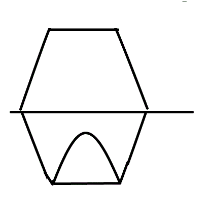

I do get an amount of sticking on the negative rail when the amp clips. If Q17 isn't present on clipping the negative rail clipping does something really ugly and R22 has a lot of current thrown through it.
It's hard to describe really ugly and I don't want to force the amp to reproduce it just so I can grab a pic on the scope.
It kinda looks like the attached pic. Where the negative portion should simply be a flattening of the sine wave against the negative rail, it appears to reflect itself off the rail as if it were a mirror. I cannot remember if anything is actually 'flattened' against the rail, or if it's entirely reflected back.
This only happens if Q17 isn't in place and with it there I get rail sticking. I can force it to show signs of instability, but I really need to make the amp clip badly for this to happen, we're talking 10-20% THD.
The higher in frequency I go the worse this sticking appears to be.
This is all with no load attached and 125mA resistors in the fuse sockets. I don't really want to push the amp into doing this with a load attached.

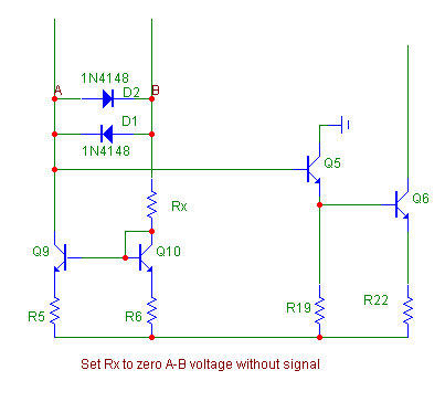

removing the VAS protection can destroy Q5.
There were a couple of threads in the last year that discussed this in detail.
They solved it by omitting the protection and adding a Q5 collector resistor to ground. This limited EF current to a safe level during overload.
Replace Q17 with 3 pieces 1N4148 in series, first anode to base Q5, last cathode to -Ve(or with one LED with forward voltage about 1,8-2V). Or much better (for fast recovery and against "sticking") is something like attached picture

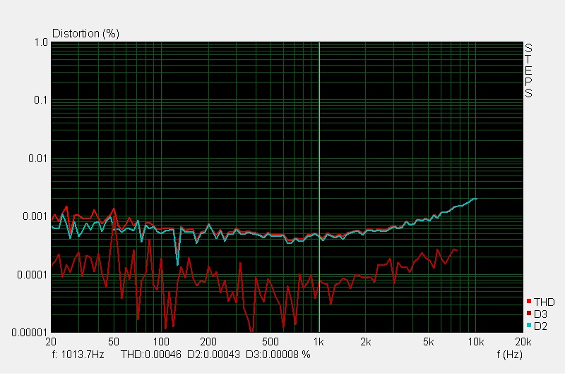

With the new transistors in we get.
This is a bit under 80v p-p into the 9.4 ohm load.
Rather brilliant 2nd, 4th & 6+ harmonics. 2nd harmonic is at only 0.002% by 10 khz.
Third harmonic, on the whole, remains unchanged. Flat line 0.0027% From 20hz up to where the sample frequency cuts off. Although it is showing a slight rise towards high frequencies. However don't confuse the 3rd harmonic with the THD plot. The rising 2nd starts to influence the THD causing it to break away a bit from the 3rd.
The new transistors, at least to my eyes, appear to be doing something good, the 2nd harmonic dropped down significantly.
Damned 3rd harmonic!

Instead of chasing the 3rd harmonic I decided to actually listen to the amplifier. Mono is always a disappointment and now I've got stereo I couldn't resist.😀
My main speakers are active (hence the 6 channels) so I had to 'make do' with a small stand-mount I designed a few years back. Scan D2905/95 tweeter and the old peerless 6.5" HDS polyprop sandwich cone with phase plug (850467). Xover at 2k in a small ported enclosure. All things considered they sound great, the only thing they really lack is deep bass, I could easily live with them as my main loudspeakers - they don't do anything wrong. Although I would probably want to add a sub.
To cut a long story short the amps sound sublime. And if I had to say, significantly better then with the Slone PCB.
The power levels I am using these at wont even excite the raised third order problem. I'm more interested in exorcising the 3rd order in a bid to find where it's coming from.
Currently the amps are built with FJV992/1845 on the input stage and current mirrors. F grade on the 992 and U grade on the 1845.
The VAS transistor is the aforementioned SC3503 E grade with the EF, the E grade version of the KSC1845.
They really do sound fantastic, which is nice to hear.
Now to try and hunt down the 3rd harmonic.

This is interesting as it's the only thing I've got to go on and the only thing that has actually made any difference.
It's my understanding that at low frequencies the input stage and VAS distortion is swamped by non-linearities in the output stage. This is providing the input stage and VAS are appropriately designed.
The input stage and VAS don't have any heat sinking and, as far as I am aware, operate in Class A. The current draw through the devices should therefore remain constant and hence the temperature of the devices should not change much during operation.
Whilst sat, pondering, I was watching the spectrum analyser with the amplifier giving close to full output into the 9.4 ohm load. I couldn't help but notice the THD % falling as time went on. Remember here that the THD is dominated by the 3rd harmonic.
What started out at 0.0043% fell to 0.0033% as the amplifier warmed up.
The only devices that see a temperature change during operation are the pre drivers/bias and the output transistors.
I can appreciate that the parameters of the pre drivers/output transistors could change a bit as they warm up and hence they present a different load to the VAS. If the VAS was the cause of the distortion then the change in load could explain why the distortion changes. However on the flip side I could also say that altering the parameters of the VAS transistors, to something inherently better suited made zero difference.
The strength of the emitter-follower/darlington style VAS is increasing it's linearity via increasing the apparent beta of the paired transistors.
Changing the EF and VAS transistors from two relatively low beta transistors to a pair that would have a significantly larger combined beta should, at least to my understanding, affect the VAS performance. As it's done nothing to affect the performance of the amplifier I'm tempted to say that the VAS isn't the problem.
As the load the input stage drives doesn't change a jot with time, ie the VAS doesn't heat up or cool down, then I'm assuming that the input stage isn't causing the distortion either.
I let the amplifier cool down a bit, turned it back on and wham, the distortion has risen back up to 0.0040%. Electric fan heater in hand I warmed it quickly back up again and down the distortion went.
Obviously things should sort of change as it gets hotter, but that's an output stage phenomenon via the thermal tracking.
If the output stage is truly not the cause of the increased 3rd harmonic, then some other stage would be dominating the picture. Or if looked at from another angle, the output stage's contribution (not being dominant) is so far down in level, compared to the dominant factor, that small changes in the thermal tracking should not really present themselves. In other words the thermal tracking might cause a shift from 0.0005% to 0.0008% or so as the amp warmed up. But as something else is producing 0.004% this variation wouldn't be noticed, however it is.
Also when the amplifier is driving no load and is cold the distortion is back up at its 0.004% figure. If I artificially warm it up the distortion falls back down. Note that this takes time. The input stage and VAS transistors should heat up very quickly, having very little thermal mass, so I doubt it's them.
To me, this looks like we've got a problem with the output stage.
Would anyone with more experience care to comment? Is my reasoning decent enough? Or am I missing something fundamental?

I wonder if you are detecting the change in distortion as the bias requirement for minimum distortion changes with temperature?
What happens if you increase the output bias slightly and test again with the output bias reduced slightly. Maybe +-10% from your present bias value.
Would changing the driver emitter resistor show a change in distortion?
You wrote, distortion (third harmonics) is mostly level dependant (not load), at certain input level it is abrupt increasing. Try to measure distortion just behind input caps C1+C2..And try remove (bypass) C1 and use only C2 (+ pole to base Q1).
The open loop gain of the amplifier should increase with temperature, as the current gain of *all* transistors increases 🙂
I thought of this before and measured the distortion after the input caps. It didn't turn out to be the cause.
