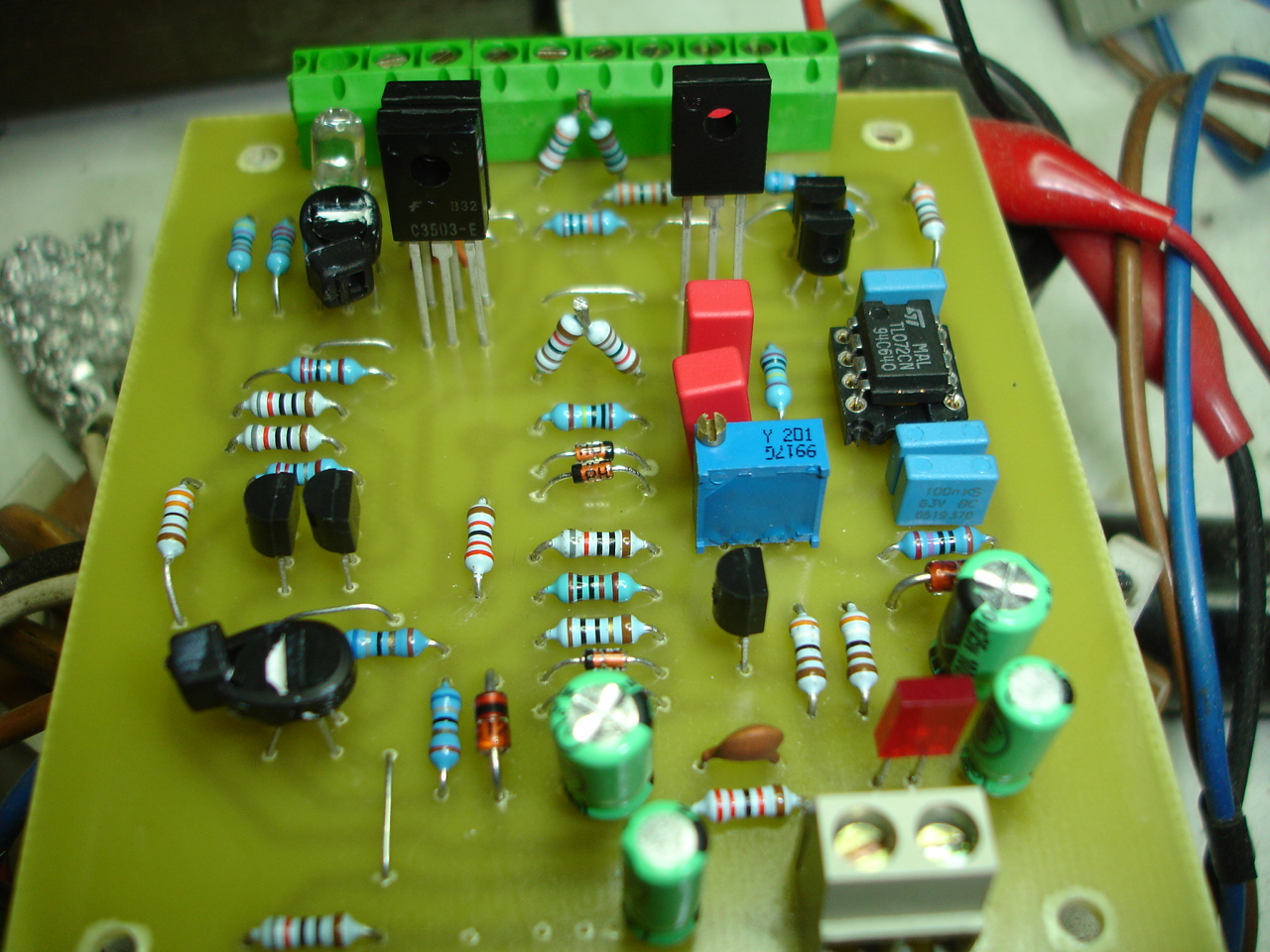

The first SYMASUI is here.
I hope a test is possible tomorrow.

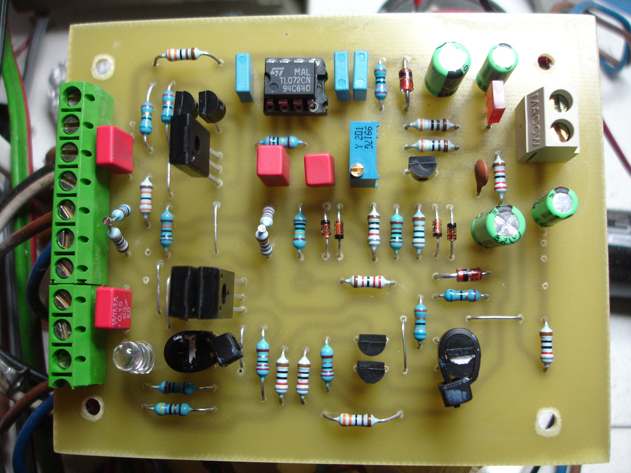

Hi Jason i see your work .Excellent work!Thimios, man, you are a machine!

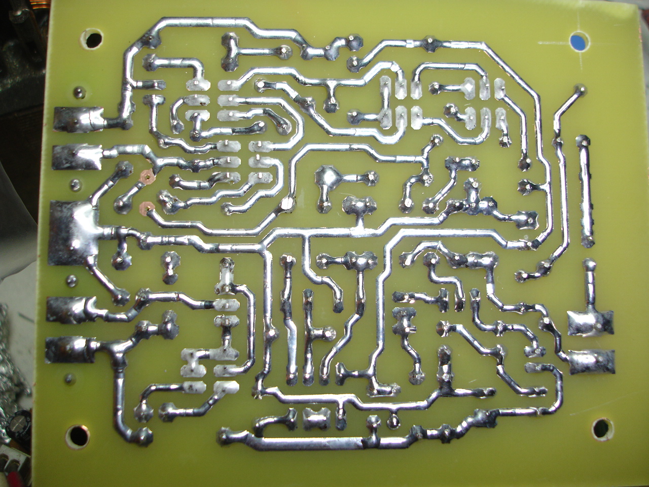

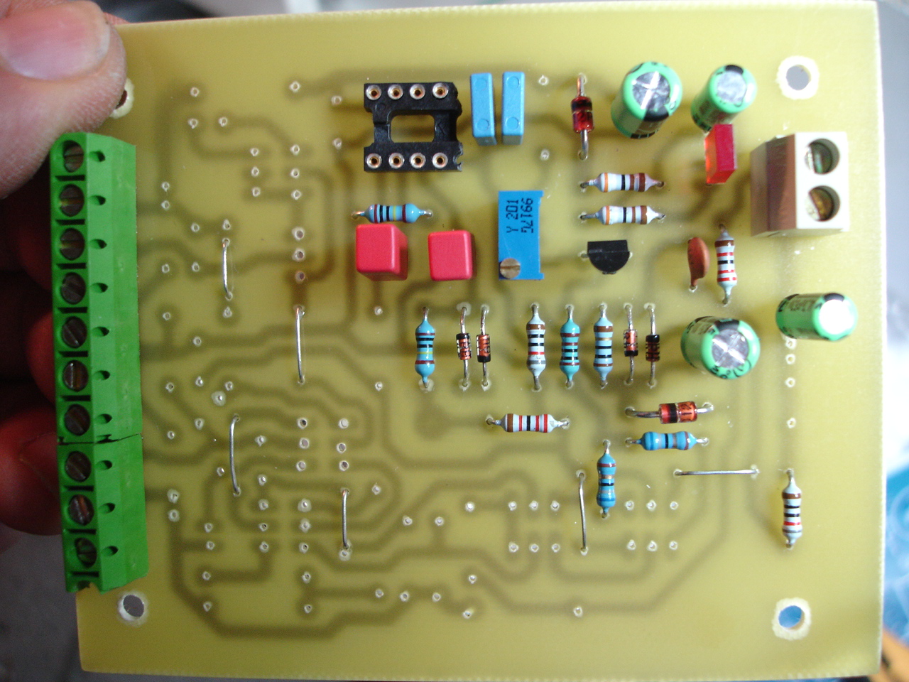

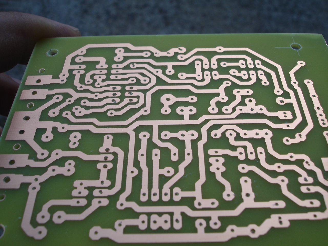

Mine pcb are all home made, not so beautiful as yours.
Hi Thimios,
Looks very good. May I ask which method you are using for making your PCB's?
Thanks,
Mogens
Thanks,
Mogens

OS
Thimios - important !!
C5's polarity is reversed ... positive goes to the regulated
12V rail.
It most likely would not of gone "poof" 😱 but C5 might of got hot.
CCS might not of worked (or low I) ....
Sorry . 😱
Another stinkin' lable error !!! argggg.

Thanks ,please look here.http://www.diyaudio.com/forums/solid-state/221741-dx-blame-st-together-dx-super-116.htmlHi Thimios,
Thanks,
Mogens
post#1152. If you have any question please ask again.
Thimios.

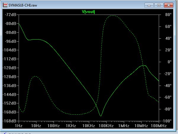

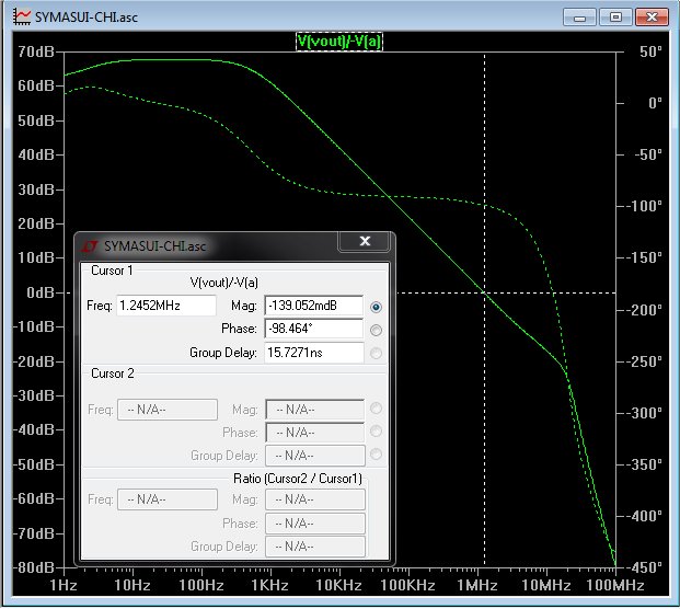

Thimios .... tips !
So you get the very best listening impressions.
C7 = 33p
Clc= 2.7p
Cvs1/2 = 47p
don't make Clc too big .. like 5p (peaking) .. better to be small (2pF)
(below) is the ideal bode with the values above. A VERY
well behaved amp (stability wise)
PS - you can bring this amps unity gain up over 2mhz and it will
still be "well behaved". 😎
(C7 = 22p Clc= 3.3p - 2.1mhz UG)
You can also reduce R9/R10 to 33R for 72db CLG with still ... plenty of
margin .... VERY wide range while being very stable. 🙂
The only way to get any ringing on SW was to go (C7 = <15p) or
to use a forbidden 10p+ for Clc ....
PS - this amps psrr is 20db better than the symasym , as well (below 2). (better than the
blameless ,too)
OS
