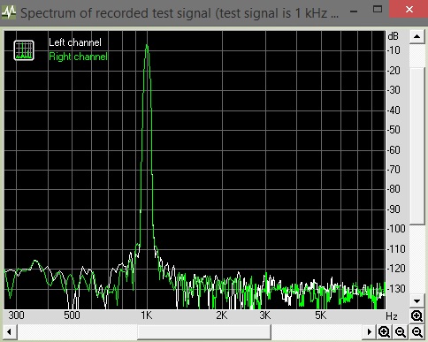

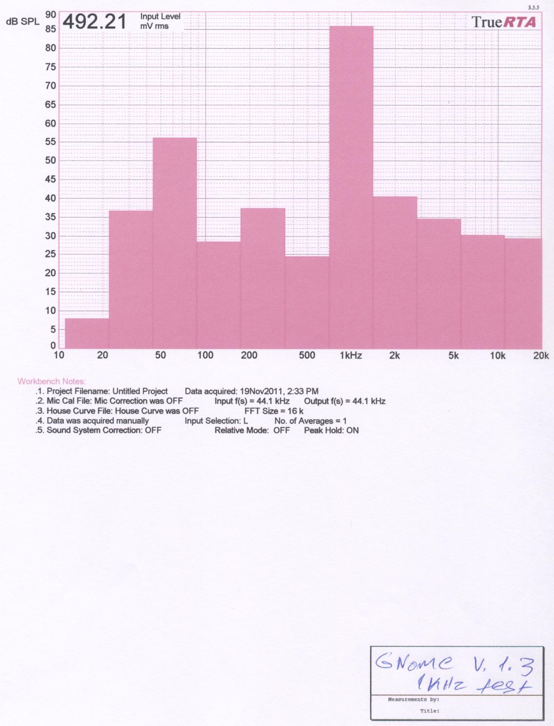

All these are dead silent even the CFA Gnome.
Yes , proper local star ground + lifted input = "dead silent".
Single pair bias would be ideal 60-70ma (14-15mv / .22R).

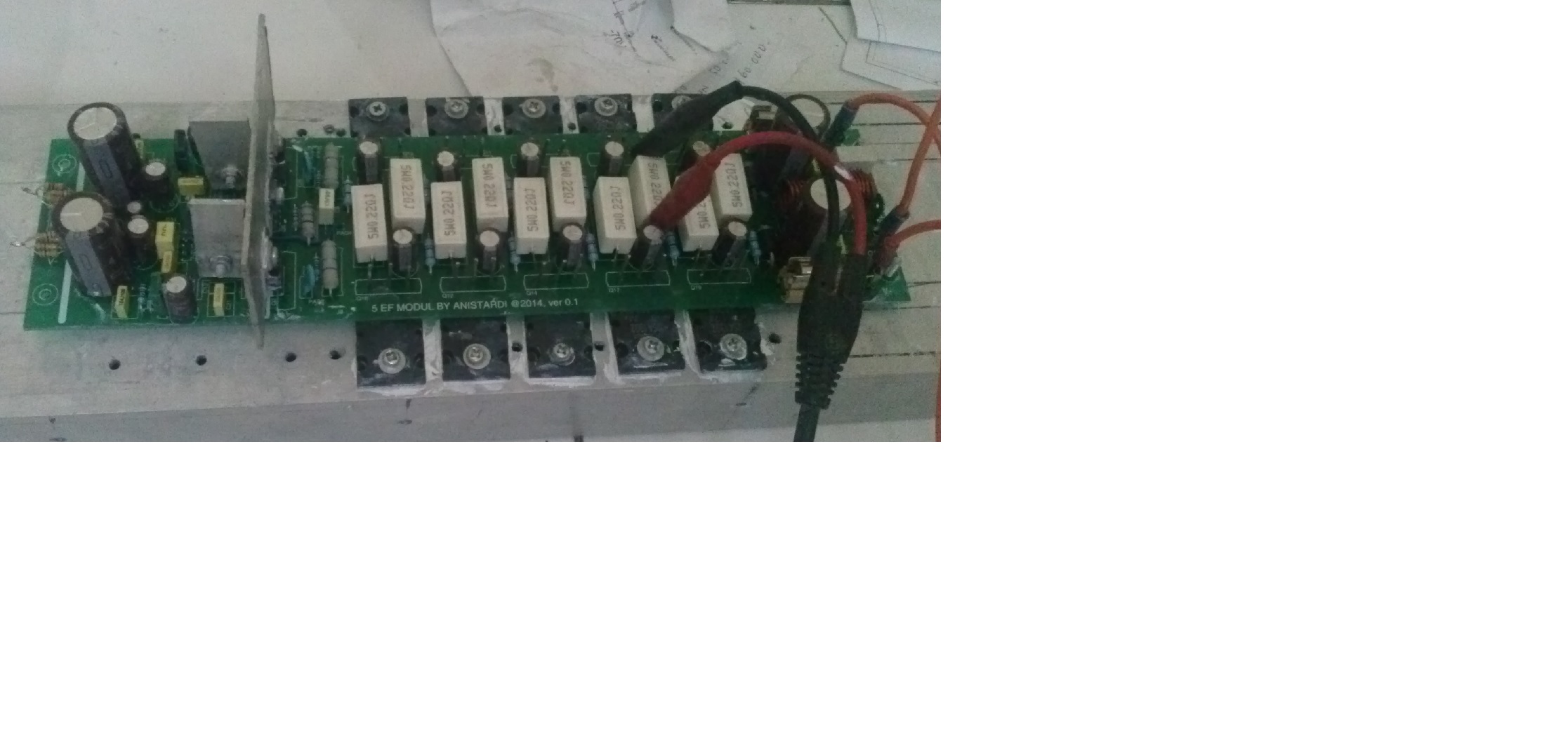

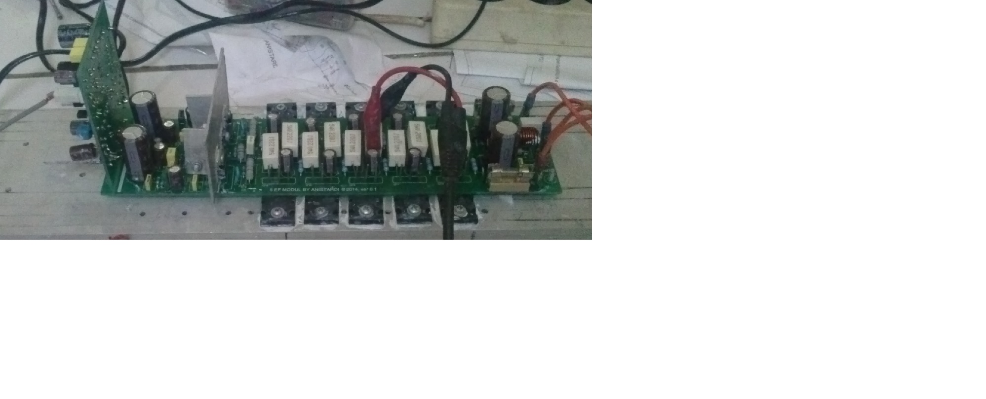

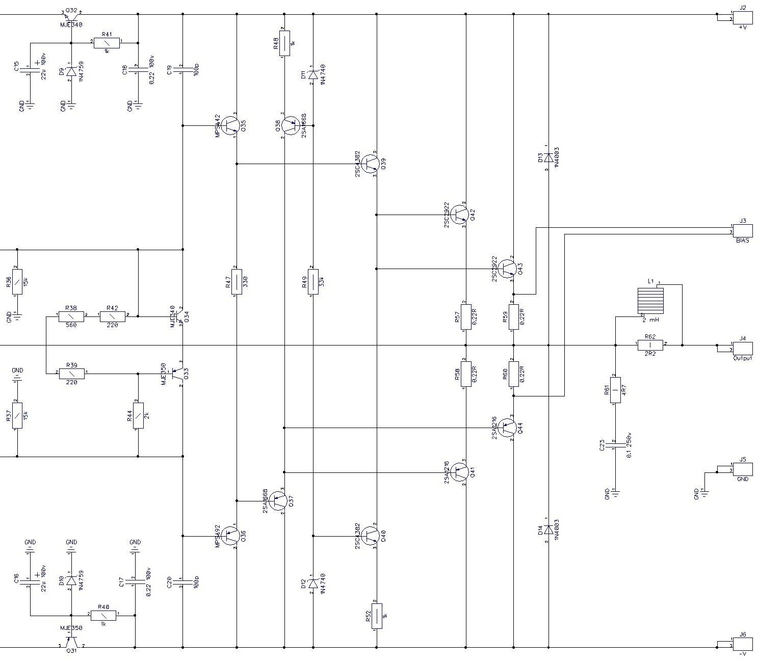

My 5 pairs emitter follower and the complete version.
The IPS is simple VSSA with single VAS transistor.
Listening result:
It is best of amp that I ever built. Better than my VSSA variant . I am using +-63V power supply.
My first CFA with Hawksford cascode is slightly worse in high frequency than my VSSA variant. May be I can not optimize it, not yet.

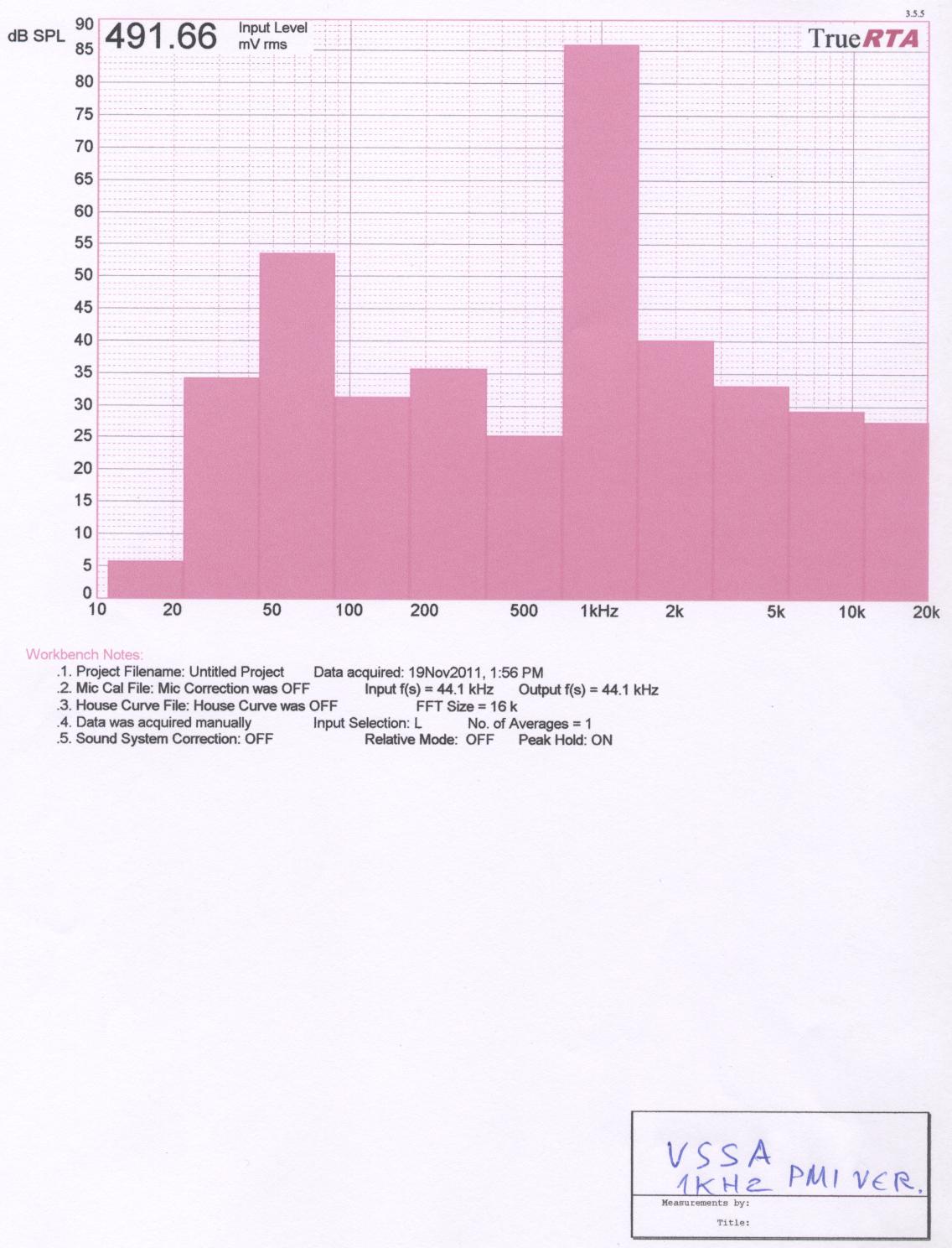

Drivers with CCS load
I have practically tested the OP with class A drivers (loaded with CCSs) within VFA design (see attached OP schematic and overall spectrum).
Sounds very good. I mean - it doesn't sound. Ultra-linear
+/- 80V DC
+/- 80V DC

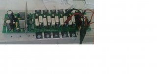

Listening result:
Now I can make thread on headsink using tap .
The simulation result using 3 pairs triple emitter follower at +-70VDC:
Phase Margin = 69
Gain Margin = 9
Slew Rate = 400 V/uS
THD 228Watt rms/8Ohm, 1KHz -> 0.000823%
THD 228Watt rms/8 Ohm, 20KHz -> 0.004953%
Edit: I use some components from my 3 pairs triple emitter follower and from my junk box

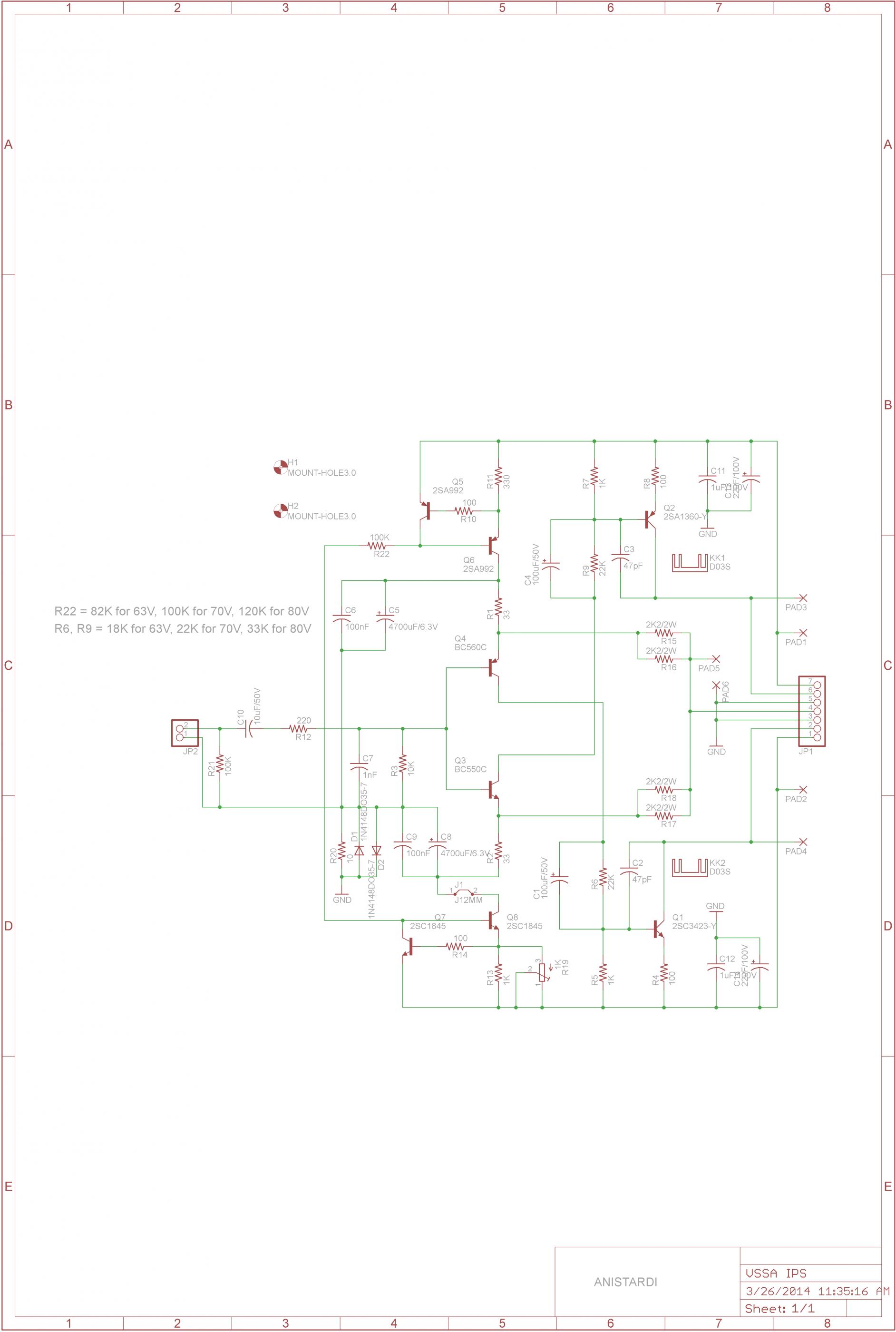

hi bimo, what version of simple VSSA are you using in IPS, is this the CFA-X v1.2? thanks
I use my own design. I only follow Ostripper's OPS design with same contruction but different compensation. Now I run the pre-driver transistor hotter than Ostripper design.
The modular design fit to my need. I want to learn to design audio amplifier.
Dear bimo.
Could you introduce all your IPS module, that allowed you to get the best sound.
Here it is.
