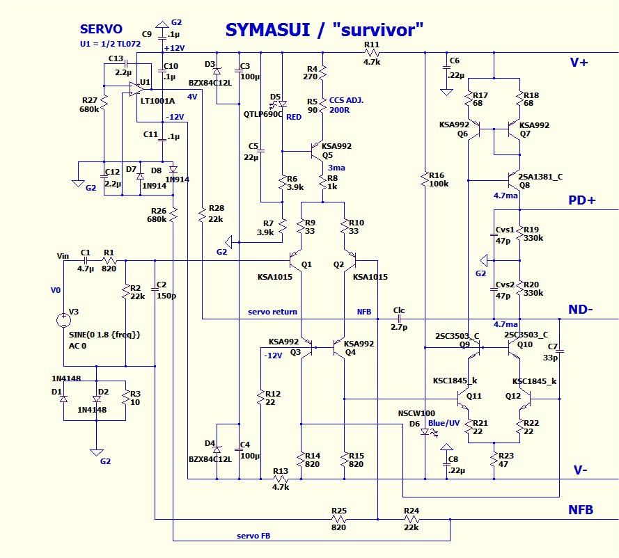

C7 = 33p
Clc= 2.7p
Cvs1/2 = 47p
don't make Clc too big .. like 5p (peaking) .. better to be small (2pF)
(below) is the ideal bode with the values above. A VERY
well behaved amp (stability wise)
PS - you can bring this amps unity gain up over 2mhz and it will
still be "well behaved". 😎
(C7 = 22p Clc= 3.3p - 2.1mhz UG)
You can also reduce R9/R10 to 33R for 72db CLG with still ... plenty of
margin .... VERY wide range while being very stable. 🙂
The only way to get any ringing on SW was to go (C7 = <15p) or
to use a forbidden 10p+ for Clc ....

You can start with just C7 ... you will have a "ampslab" basic amp (or a
REAL big NE5532) 😀.
Add the Clc/Cvs later .... they "mold" the sonic signature. (FFT says so).

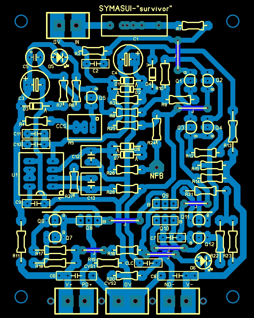

R26,R27=1M
C9,C10=1uf Is this ok?
Is it possible give some current(mA)measurements for Ltp and VAS ,so i can trim?
Exactly 3V (3ma) across R8 will give 4.8ma VAS current.
Depending on your rail voltage , R11 and 13 might also need adjustment
to supply the "hungry" 😀 zeners with enough current.
C9/10 ?? (11?) any reasonable value will be good for the local IC decoupling.
PS- so we are on the same page ... I made labeling mistakes early on.
(below is the latest).
OS

I mean 1uf in place of these 2u2.Exactly 3V (3ma) across R8 will give 4.8ma VAS current.
OS
1uf in place C12,C13?
R26,R27=1M?
That what I changed ... the servo caps ...
Yes ! 1 meg / 1uf will bring you close to the .2-.3Hz servo fc. Good !
(actually .5hz ... but still good).

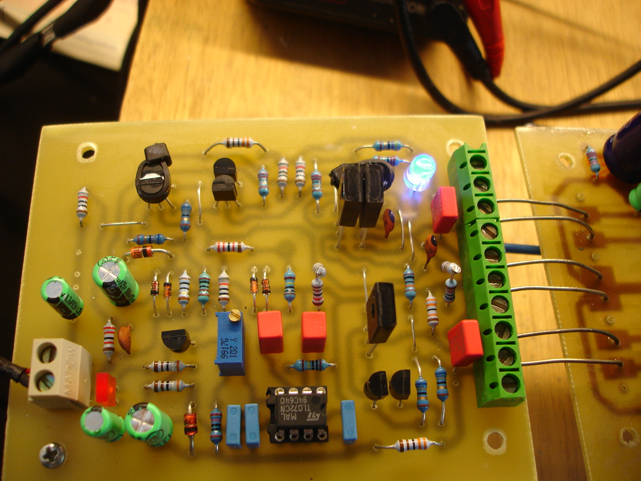

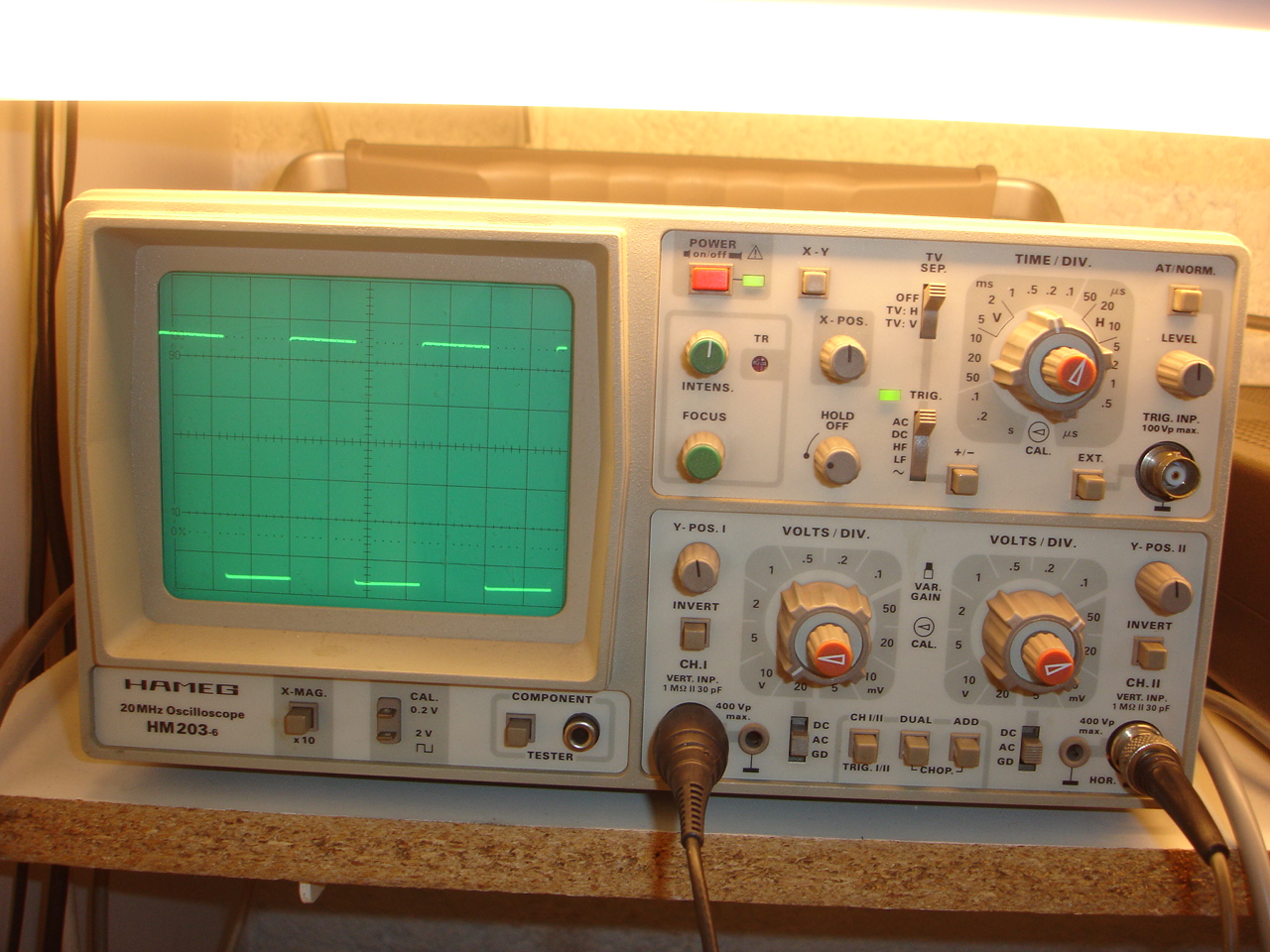

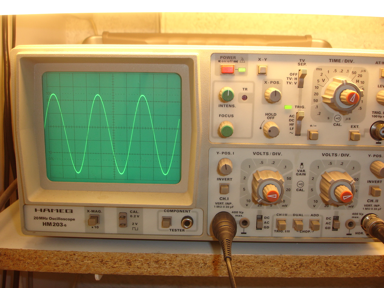

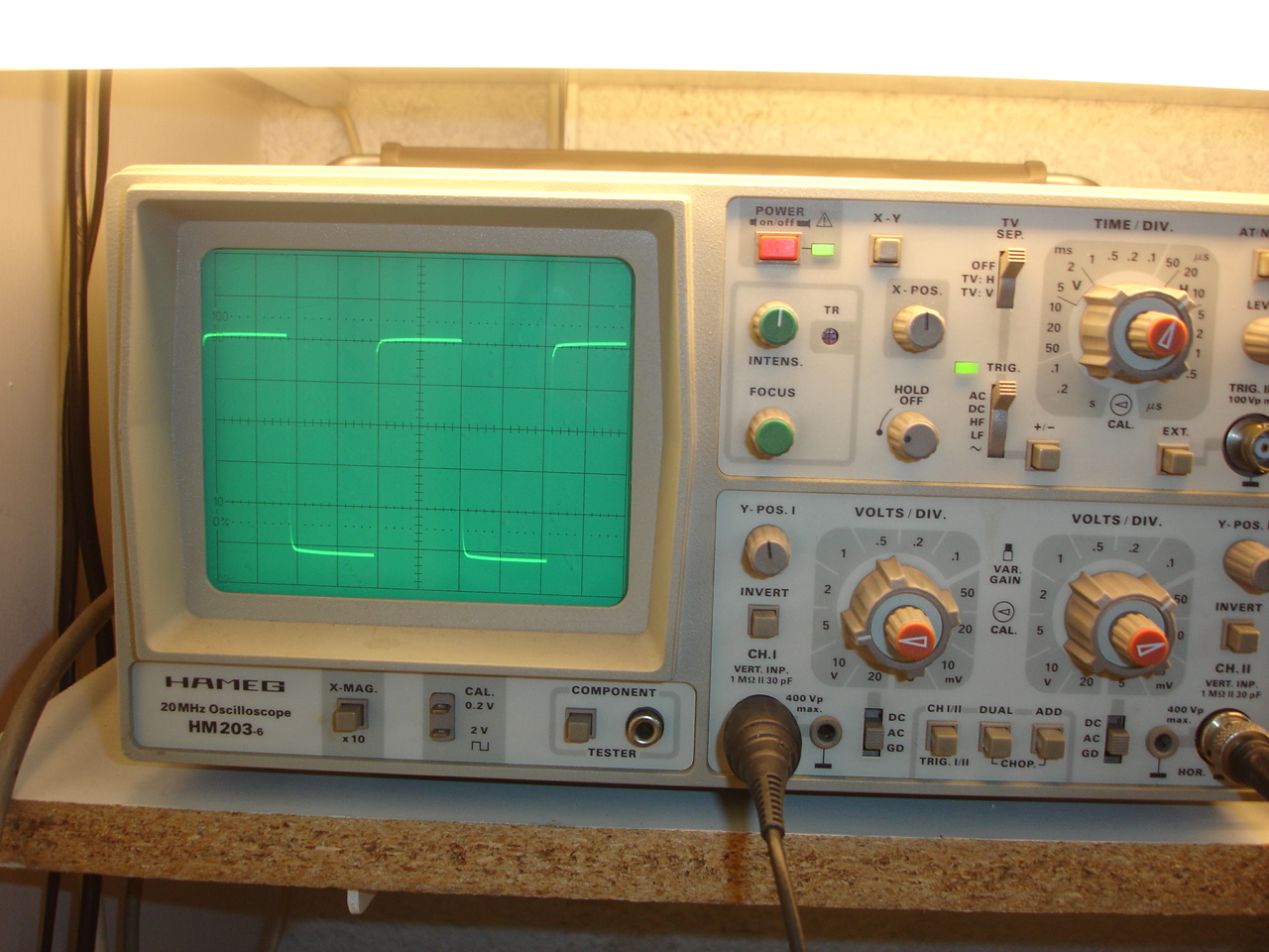

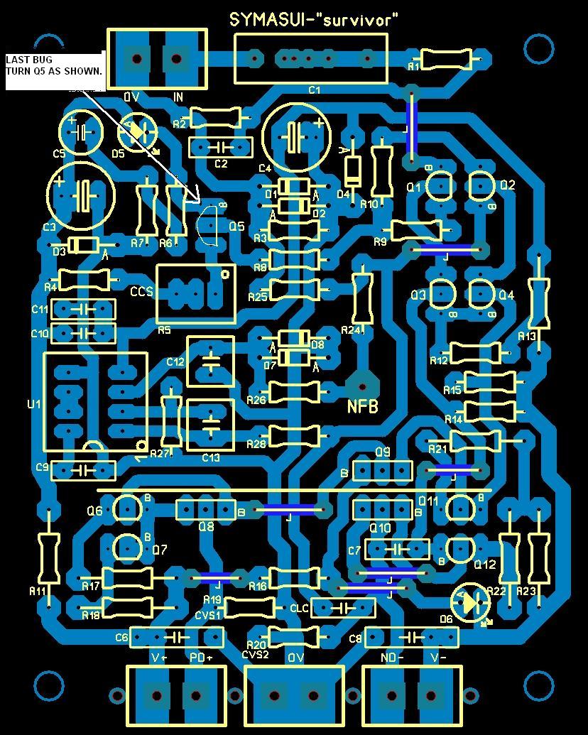

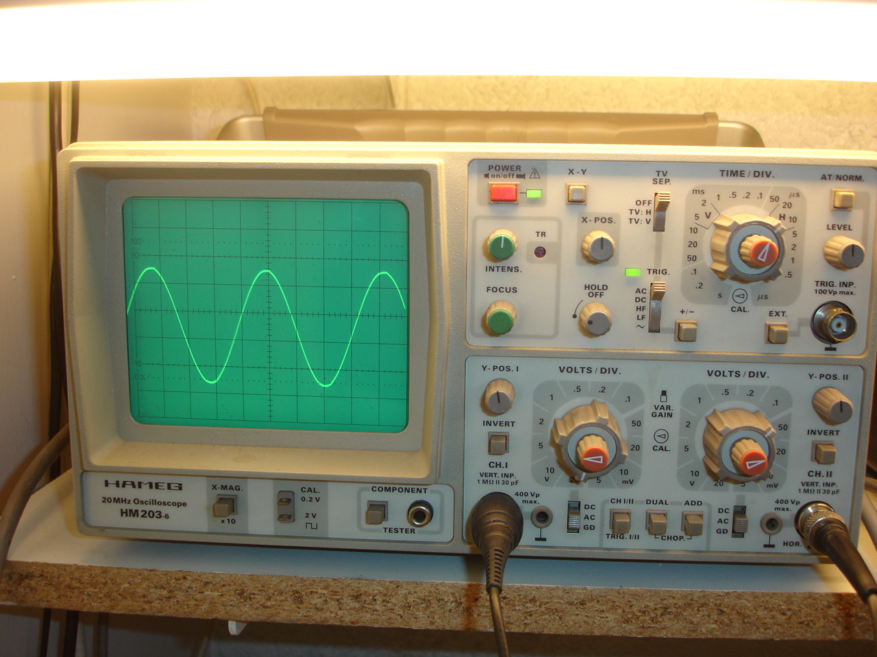

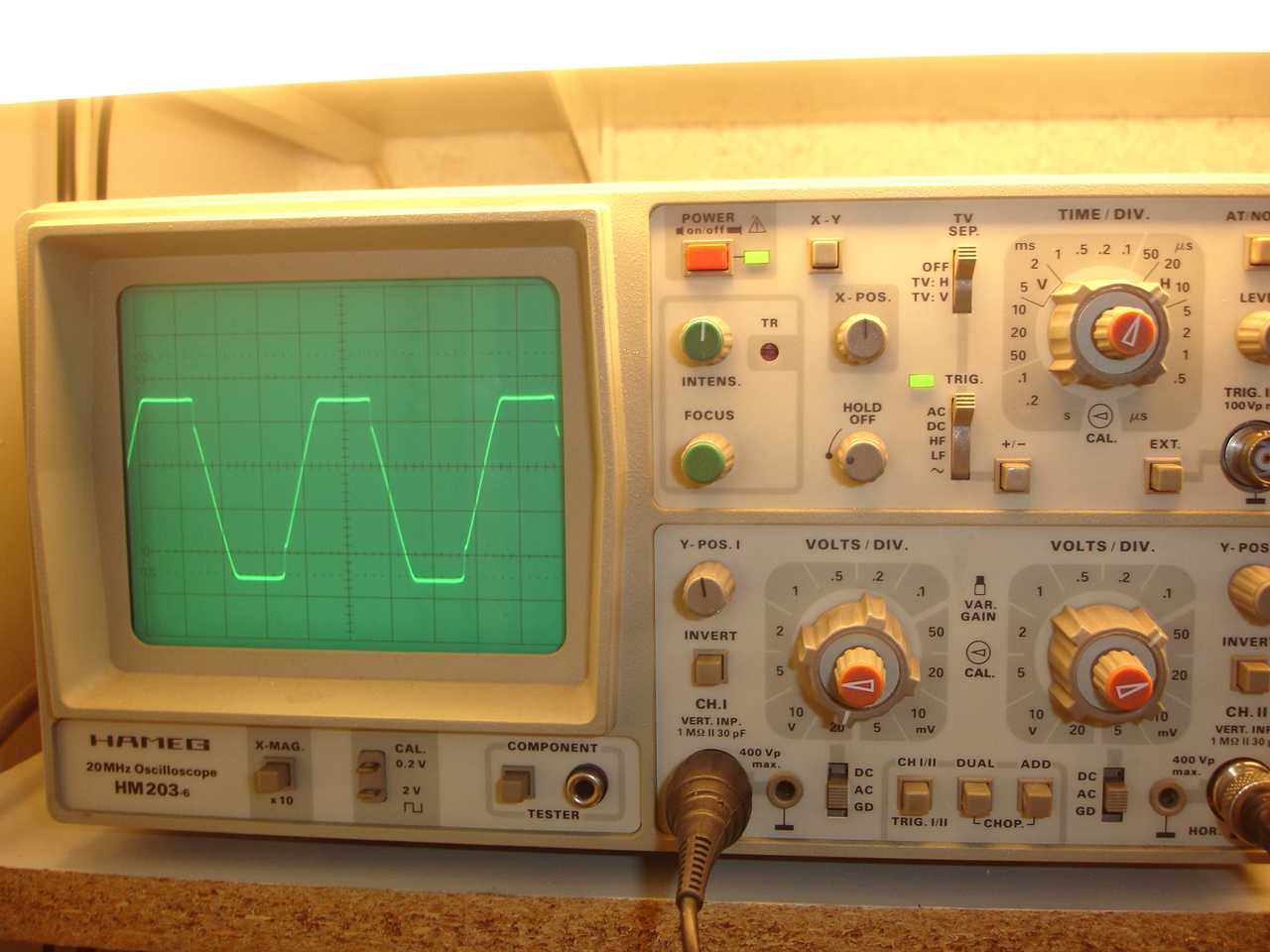

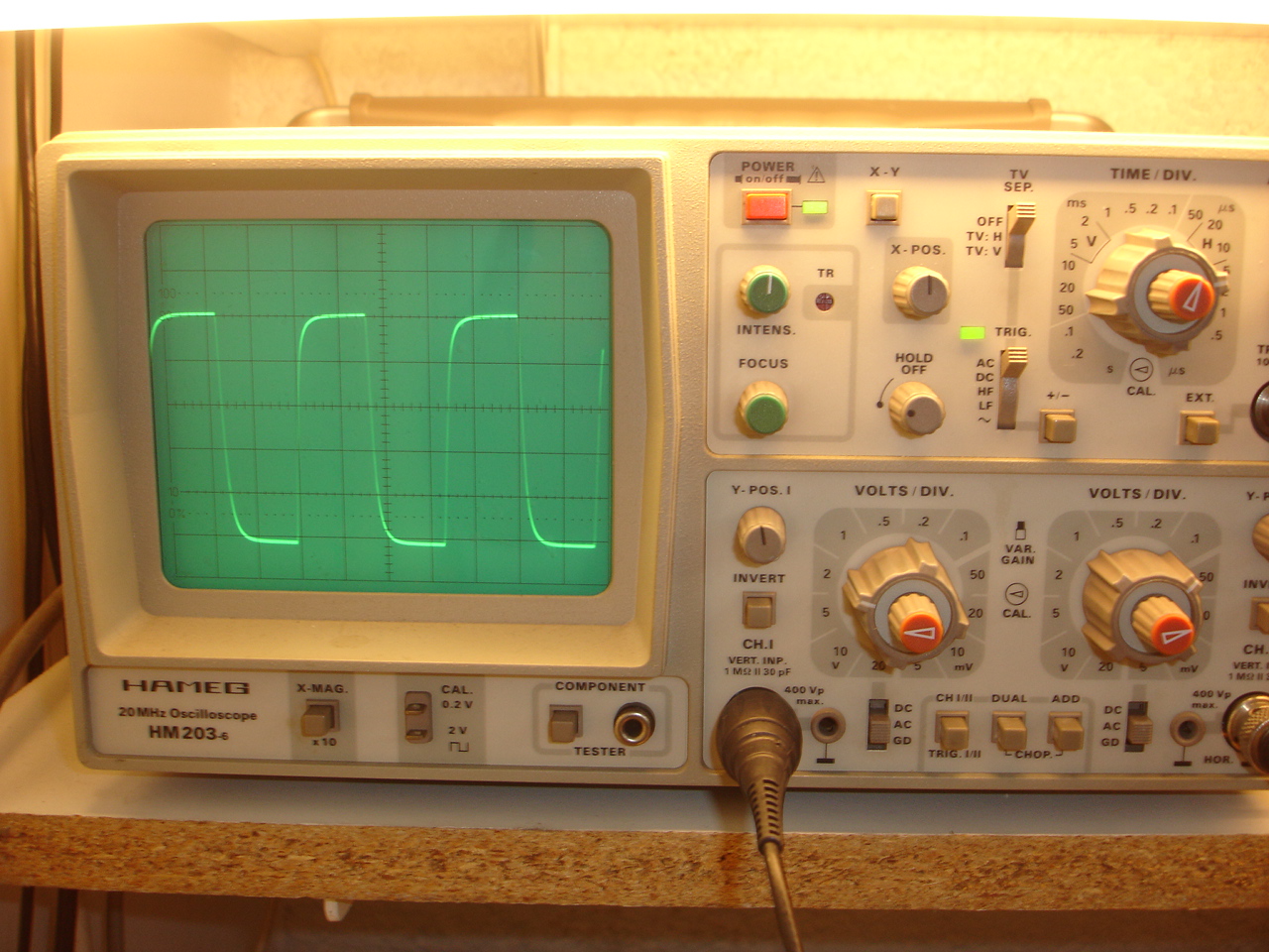

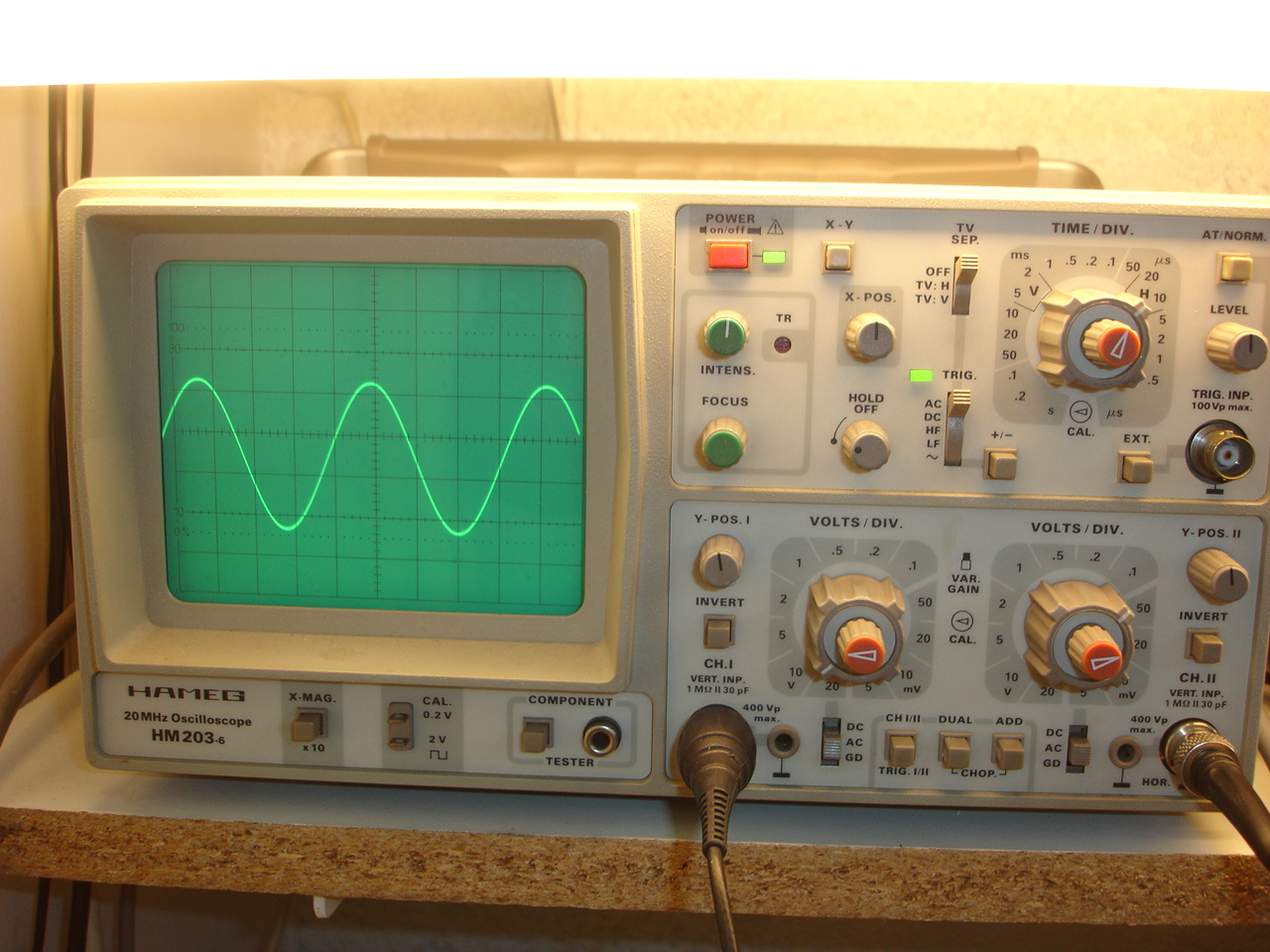

OS,we have a last bug.
Q5 must turn as in picture.
Now it's time for test.
See measurments on shematic

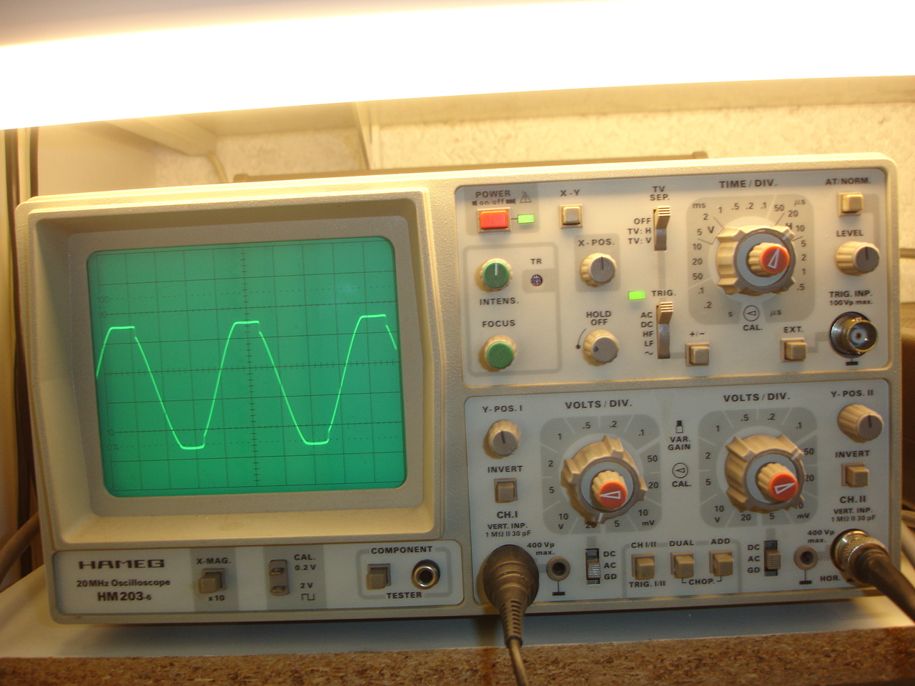

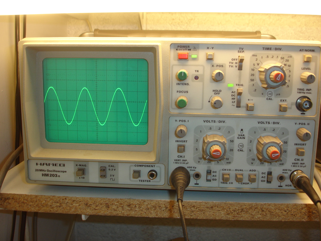

photos.
1)1KHz/12vRMS/8R
2)10KHz/12V RMS/8R
3)20KHz/12V RMS/8R
4)20KHz/27V RMS/8R just before clipping.
5)20KHz clipping /29V RMS out/8R
6)20KHz hard clipping/31V out/8R

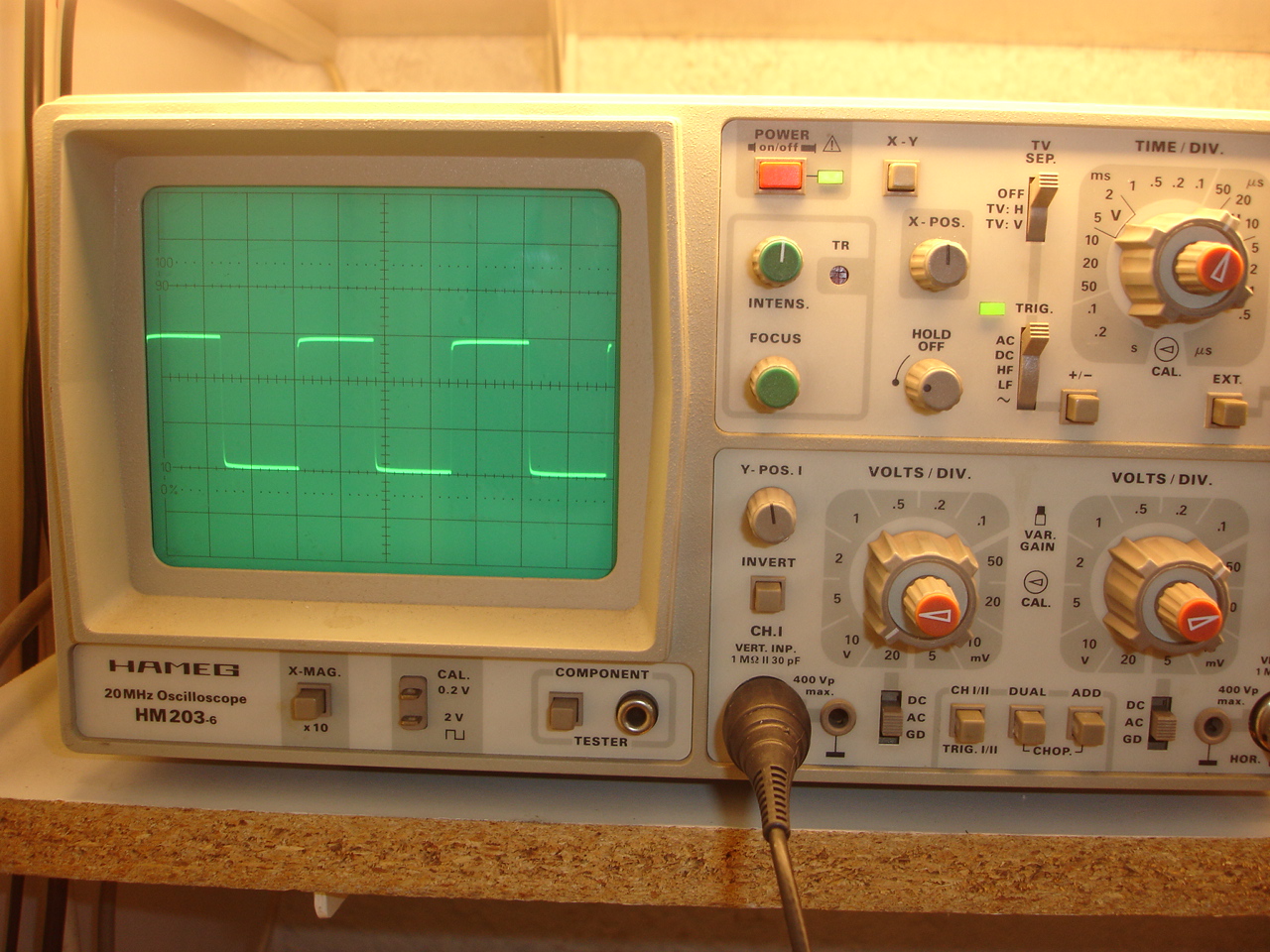

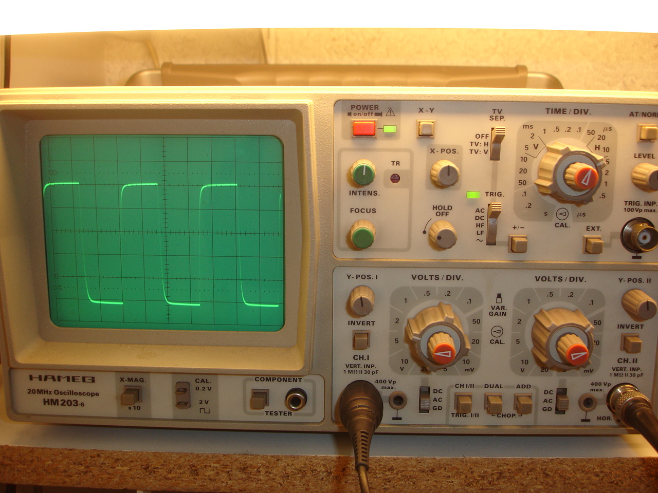

SQUAREWAVE
7)1KHz 28V OUT/8R
8)10KHz out 13V/8R
9)20KHz
photos.
1)1KHz/12vRMS/8R
2)10KHz/12V RMS/8R
3)20KHz/12V RMS/8R
SQUAREWAVE
7)1KHz 28V OUT/8R
8)10KHz out 13V/8R
9)20KHz

1)50KHz
2)100KHz
-3db doun to 2.8Hz
up to 200KHz (tested at 20v RMS) (-3db 14.4v)

The first fire up is good .pull out the servo and measure , if measure big value of volt its nesesery to match the LTP and you get more sound detail .

Very good !
I do notice "sticking" on clip. Try increasing main VAS cascode LED current
(R16)... try 33-47K here (>2+ma led I).
Square wave is excellent ... this amp has the "slew" !
OS
