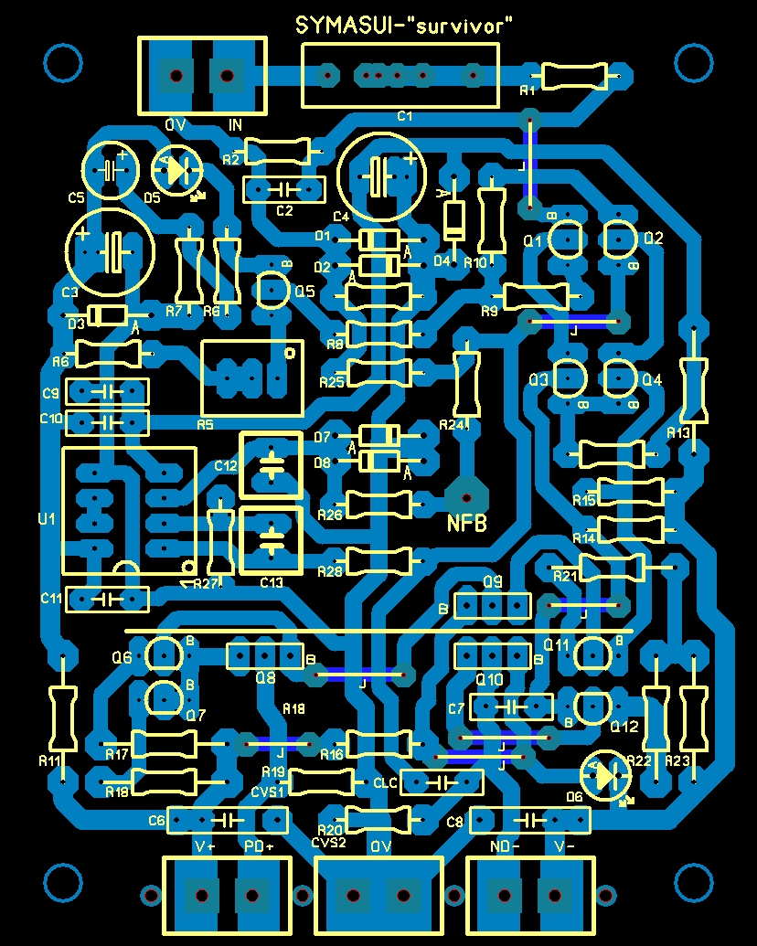

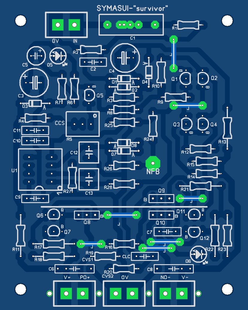

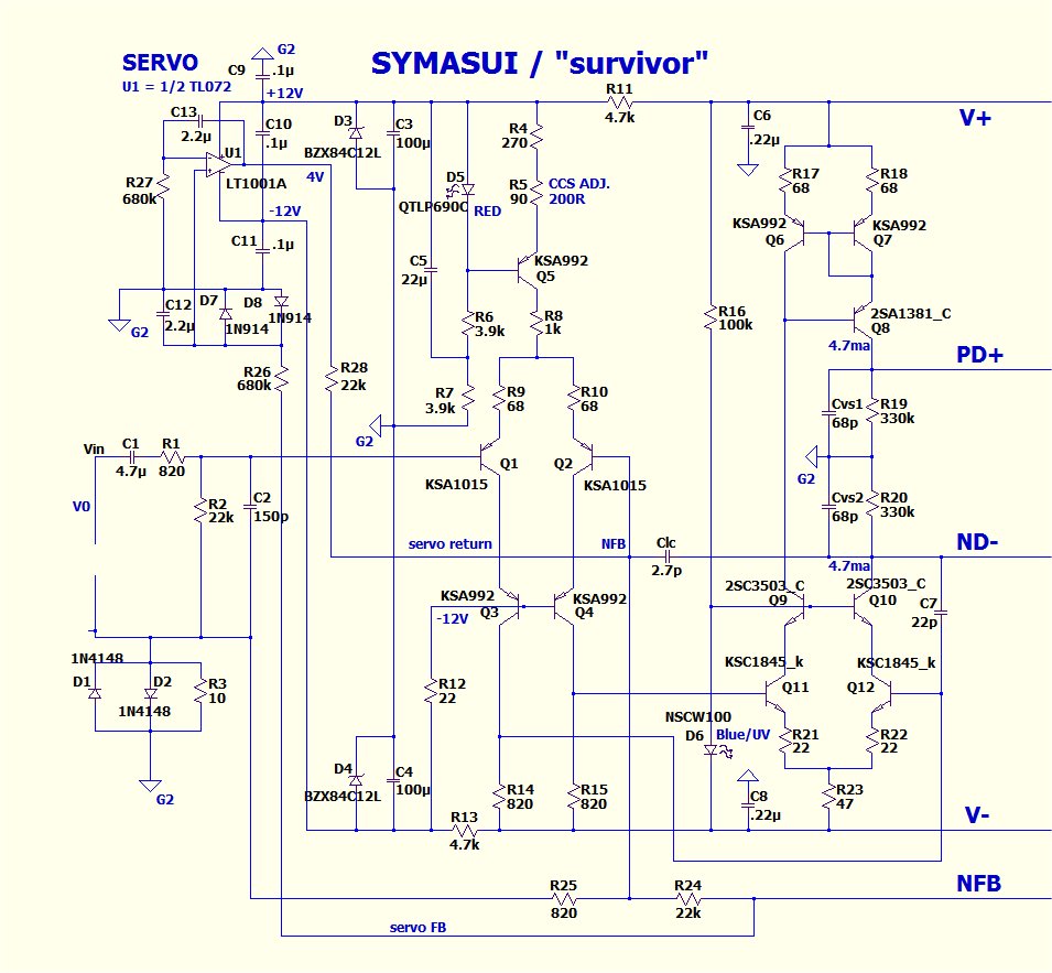

No , but there is the finished "SYMasui" .

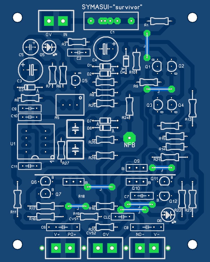

Finally have it done ! 😱
(below 1/2) is the "pretty " PCB.

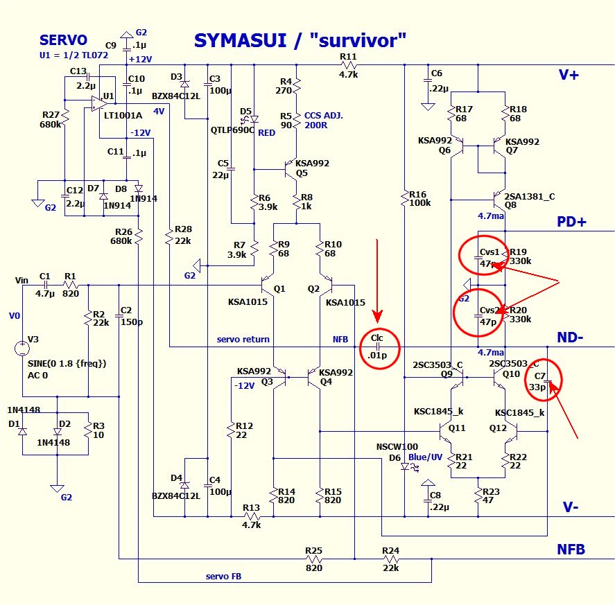

(below 3) is the schema it came from.
Went back to the standard symasym , more stable. Added the capacitive
shunts like the original .... they bring the THD harmonics right in line with the
original project. These are all optional , of course ... the IPS will run
perfectly with just one compensation cap.
But ... this amp "buries" the original in every other way. 😎
Will release the whole package after "proofing" 😱 .

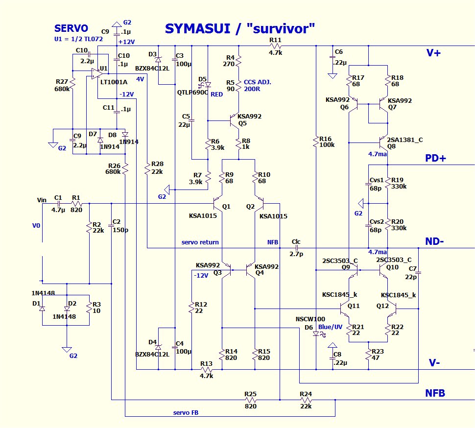

found 3 mistakes already (I think that's it) D4 reversed and wrong/mislabeled
servo caps. Fixed (below).
I don't know .. Carl , I might take a break ... refine/debug these 3 main amps -
(gnome/spooky/symasui).
PS- .asc for error hunting below , as well.

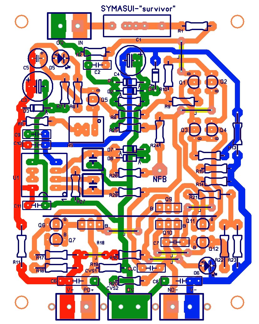

Well ... here it is !
(attached ) is the "package" (debugged).
Let me explain it. M. Bittners "symasym" uses the Otala style VAS (CM +
differential) with a simple LTP input pair ...
he then adds adds R/C shunt compensation to the VAS's output.
I simulated the original side by side with my design.
Cvs1/Cvs2 (below 1 schema) , reduces total closed loop gain and lowers the
UG. The "side effect" of this reduces H3/5/7 even more ... but increases
H2/4. My design can compensate by adding a small amount of lead
compensation (Clc ... 2.2-2.7pF) , thus allowing the reduction of Cdom (C7).
This increases the UG point and slew rate back to where we started.
Bittner used 100K/330pF for his shunts. My design has 5X the impedance
(cascode/wilson)and drives an EF3 .... 330K/47pF, accomplishes the same task.
In the end , I simulated the original and mine - both had the same FFT. Should
sound almost the same.
What is different , most of my devices can be low voltage ... except
for Q3-4 /Q8,9,10 (regulated front end). THD is 1/5th the symasym (5ppm) at
60V p-p and 20 at 120V.
It can also go where the symasym can't ... just like the spooky , 150V p-p
is EASY for this IPS @ 25ppm.
NOT the same hawksford VAS , Not a symmetrical design (despite the name).
This should have a totally different "character" than the balanced IPS's.
The FFT says so .
-Balanced = cancellation of H2 /4 ... even harmonics.
-unbalanced (this amp)= almost no H3/5/7 ... odds are gone.
PSRR is also -110db or better across the audio spectrum.
PS - Cvs1/2 and Clc are totally OPTIONAL. IPS will run happily on just C7 (33-47pF).
OS
