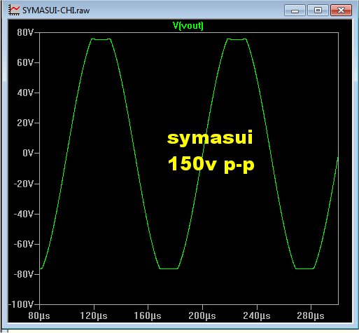

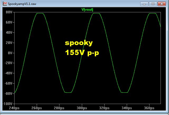

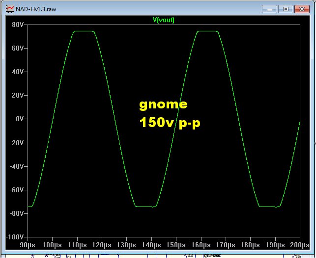

These amps don't saturate/stick and misbehave on clip (don't need no stinkin' clamps). 😀
(below 1 , 2 , 3) Gnome - spooky - symasui ... (85V all)
40ppm , 20ppm , sym is at 6ppm (125Vp-p) !! 😎

Clip away.
PS - this would be your "max headroom" with 85v rails .. BTW.

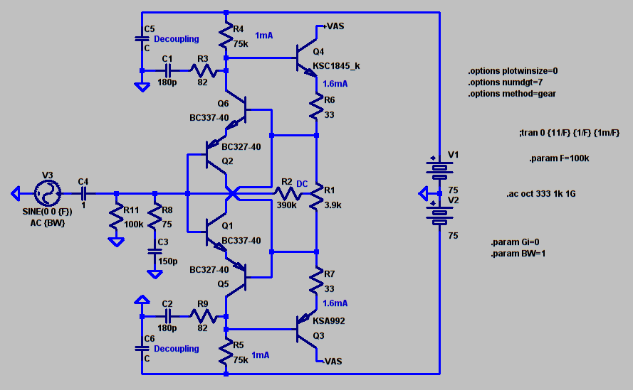

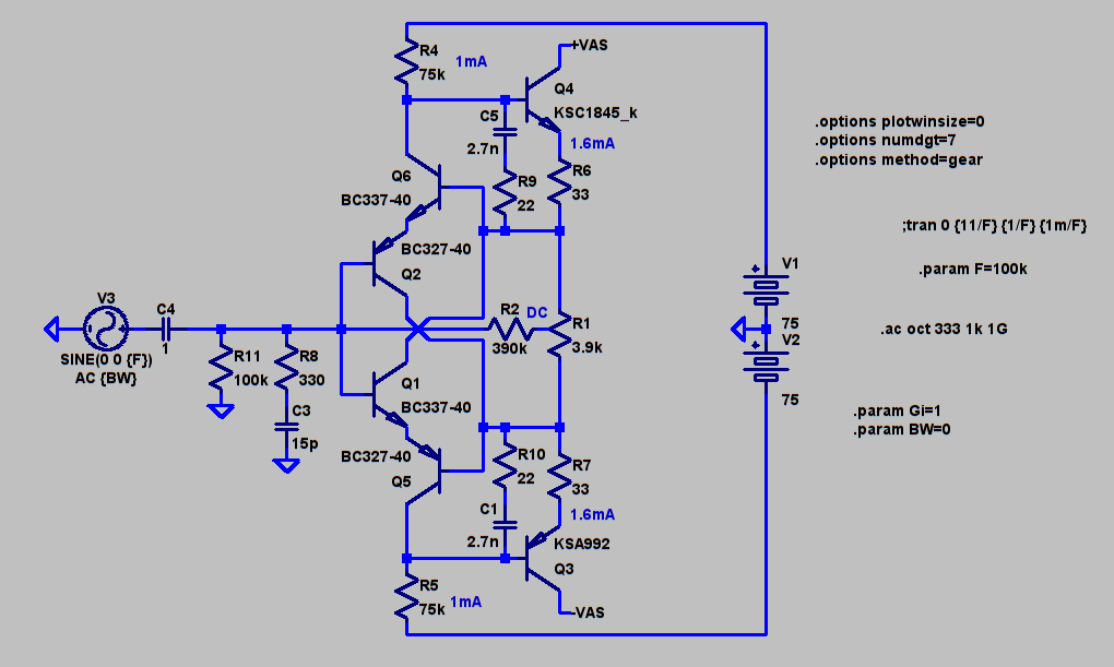

Here's a version for higher voltage rails and better compensation. You may have already done it mostly, but this compensation should work better. Also shown is decoupling/comp wiring for best stability.
The drawback of this compensation is that the input RC gets bigger. This RC is needed for stability with inductive sources, so worry about it only at the end when you start to test with source impedances higher than 50 ohms.

Okay, that last schematic was very wrong. Let me try that again. Sorry for any confusion. Here are schematics with both compensation methods, in case one doesn't work. I prefer the first in terms of numbers. They are both for 75V rails.
The bases of Q5 and Q6 are the NFB points.
How does that work without shorting them together?

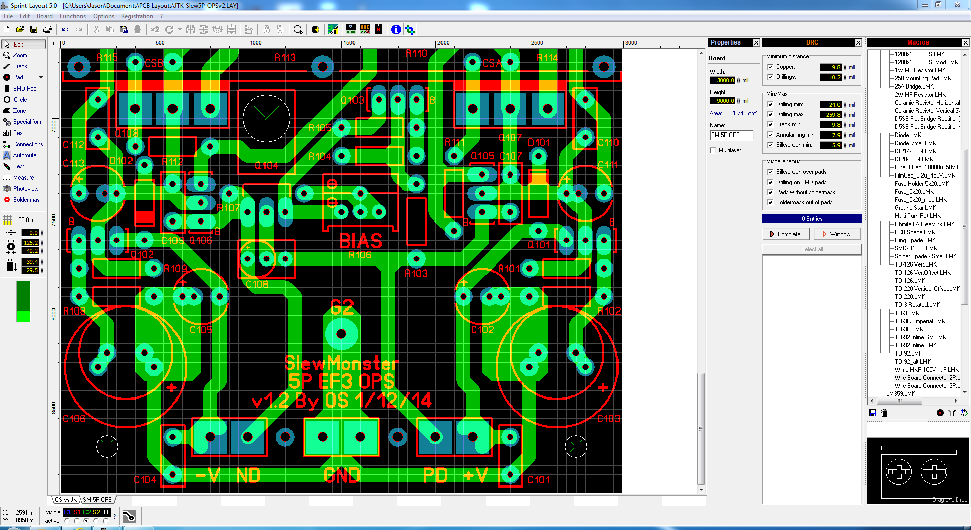

Got to thinking about the availability of the specified component values for running the Monster at HV rails, meaning 100V capacitors. I couldn't find much available in a 12.5mm can for the 470µF cap for the CM. I have pushed and pulled a little to allow for 16mmø 7.5mm LS caps there. Any thoughts?
Like this:
