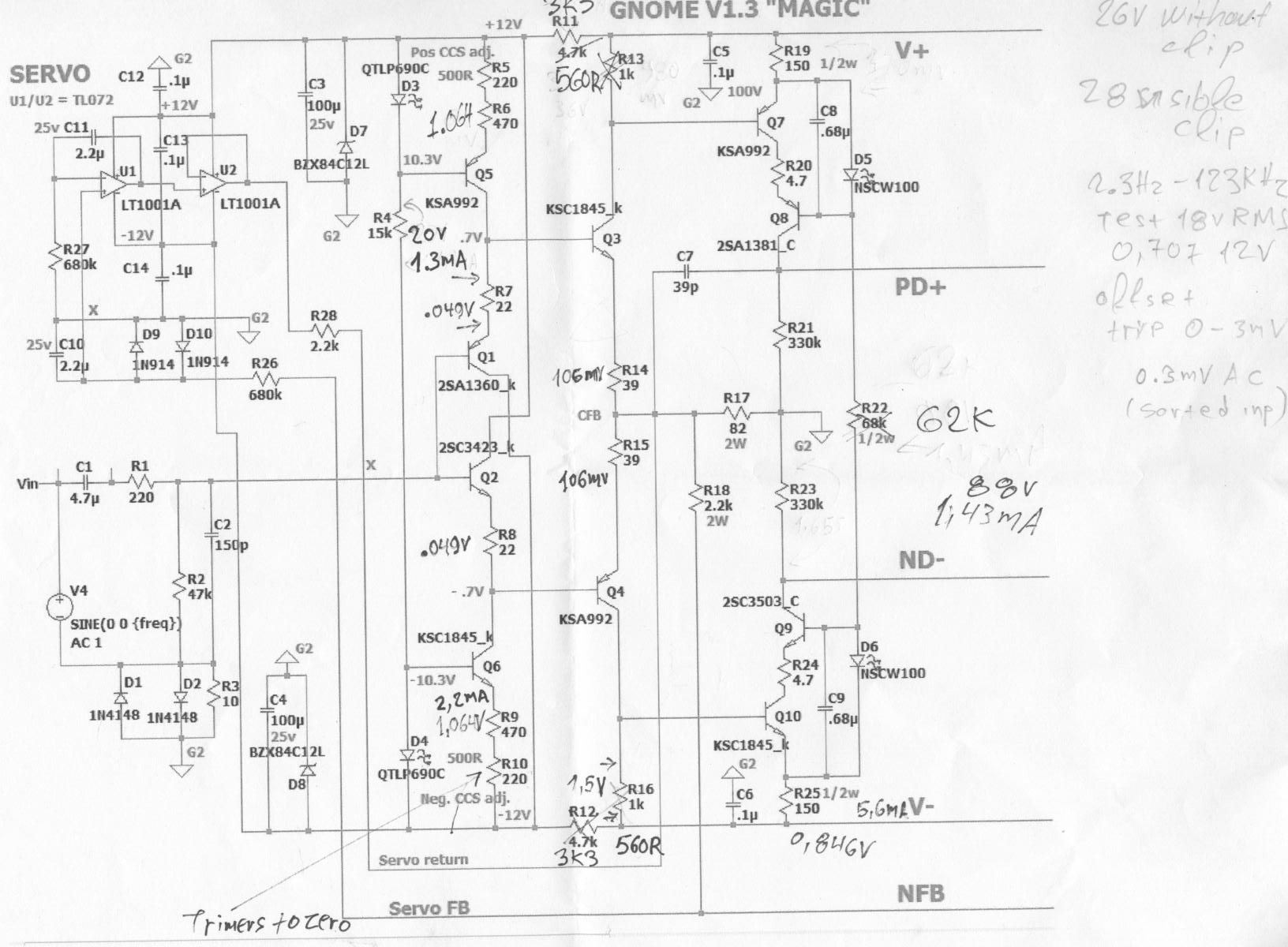

You DO need to have a higher wattage FB resistor( R17).

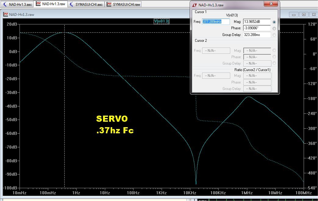

To make you happy .... If you only have 1u for the servo caps (C10/11)
(you have some mounted below) , increase R26-27 to 1meg.
With 1meg/1uf = .37hz Fc , still good to go.

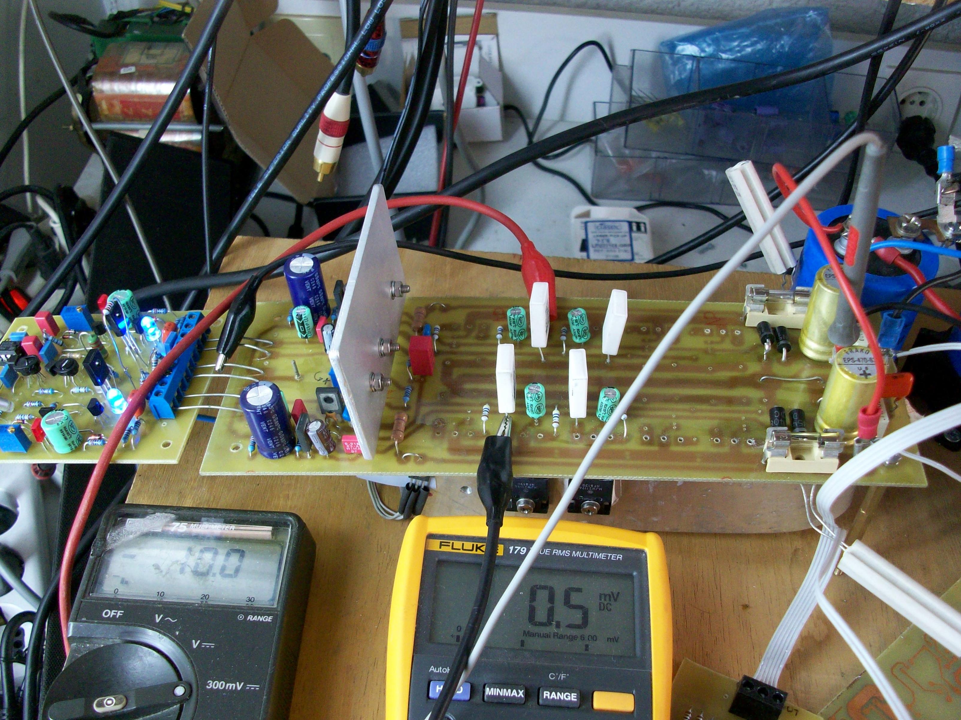

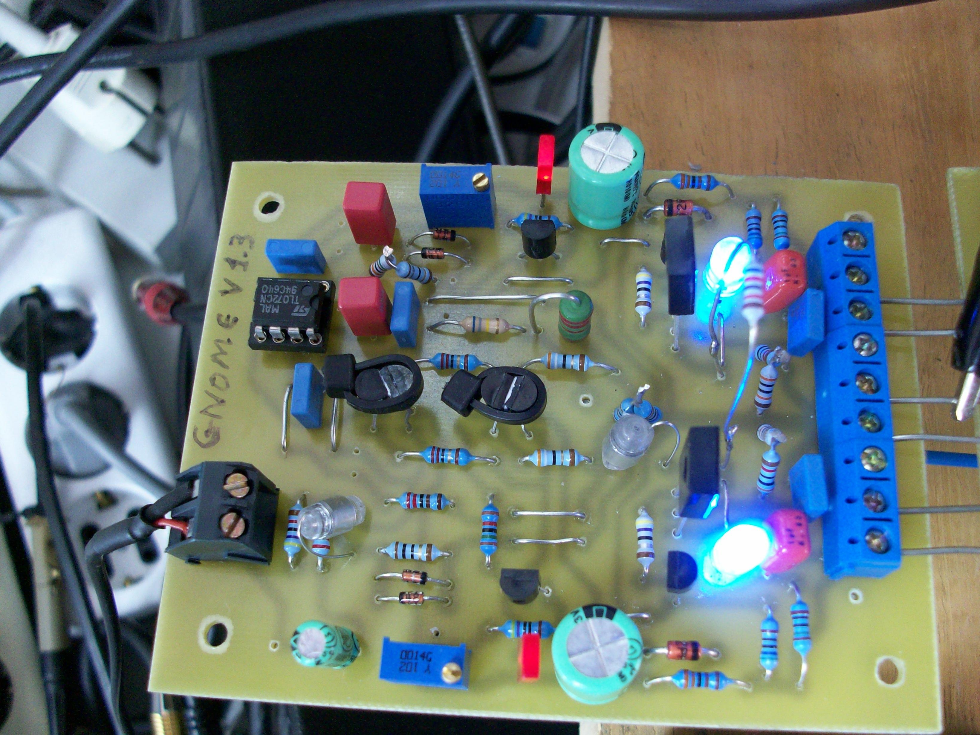

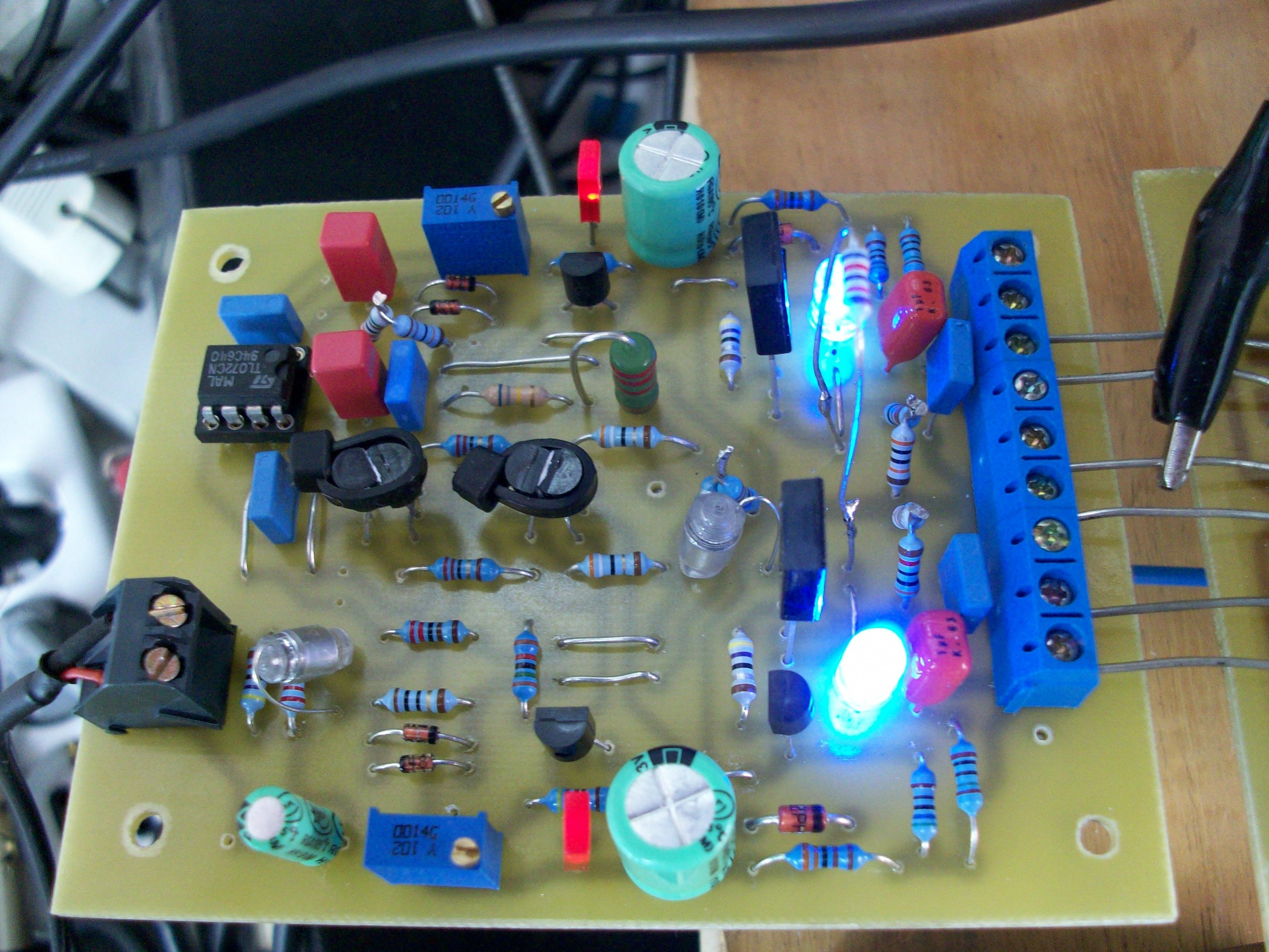

Gnome V1.3 first try.
Some resistors must be changed values ,my opinion.
OS, here you are the Boss.😉
Yes , maybe 680-820R for R13/16. With the new trimmers , R5/R10 ....
If you make the "safety" resistors small (R6/9 - 330R) , R5/10 should
give you a wide range of input device current allowing you to set your VAS
current perfectly ! 😎
Good to see the .5mv servo controlled DC value !
Also , with the trimmers , feel free to bias those VAS leds to taste
( 33k - 68k).
PS - I design at 70-85V , you build at 40-50V .... so , there will be some
variation (R11-12 -zener regs.)
Good work !!
OS
