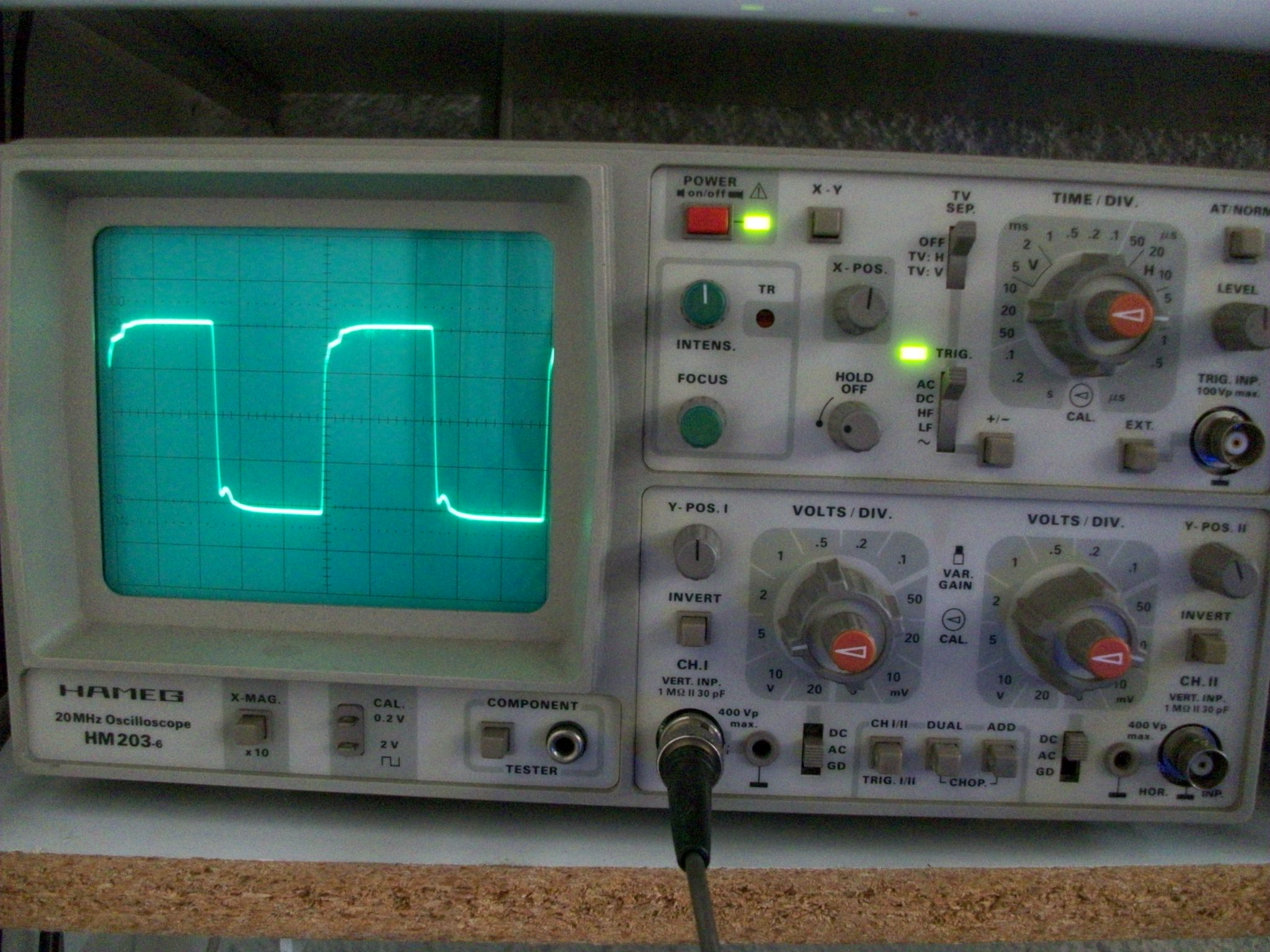

Measurments after updates.
The instability remain.
Amplifier oscillates after clipping also, (sinusoidal wave test)
I measure 2mv A.C on out even when input is sorted but can't hear any noise from speaker.
Check your C7 , on your 1.2 you used a ceramic 33p ... I don't know
what clear/silver cap you have now ?
If that don't work , reduce (or remove/jumper) R20/24 ... you
then basically have V1.2 again (except for inv. servo).
That 2 mv ac is oscillation at very HF. Does the OPS zobel get warm ?

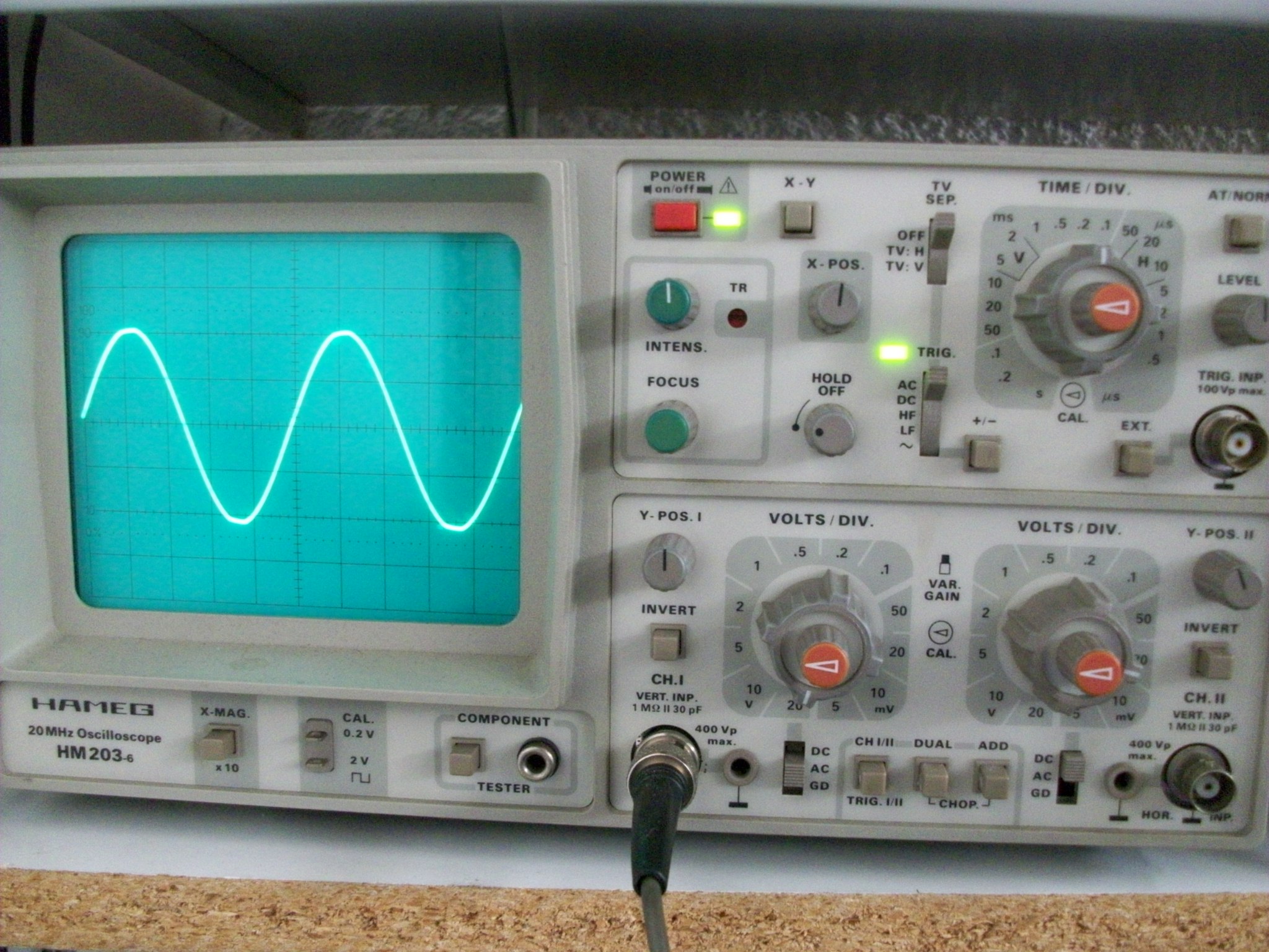

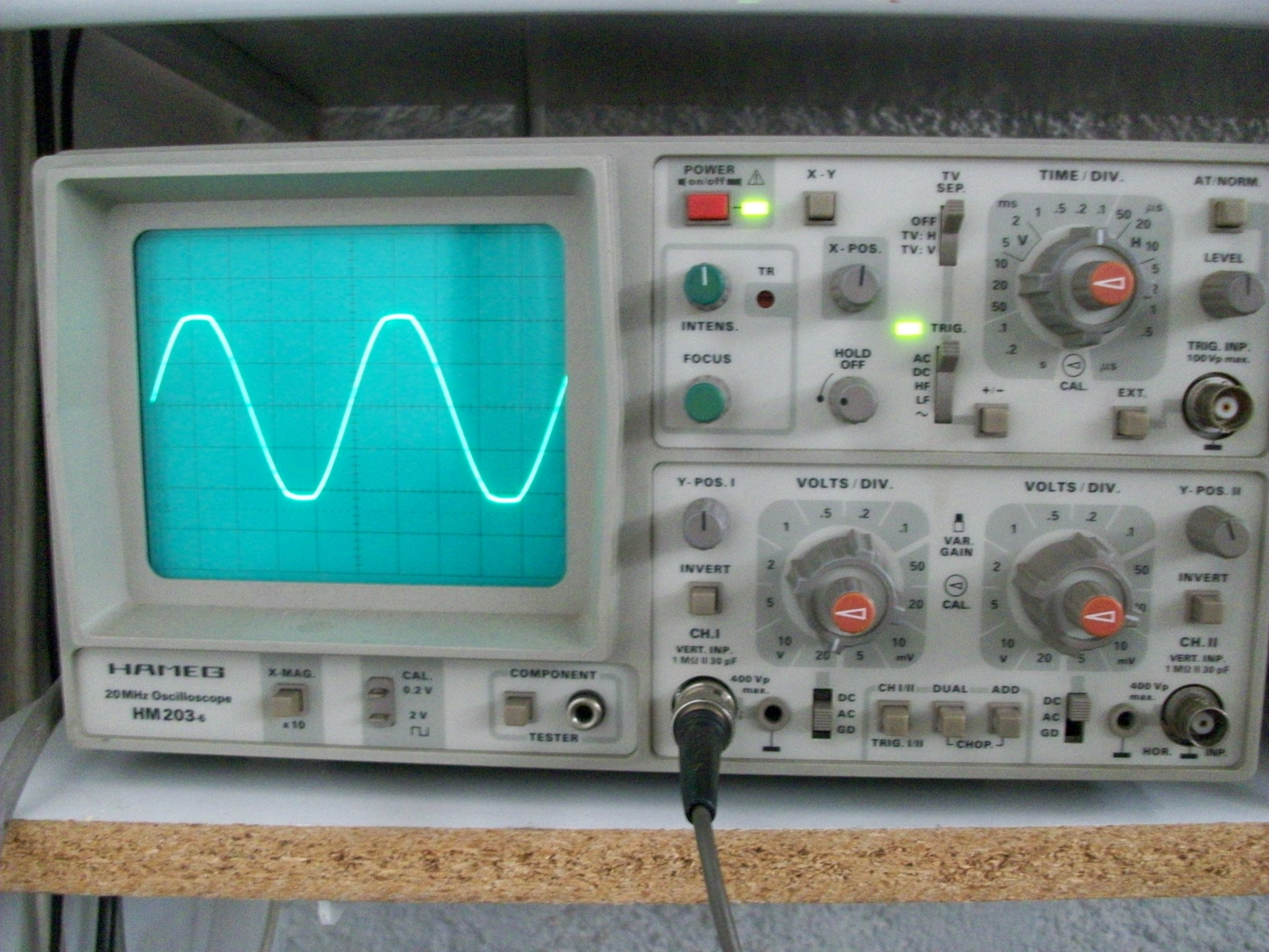

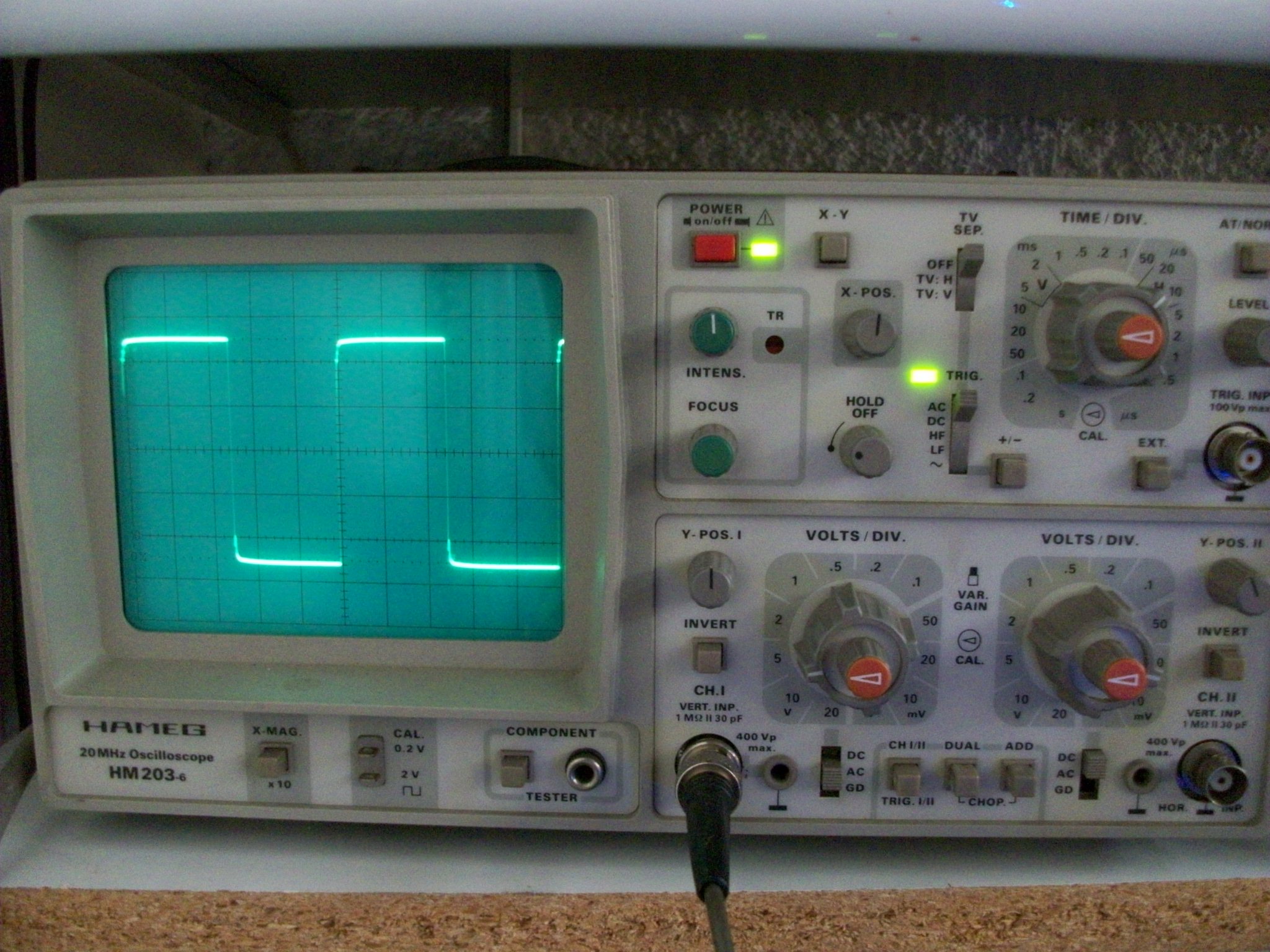

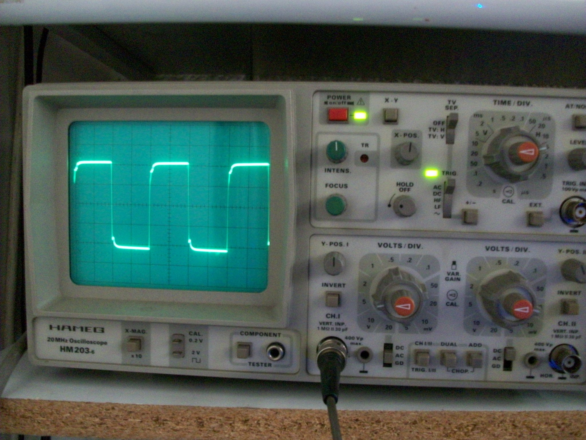

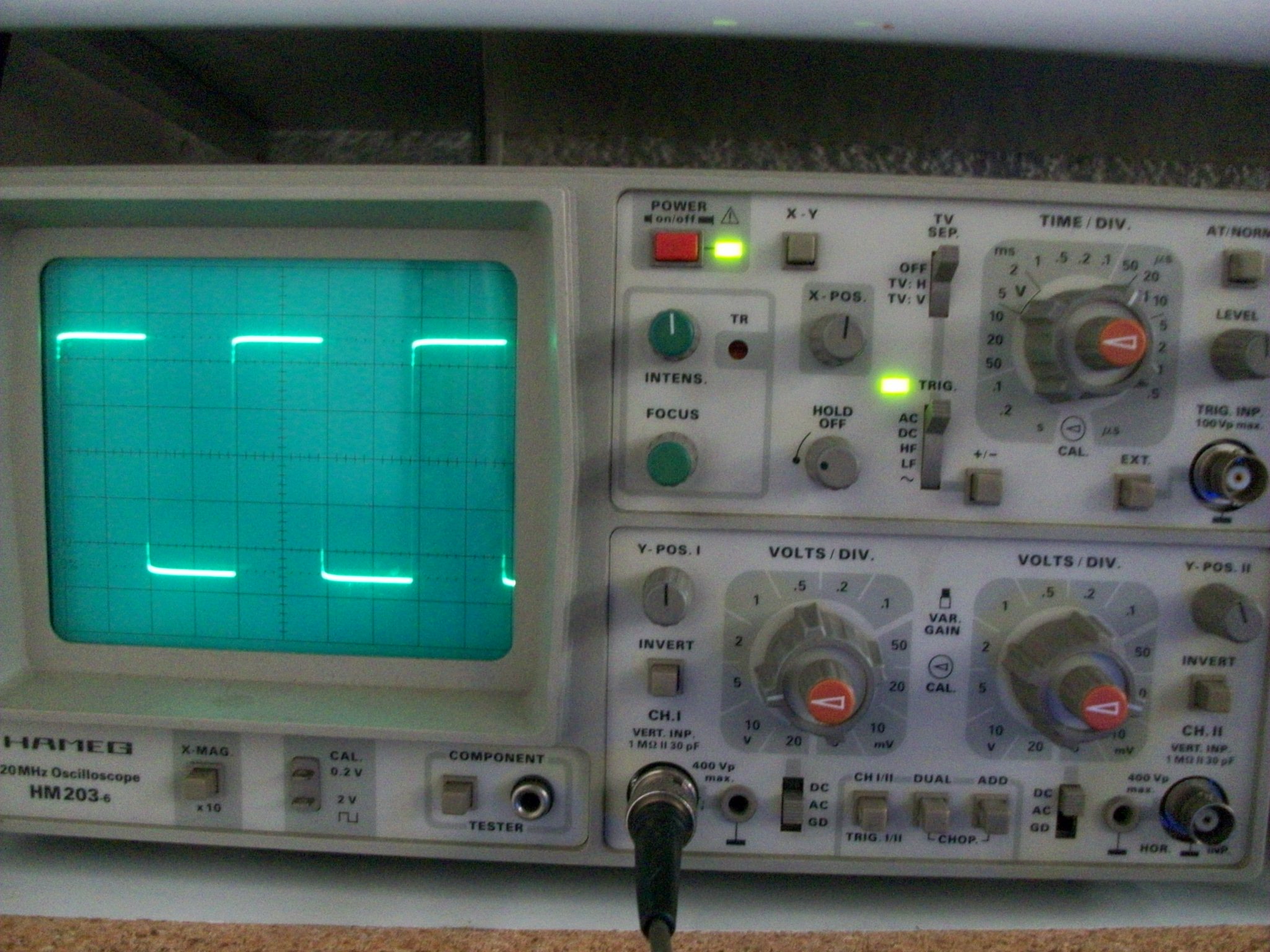

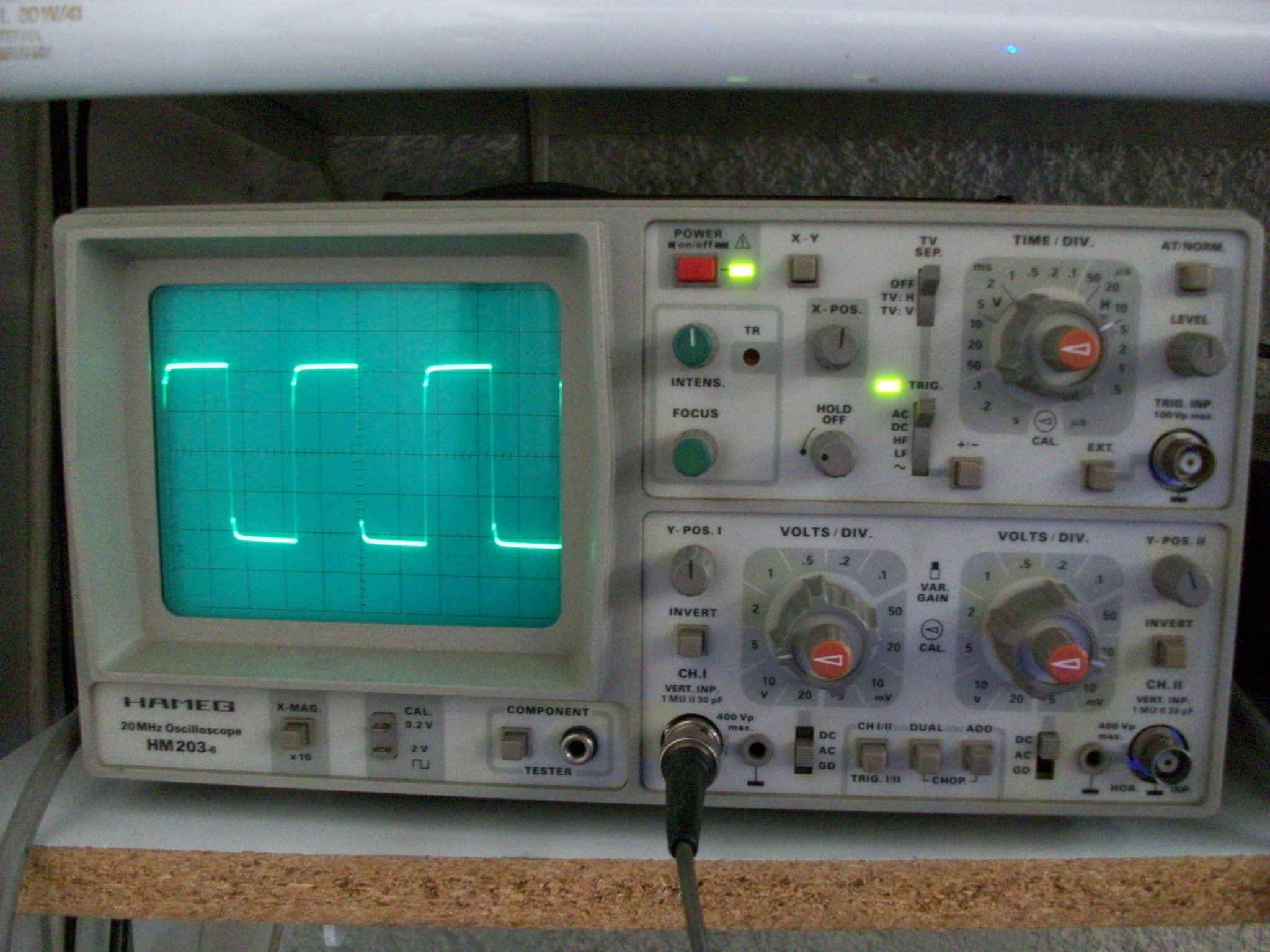

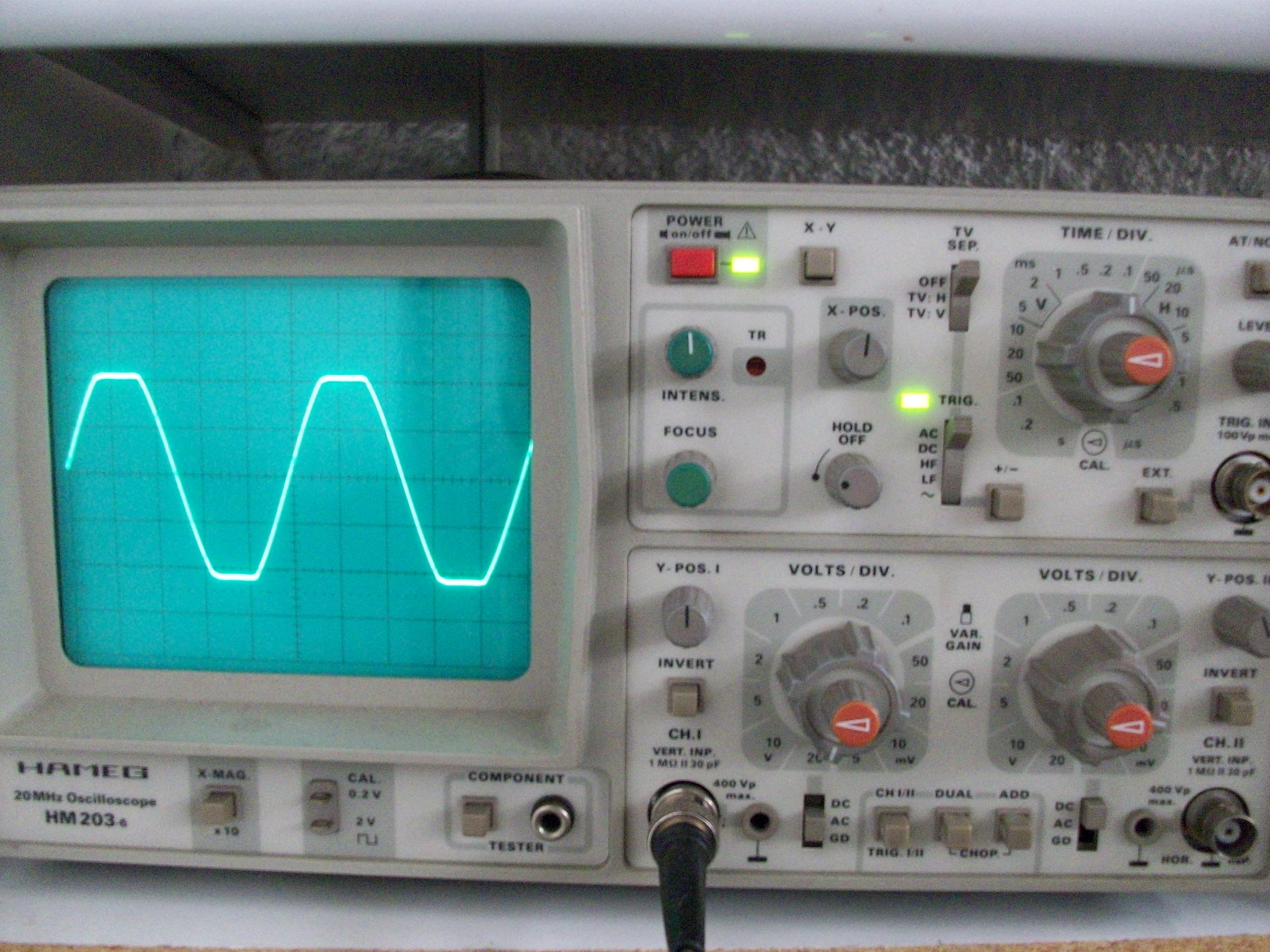

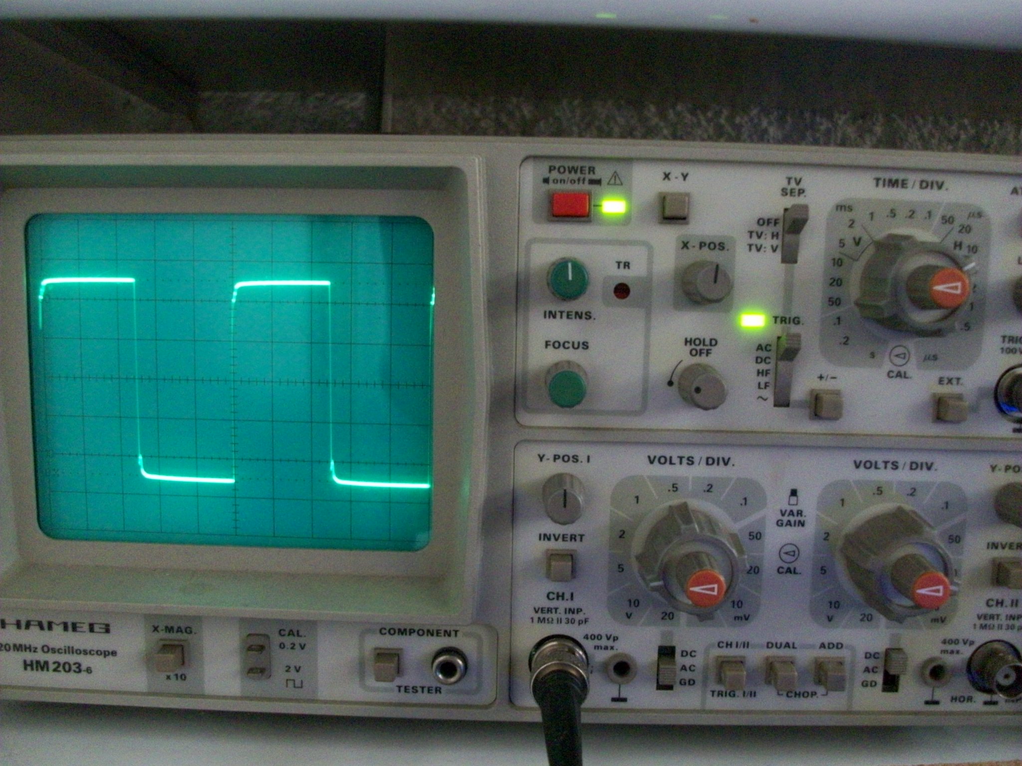

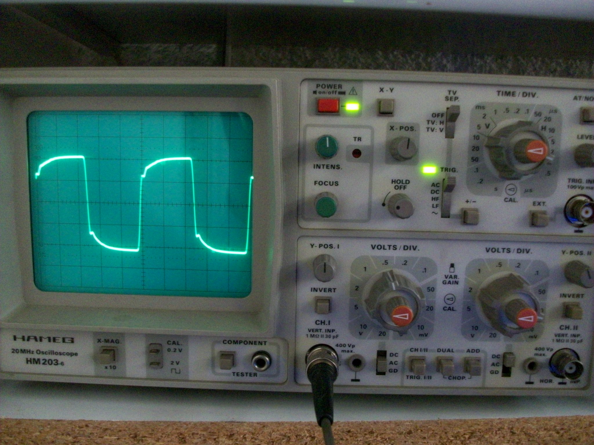

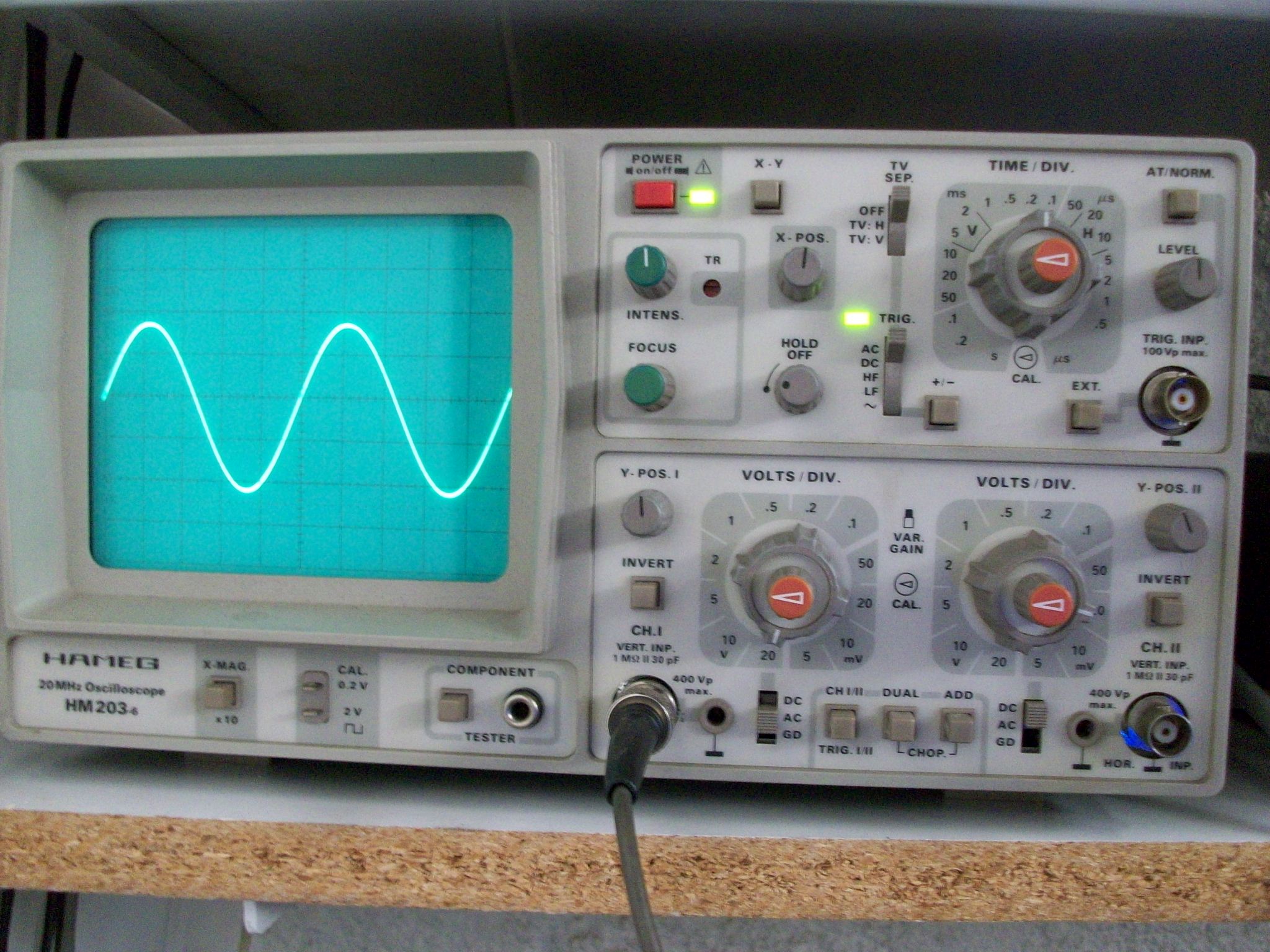

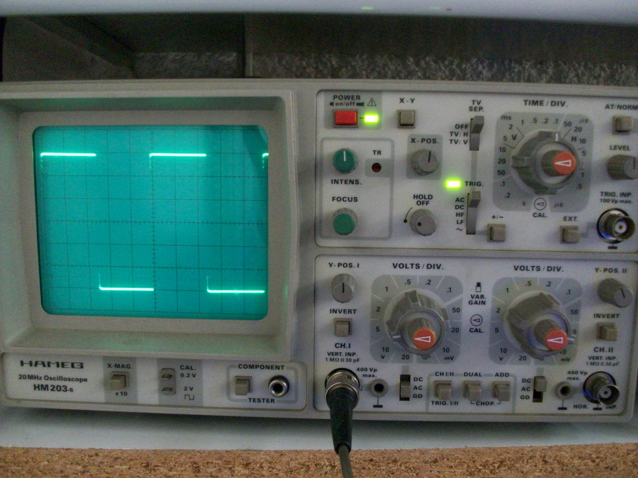

Now ,i tried all these recommented changes.
1) tl 072(servo i.c) pulled out.Offset=20mV oscillation is present.
2) R20 R24 sorted. oscillation is present.
3)changes LED to green.oscillation is present
Then i try to reconfigure test set-up.
In all previous tests, my signal generator powered by 1:1 safety transformer and oscilloscope powered direct from outlet
Now i tried to power the genarator and osciloscope direct from outlet
This seems to help but not enough.
1) 26V RMS just before clipping
2)28V RMS visible clipping(Vinp=1Vrms/1KHz)
3)30V RMS
4)31V RMS
5)34V RMS
SQUARE WAVE
1)1KHz
2)5KHz
3)10KHz
4)20KHz
5)30KHz
6)50KHz
7)100KHz
8)200KHz
