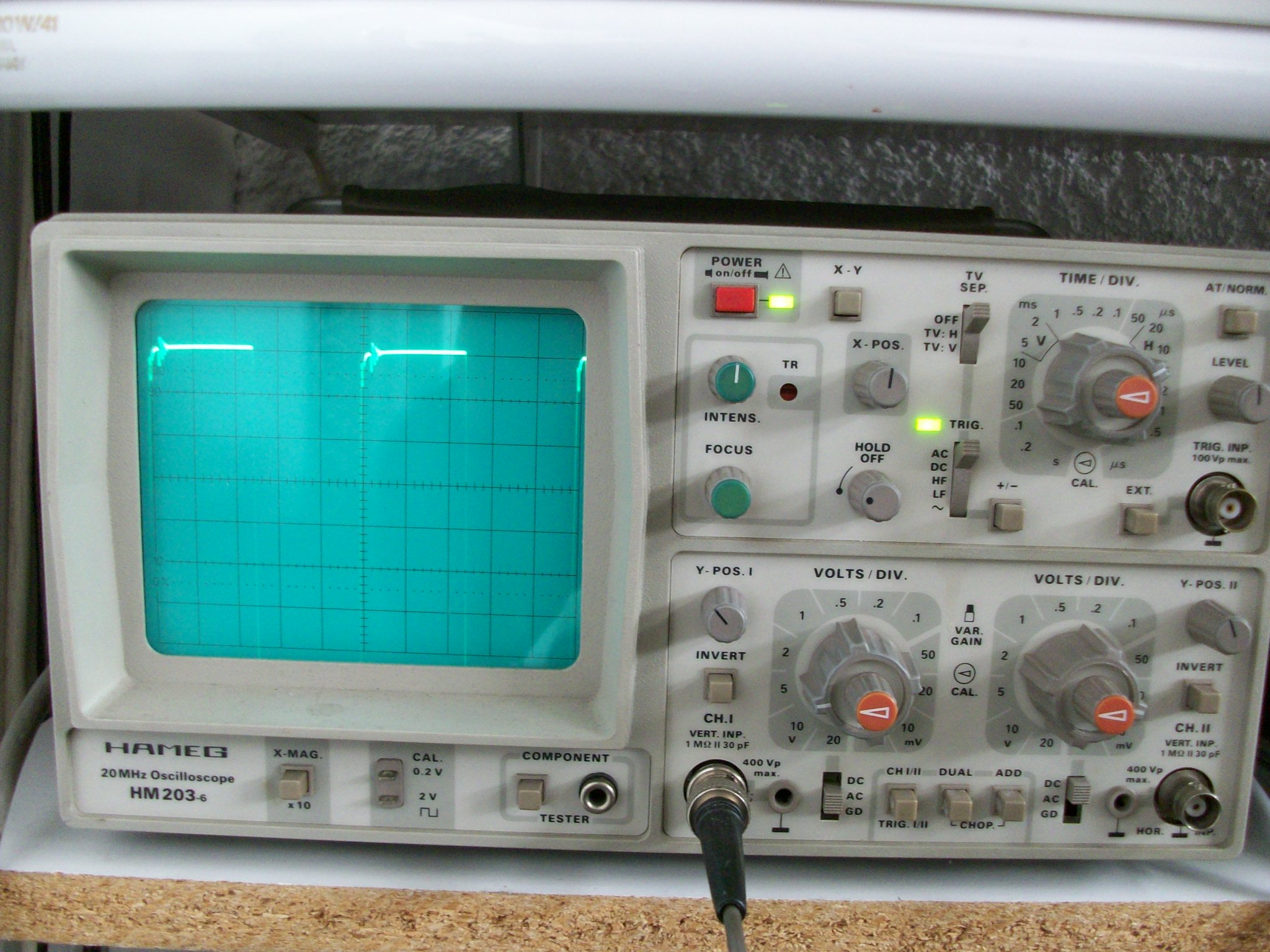

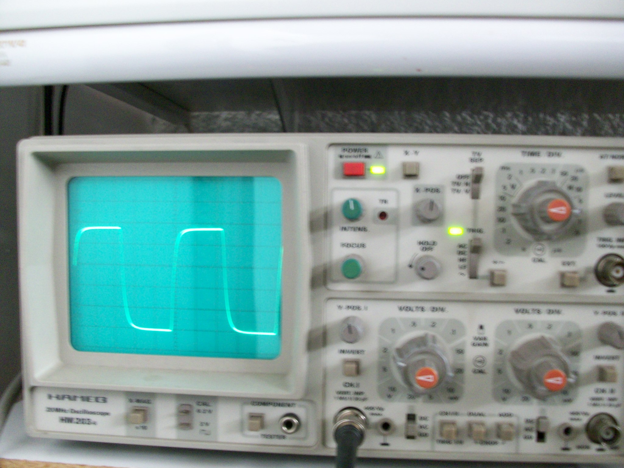

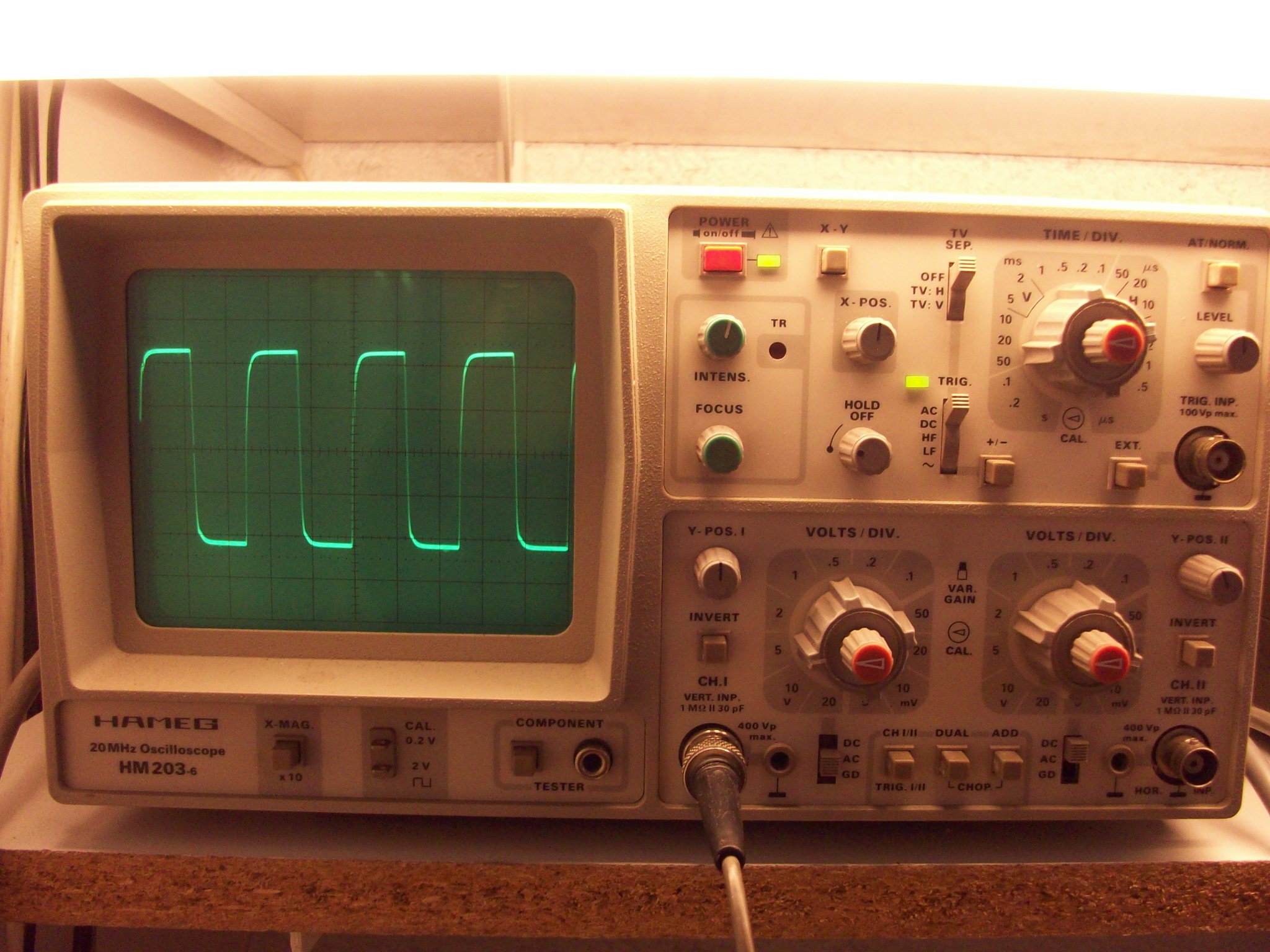

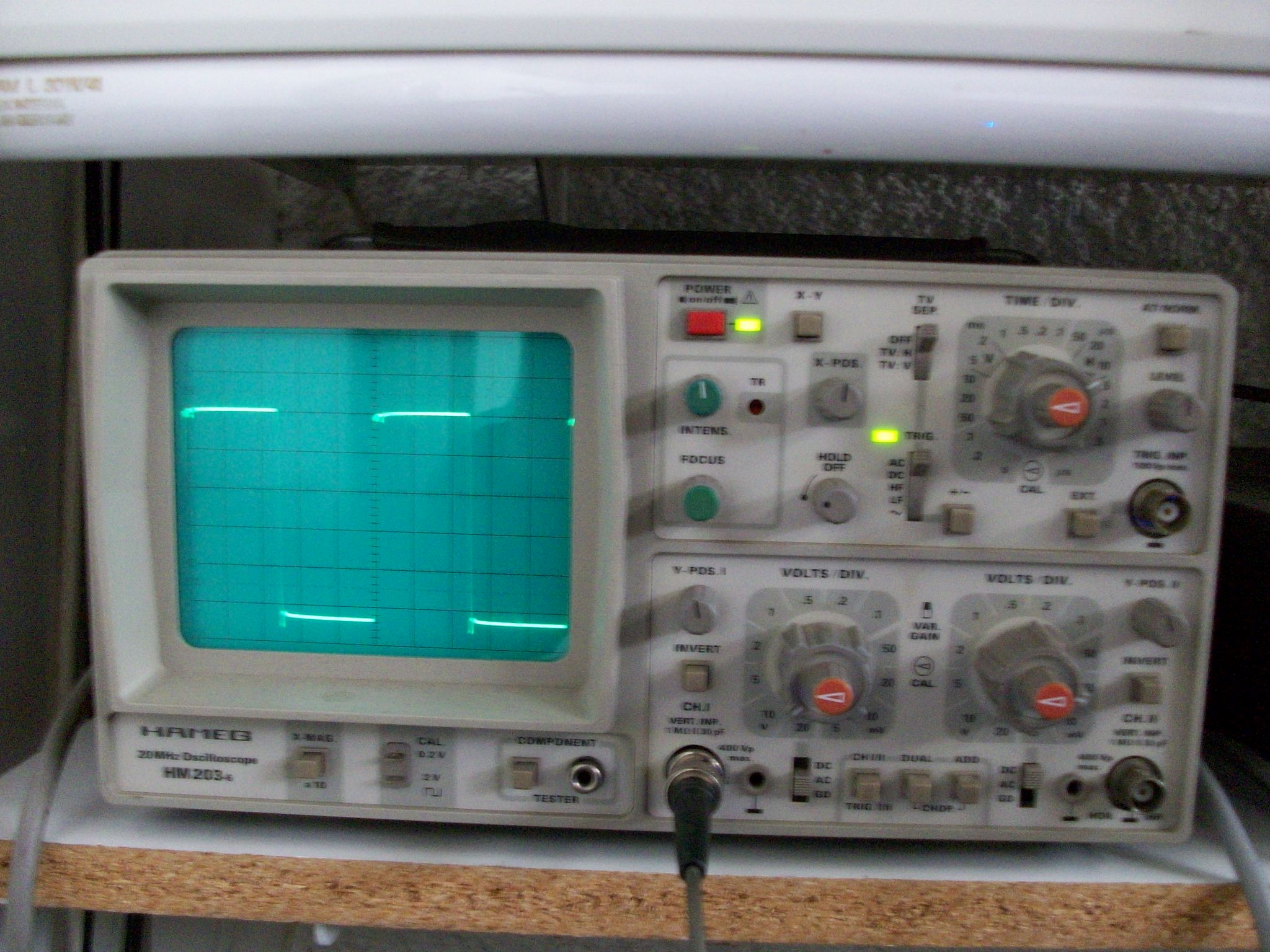

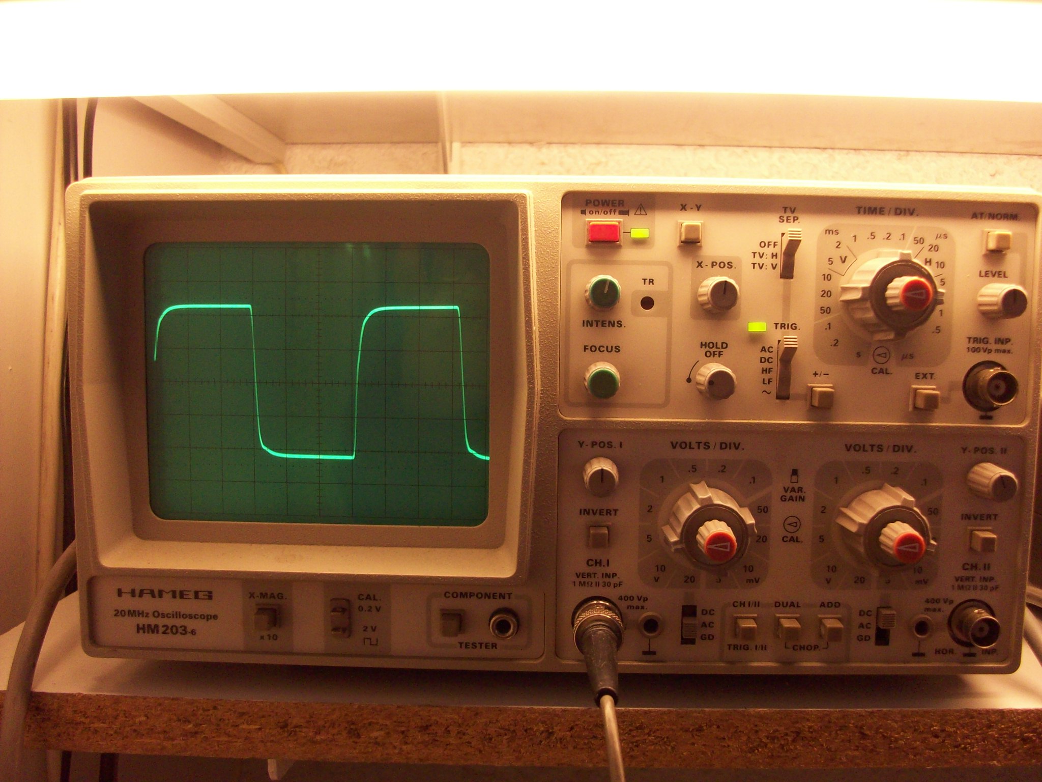

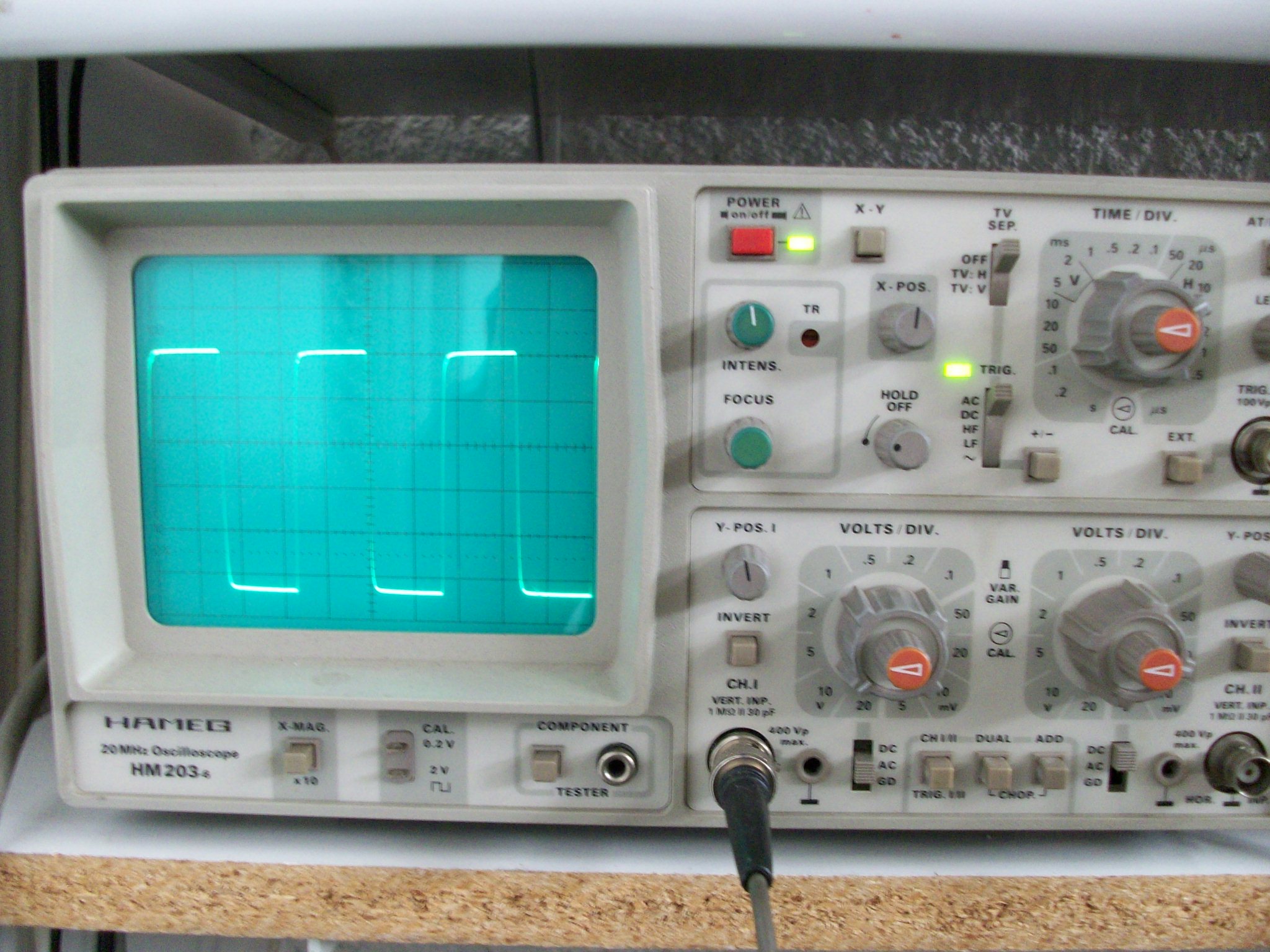

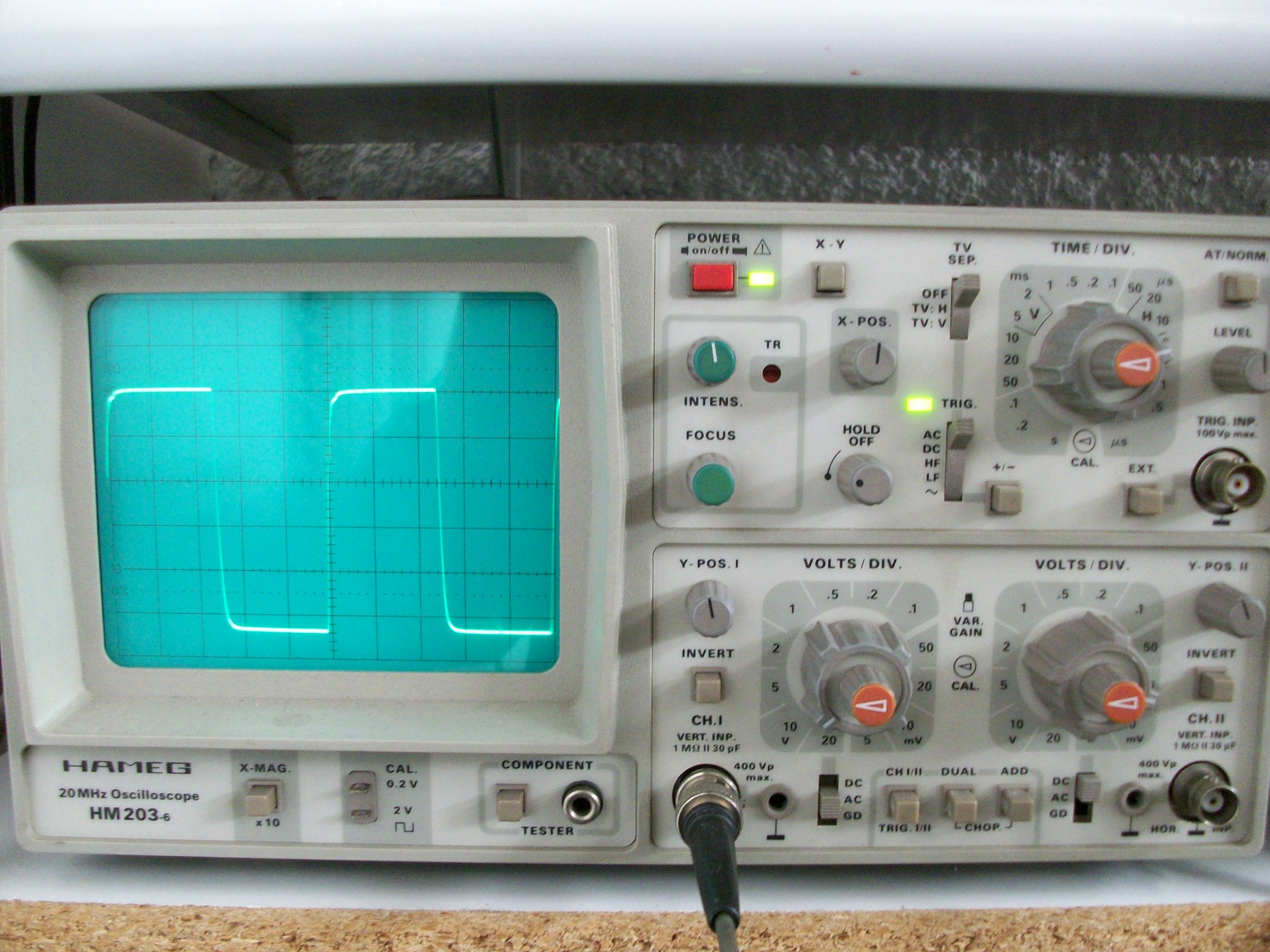

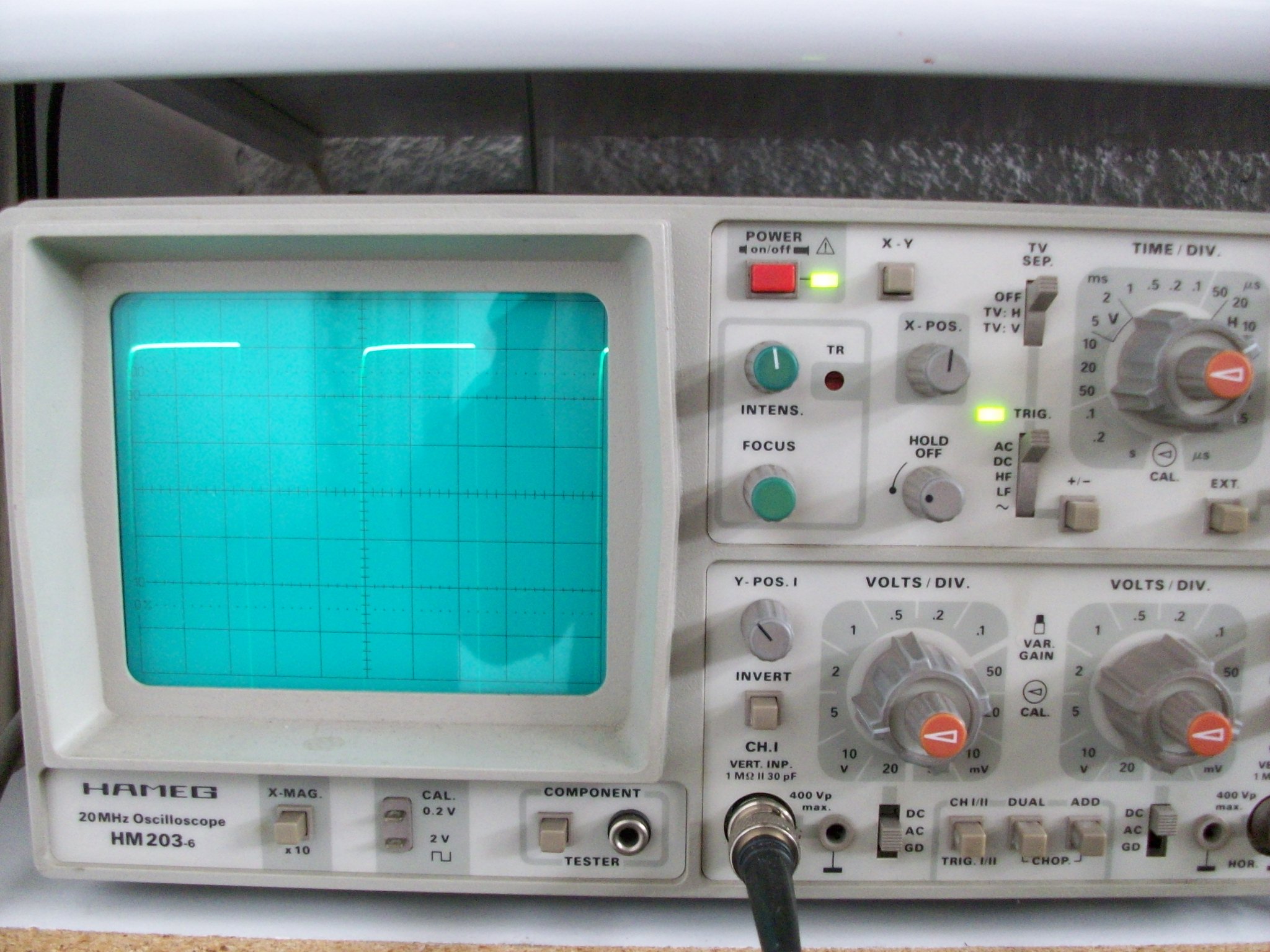

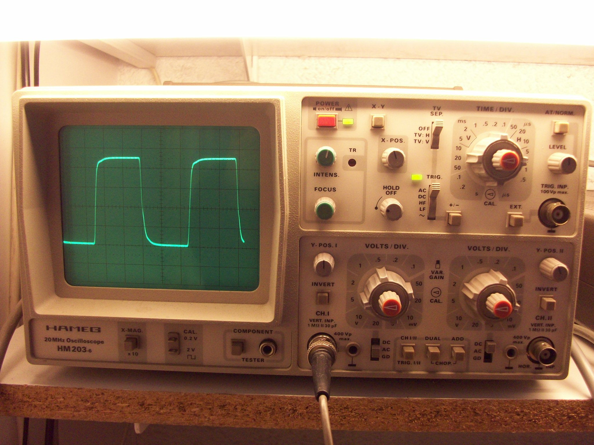

I tried putting 2sa1943 c5200 as driver outputs.
With these, the amplifier oscillate badly.
Then i tried NAD V1.2 ,same bad oscillation.
Putting again 4793 ,1837 i tried again v1.2 &1.3
First photo 20KHz (V1.2)
Second 20KHz(V1.2) BUT now i have add 100pf//33pf(c107,109)
30KHZ,40KHz,50KHz,100KHz(all v1.2)
last photo v1.3/ 20khz....
Thimios,
It appears you have solved the problem of the ringing you see in the first picture. Now how does it sound! Great work.

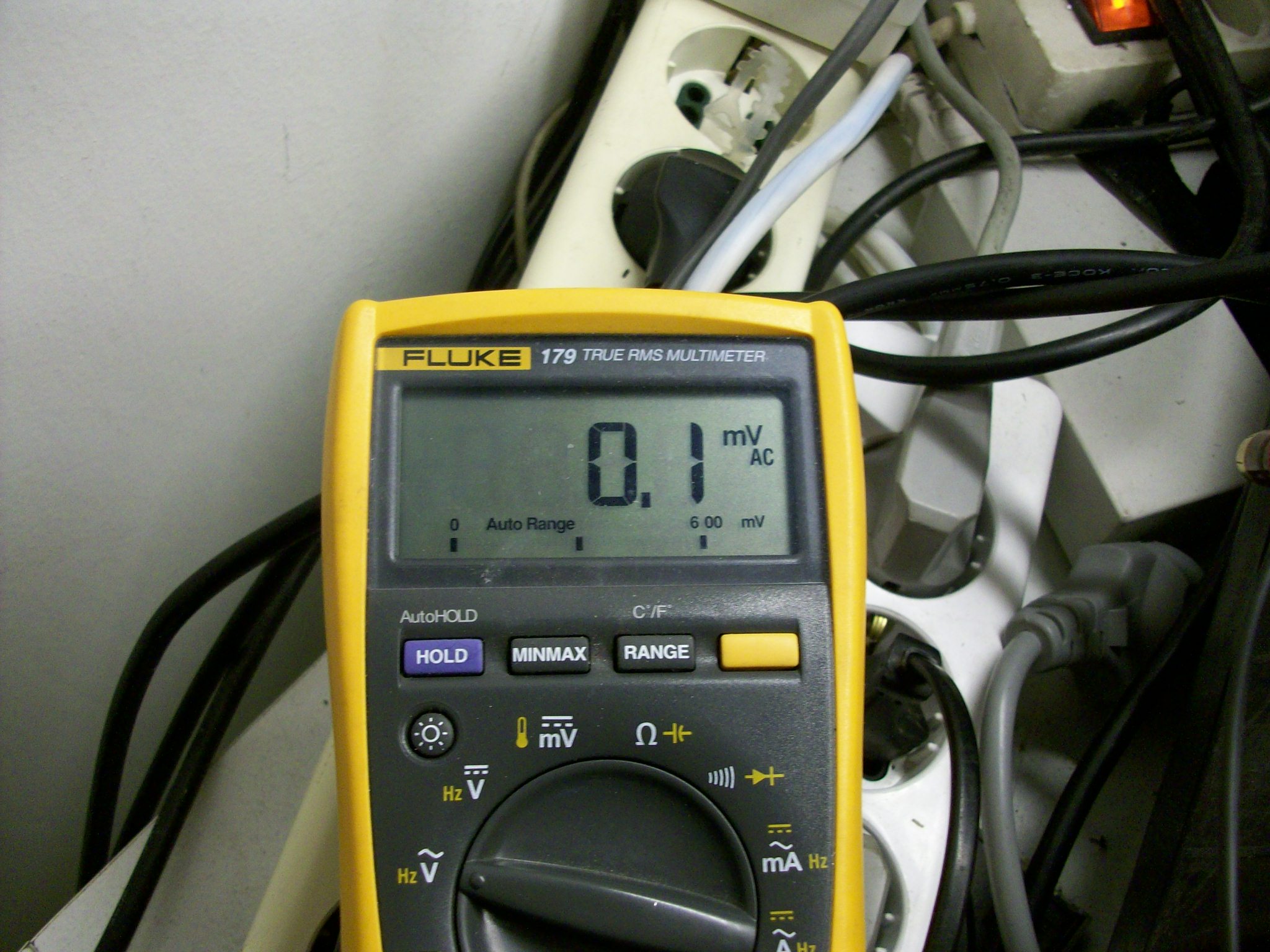

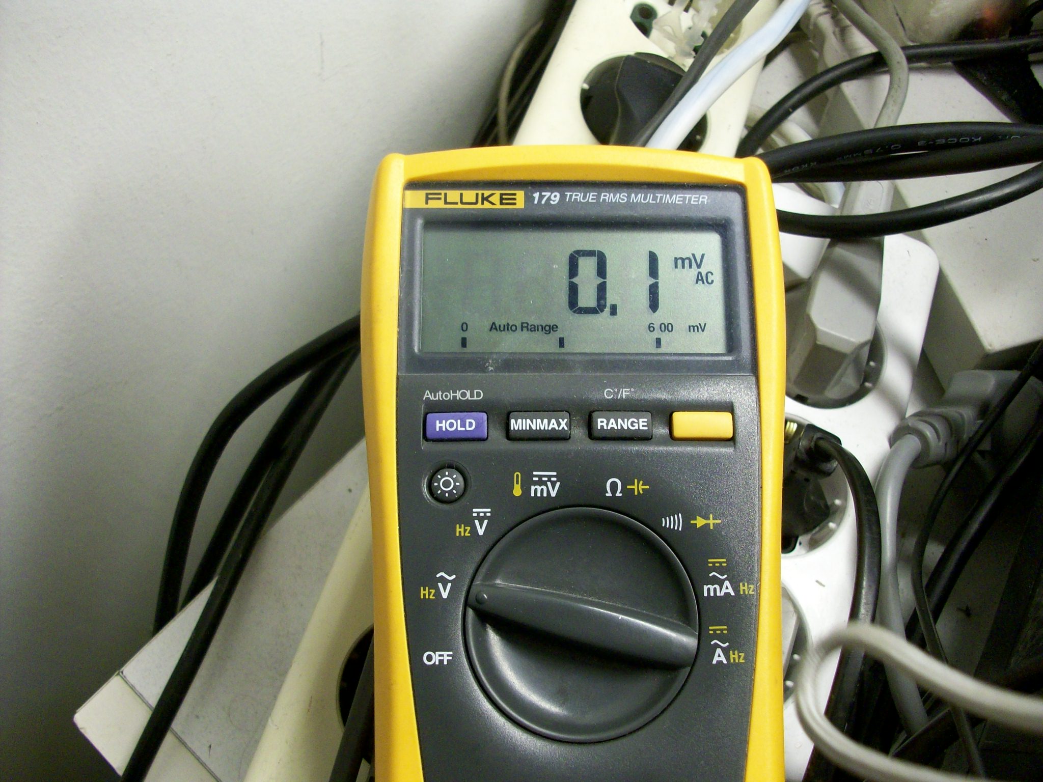

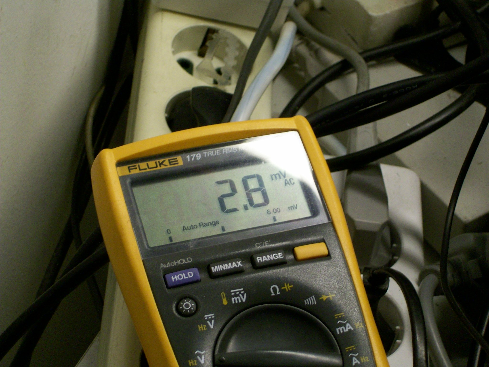

Please ATTENTION.Measurments after updates.
The instability remain.
Amplifier oscillates after clipping also, (sinusoidal wave test)
I measure 2mv A.C on out even when input is sorted but can't hear any noise from speaker.
You must read these at shematic,734ma as 0,734mA & 846mA AS 0.846mA
Sorry fo this.😱

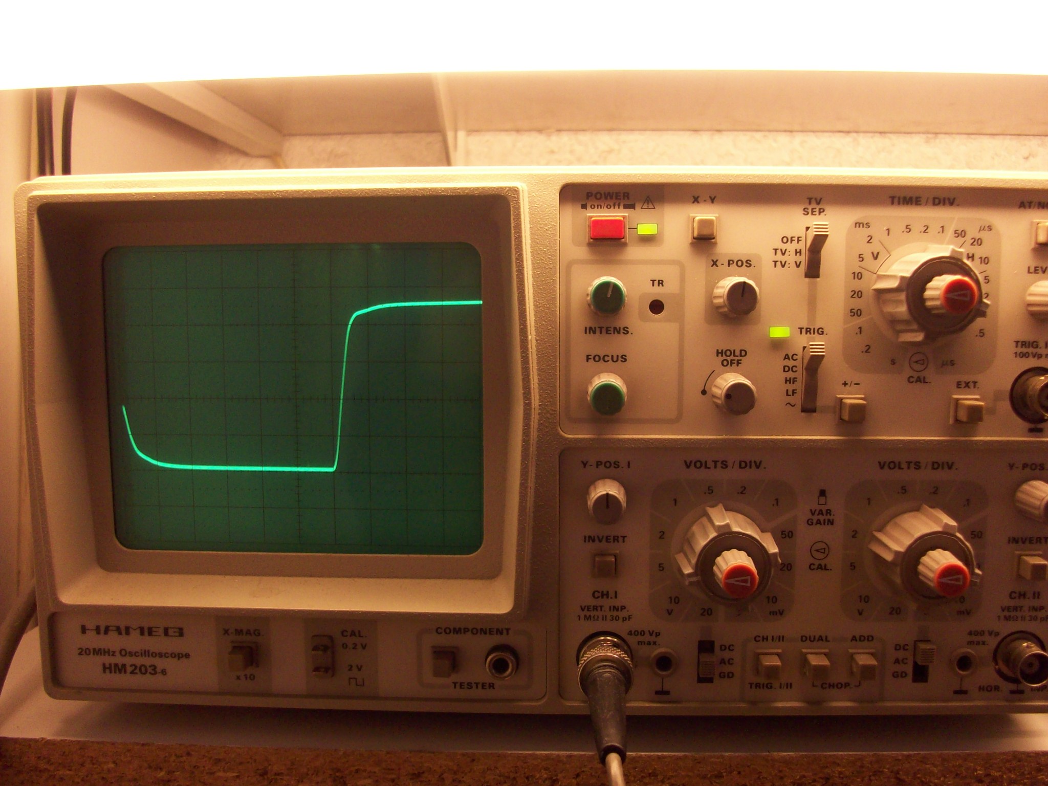

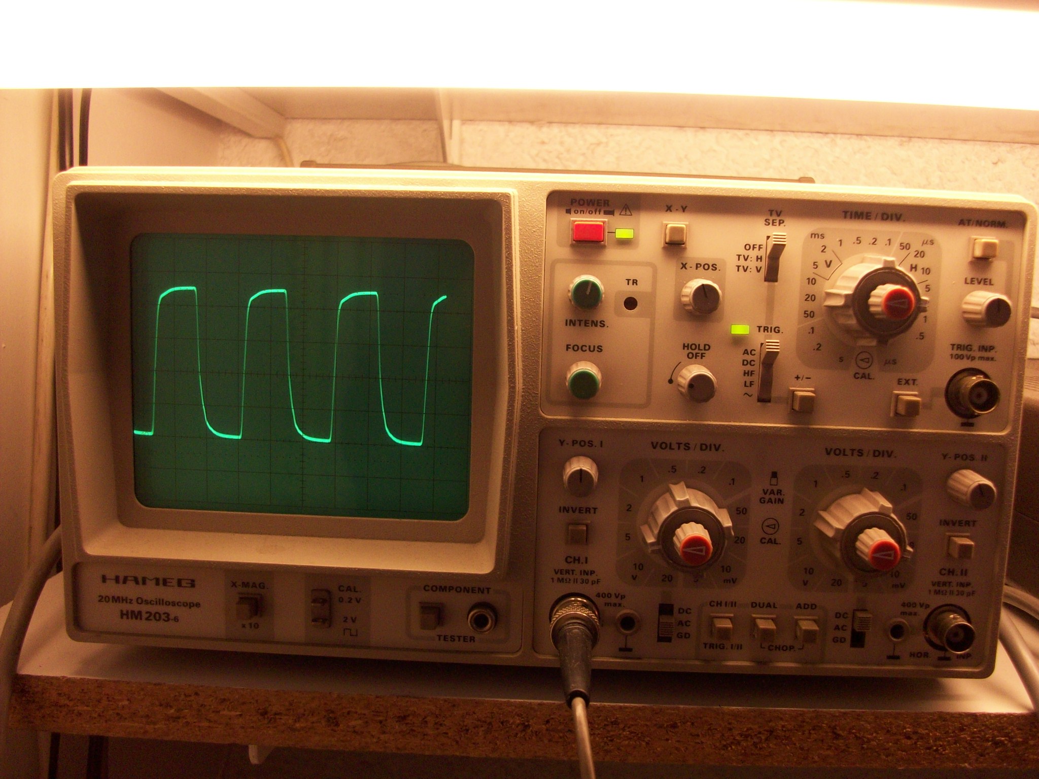

A new test.
1,2,3 80KHz
4, 100KHz
5, 150KHz
6) out A.C with sorted inp.
7) out A.C with open inp.
8) out A.C inp sorted with a resistor 1K.
1,2,3 80KHz
4, 100KHz
5, 150KHz
