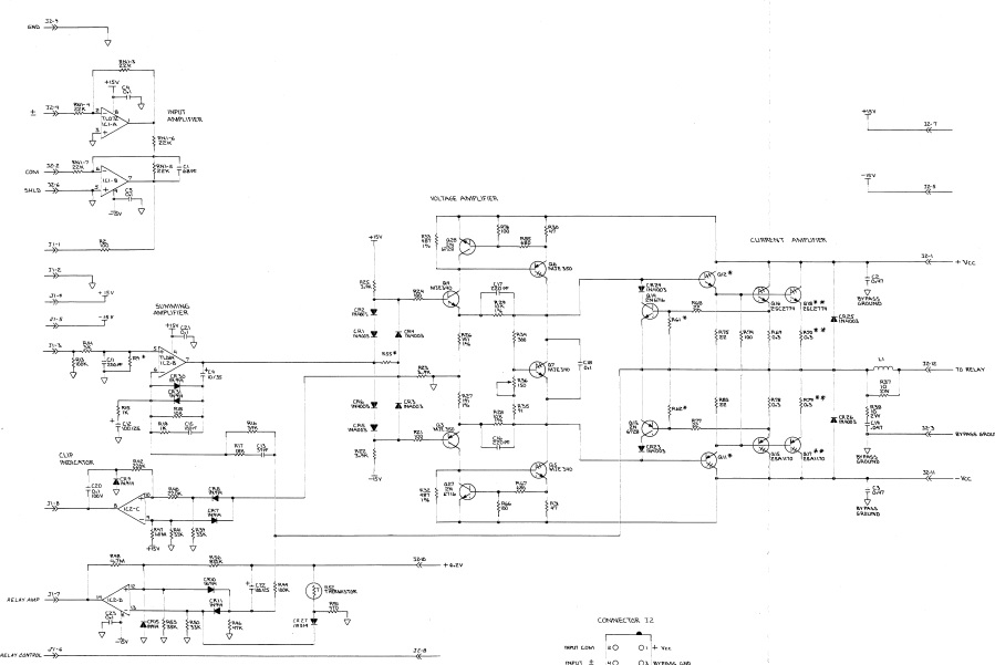

Ostripper,
Do you by chance know which topology the old UREI 6250's are?

Yea, I know some of those guys. It is surprising how good these amps sound once you consider how simple of a circuit is inside.

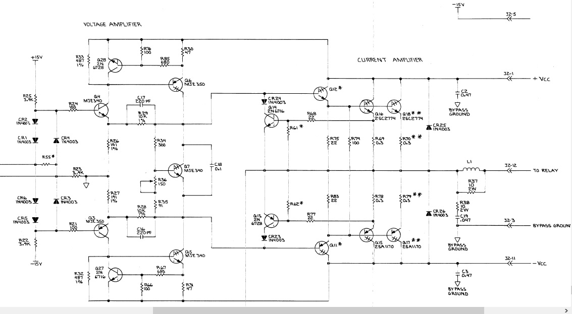

UREI 6250 schematic
That is a incomplete schema ... but , I can "see" the rest !
It looks like my next endeavor .. A cfa (yes , the UREI is one)
with the CF stage driven by an OP-amp 😉 .
a guess , but the dual diode input to the level shifters almost
assures this.

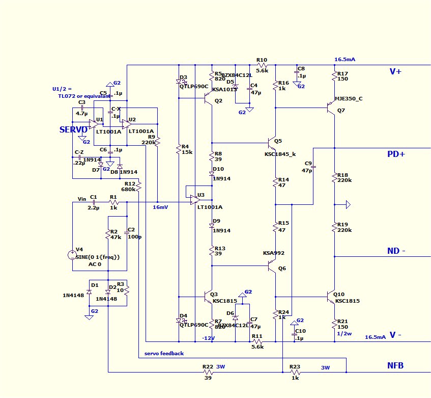

I couldn't fit the whole thing.
It has IC chips in front.
You are right.
Thank you ... ( could you make that more detailed).
(below ) is my work ...
PS - only down to 80ppm 🙁 . (just testing the waters) ...

It looks like my next endeavor .. A cfa (yes , the UREI is one) with the CF stage driven by an OP-amp "
Yes, please! I'd like to see that.
Curiosity got the best of me. Here is a larger PDF of the UREI 6250. If you Google 'UREI 6250 User Manual' the PDF that includes this will be listed.

For an IPS ....
You might want to wait for my "symasui" .... I can create VFA's from
"heaven" - I am the "VFA man" 😀
PS- both the spook and the symasui can go to 200Vp-p single digit PPM
...they go to that point that the CFA's can't at very high voltages.

It's a VFA ! Lead comp + dc blocker are relegated to the IC. The quality
of the full amp will be determined by the topology of the IC.
As a reference the TL072 is a "blameless" with fet inputs , the NE5532
is a symasym ... etc...

Best to DL the manual.
http://www.google.com/url?sa=t&rct=...62gDRHEiC0aEChXSObWPZXg&bvm=bv.63934634,d.aWc
it has the schematics in it.
