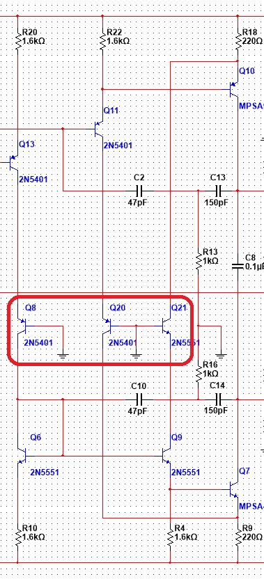

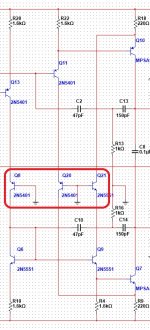

Totally agree about cascoded VAS - you can use a lower power / higher hfe transistor as VAS and higher power / lower hfe / higher voltage transistor in cascode. For example 2n5551/5401 + MPSA92/42 give a very good result.
With regards to the "upside down" 2-nd and 3-rd diff cascades advantages - I have to think a bit more why they work better... but thank you for pointing it out 😉
"upside down" = CMRR (cancellation) . Like the EMI filter for AC line.
PS - what else could explain 30db+ PSRR gain ?
OPS

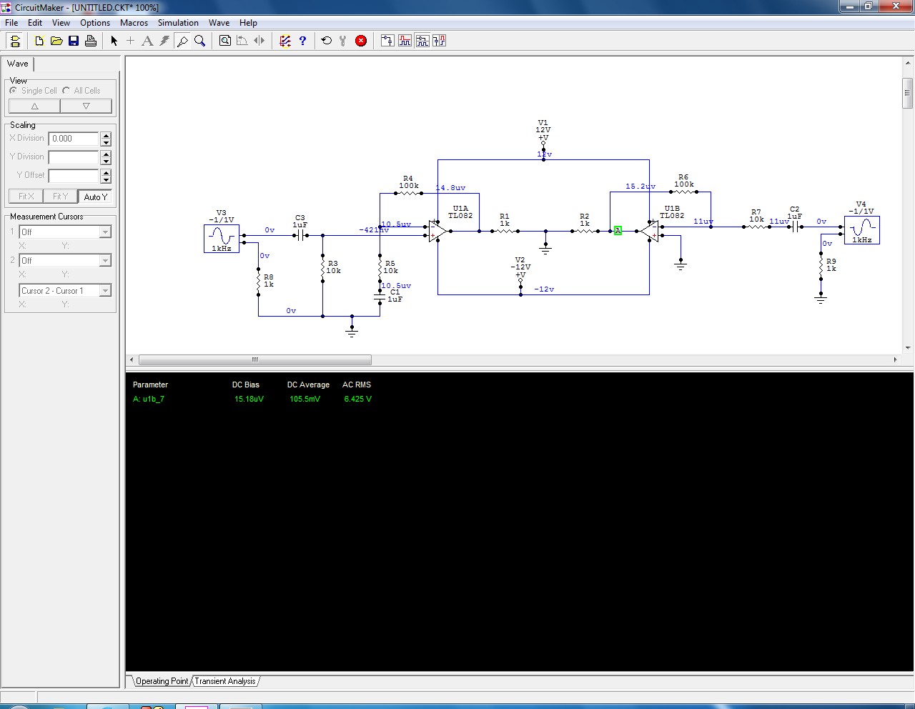

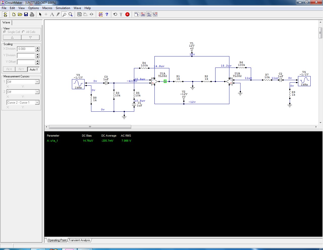

You should not forget that NFB used in an inverting amp depends on the source output impedance and is influenced by input cables. An input buffer would be a good to have here.
Show an example (either crude or elaborate 😀).
OS
OS
If you mean buffer, then you can find many good buffers in this forum. I used JLH simple buffer(search JLH buffer) with my gain clone working in inverting mode. Some will say that the buffer is not in the NFB loop, so not good.

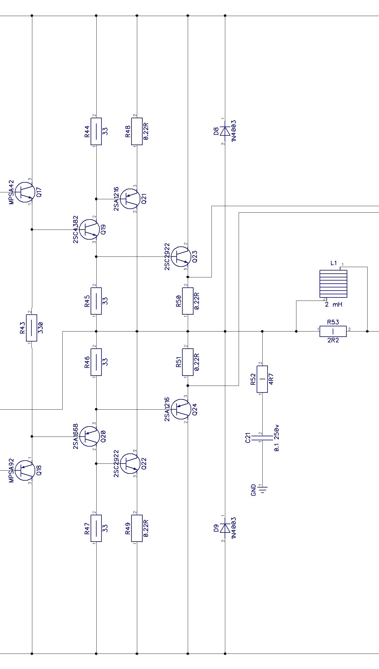

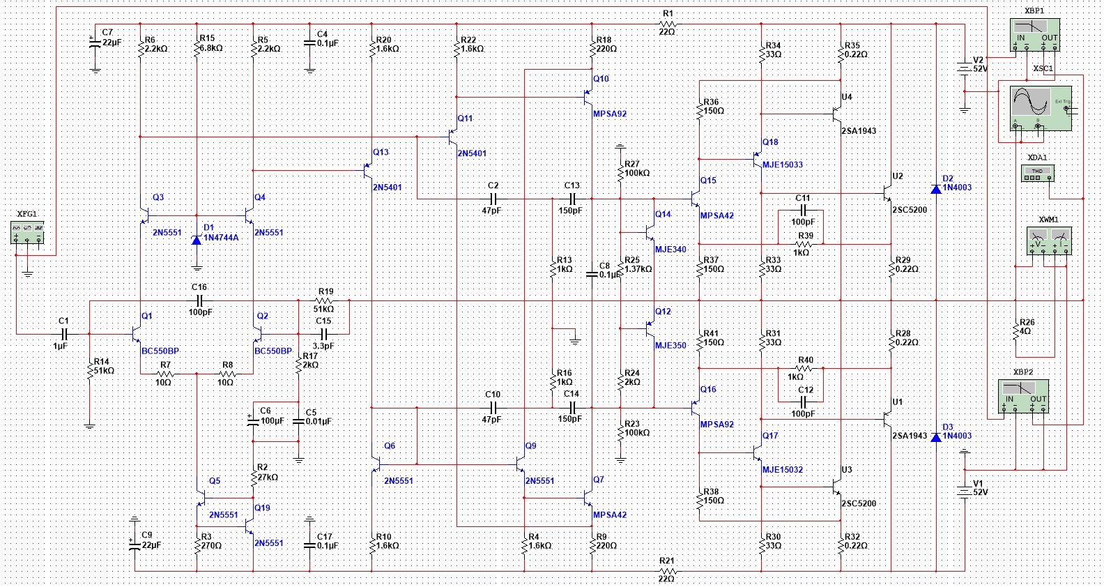

OS, did you have a chance to play with this one? I did not prototype it yet (too busy with CFA 🙂 ), but initial simulations show very good results...
By the way, the OP showed excellent performance in simulation, but appeared very unstable in the real prototype, so I use an earlier Bryston-based design now (3-rd image attached).
Damir, you're absolutely right for the inverting one, but the one here is non-inverting... or am I missing something? )
Damir
Oh , like just a high-z --- low Z input buffer. OP-amp non- inverting
follower ??? (as a crude example ? ).
OS
That technique is like the positive hawksford fb (feedforward). It adds
another pole ... like a CFP stage.
I have actually made a hawksford oscillate at 4mhz 😱 .
I tried your VAS "trick" on a few designs. No ocillation , but reduced
performance. 🙁
I was talking about Otala amp, probably it was not clear from my post, sorry.
OS
He is correct. Attached are showing the difference in gain between inv. and non-inv. when driven from a source with appreciable output impedance.
Your plot(s) did not post ?
Now that dadod elaborated 🙂 , I know what he means.

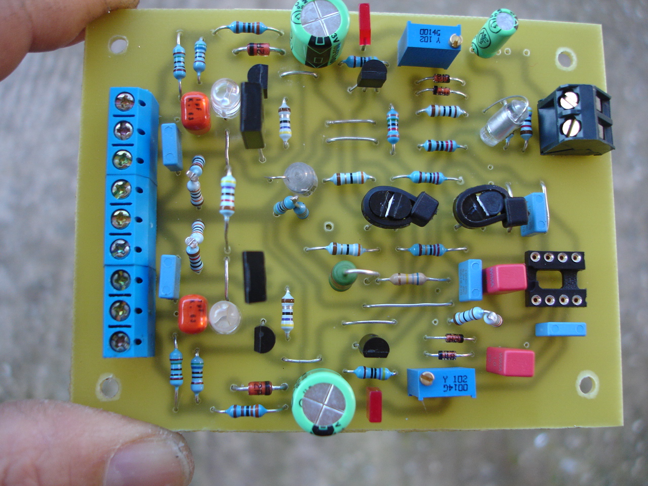

Boys and girls here is Gnome V1.3!

Thimios, One of those eight legged devices and a few things and you can tell us how it sounds. Did you just modify the V1.2 and turn it into the V1.3 or is this another board. Can't wait to hear how it sounds.
Hi Terry thanks.Dude, you are lightning in a bottle!
I believe tomorrow will fire up it.
Thimios

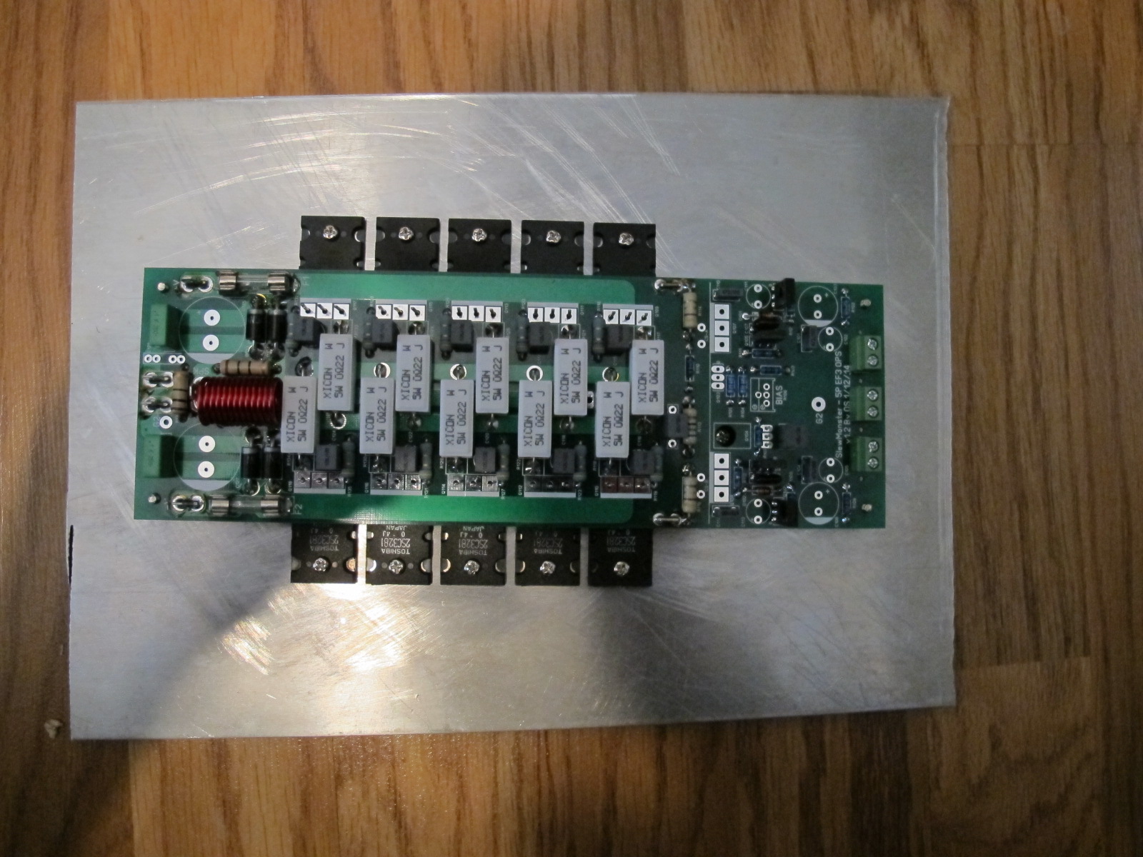

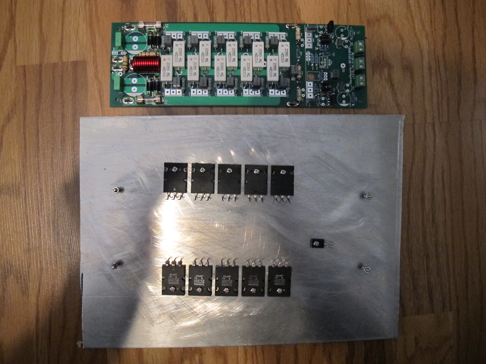

Assembly tips...
There has been some suggestion that it might be difficult to make a nice assembly. Here is what I do:
Print a paper template (make sure it is at 100% scale) and punch either a piece of aluminum as an assembly jig or the heat sink you intend to use. Drill the holes and tap them for the hardware you intend to use. Fasten your parts to the jig or heat sink. Install the board on top. Adjust lead bends if needed and solder the components to the board.
