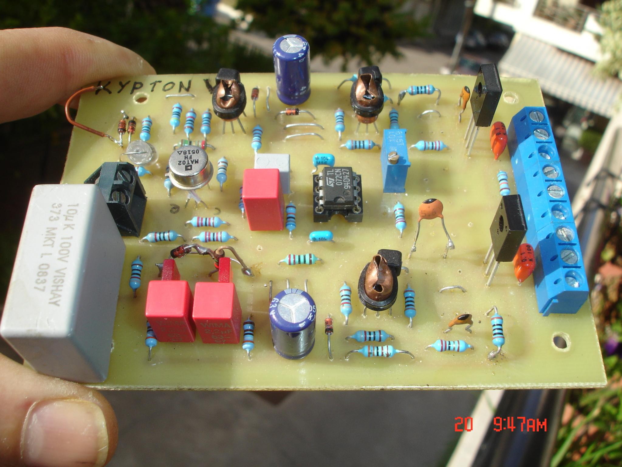

i notice that the BC550 Q1. Q2 and Q3 have been replaced with KSC1845k in this schematic. is it necessary to replace them? Do i have to cross the pins to do so?
I see there's a lot of changes. Removering some resistors and replacing Q4 with led.

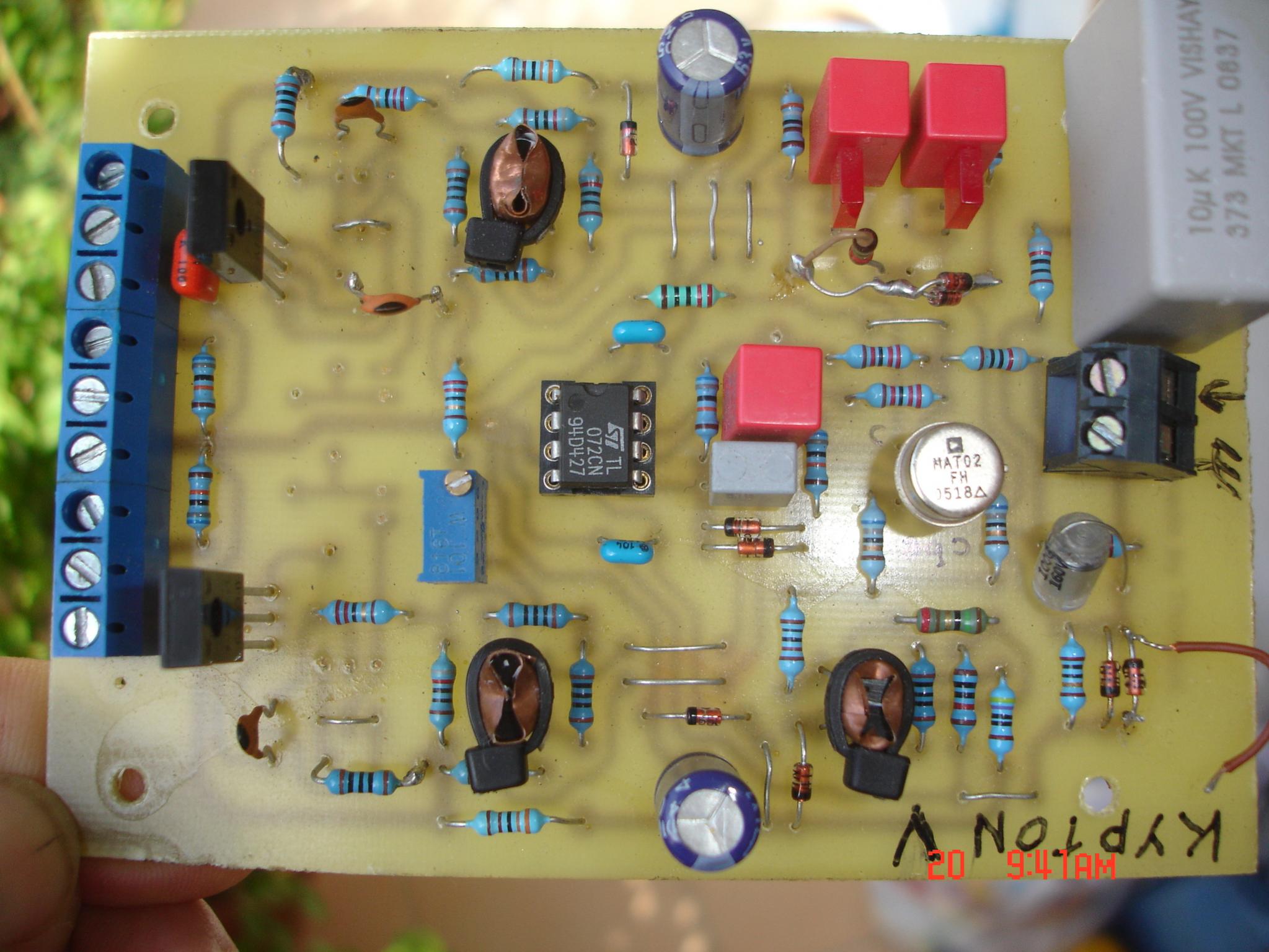

Thimios, do you have a picture showing what the board should look like after the modifications?
I built Kypton V2 final because it was posted in the first post and I thought that it had been tested and was working. Have anyone built that exact ips successfully?

You can use any high Ft BJT for Q1/2. The BC's are about the same if
you know the (1845) grades . BC550c is about the same as 1845 E or F grade. My 1845 E's were @ 380-400 hfe.
Thimios has it built , he showed it in this thread.

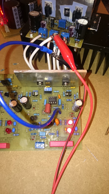

Yes. I built the one in post 5384 and can't get it to work. With nfb connected none of the leds light up. Without nfb connected one of them light up.Are you speaking about Kypton v?
I have double checked all values with the schematics and all of them match.

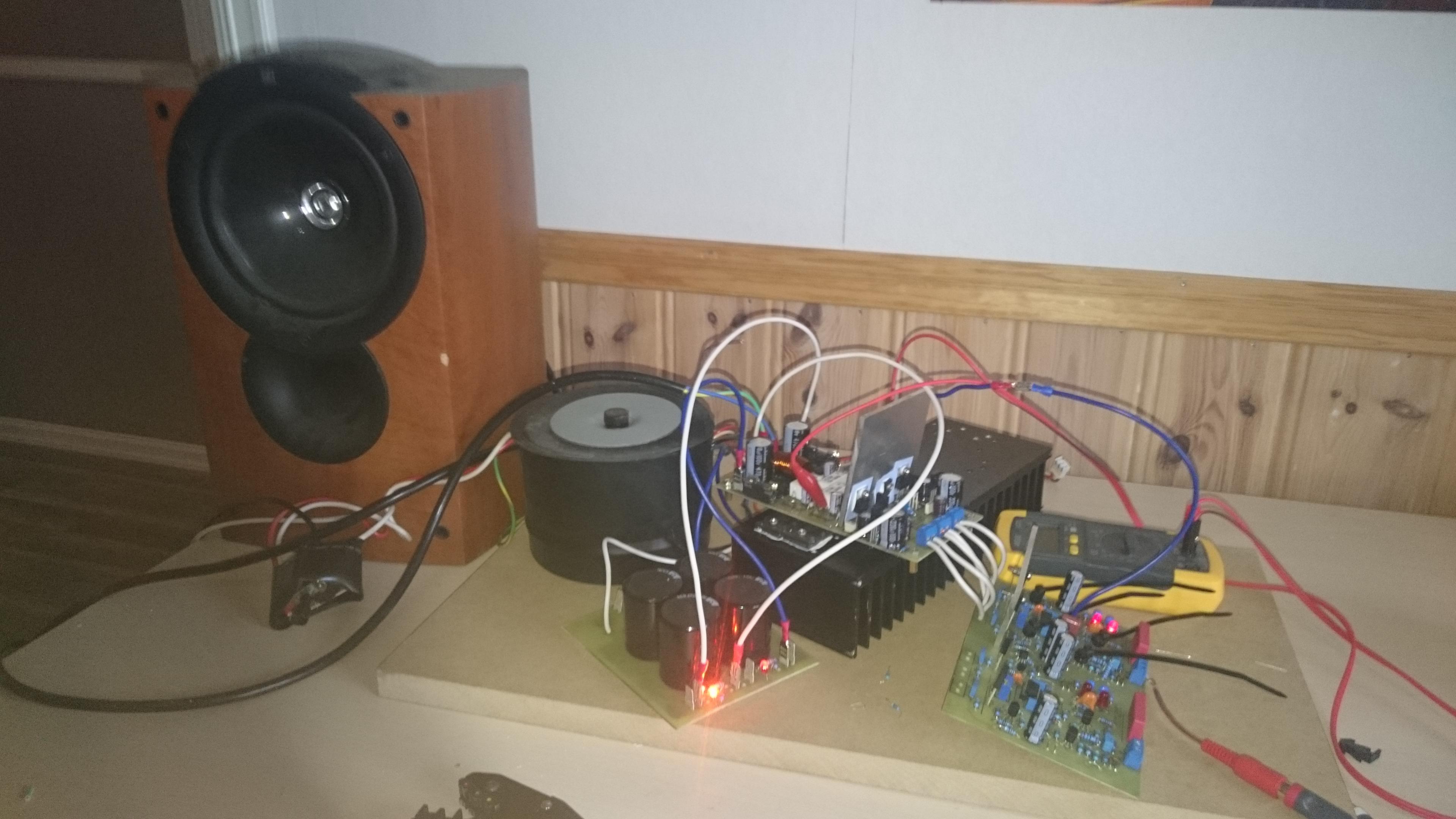

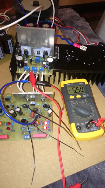

Voltages seems to be correct and I managed to adjust VAS to 5.5mV. The only differences I have from the schematic is R12 570R (470R+100R because I didn't have any 560R resistors) and C3 100p instead of 220p, since i forgot to order 220p caps.
It's powering the OPS now. Gonna put the scope on it and look for problems before I connect a speaker, remove light bulb and listen to music.
Glad to see your Krypton v working now!It's working and it sounds great. 🙂
What was the problem?
Is it a pcb bug to this v2 bord?
The problem was a solder bridge on Q1.

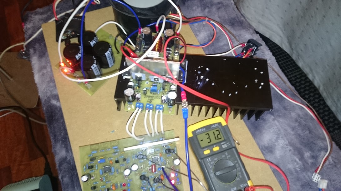

It's still not perfect. After listening to music for a while, the bias suddenly goes sky high. (0.5V).
Both OPS and IPS is new, so I have to do more troubleshooting to find out if it's ips or ops related.
The amp is stable now. I Increased R14 and 15 to 4.7k, after that the bias was fine.
