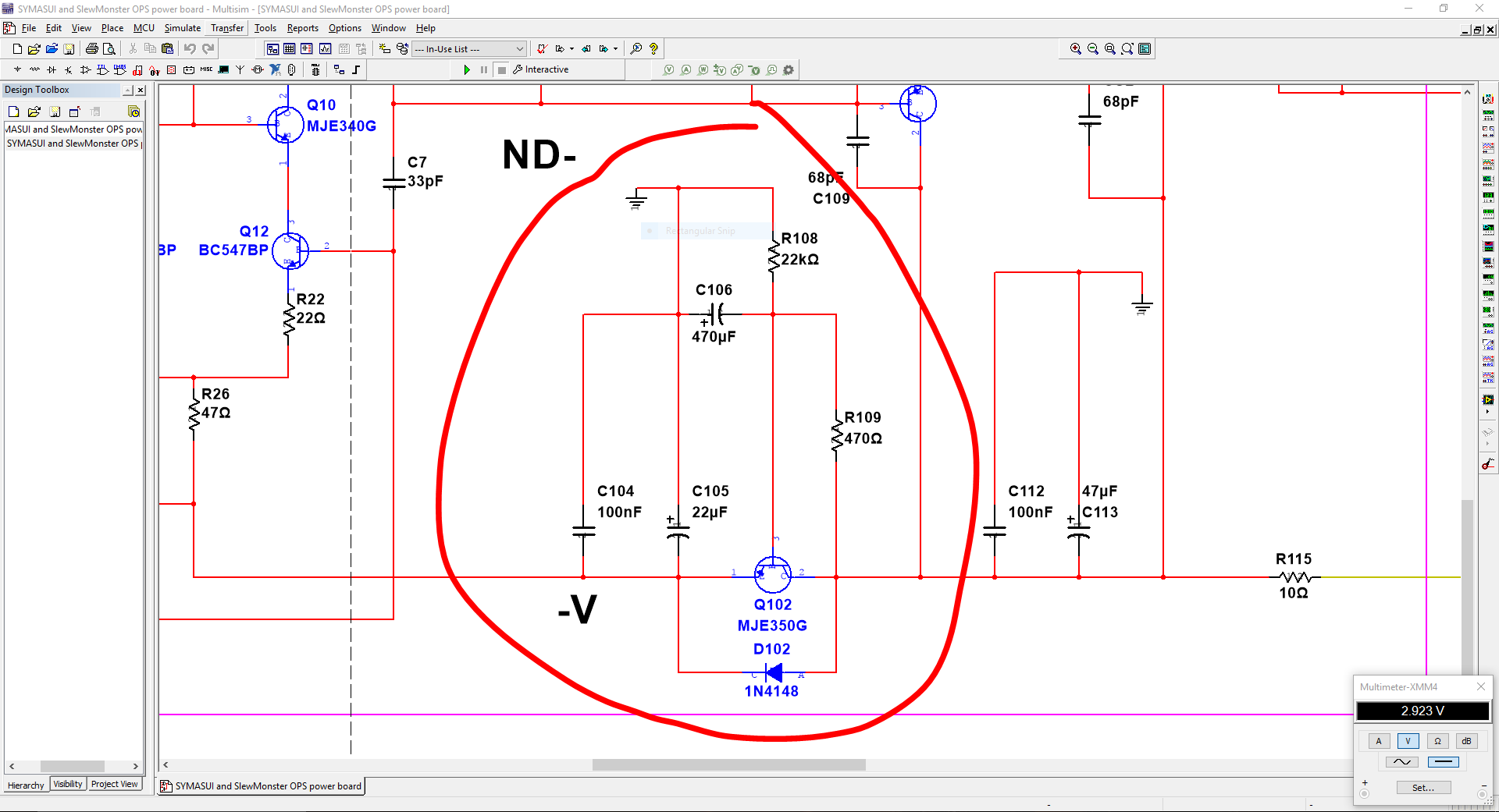

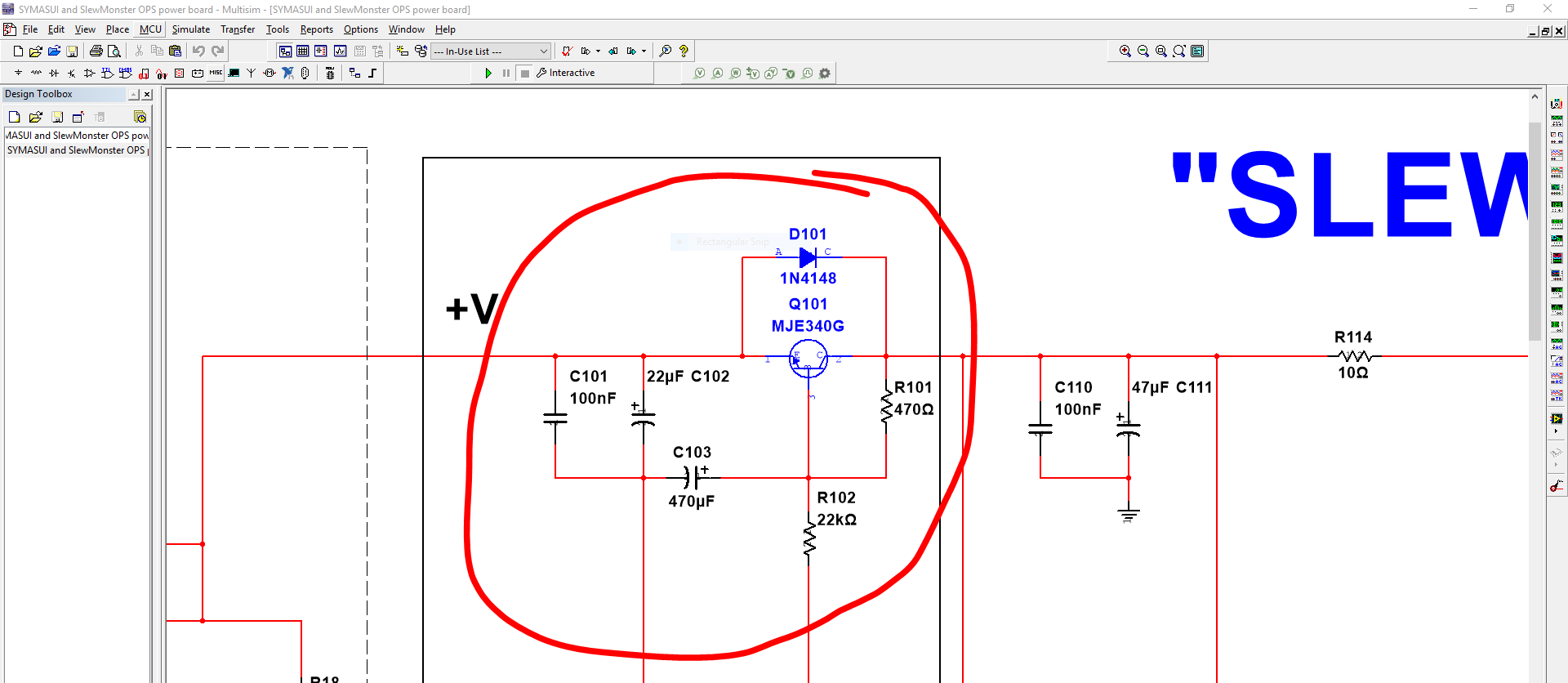

hello guys one question how you guys call the circuit from the positive rail to the negative rail ?
This is a capacitance multiplier.
The value of 470uF at the base is multiplied by the current gain (beta) of the transistor.
Those are 'Capacitance Multipliers', a simple active filter to help remove ripple and noise from the power supply lines feeding the low current sections.

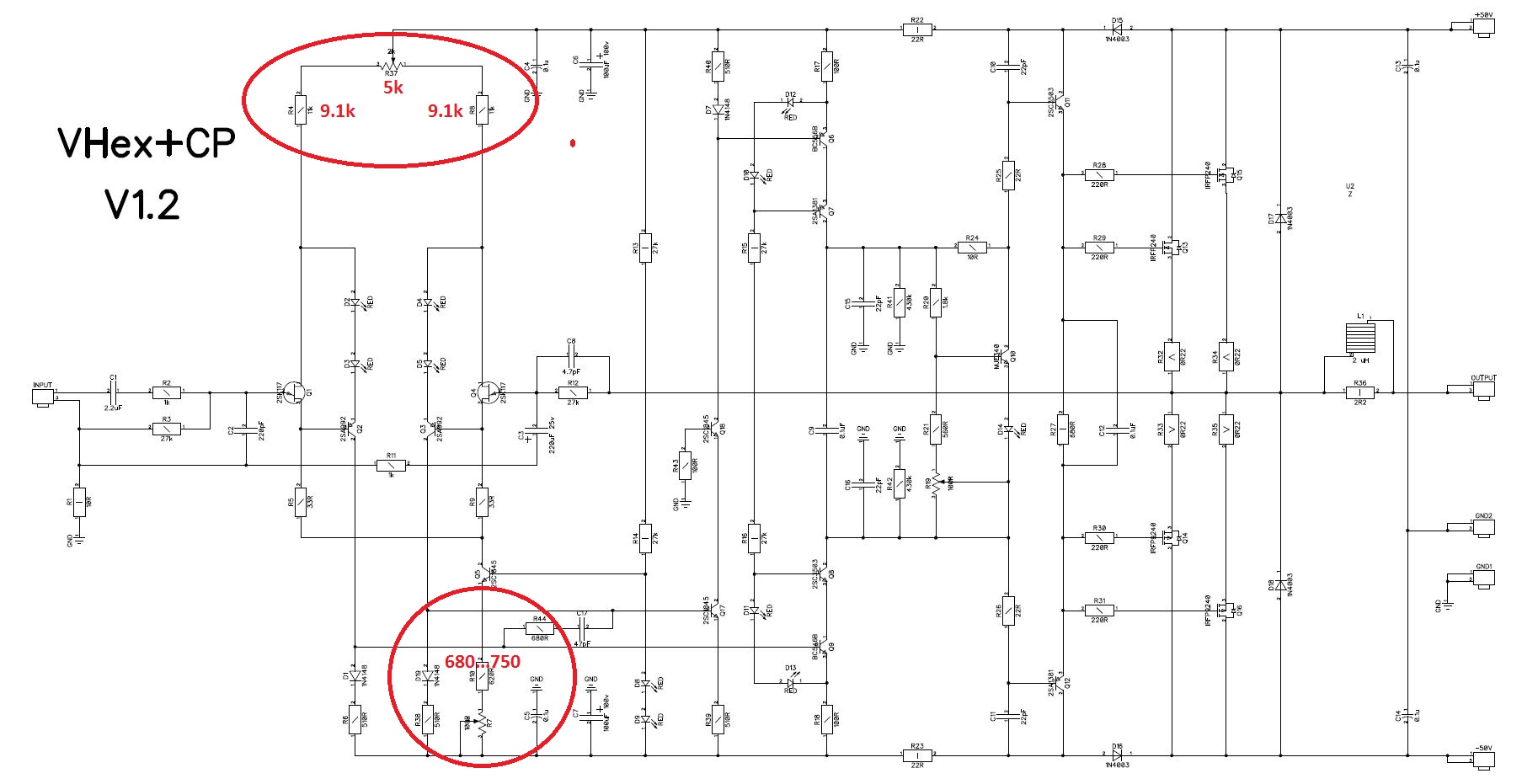

Hi Rhythmsandy,
It looks very much like a local oscillation.
I don't want to "promote" my designs here in Pete's thread - just see the OPS schematic here:
VHex variation
Note D14, C10, C11, R25, R26. Red LED in the spreader makes the tempco of the spreader very close to the one of IRFP devices. You don't need to place the LED on the main heatsink (Q10 must be there, as usual).
This output stage will work with Kypton V perfectly.
Valery
P.S. Do you have an oscilloscope connected to the output?
Thanks valery i have changed the compensation caps from 100pf to 33pf and also the Source resistors to 0.33ohm and all seems working stable.
The only concern in my circuit is the bias pot is too sensitive please suggest me what values to choose to make the bias go considerably smooth like from 300ohm pot position to 100ohm the bias could increase from 0ma to 1A. Right now im getting like for just 5 ohm difference the bias will be from 0ma to 500ma which is little bit of variation its crawling up way too fast.

That much drastic change in bias current is usually a sign the amplifier is going into oscillation.
Exactly - Rhythmsandy, if you use the spreader with the values, close to the ones at my link, having sensitivity that high - your amplifier oscillates.
Oscillation may or may not kill the output stage, but in any case it negatively influences the sound at highs. Unless you solve the oscillation issue, it will not sound as expected.

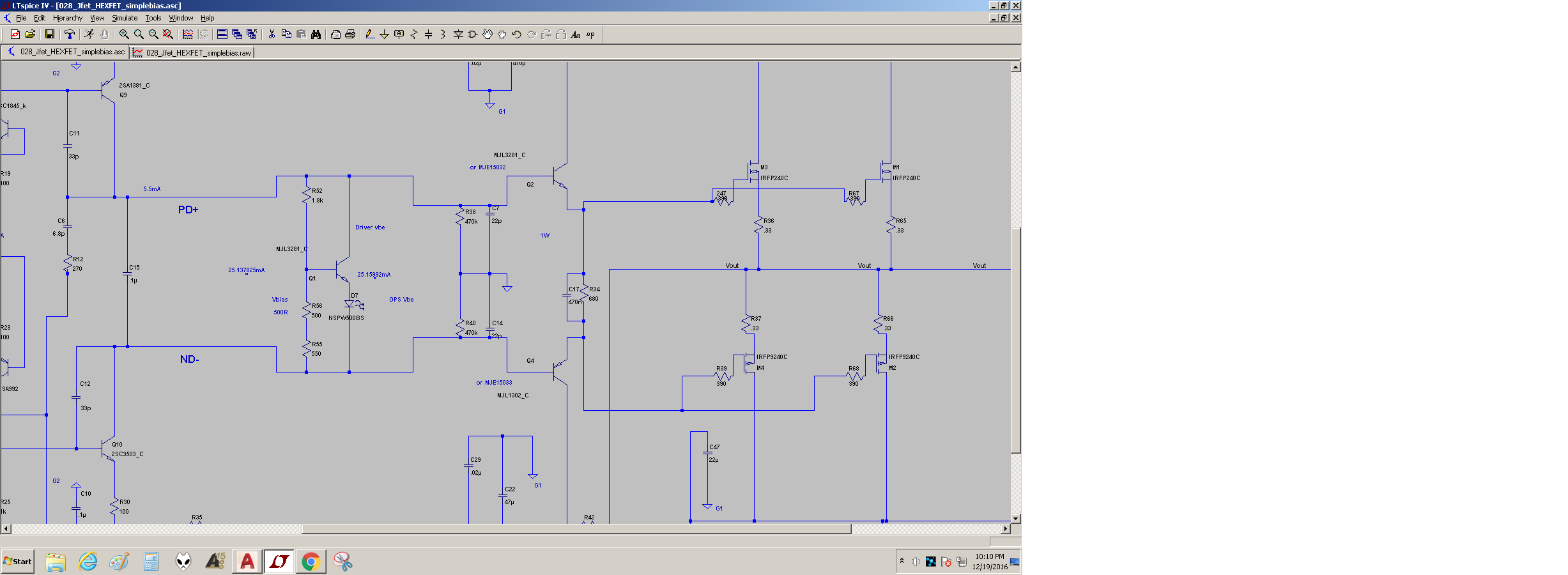

you mean to say the one in this link?
http://www.diyaudio.com/forums/atta...0855673-sons-vhex-00-vhex-cp-sch-1.2-test.jpg
Yes.
In the attached pic.
R55 is the bias controlling resistor so now i see considerable improvement in the range at 580 the bias is about 1.9ma per mosfet and for 500 its 108ma per mosfet which is quite sufficient.
Now do C7 C14 R38 and R40 responsible to stop the oscillation?
Yes, but they strongly depend on particular front-end topology and compensation scheme.
If they are not specified in Kypton V2 - you don't need them.
