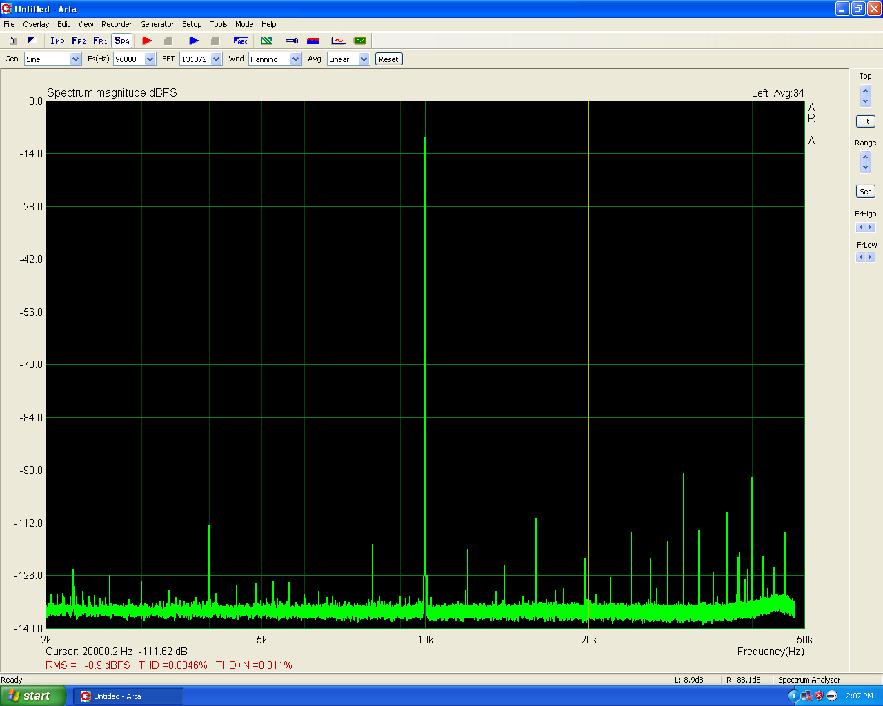

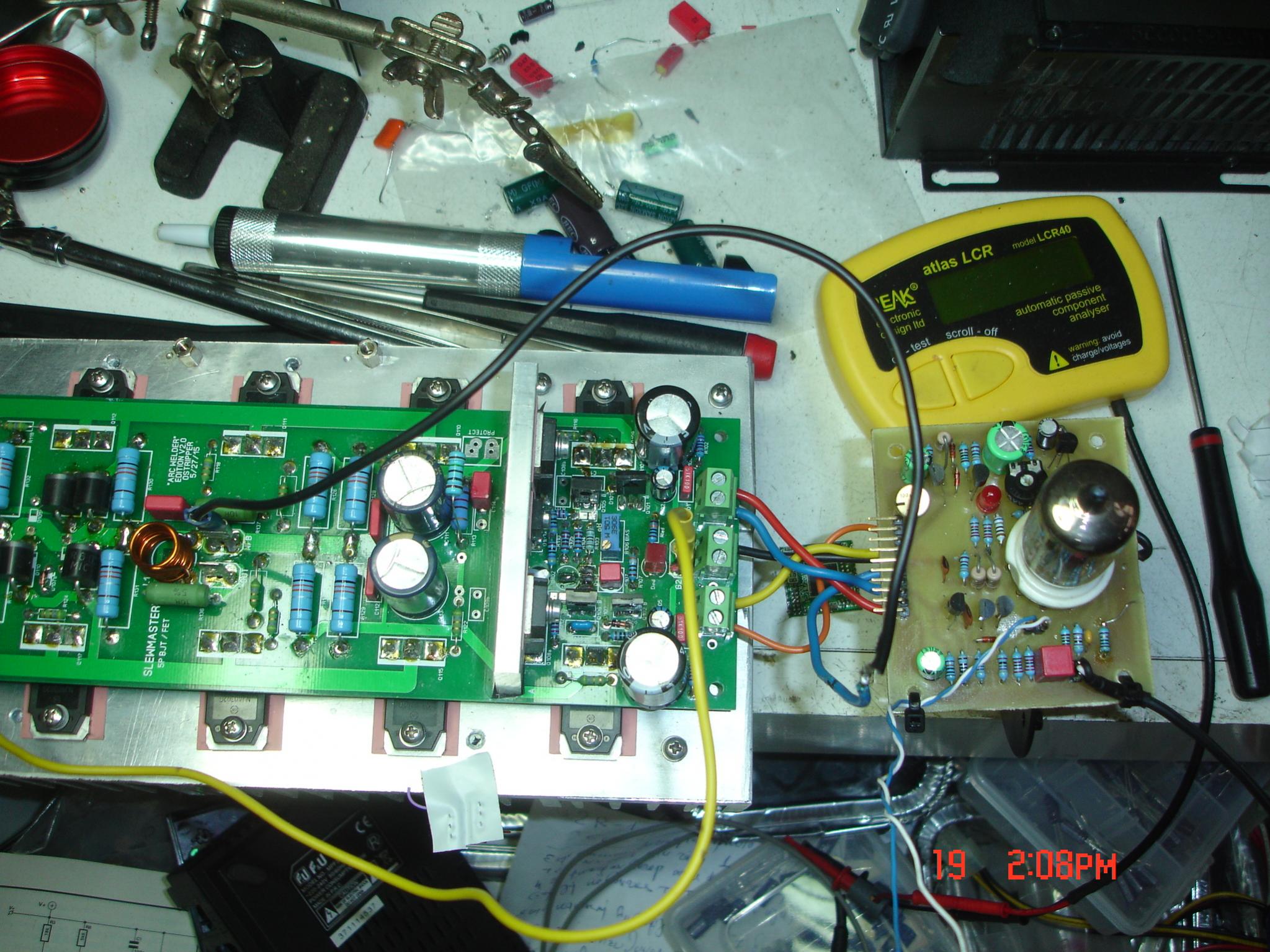

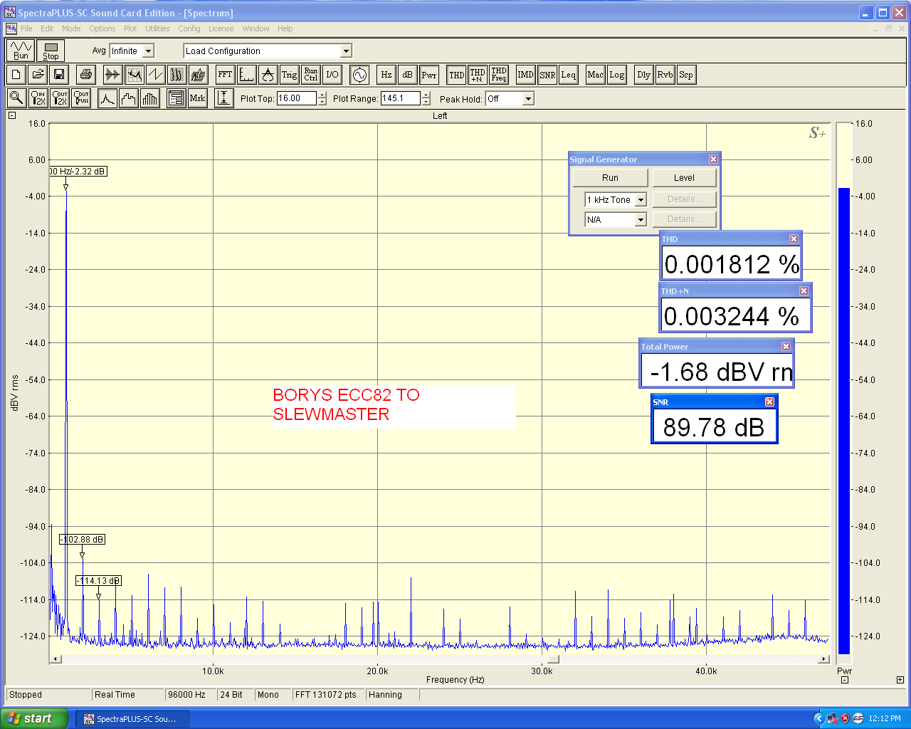

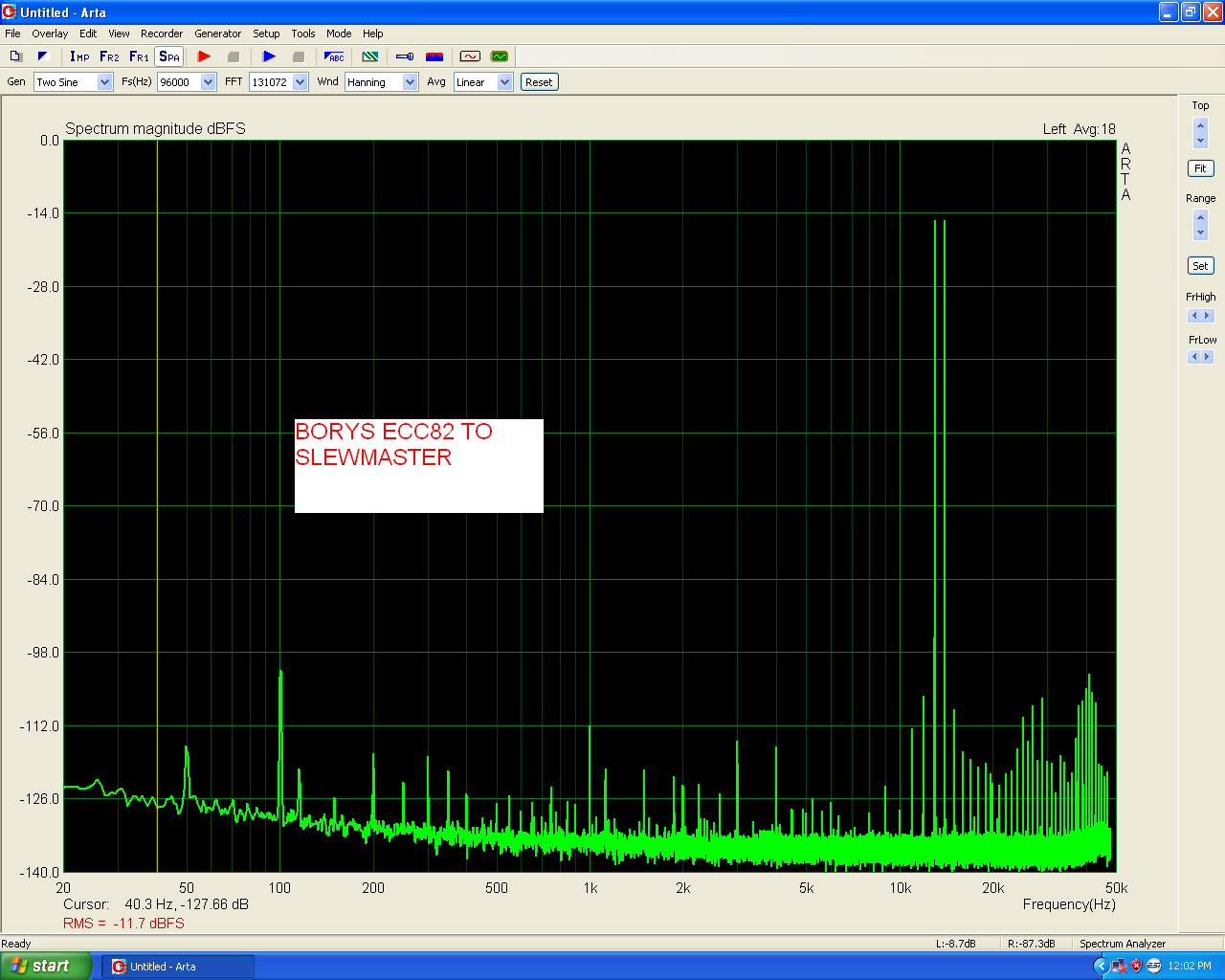

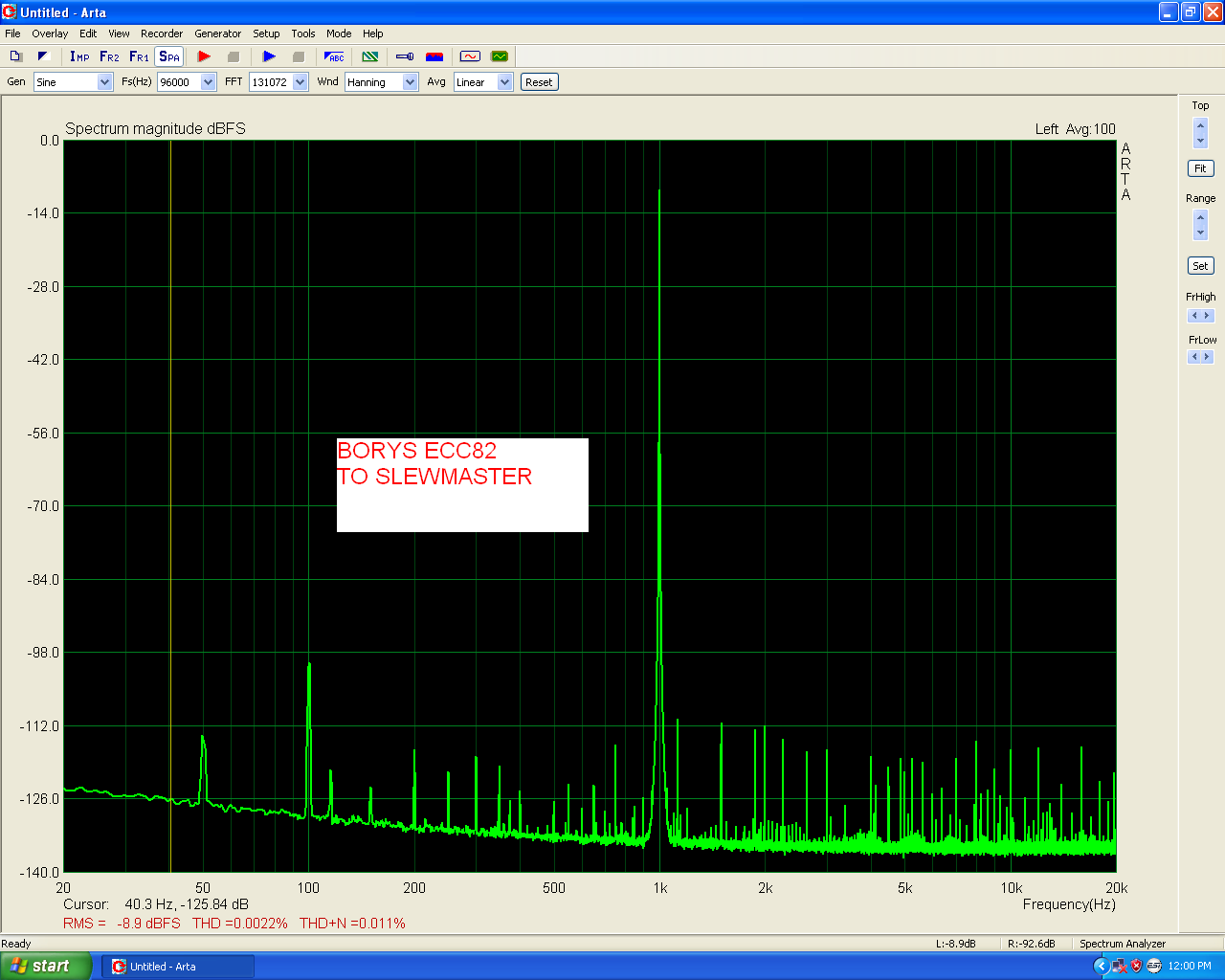

Testing this combination.

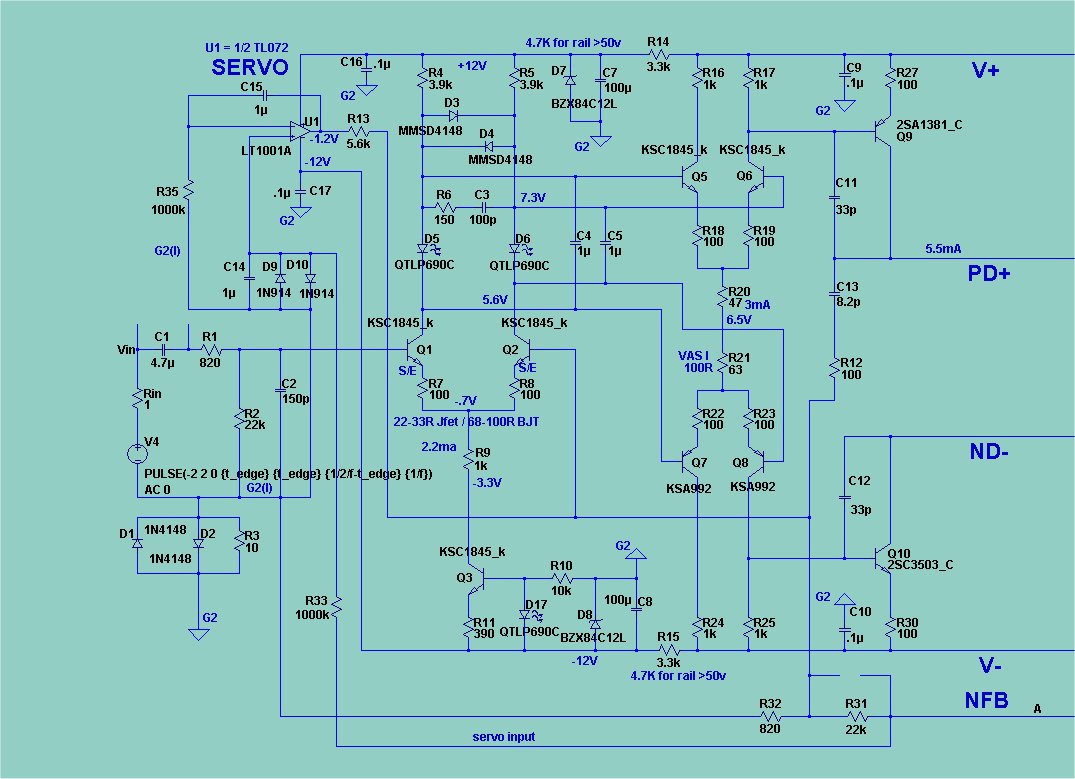

I'm trying to get Kypton V up and running. Something seems to be very wrong. None of the leds light up. If I disconnect NFB, one of them light up.
Any suggestions where to start troubleshooting?
Me and Thimios shot back and forth many times on the V. We finally
came up with the V2 (below).
The V is VERY picky about compensation (R6/C3 - R12/C13).
He said (and showed) it worked , said it was one of the better sounding IPS's.
OS
