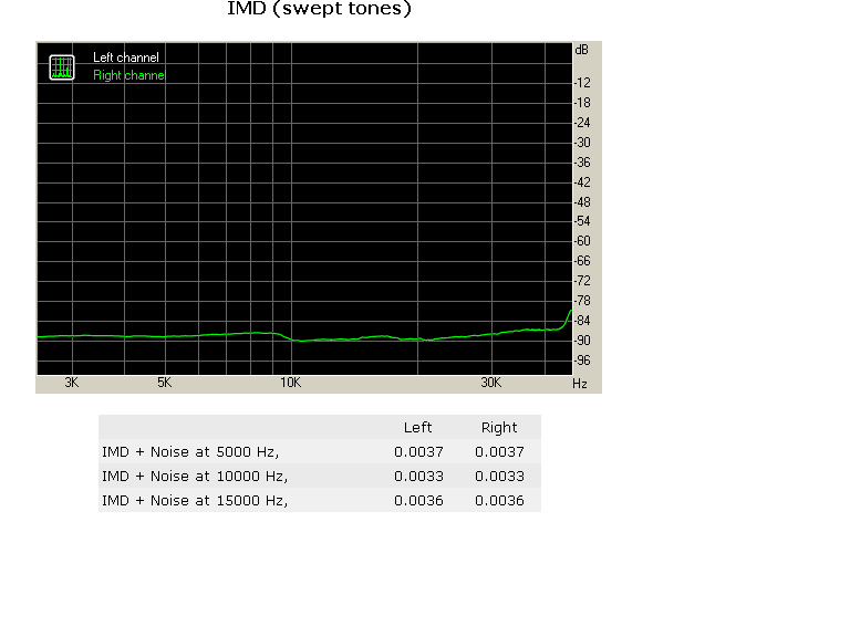

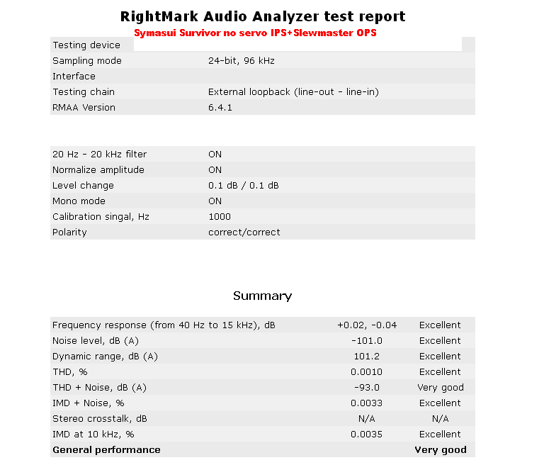

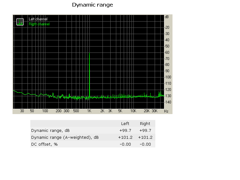

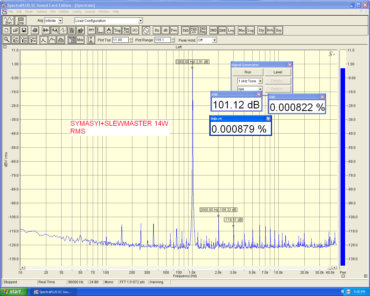

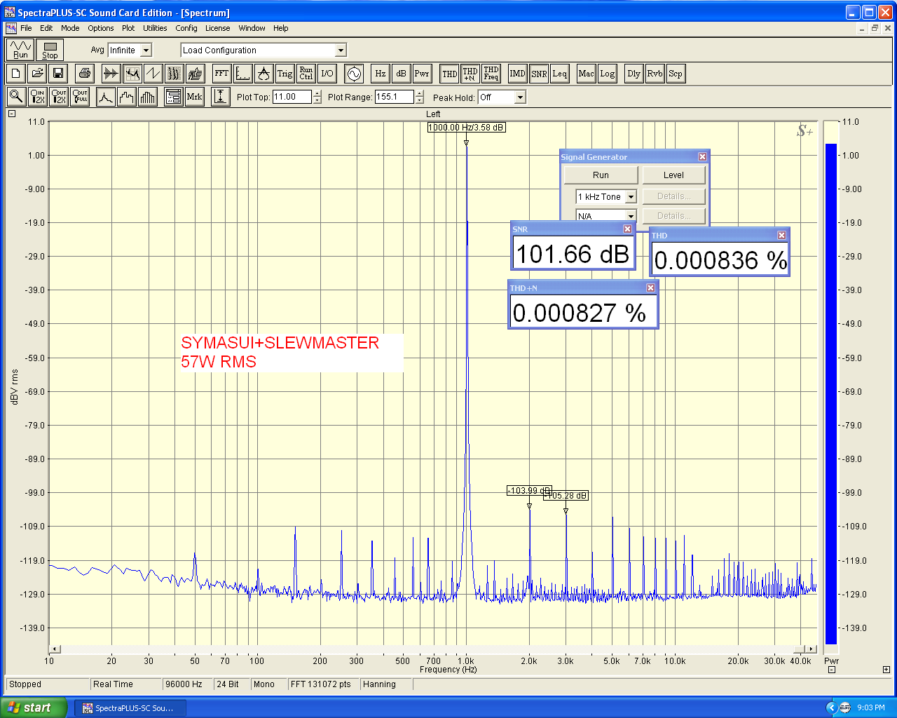

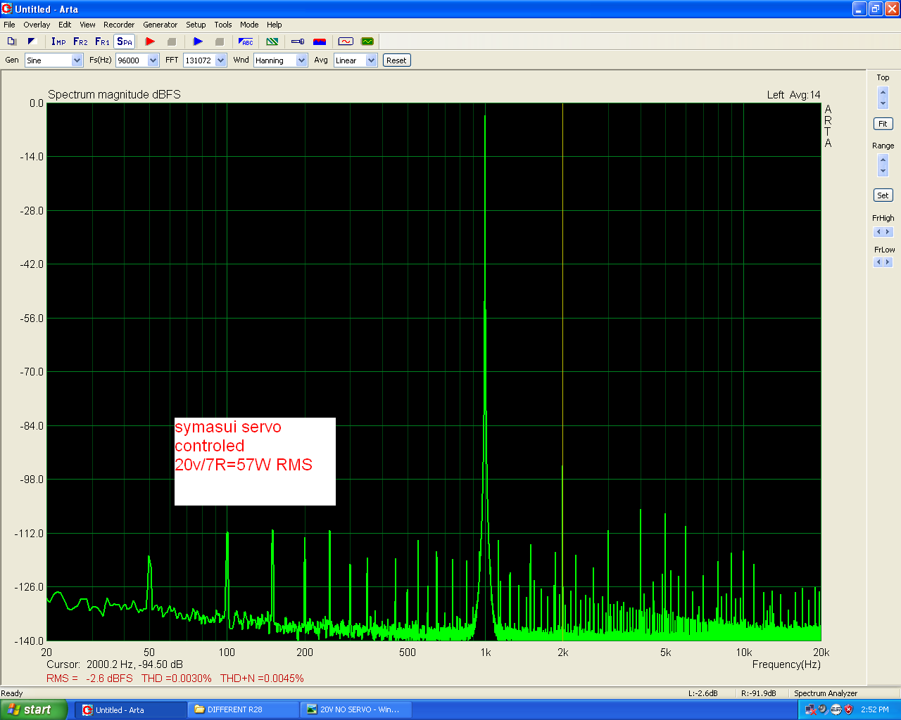

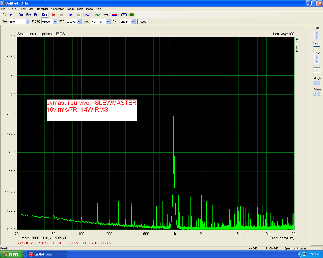

Attaching the Symasui IPS to Vzaichenko NS OPS i see that servo function is strange.
Offset start from 3v and ended at 2.9mV.
This give me the opportunity to try a non servo symasui version.
What i found?
Offset in non servo version is 2.9mV!
This Symasui survivor IPS perform far better without servo!
This was tested to Slewmaster OPS too.

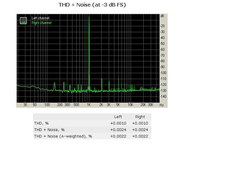

Here is the non servo Symasui Survivor on the Slewmaster OPS.
What i found?

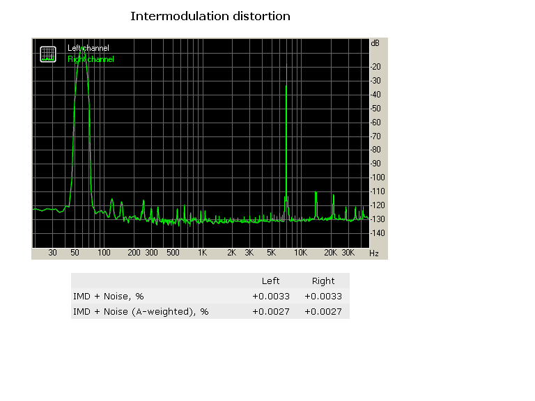

Symasui Survivor+Slewmaster no servo

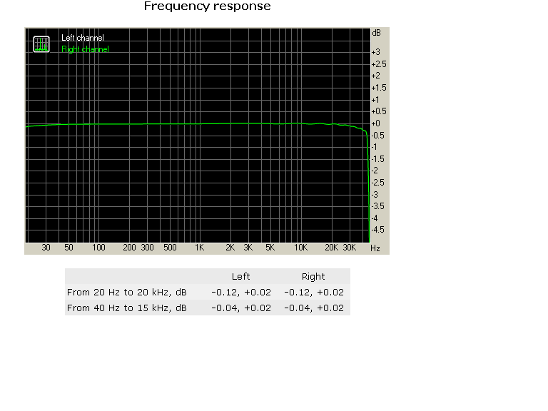

Using RMAA.
Using RMAA.

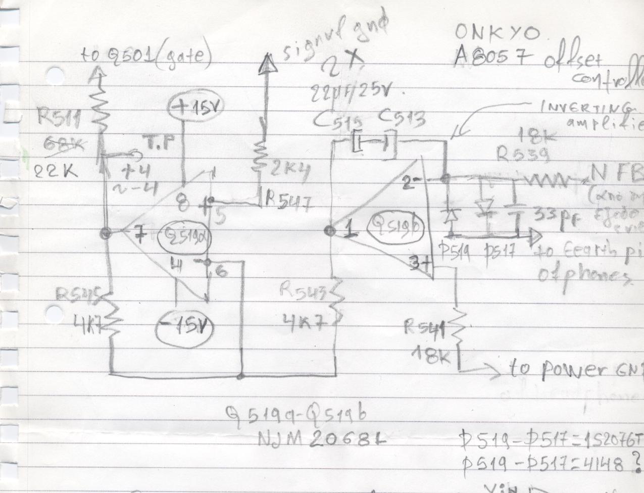

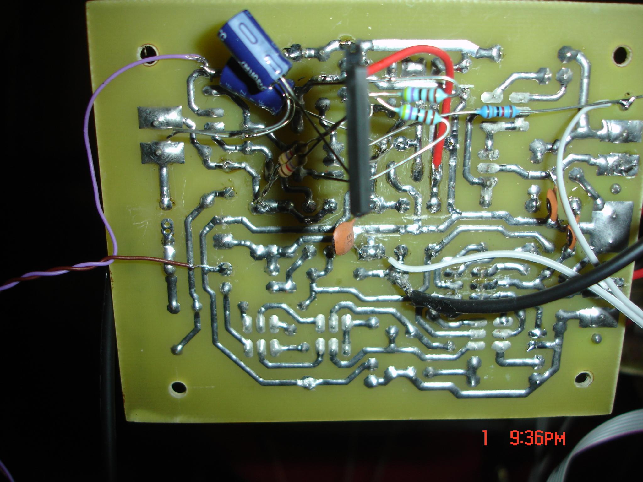

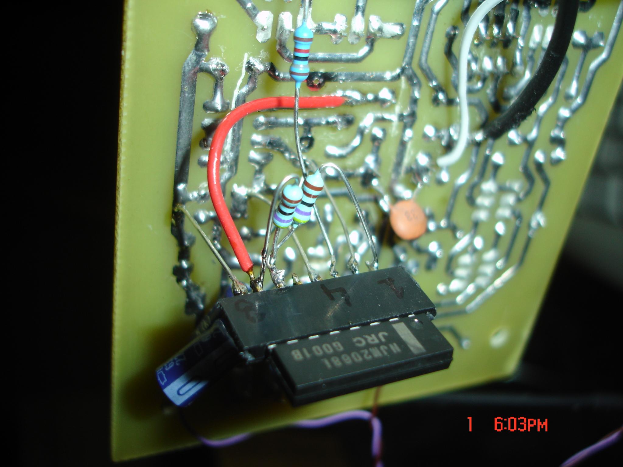

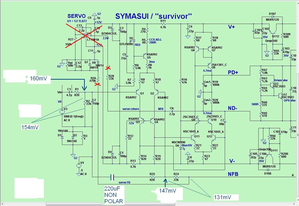

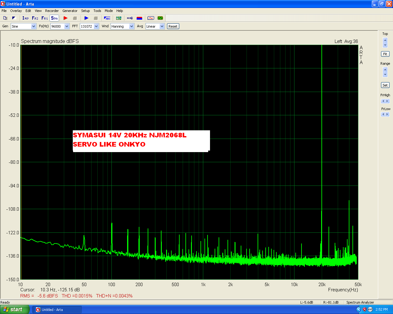

Symasui Survivor new servo like Onkyo
1)The new servo circuit.
2+3)Not beautiful but functional🙂
4)The settling time of the TL072 servo circuit.
5)The settling time of the LF 412 servo circuit.
6)The settling time of the New NJM2068Lservo circuit.

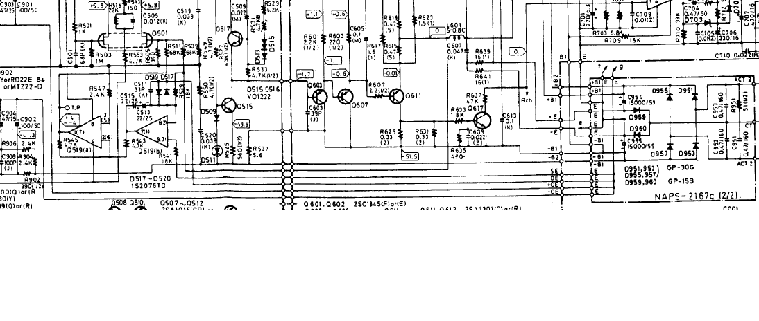

7)The original servo circuit on an Onkyo A8057 Service Manual.

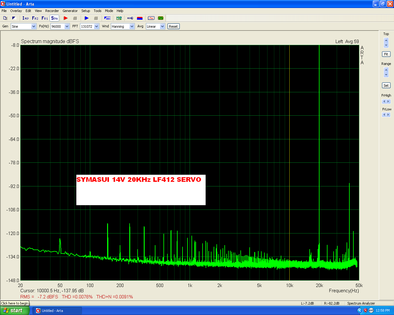

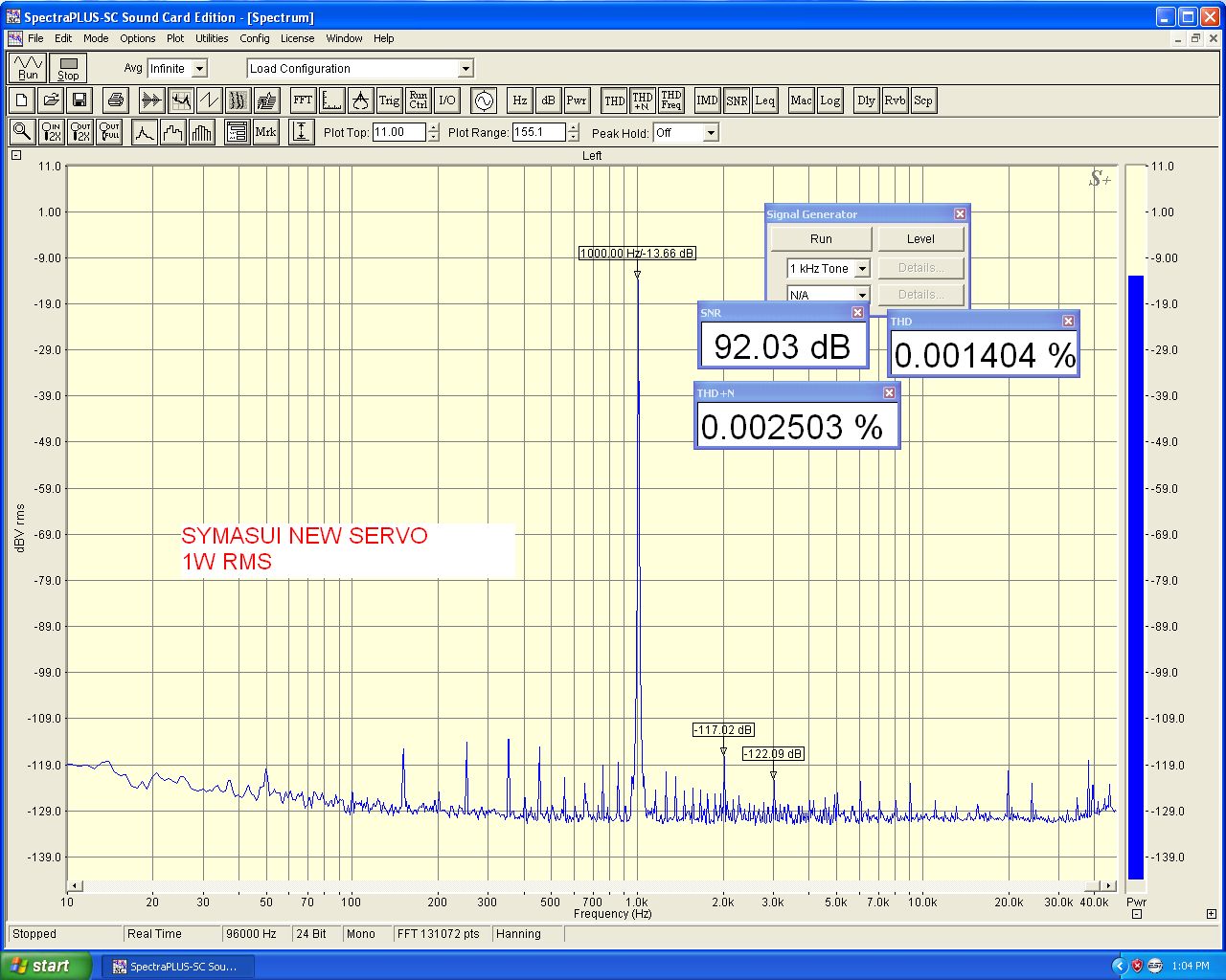

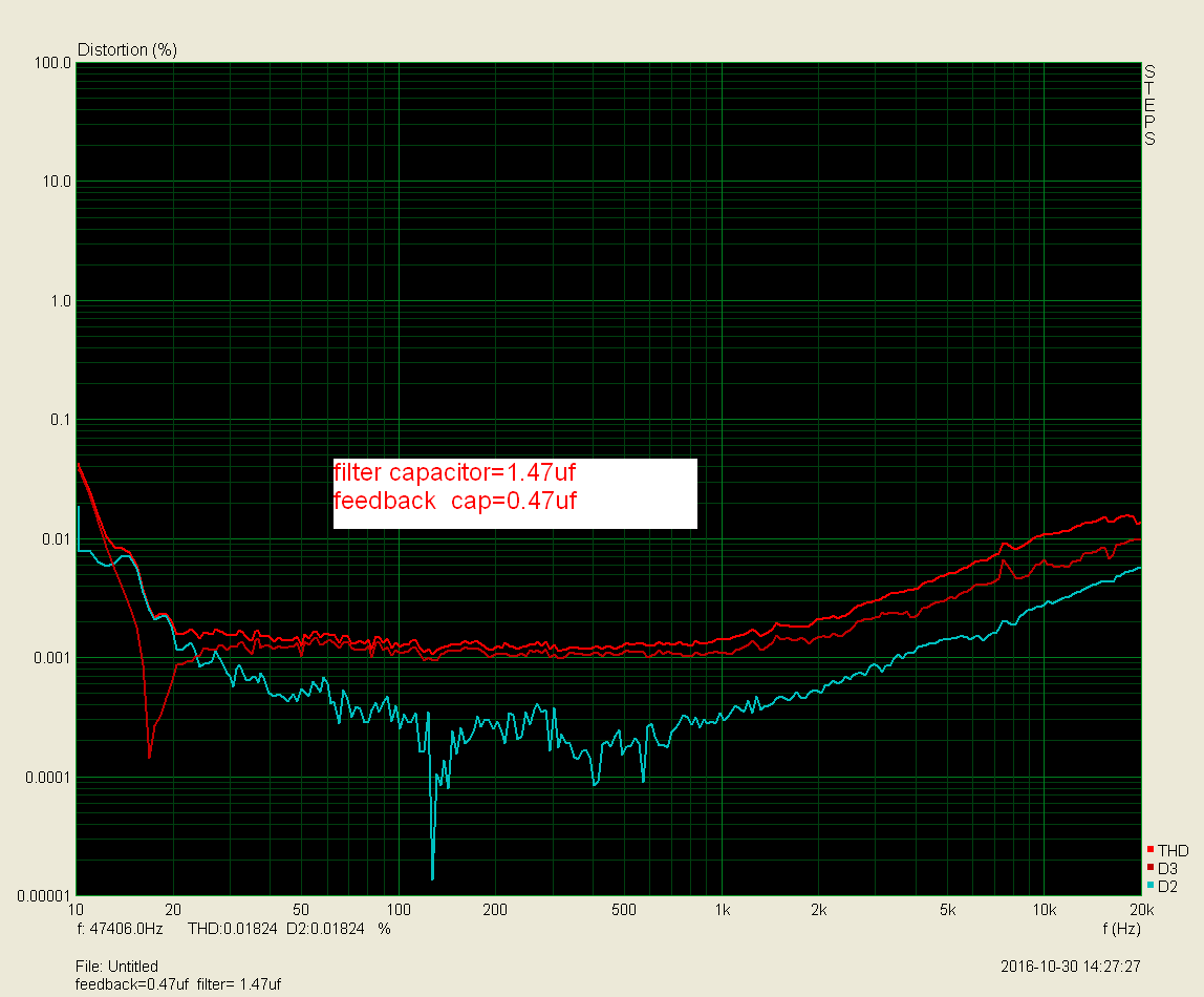

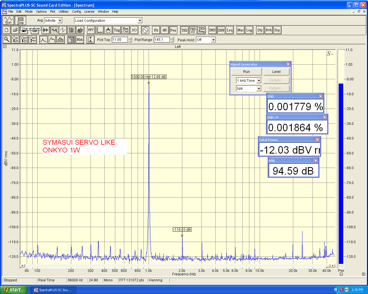

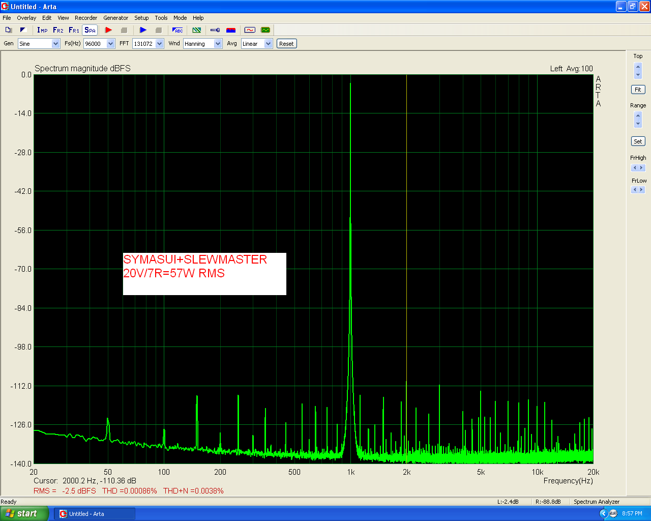

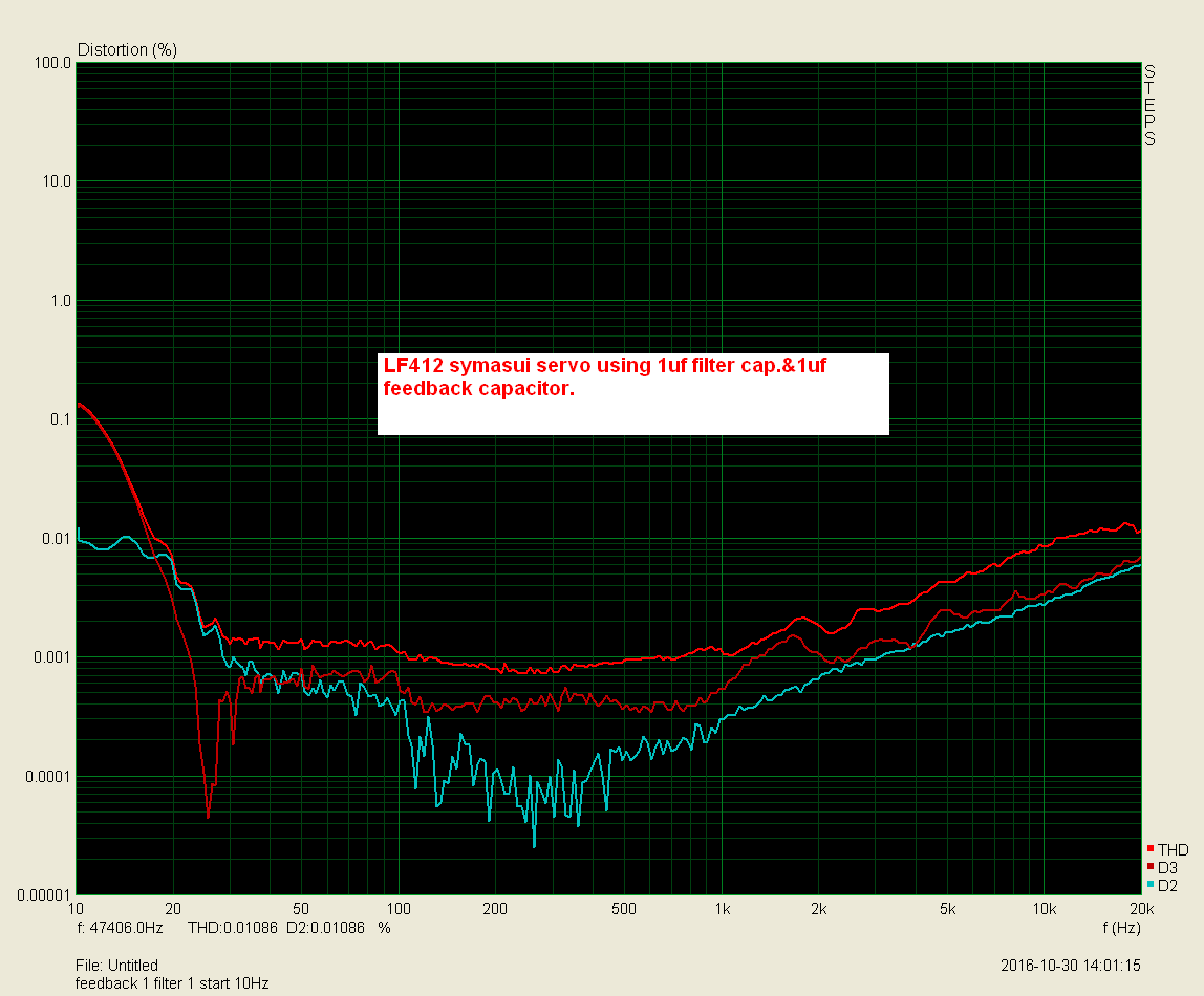

Testing the new servo
Testing using steps,this is the most suitable test for servo testing(my opinion).

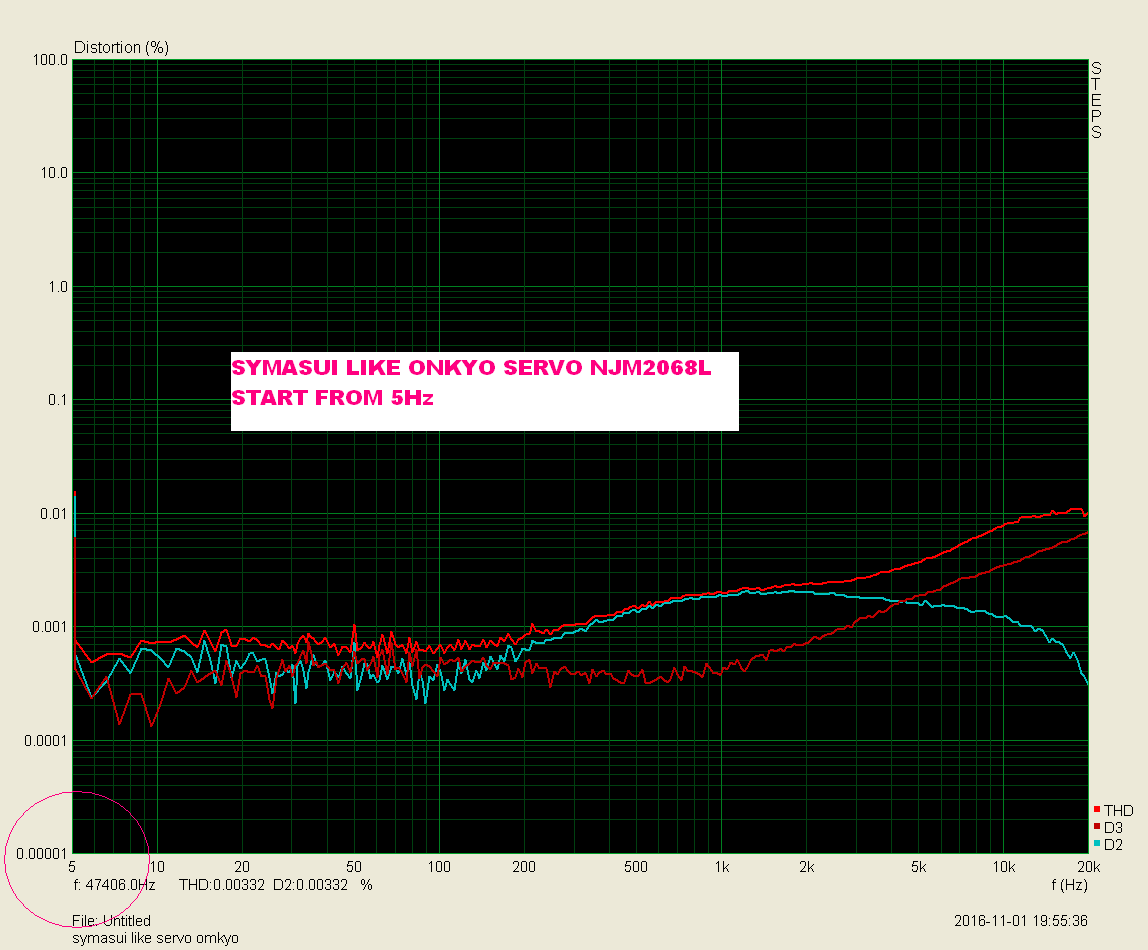

Testing using ARTA to see distortion in other frecquencies than 1KHz.
The last picture is from the first symasui servo using 1M,1M 1uf 1uf
Much better in low frequencies but i see a little jump in the 1khz area.Waiting for recommendations.

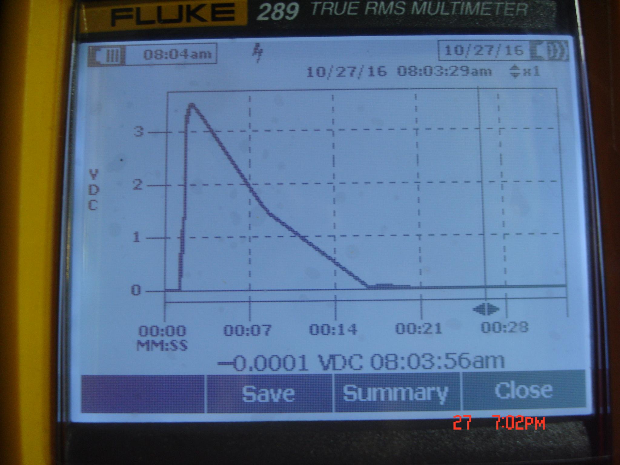

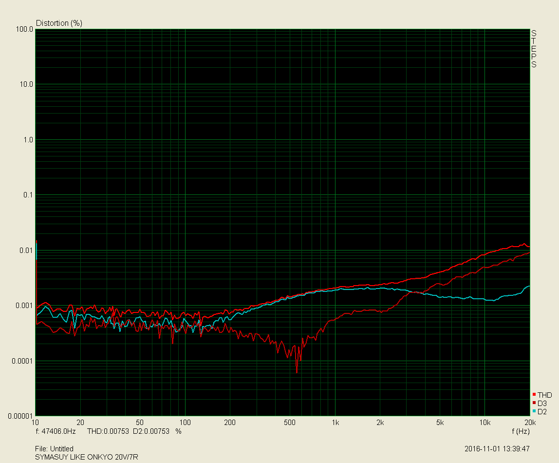

Why does the start up step to nearly 4V offset?
It should not do that.
The inherent offset is near zero without the servo.
See post#9570 picture 6.Why does the start up step to nearly 4V offset?

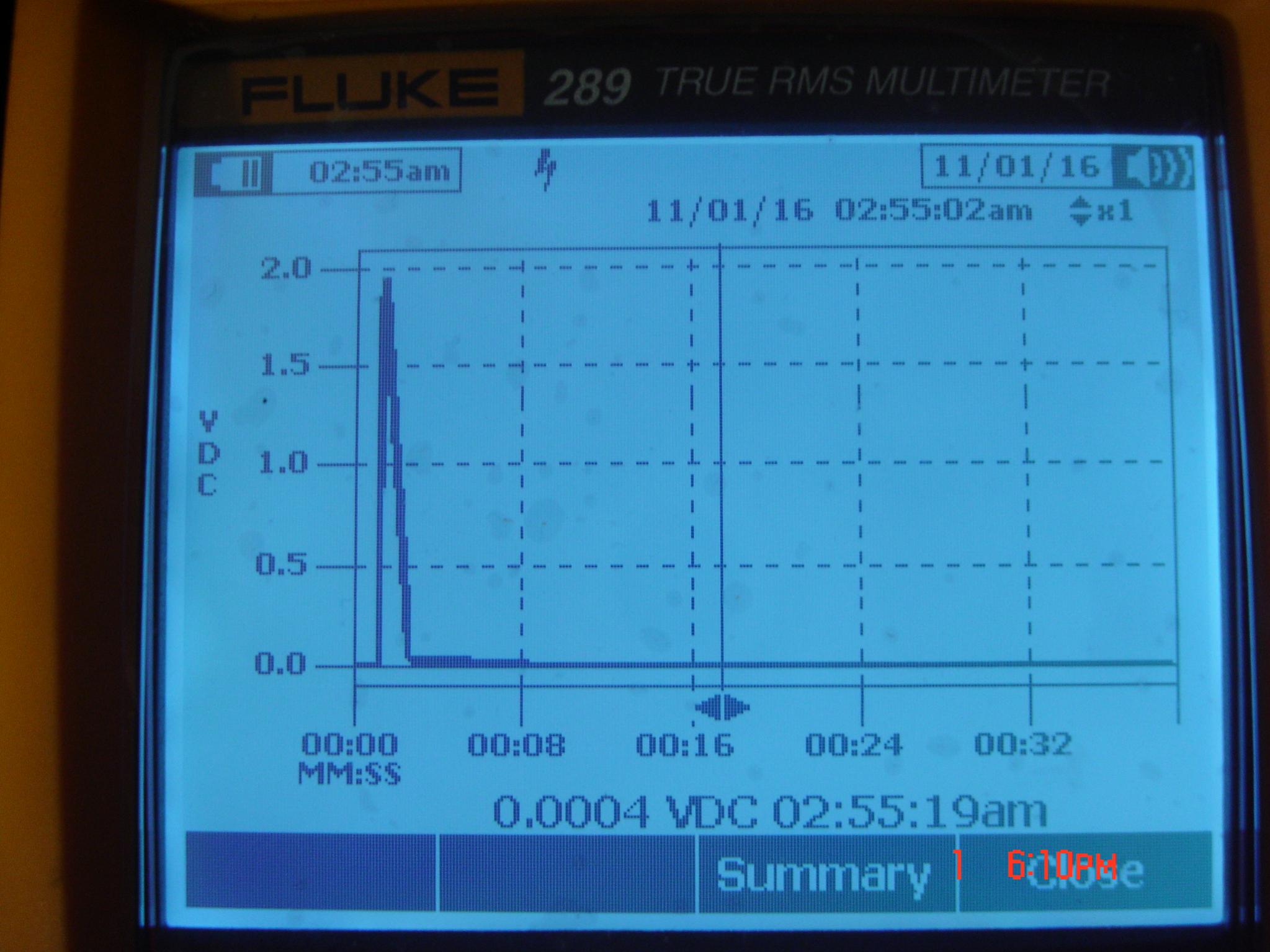

New offset circuit gives 2V only and settling time for zero offset=3''
it should not do that.
2000mVdc of start up offset is ridiculous !
especially when no servo is one hundred times better than with servo.
What you believe that is the turn on "bump" in all amplifiers without protection-delay circuits in the output?it should not do that.
but I thought you said way back that without the servo the start up offset was very low.
Is that what you said?
The issue with longer settling is not the OpAmp, but the values around it.
LF412 is far better than NJM2068L.
Sure ,but i believe that is the topologi, not the values around LF412.The issue with longer settling is not the OpAmp, but the values around it.
There isn't the long settling time only,please see Steps closer😉
I have play with the values around LF412 before without success.
If you have a better option i will follow🙂
May be Ostripper will come with a better solution.
I have chosen the NJM2068 because that is i have on my hand and because i wanted to do this without cutting traces.
