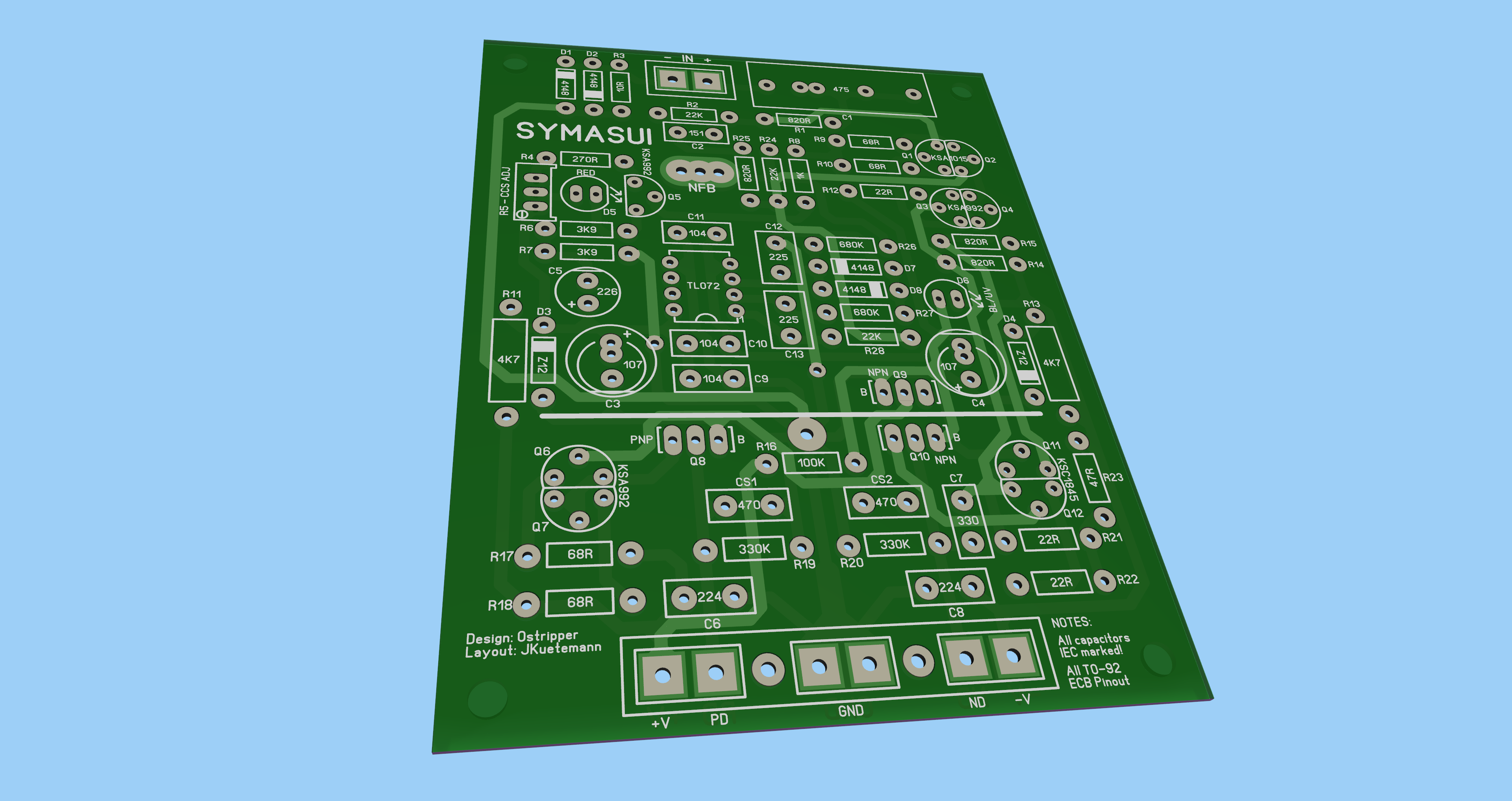

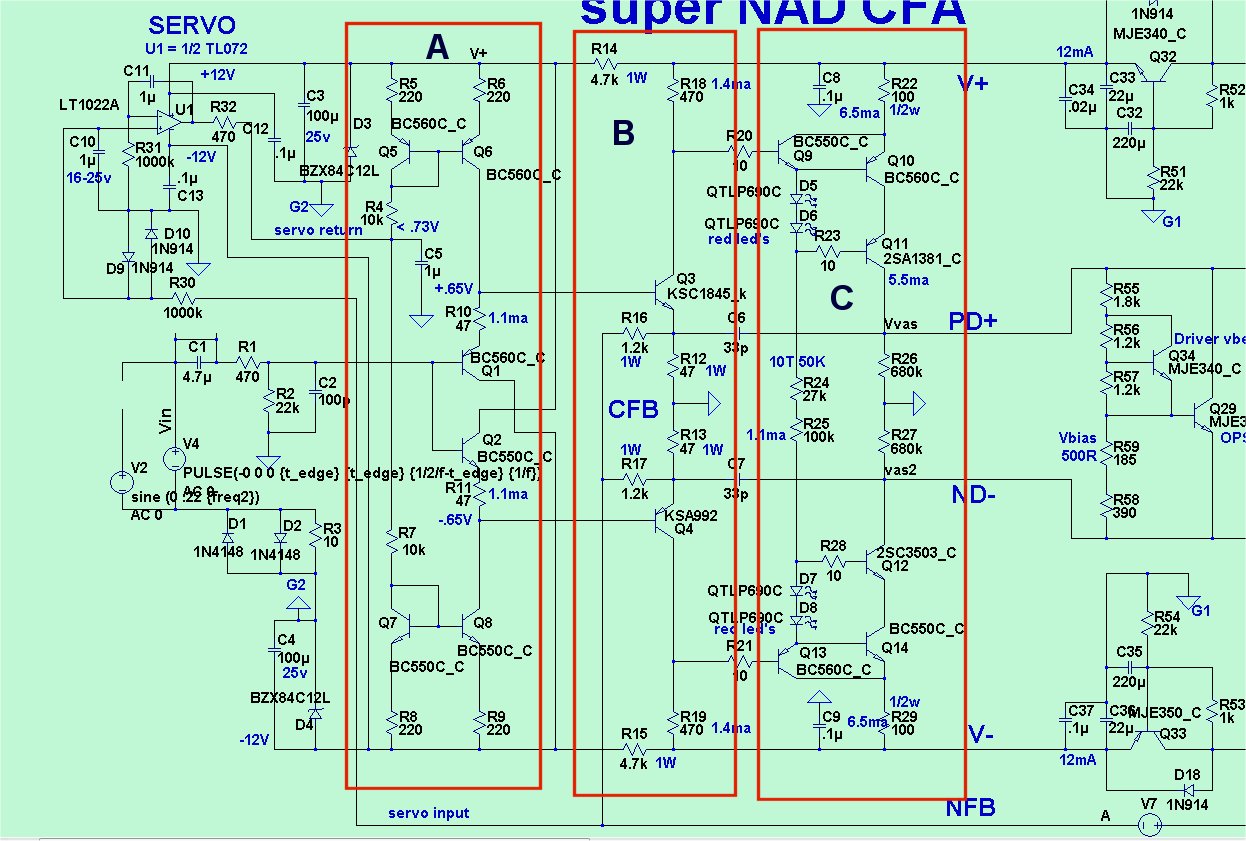

apart from the super pair it has issues. I built over 10 of these channels and the sad part is sometimes you dont get the bias. Sometimes the bias is overshooting. Sometimes the leds dont glow.So it Kypton V not the ND that have issues. Did Kypton V2 have issues too?
I agree trouble shooting by the values and I got 3.3ma output from VAS.
It was very irritating some times that even after checking the Point to point contacts everything seems fine but it has these issues.

Did you show the instability and the solution/s in another post?
It's spread over multiple posts in the slewmaster builds thread. My problem was too high vas current.
Part of the problem was thermal coupling between Q3 and Q4. They have to be proper thermally connected to get the correct VAS current i used heat shrink instead of tie wraps to press them together, that helped reduce the current.
(Even blowing on these transistors will make the vas current drop).
I ended up changing all resistor values according to this schematic
If I remember correct I had to use 390r for R18 and R22 to drop the current a bit.

The knd makes more noise on startup and shutdown (solved by adding protection boards) it's also more sensitive to RF noise. I had to bypass D1, D2 and R3 to make it quiet.
The reason I prefer the spooky is that it requires no fiddeling and tweaking for stable operation.
Here's a good explanation from OS how to tweak the knd.
http://www.diyaudio.com/forums/solid-state/260268-slewmaster-builds-132.html#post4507148

Have you seen super nad schematic 1.1 where R10-13 are 56R and R18 +19 are 390R?

the Disconnecting Network is shown in the signal line. That is wrong. No wonder it makes extra noise.it's also more sensitive to RF noise. I had to bypass D1, D2 and R3 to make it quiet.
The signal input circuit must allow signal current to Flow into the input AND must allow signal current to Return to the Source. That CIRCUIT must be complete.
Then one can add in a Disconnecting Network to attenuate interference current that passes around the loop of a stereo amplifier as shown by HBRL + HRRR in Joffe paper.
