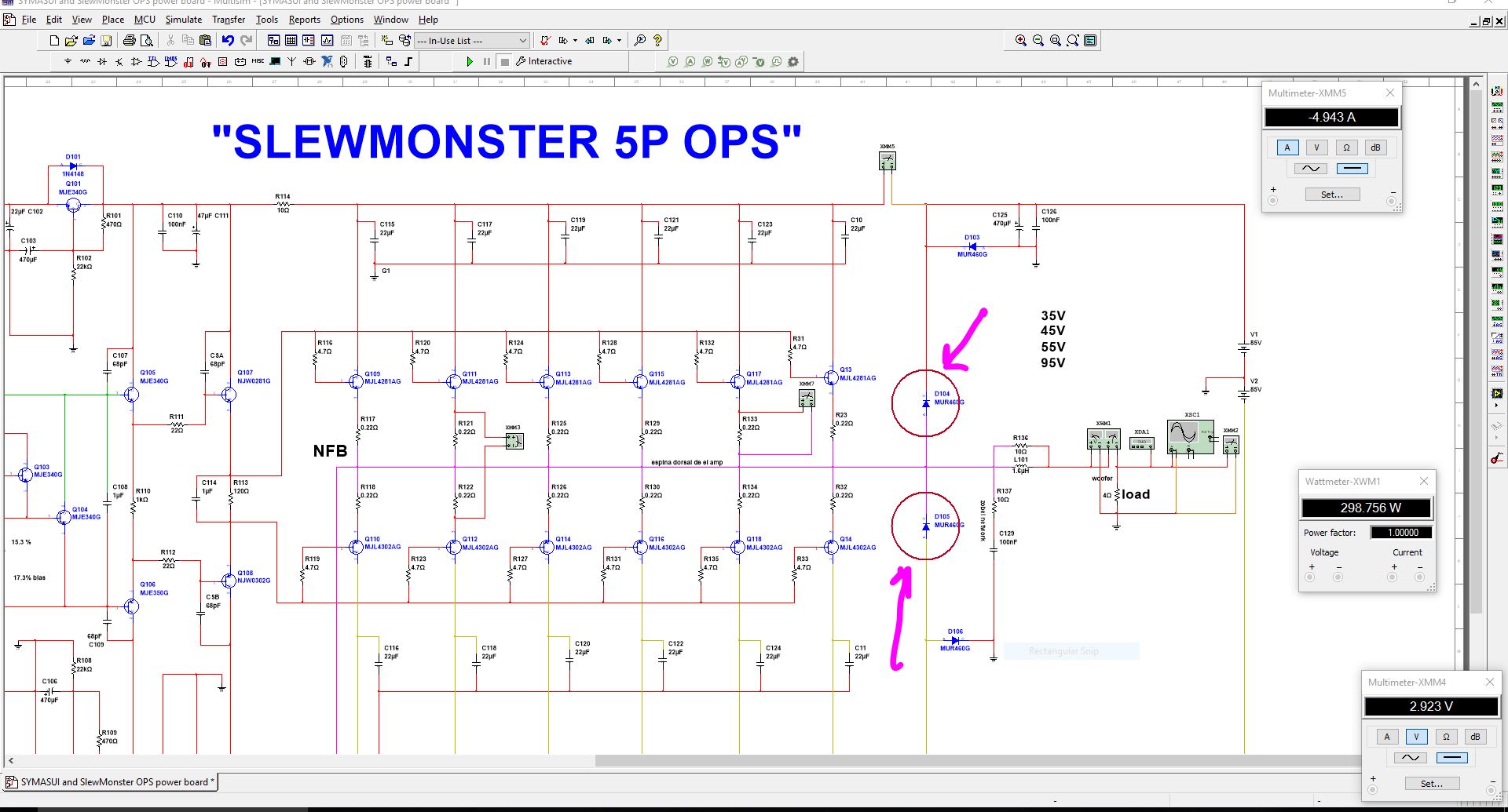

hello guys I got a question, it might be silly but is really important for me, what is the purpose of this two diodes circle by a red circle
Hi Vargas, these diodes protect the output devices from possible back emf from the speaker - if some nasty high amplitude pulse is coming (higher than the rails), it gets shorted to the rails through these diodes.
Not really a high probability event, but you know ... if it comes, it's better to be prepared in advance

these protection diodes are very important if there is current limiting or IV protection in the output stage.
The very sudden switch off as the protection is triggered will inject back emf into the output stage.
I also add supply rail to Power Ground diodes on the amp PCB. Thses protect for silly mistakes connecting to PSU.
The 4 diodes work in my amplifiers using 1n400x. These have never failed, yet.
