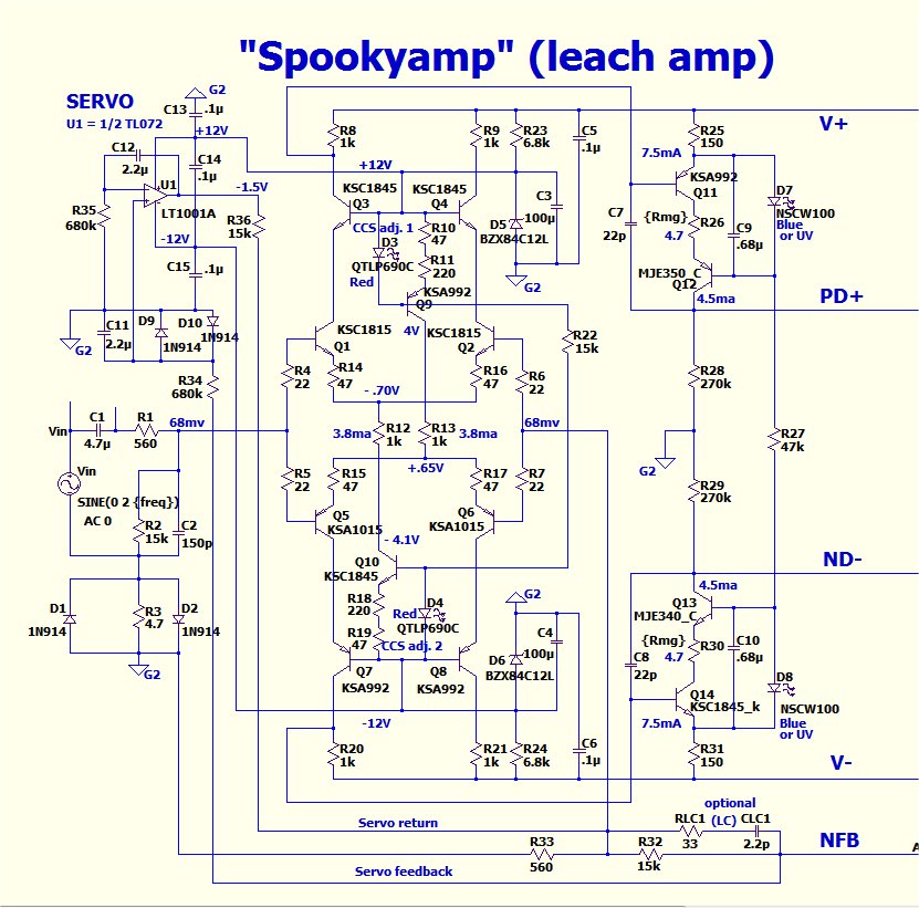

Symmetry topology like Spooky or Symmetri amplifier is the best for bass reproduction. Recently, I tried spooky amplifier with some modification (use easily to find transistors here and use different compensation and others modification). I used 90VDC PSU, it will use for party amp.
In simulation, I get 0.008537% THD at 344W/8Ohm, 20kHz and slew rate about 94V/uS. Prototype was working but need PCB layout modification for better thermal management. Sound fantastic in low frequency and the mid and high frequency did not sound any harsh at all. Bias current is very low, about 10mA 😎 It sound like a hi-fi amplifier rather than audio pro amplifier 😀 😎
This was the spooky ips pcb layout by jknuteman. Yes, vzaichenko is right .There is the servo . If it helps anyone,I done the (Q1,Q2) & (Q3,Q4) as there is requests of philips or generally bc550c bc560c as input transistors . 20-23 years ago amplifier worked easy really easy , with no servo and the two pairs hfe matched with DMM hfe tester. was enough.

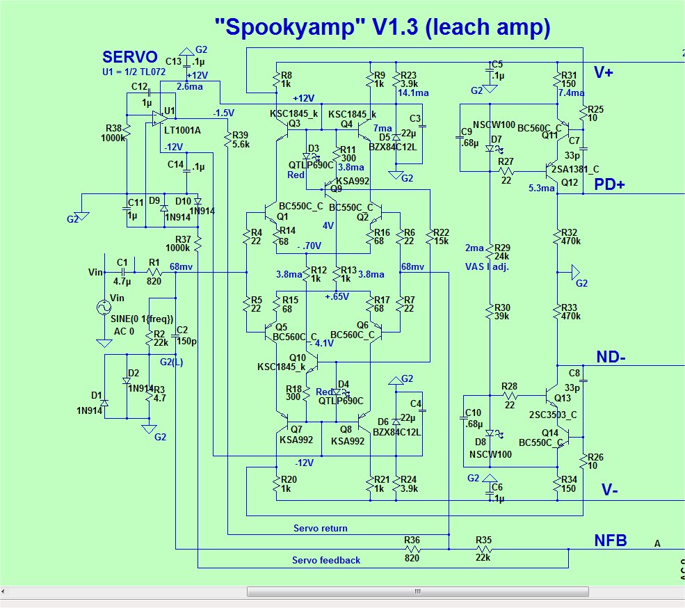

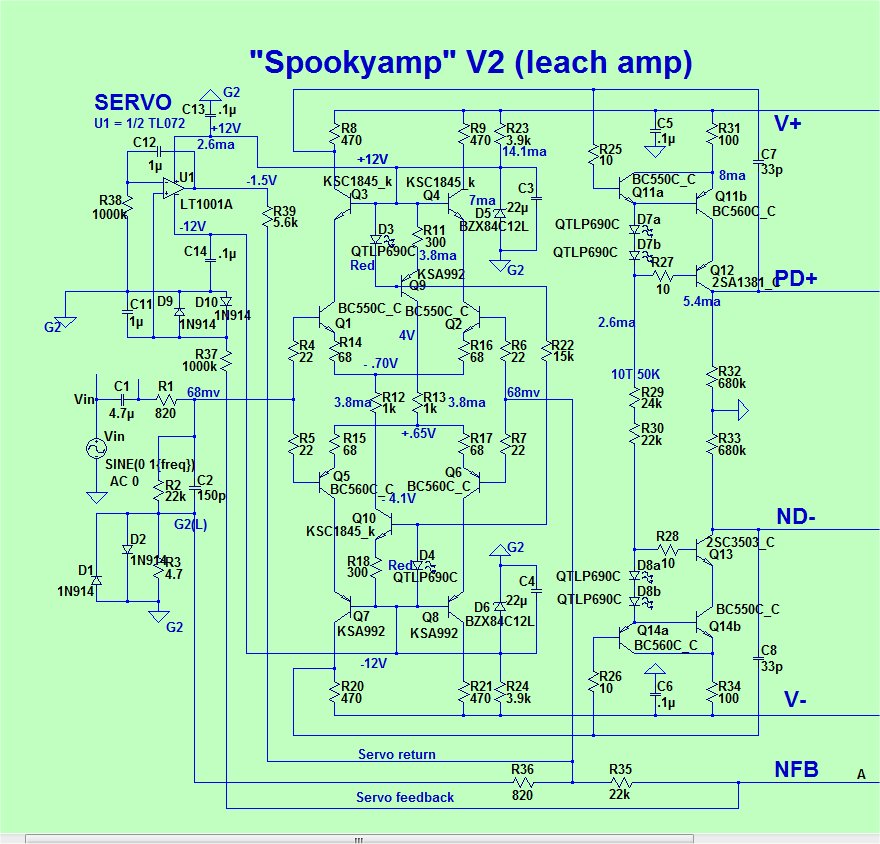

Spooky versions
Has anyone built all the (3?) versions of the Spooky and compared them?
Any advantages or disadvantages in using one over the other?

Has anyone built all the (3?) versions of the Spooky and compared them? Any advantages or disadvantages in using one over the other?
Ostripper's website posts FINAL = Spooky V1.2 which does not use the super pair circuit, and instead goes back to the standard Hawksford VAS. Ostripper stated that this is his favorite Spooky... favorite bass amp. Your posted V1.3 appears to use a few different resistor values.
http://startfetch.com/ostripper/docs/Spooky/Spookyamp-V1.2-final/Spooky-V1.2-schema.gif
The Spooky V2 you attached uses the super-pair in the VAS circuit. The super-pair adds a local feed forward loop within the global loop of the whole IPS. The super-pair has some value with lower loop gain IPS and in CFA, and even the Spooky front end. BUT.. The super-pair adds instability, especially if all of the VAS stage transistors are not matched. Ostripper recommended using matched transistors arrays for super-pairs.
