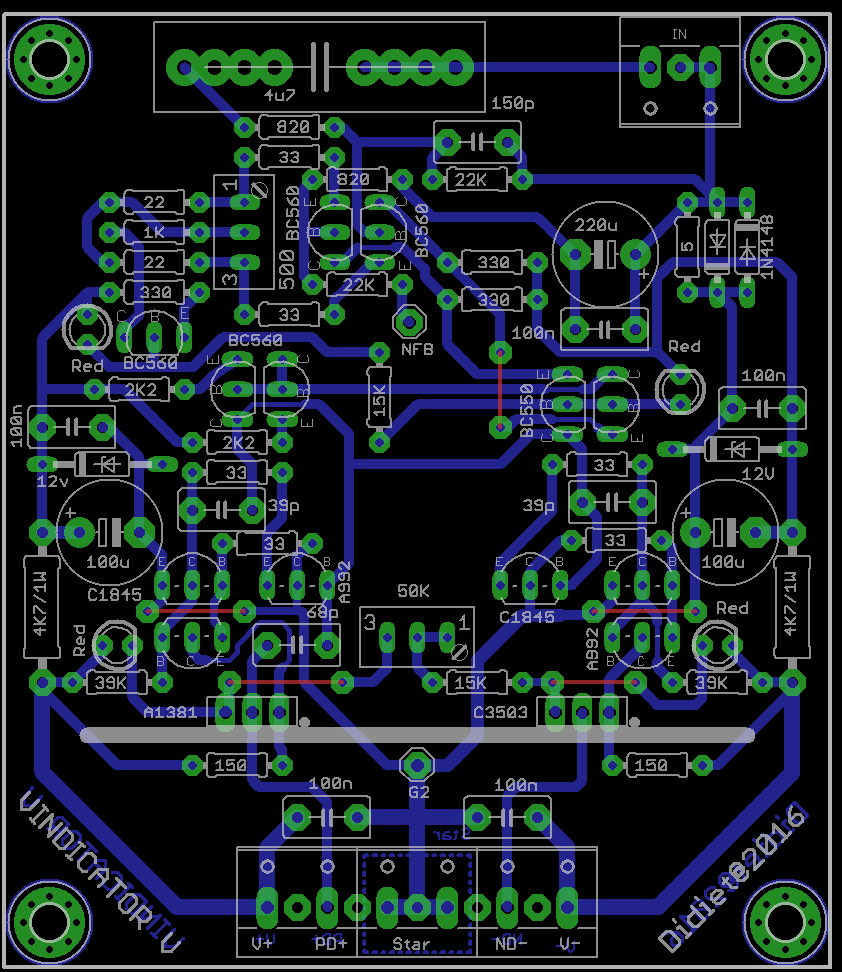

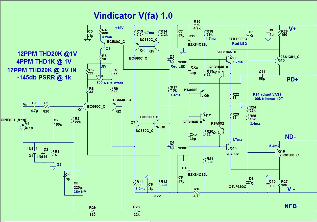

May I request you to kindly post the schematic and PCB side by side in your posts? This can avoid lot of misunderstanding and members asking for reference later on.

Is anyone completing the design of the super-duper output PCB with interleaved NPN-PNP outputs... larger power capacitors... etc.. Maybe for 4-pairs of M1 Sankens which nicely fits the Heatsink USA 10.8” long, 3" high, low cost bare Aluminum. It would also be useful if two of these output PCB can be connected in series with a few thick wires for high current, low voltage designs... 5, 6, 7, 8 output pairs.

No. Maybe toner transfer. If anyone gonna order PCB , i can send the gerber file(s).
