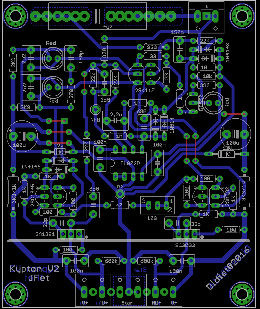

The "Tubesumo" and the Kypton V are where me and Vzaichenko's designs (traded) techniques. They are nearly identical.
The first Kypton V also did not play well with the Slew EF3. The extreme OLG of
of the 3 stage IPS highlights the baxandall super pair poles. I removed
the superpair enhancement on the V , and Thimios's test of it was stellar.
So , the Kypton V2 ... with the Valve instead of the BJT's (and minus the Baxandall)
Or , the Tubesumo design ... with the super-pair removed and the VAS Re adjusted .....,
should be very well behaved.
The only shortcoming of the Valve is the long startup time.
PS - I would prefer a nice matched pair JFET LTP over either the valve or BJT ...
best of both worlds !

Where and from who can I buy those Kypton V2 boards?
You have a pm.
Do there exist a schematic with jfet input?
