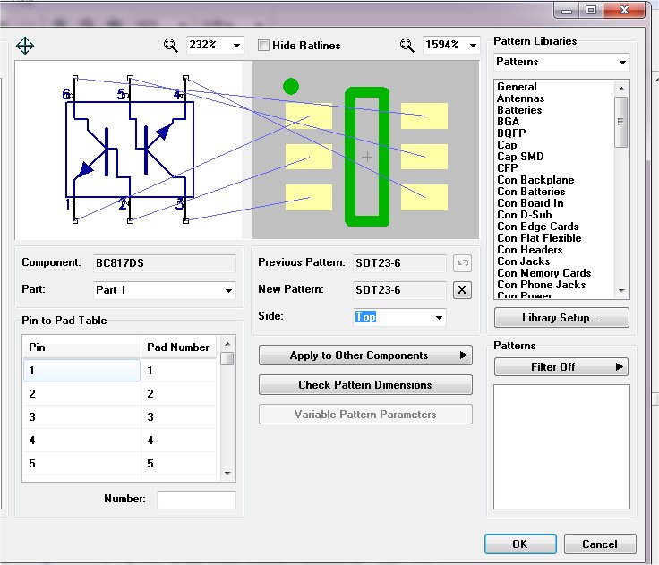

I not only had to make most of my own components (below) , but had to
consider what the most common internal pinout is for low voltage and HV
dual SOT23-6 packages are.
The dual 807/817's are going to be my choice for all differentials (on all
my IPS's). Single 807/817's for the active hawksford semi's and ZXTD4591
"greenie's" - N/P matched for super-pairs.
All these are 3X3 mm bigger SMD. I don't know if the 363 packages will
fit the SOT23-6 pads , but their pinout is the same for both LV/HV.
So - just BCxxx , 5551/5401 , TL071 , and our favorite 1381/3503's .....
all standard cheap (.11 - .49$) parts.

No, different pitch!!All these are 3X3 mm bigger SMD. I don't know if the 363 packages will
From I remember there are duals available in the common SOT23-6, SOT126, SOT-363 pkgs. EIAJ may have a few more too. iirc i think there is even a sot-563.
Might be possible to make a multi-device footprint, I have never done it for these however.

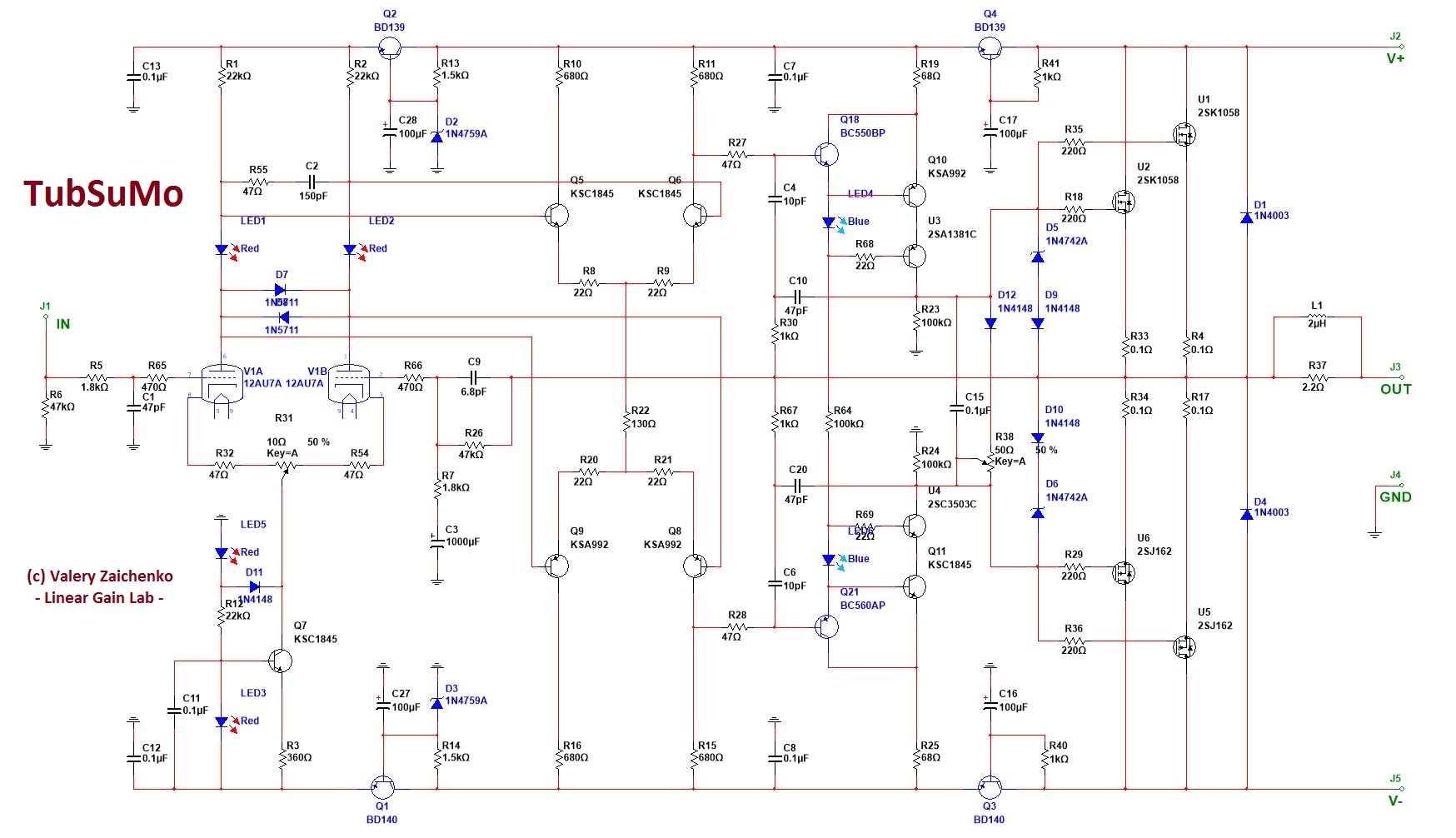

Im thinking to use 12aX7 valve at the input instead of bjt or jfet.Those might be good as a TO-92 and 650mW. Here , if you kept the rails

what is your opinion on using valve at the input? Can it give that micro and nano details?
OMG !!
I know you all have seen the forum hybrids. Good for those that have created
them.
A valve has no place in a modern SS amp. Keep it in the pre-amp.
I want an amp that settles in milliseconds and lasts 20 years.
No 6V heater supplies , No valves here. Sorry.

I have seen one of the member did the valve input in the similar setup but with super pair output.
People who reviewed expressed very nice sweet sound.
But I really have a doubt that can a valve beat the micro details of Jfets?
so the valve doesn't settle in milliseconds?
This was the amplifier that brought about the 21st Century Protection system. The tube needs to be warmed up for 30 seconds before the rest of the amp is powered up, otherwise output voltage was pretty wild on start up.

You can only build and listen and compare. At this level of performance the difference is very subtle - micro-nuances. This is a very fine amp, but in the end - different people have got different tastes.
