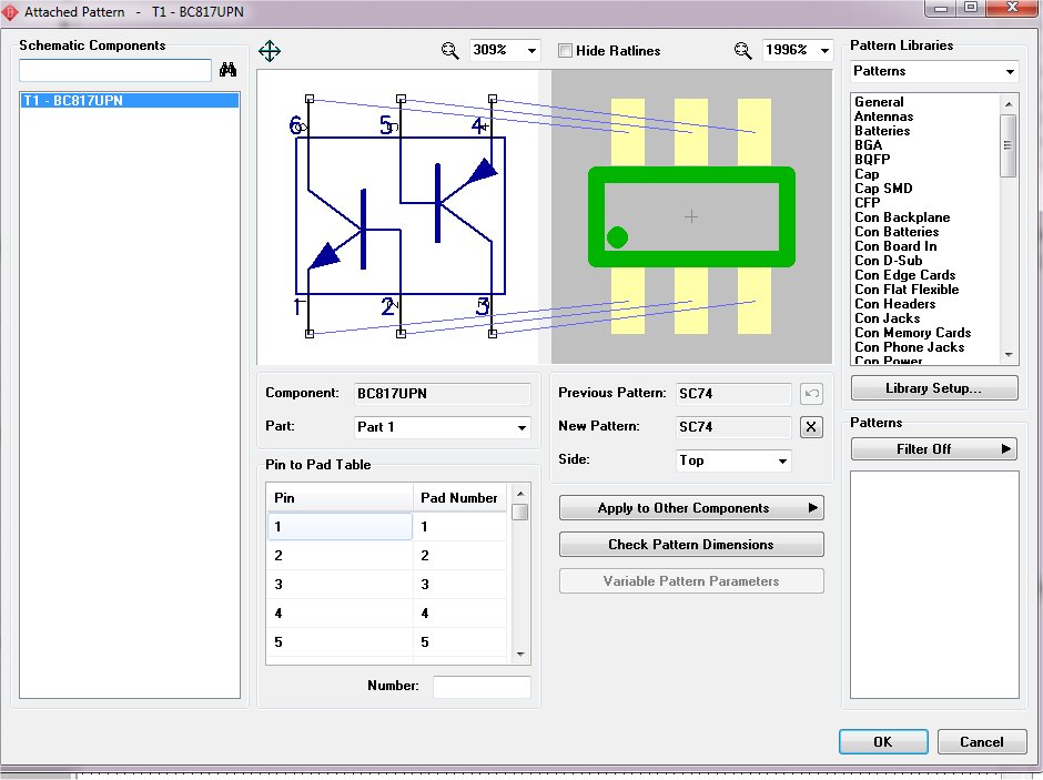

(below) is the library of it.
I now have all the SOT models/libraries - I'm "dangerous" now !!
I know they are smaller , but the SSOT-6 or the infinion SOT457/SC-88 (whatever) are DIY friendly.
The outline I will make to take anything from the 363 to the SSOT (bigger).
So whatever teeny tiny SOT to the big SOT will work with my final layout.
I will also make any single SOT semi universal from the tiny to the
"supersot" 3mm package.
PS - I want to be able to do this , as well. (i am old , too).
Edit - I have to make a component layout that accommodates SSOT -6 /SOT23-6/363 - all at once.
Builders will have a great choice of dual device options.

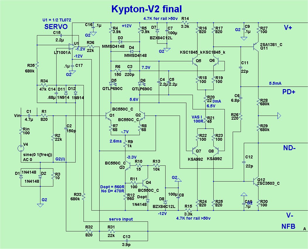

Ostripper can you please let me know about it? do we need to match Q5,Q6 pair Q7,Q8?
Not critical , but at least get close.
NFB will correct everything .
Even as this is true , the closer you get to optimal ... NFB will not
have to "try as hard" to correct mismatches.
When I make this one a SMD creation , this issue will no longer exist. 😀

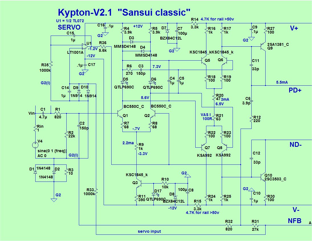

Oh , you might want to look at K-V2.1.
Any layout based on v2 is the same ... just some value changes.
V2.1 is stellar 8ppm max power goodness. Sansui would be proud. 😀
Edit - C3 and 6 are the critical components , 150-270p for 3 and 3.9 - 10p for 6.
the tradeoff is overshoot versus 20k gain margin. ALL the value ranges will
not induce excessive ringing.
Edit 2 - feel free to use your 2Q CCS instead of the v2.1 led one. The first
stage of the K-V is mostly current "blind" . the second stage I is dependent
on the Vf of D5-6.
OS
