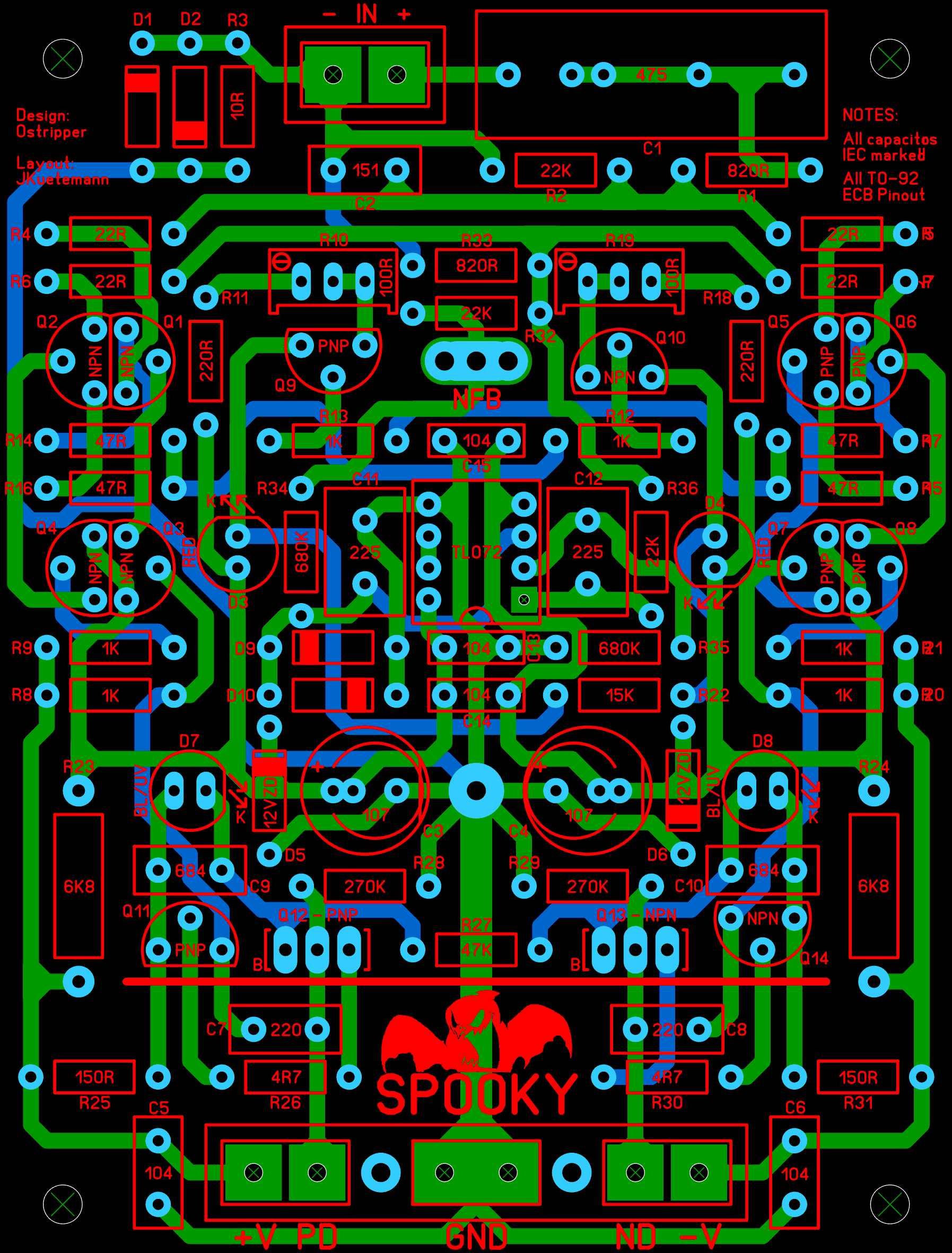

This is my layout for Spooky V2. I'm planning to built it.
You are using the super-pair mod.
You know , the spooky runs just the same on -
- the hawksford (original)
- the super pair
- or the "symetri" VAS.
Hey , look below ... this is my spooky and note how it is grounded.
OS
OS: How well matched are those super-pairs you're talking about using in your upgraded SPOOKY IPS and OPS? Ray
NICE LAYOUT!Are you using a ground plane foil side like Prof Leach? Some people say that those boards without the ground plane sound better. Ray

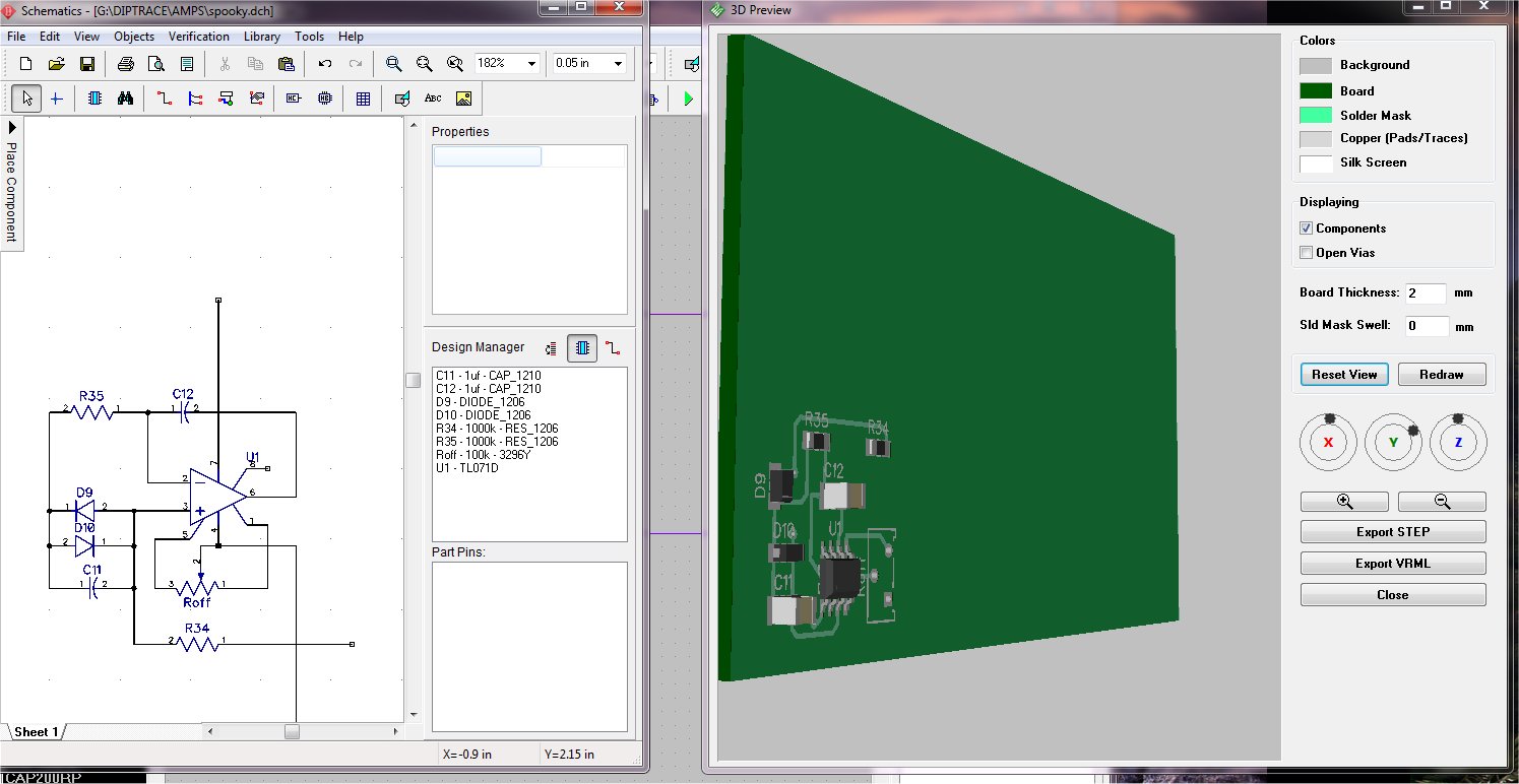

If you think the through-hole is good wait till I get this SMD-diptrace down.
(below 1).
I'm choosing packages that you will still be able to pick up with your fingers. 🙂
I've made my choices -
For SMD - 1210/1206/SOT-23-6/3 SOIC-8 for the servo.
-All semi's except for the TO-126 3503/1381 VAS pair and the 1W zeners.
-All resistors except the Zener shunts.
-All diodes and LED's.
Trimmers , 1W zener circuit , VAS and electrolytic's will still be through-hole.
The servo will be a TL071 with it's added offset trimmer. You will be able
to zero that last 1-2mv offset within the servo.
The PCB will accept either the 2 transistors for the Hawksford or the 4 for the
super-pair mod's.
Super pairs / cascodes / input pairs will be matched dual smd devices.
Matching is <5% in the dual packages.
These spooky's also run with less current ..... the single op-amp + lower CCS
current's.
In fact , the slew OPS will support 4ma VAS I - these will run "ICE cold"!
The Cascode = choice of either blue or red reference leds. 2 reds will just
add slightly more negative co-efficient to the VAS I. I've tried both and still
stay within +/- .1ma .

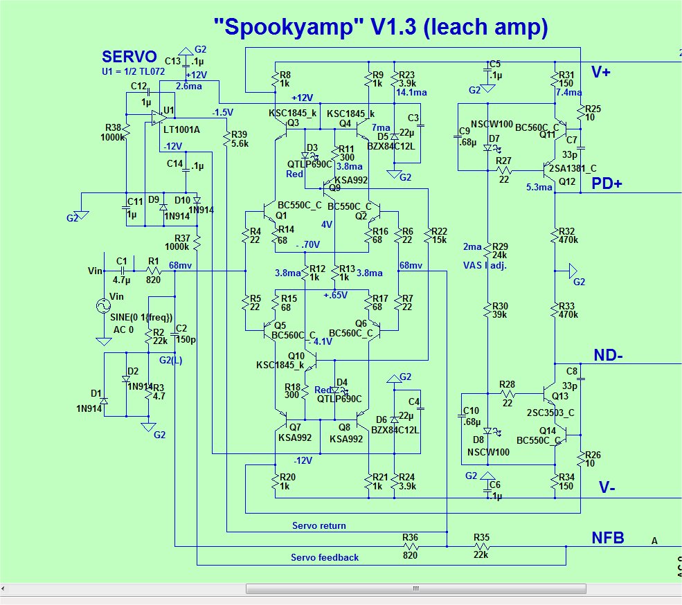

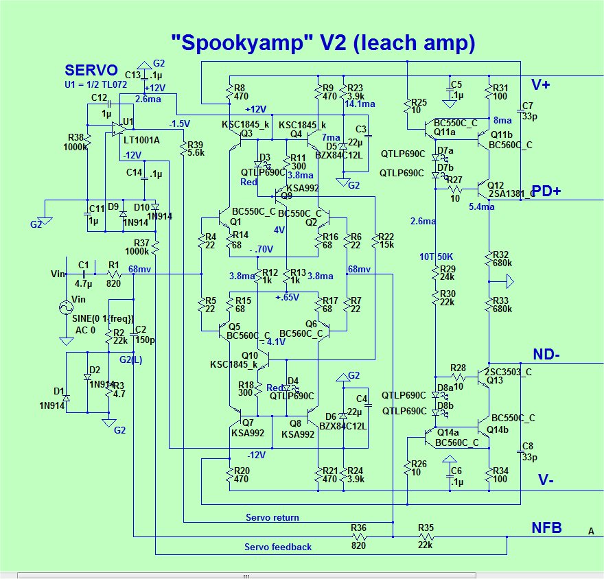

Below 2/3 are the 2 schema's I am integrating into Diptrace. I had to make
the component #'s the same for both mod's.

Diptrace did not have the 3296y trimmer 3D WRL. Where do you get
missing 3D images ?
I would also like any 3d+libraries for plug-in or standard euro connects.
I'm "launched now". These will be done.
OS
I haven't found a 3D model for the terminal blocks. It has a model for the standard Bourns 3299w trimmers. That will give you a rough idea for spacing. There are some more 3D models available if you search the Diptrace forums. I've never bothered to add any to mine.
Any of these modular IPS's that I do with Diptrace will be compact < 45 X 75mm.
With this "footprint" for the IPS , Diptrace seems to support the import of
a smaller layout to "drop" into a larger layout (OPS).
With a much smaller IPS , I might even have the option of keeping a modular
design. With a new OPS , I also might consider a smaller connector.
I have V2.402. I see the current 2.2Gb 3D models and comp/ pattern files
(at the diptrace site) , are way larger than what I currently have.
I may "luck out" here !

Why you bring ltp current from 2.8mA to 3.8mA on new SPOOKY IPS? I think it is little on high side?
LTP current is not "set in stone"
Read the Fairchild "BC560C" datasheet.
Fig 1 - "normalized DC current gain"
The BC reaches 90% at >1.5ma
And , Fig 5 - "base spreading resistance".
Near 2ma is where the noise is lowest ,slew and gain is highest.
You can run the spook LTP devices 1ma with a higher cascode resistance -
(1.2 -1.5K). Cooler amp .... but lower slew , higher noise , and less resistance
to ambient thermal changes.
Or , more current if you adjust the LTP cascode collector R (680-820R)
The average 1.7ma (small) semi operating currents in all my IPS's seem
to be the best compromise. Some devices might benefit from 2ma+ ?
1.5-2ma is the "sweet spot". I've also observed this with a thousand Japanese
designs (2SA/2SC - toshiba/NEC) .
OS

How did you find that(in bold letters), The noise is lower at lower current, the gain of this bjt is highest at about 10 mA and slew rate depends of other things not only current. By the way Fairchild is inferior to ONSEMI, lower ft, higher noise and Cob.
2 things, Dadod .
We not only have noise , but the other 3 factors to consider.
I only made my statement after correlating all 4 factors and observing my
many simulations of classic amplifiers.
Google "noise in semiconductors" ... 7 different noises.
1/f noise is governed by Ib ,,, which is governed by semi gain.Google "noise in semiconductors" ... 7 different noises.
Shot noise by Ic.
So , in a given circuit ... even different grades of a given device would
have different noise characteristics.
Then , Different Ic/Ib/Hfe combo's will affect "flicker noise corner frequency".
Yes , I is not the only slew factor (collector Z ) .... but we have to compromise
ALL these conditions.
I highly doubt that all those Japanese designers were wrong.
