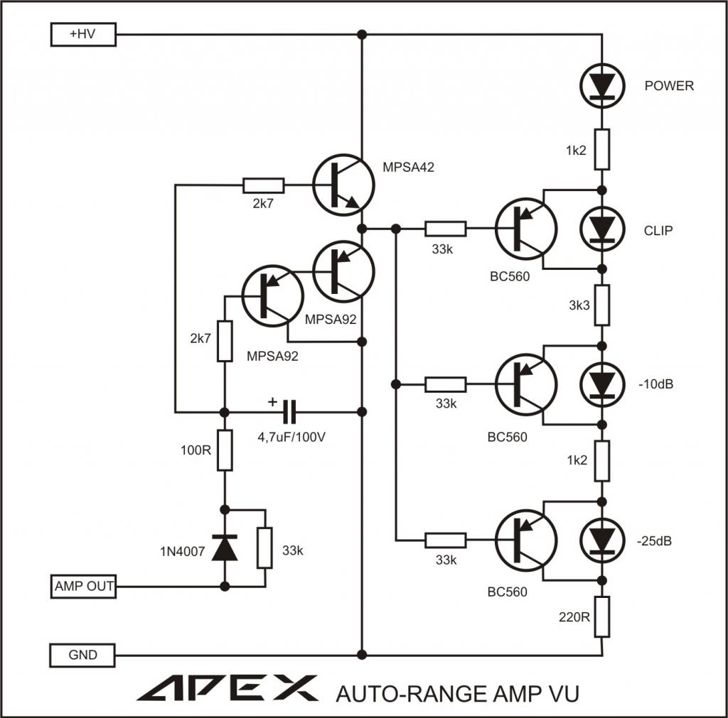

(below) T13 or 14 saturate , forward bias T25 .... causing T26 to conduct turning
the LED on.
Short of clipping , the reverse leakage of t25 might affect the LTP.
I've noticed on lower Z circuits like this or the Kypton V .... no issue.
On a higher Z current mirrored input section , reverse leakage is a
bigger issue (like a "blameless").
Here is better one - Clip Indicator (LED) for any power amp
Runs right off the output (real low Z).
Another - Project 146
Clipping Indicator For Audio Amplifiers Circuit Diagram
These all assume you KNOW at what point your amp clips and references
the actual output waveform to a rail. At least this does not require input
stage "meddling". 😀
OS

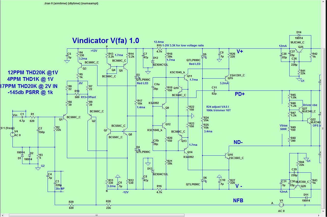

Is the value of CXa/CXb on the Vindicator V(fa) critical? I'm not able to source film caps of 39pF. Only 33pF/47pF available. 39pF is however available on ceramic/ceramic MLCC types.
Hari
Actually, try the Groner TIS without them initially.
It was mentioned that this TIS has peaking >7mhz. I did not see this
in any simulation including using a tian to probe the TIS independently.
I decided to at least include Cxa/Cxb as an option because this "peaking"
was mentioned by both Groner and Kleinschmidt.
The main 68-82pf local compensation (C11) might be enough (according to
both the bode of the TIS and global simulations).
This is a new design - bear with me ... 😀
OS
