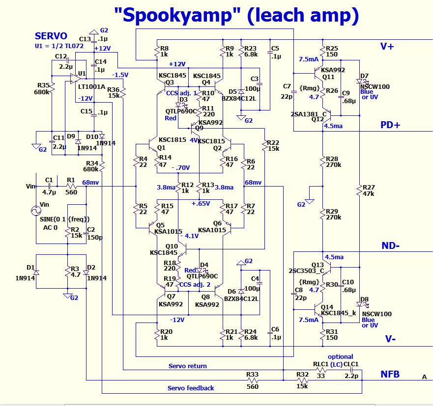

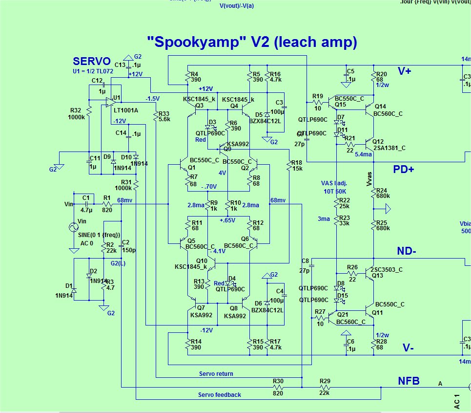

Is this Spooky V2 the latest schematic? I thinking about build it.
I also think the VAS current and led is not valid. It will be 5.4ma for VAS and 2.1->2.5 for led. Is it correct?
I also seen a version of Spooky that have the dc servo opamp ground (2x914 + 1u + 1000k) go to G2(l) instead of G2 like this schematic. Which one is correct?
Why R20 + R20 must be 1/2W ?
I would actually prefer the output version but I have a doubt that when you have used the parallel diodes across the collectors of LTP would that tamper the low level signals also before clipping?I will , but not any worse than what anti-parallel diodes would do across the
LTP collectors.
(below) T13 or 14 saturate , forward bias T25 .... causing T26 to conduct turning
the LED on.
Short of clipping , the reverse leakage of t25 might affect the LTP.
I've noticed on lower Z circuits like this or the Kypton V .... no issue.
On a higher Z current mirrored input section , reverse leakage is a
bigger issue (like a "blameless").

obscurus,
This is the schematic I followed.
How do you think about your spooky?
Collector Z vs. the reverse leakage of the diodes , that's all. Simulator shows
not a single ppm with or without the diodes.
The reverse clamp diode on either the Badger or wolverine will shave 3-5ppm
at clipping. Much higher Z here.

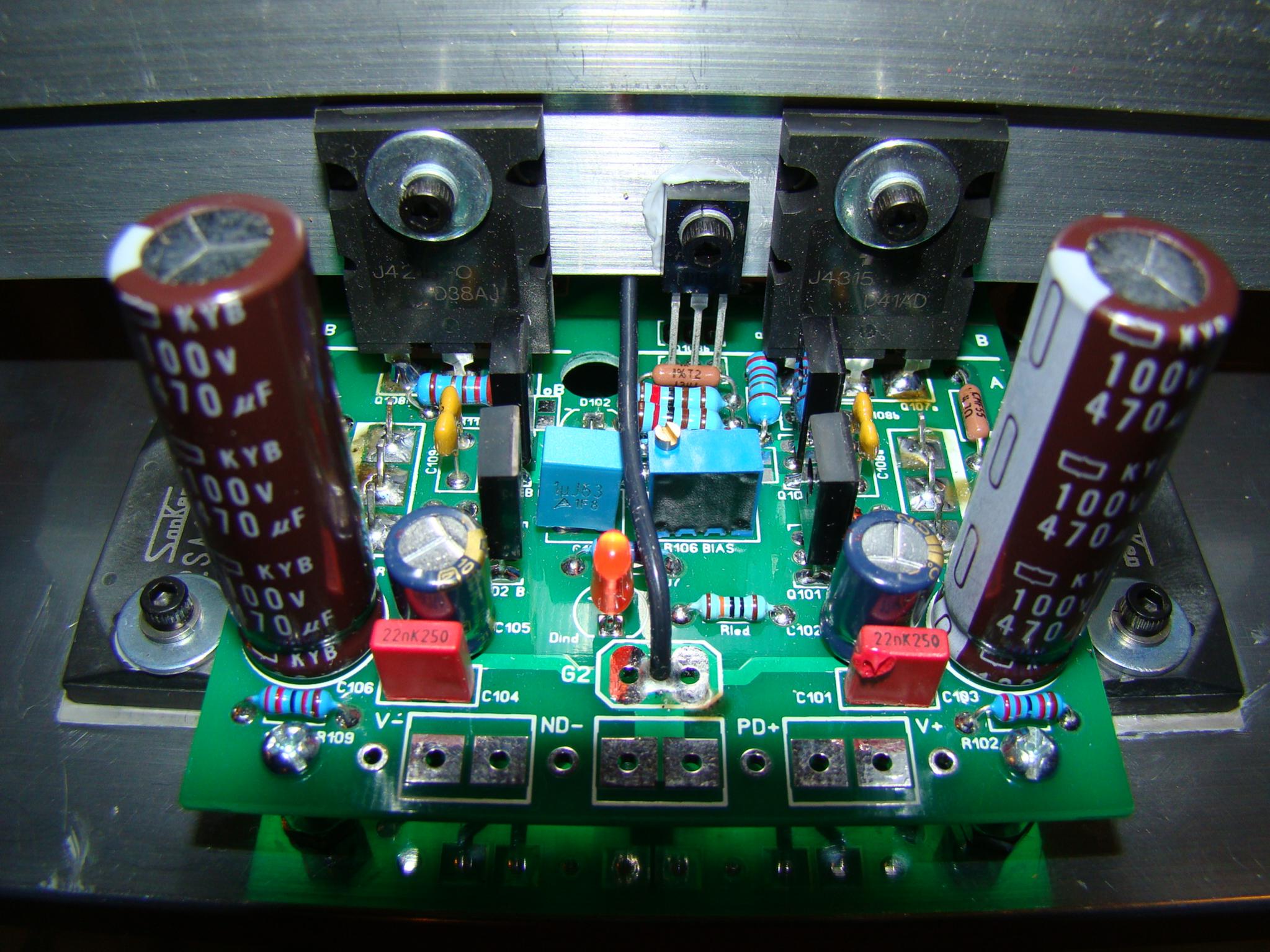

kapton insulators suck.
Had my right spooky channel go up in smoke.
One red LED for the 12V on the Spooky IPS was out.
1-10A fuse was blown. Replaced the fuse , magic smoke from one of the
NJW3281's.
Pulled the OPS , a 2mm round hole through one of the Kapton insulators.
The pulled 3281 tested good. So , it was just the insulator.
The extrusion underneath also had a hole from the vaporized Kapton .... 😡
NO burrs or micro dust from metal - just material failure.
Oh well , 15 months+ .... ordered some real mineral mica insulators to go
all around. My Kapton days are through - 5% better thermals are not worth
shortening my 20 years MTBF !!!

At least the mica. NEVER saw a mineral (or a insulator) be the actual cause
of the failure.
Cool that the rest of the amp (and the protection) works perfectly now.
