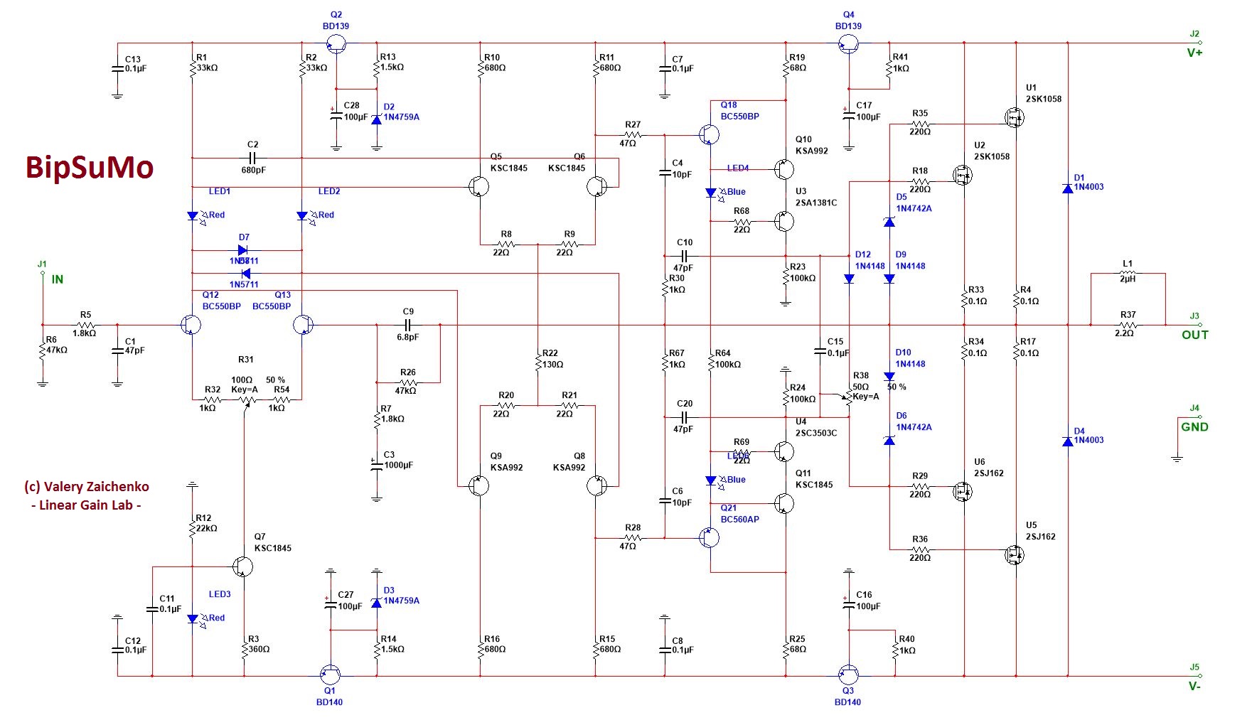

Ostripper i have a doubt regarding the Kypton V2 that I want to run it at lower voltage for ips and ops so I see the sound quality variation when I increase the voltage to 50 which is better than at 15V so what are the resistor values to be changed to get as good quality as at 50V
If you see the Bipsumo circuit then its observed that R8 R9 R10 R11 are different than what you are using.
So changing these values will give enough sound quality improvement?
The one you're showing here is an early prototype 😉
Now I'm using R8, R9, R20, R21 = 100R.
More degeneration - more stability.

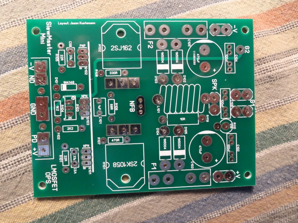

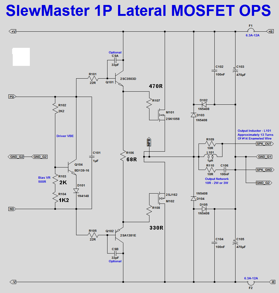

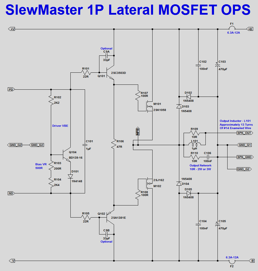

I work for MINI OPS LATERAL MOSFET.Q104/BD139/ to be mounted on a heatsink with 2SK and 2SJ??
No,driver transistors will be mounted on his separate heatsinkHello guys.
Hello guys.
As Thimios said, and also you grabbed an older schematic. The values on the board are correct - follow those - especially for the gate stoppers.
To match each other.As Thimios said, and also you grabbed an older schematic. The values on the board are correct - follow those - especially for the gate stoppers.
yes gate stopper resistors play a big role even in stabilization these laterals oscillate faster than you think.To match each other.
