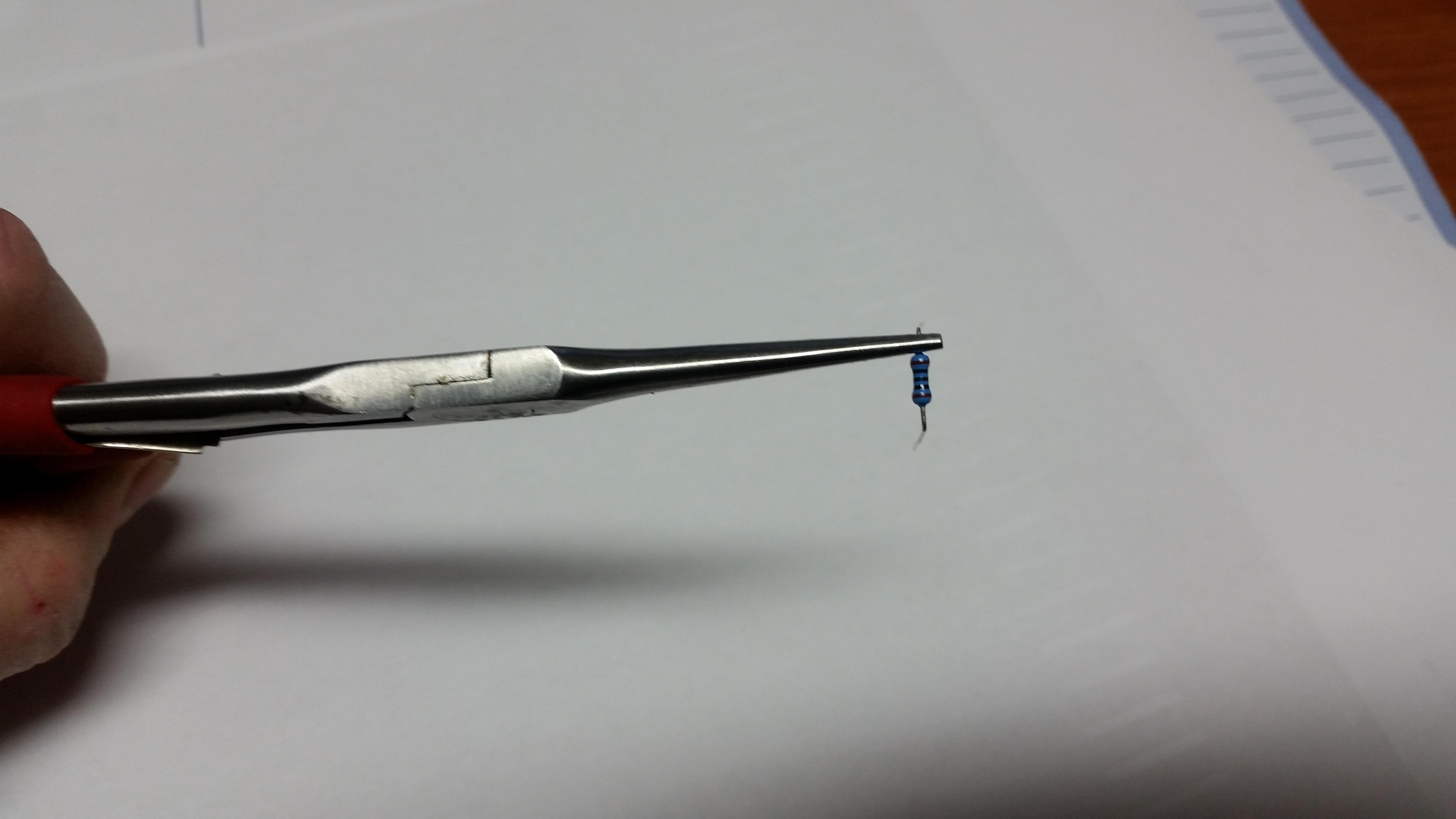

You need a good pair of needle nose pliers. They're the best lead bending jig you'll ever find if you figure out how to use them. I'll post a picture of what I mean tomorrow when I'm back at the office. 1/8W is easy.

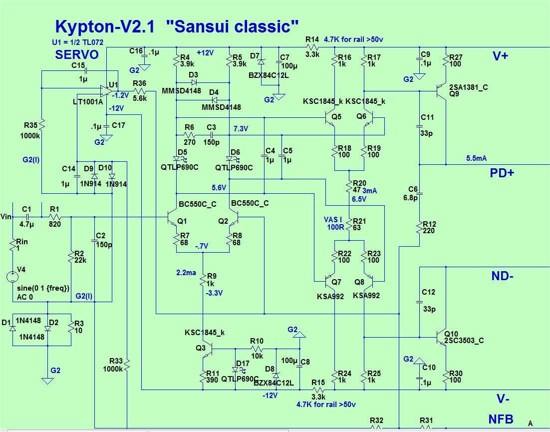

Is beta matching required for the transistors Q5, Q6, Q7, Q8 in kypton v2?
If not required then I want to go with smd version of 1845/992.
There is one more problem im observing with the kypton V2. That is when building a multi channel amplifier i found that the resistor R30 value 100ohm is burning. The voltage across is increasing quite high even after increasing the R21 to 820ohms. In other channels even with R21 being 100 to 150 ohms its working fine.
why that specific resistor is burning and giving fumes.
Think about it , all the other channels work. Either Q8/10 or the OPS is
suspect.
Swap a working IPS to that channels OPS , see if it's r30 burns ??
OS
suspect.
OS
Q10? i couldnt see Q10 in above circuit.
I tried swapping the OPS its the same problem.
Q12 in that one. I dropped the superpair in V2.
(Q10 below) is "V2".
This is the one thimios tested.
OS

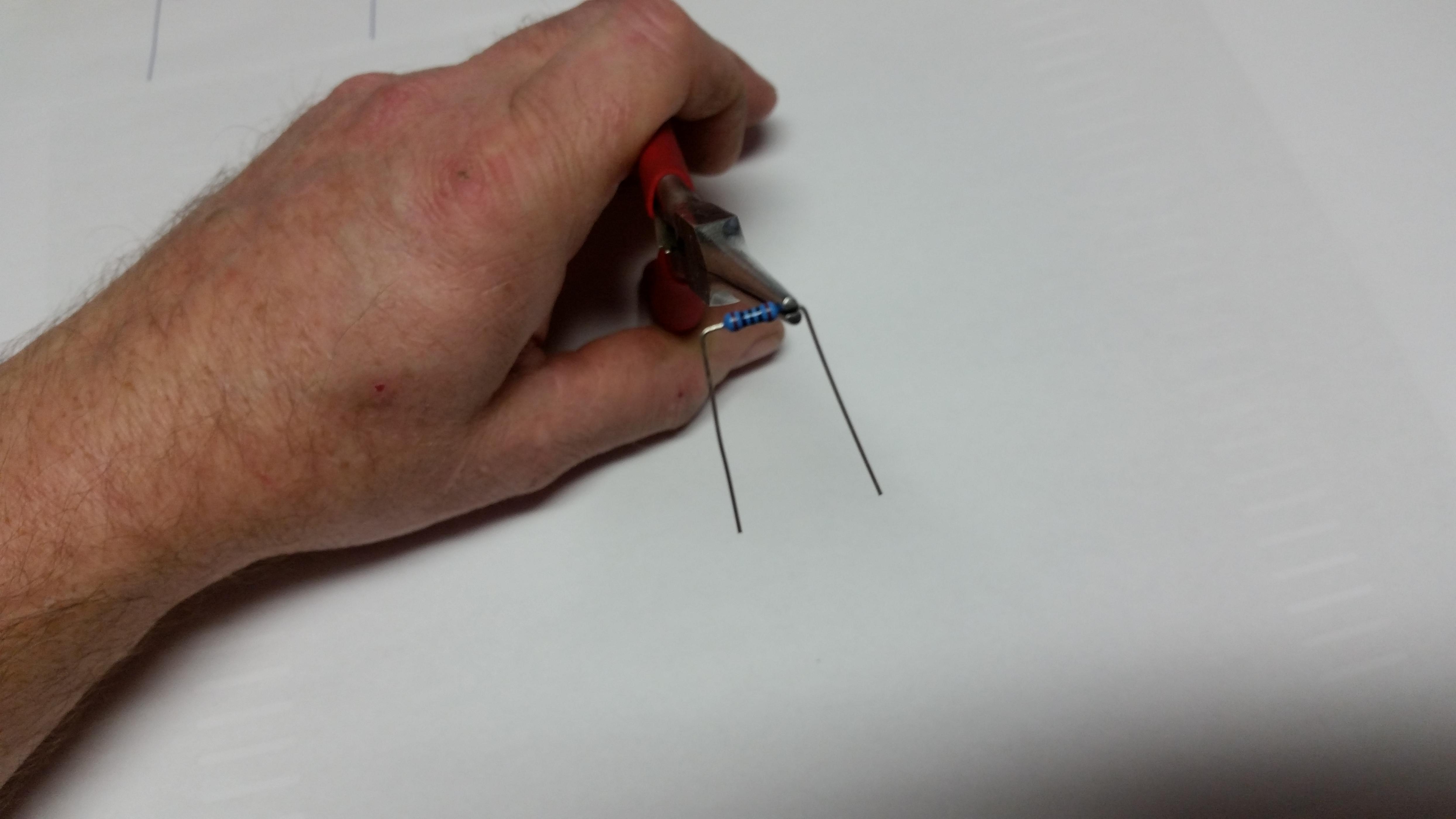

Here's the easy way to bend resistor leads neatly. If you need wider leed spacing, just move into the plier jaws farther. Once you figure out the magic spot on the needle nose pliers, the leads will fit perfect every time.
That's what I always do, but using tweezers 🙂

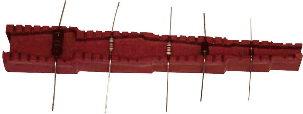

I actually have a wood block the proper width for 1/4w.
