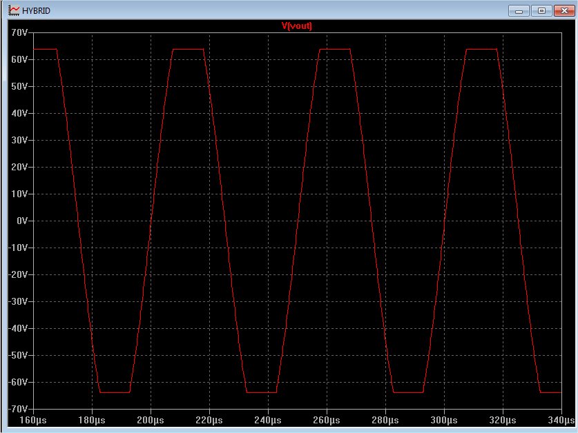

slew. Geeeezzz . (below 1)
But I did get >125V/us out of this one. Everything is a compromise.

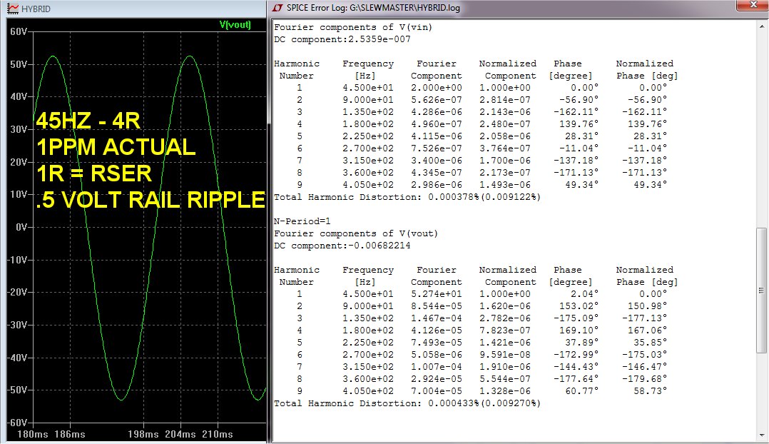

Add (simulated) serial resistance to a typical CFA at 45hz and then this one -
you will see. (below 2).

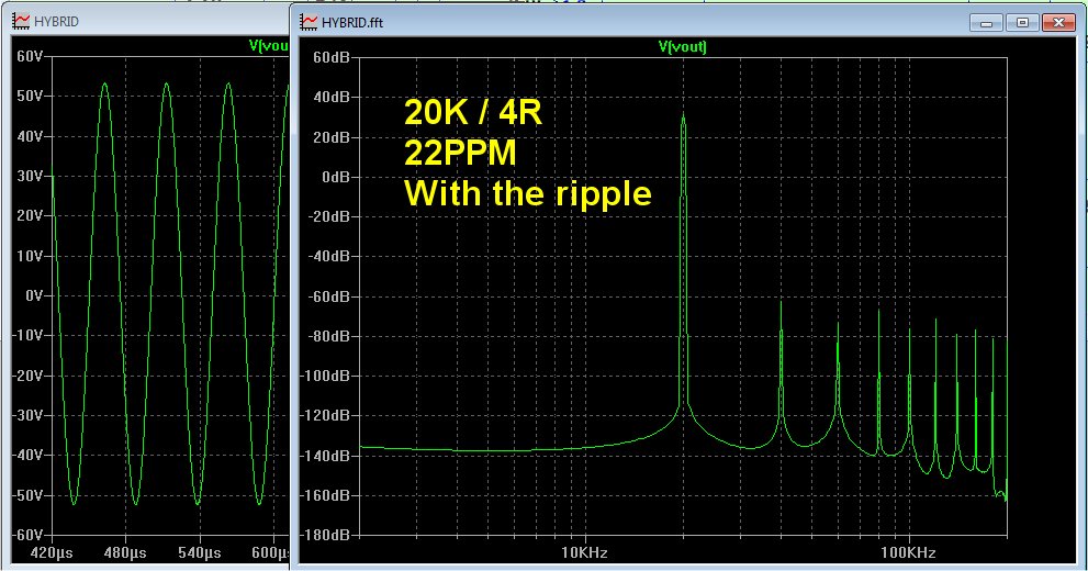

PS - this amp is .5 ppm to 5 ppm - from 500hz - 10Khz (with the ripple).

(below 3 and 4 ) worst case high output and overload.

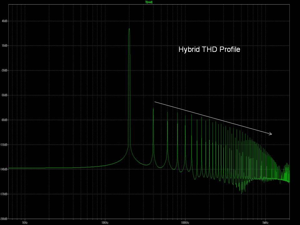

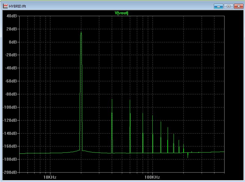

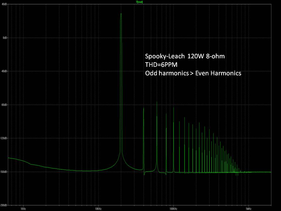

__Evens__vs__Odds__ Is there "ONE BEST" harmonic distortion profile?
=====Spooky Harmonics====
The Spooky-Leach topology generates higher odd harmonic distortion levels than the preceeding even harmonic level.
3rd > 2nd
5th > 4th
7th > 6th
The complementary circuits in the input+VAS+output cancel a portion of the even harmonics, so the odd harmonics dominate.
IS EVERYBODY HAPPY? or will Golden Ear musicians run away like from finger nails on a chalkboard?
=====Hybrid Harmonics====
Monotonically decrease 2nd>3rd>4th>5th>6th>.... with no missing harmonic.
Golden Ears swear that there is a correspondence between a gradual decrease of higher harmonic components and the subjective quality of an amplifier. In particular, amplifiers where the harmonic distortion spectrum does not monotonically decrease, or where specific harmonics are absent, may sound less agreeable even if the absolute distortion levels are very low. They argue that higher distortion levels are not in themselves objectionable if the harmonic components show an orderly, monotonous decrease.
===Spooky vs. Hybrid comparisons could help settle this debate===
Both Spooky and Hybrid have low THD, but from different ratios of harmonics.

Simulated harmonic results won't "hold" ....
Especially on a CFA.

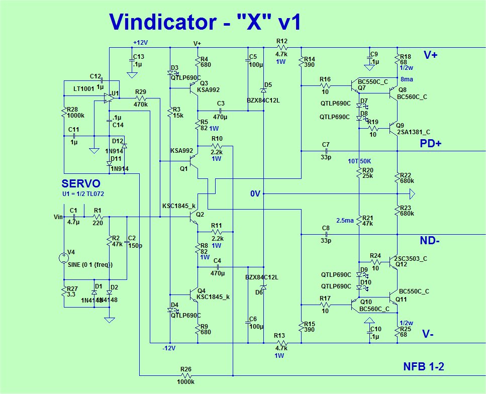

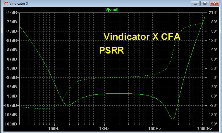

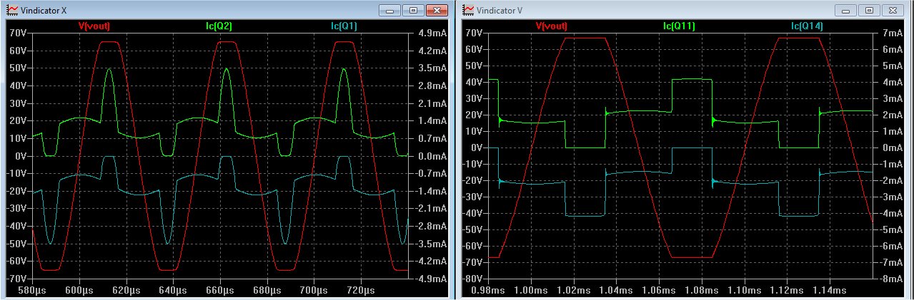

I just redid the "Vindicator X" ..... last of the new Vindicator series.
I have -100db over most of the audio spectrum.
PSRR is better than the VSSA/CFA-X.
- no over load of Q1/2 , no offset with the servo , Q1/2 thermals won't affect
the super pairs and no bad clip , either.
- "Gnome servo" + KyptonND VAS + CFA-X = a better CFA.
(Vindicator-X schema/psrr below 1-2)

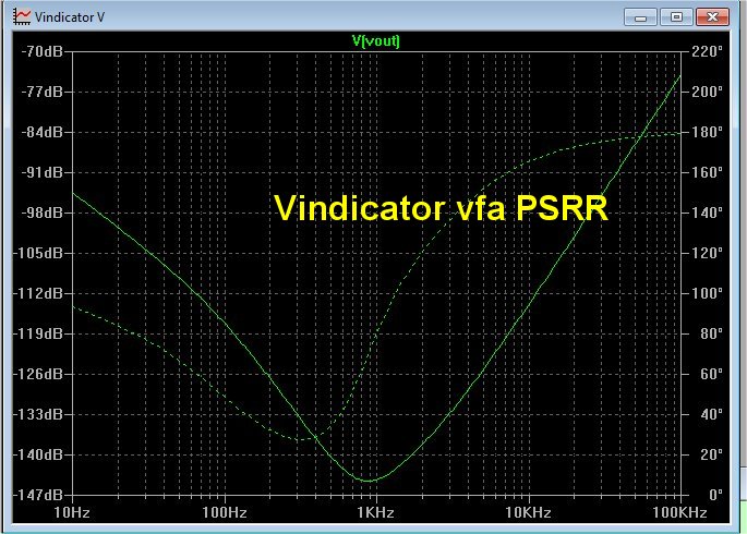

By comparison , "Vindicator V" (vfa) is improved (below 3/4) ,
best PSRR of any design. All input stages are now 12V regulated , low current
BCxxx - all ready for SMD. 🙂
Think of bad PSRR as another feedback path that degrades performance
with output and frequency. This is why spooky and Kypton V2 are stellar
performers.
I attached "Vindicator X" (plus C/X) -.ASC's are below.
OS

I want you all to build , and then try to kill these (below).
I want these to be indestructible. Super-pair VAS has the soft clip
here , too. 🙂 TO-92's only see short bursts of 4ma , also cool !

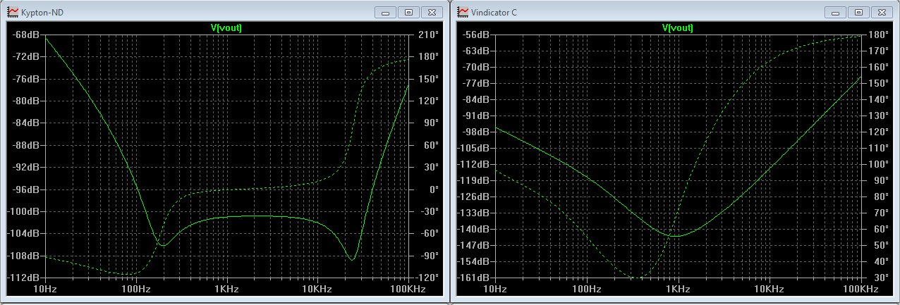

Can you also show a PSSR graff from the kypton C ips to compare with the vindicator C?
ThxFor psrr , there is a big difference ....
(had to use the ND - same as C)
OS

BTW , it also looks as through all the SOT-363 dual's have the same pinout.
The ON's will sub for the Toshiba's. 😎
The same gender duals with connected bases have a different pinout - I
might not use those ( not universal enough).
The complimentary's would be an actual massive improvement for any
of the CFA stages , as the Toshiba HN1B04fu is gain matched for P/N.
All these pairs (diamonds , LTP pairs , cascodes , and mirrors) will also be
thermally coupled. VERY ideal for these designs.
OS
What about BCP56 replacement for 3503/1381 as it has a higher Ptot?While the designs are gravitating toward something fully SMD , searches
for high voltage .5A low Cob SOT-23's are harder (than to-126).
Fmmt497/597 looks like the perfect 3503/1381 VAS semi replacement.
All the other to-92's (BCxxx and 992/1845) have SOT equivalents.
It should be cool , resistors on the bottom ..... semi's on top. IPS's
would be 75 X 50mm - 1/2 size.
The FMMT's would need a few square CM of copper - that's it !
Most slew IPS's run ice cold with no high currents. NO issues.
OS
It is only a 80v device though. ..
