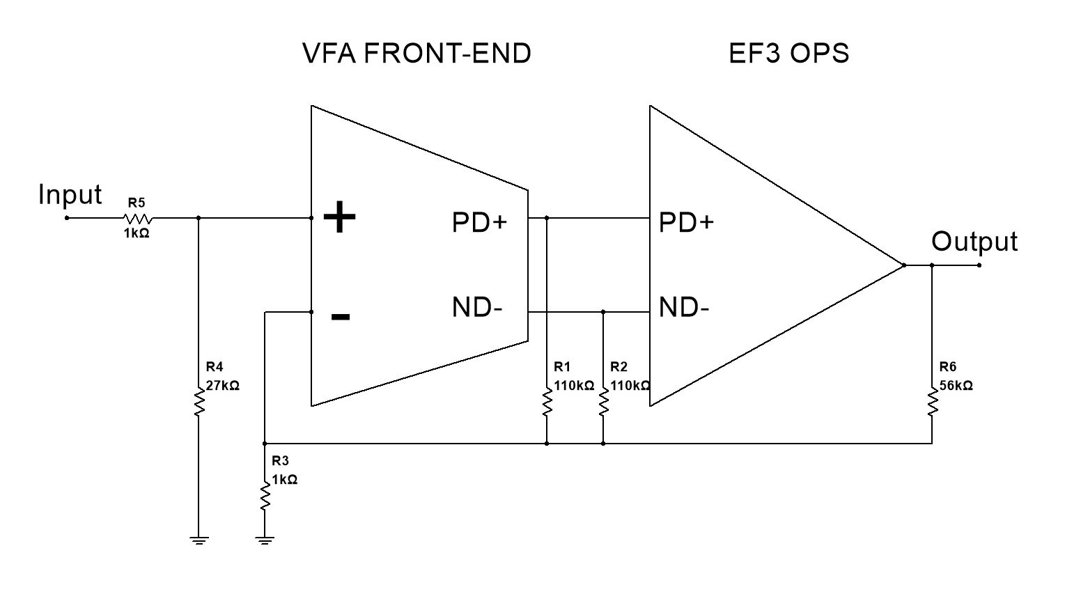

I have actually come to an interesting observation, experimenting with the nested feedback (works well, as soon as OPS is low-distortion enough). IPS is a fast VFA.
Leaving only about 6db for the global loop, I have the output impedance increased (comparing to the normal setup, where most of the NFB is provided by the global loop).

Pete, that's right, but TMC is (deliberately) frequency-dependent.
Yes, there are lots of local loops within any design.
What I mean is dividing the overall loop gain between the global loop and the one, covering IPS+VAS only - see the picture.

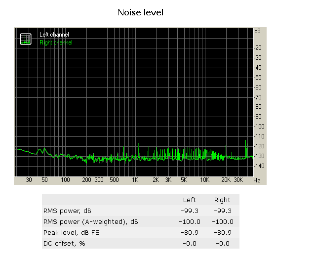

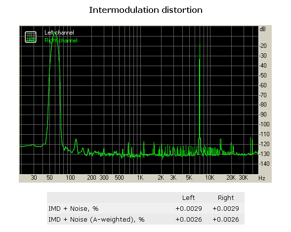

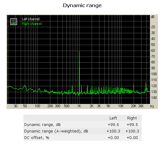

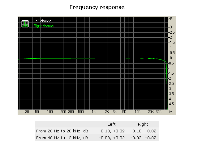

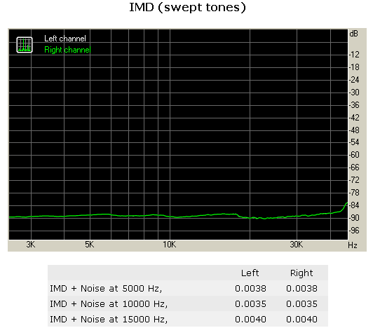

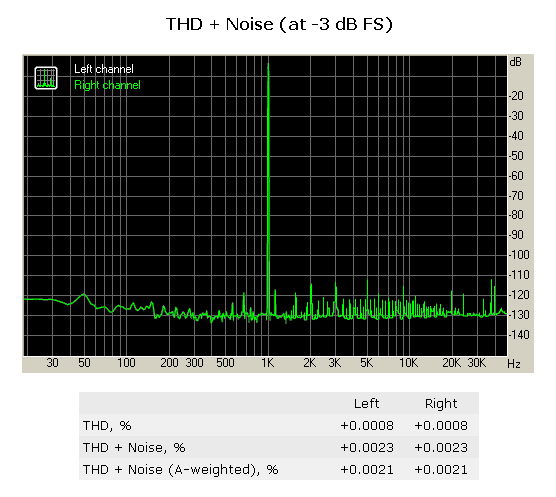

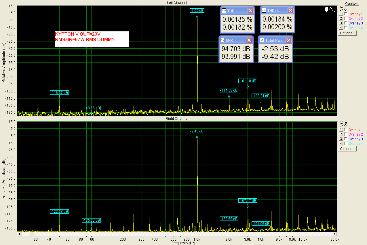

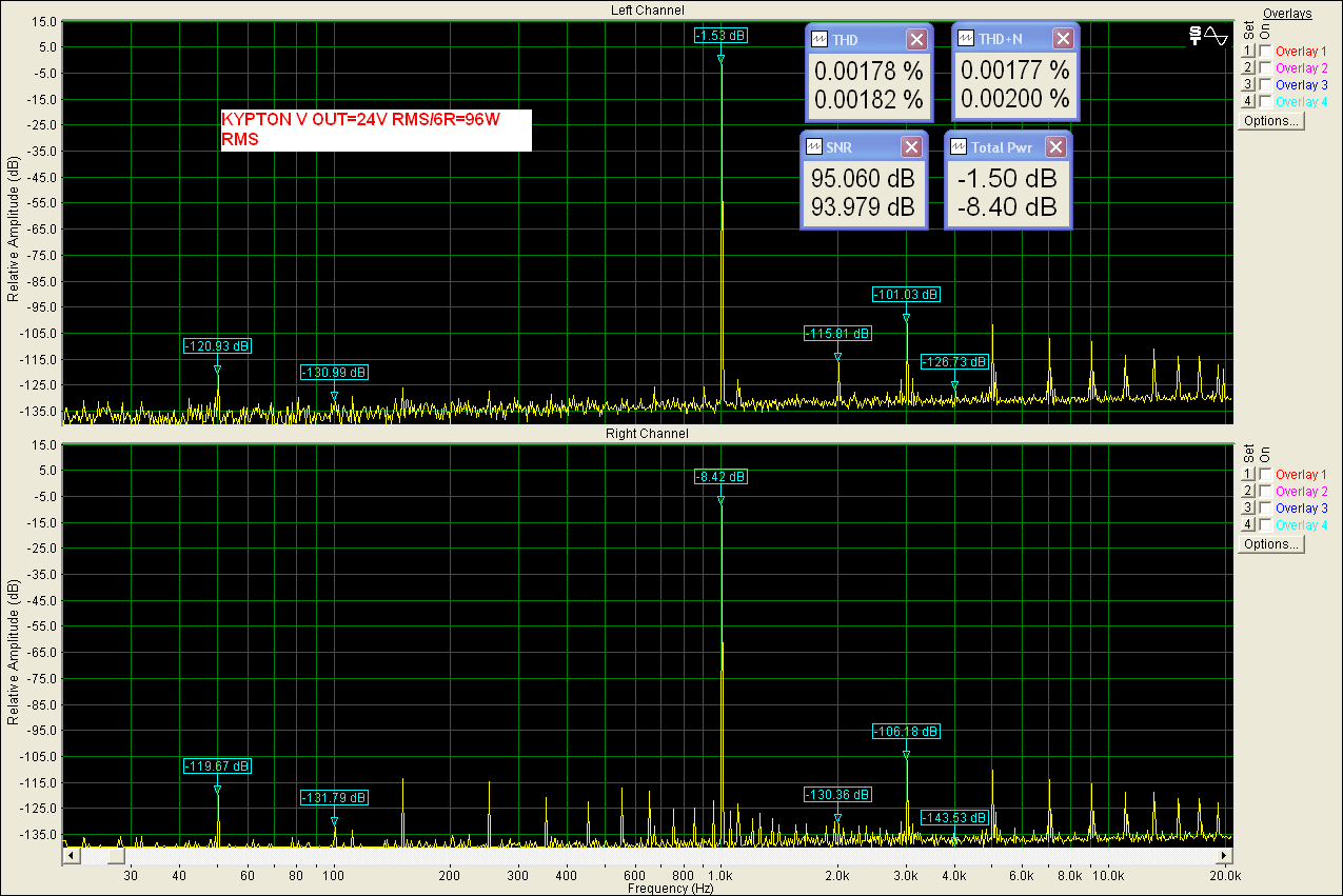

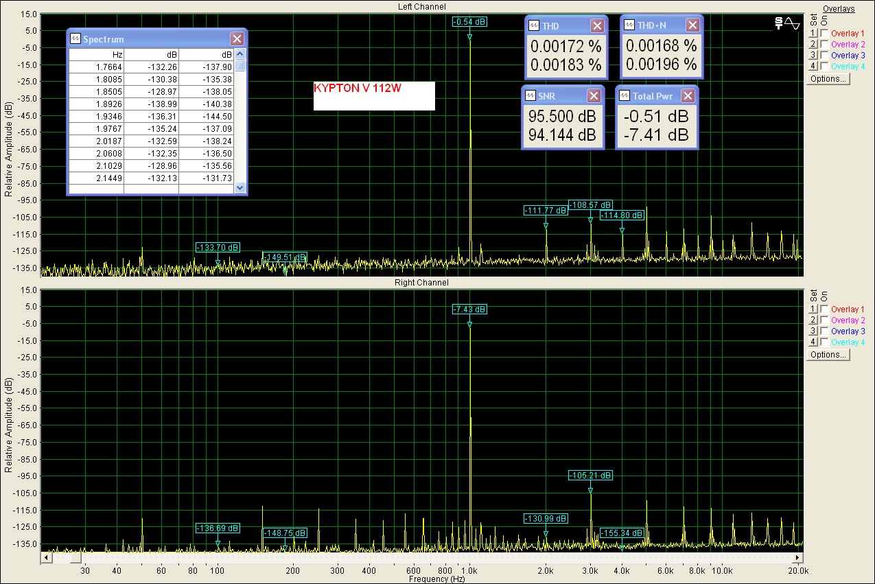

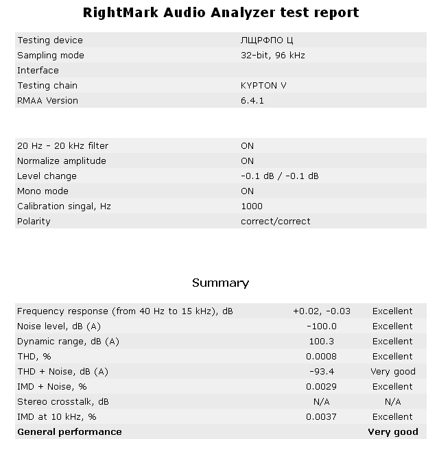

kypton v new test on dummy load
My test setup changed again(now an 6 ohm dummy load is used).I must run all these from the start.
Let's start testing Kypton v
Keep in mind,amplifier under test is connected(mono) in the LEFT channel
My test setup changed again(now a dummy load is used).I must run all these from the start.
Looks excellent, but what is the output power?
Thimios, can you please run it at 50W (20V RMS @ 8 ohm)?
Pictures 1,2,3 ,look the red words.Looks excellent, but what is the output power?
1)67W/6 ohm
2)96W/6 ohm
3)112W/6 ohm
Sorry i haven't any 8 ohm dummy load.🙁
1)67W/6 ohm
2)96W/6 ohm
3)112W/6 ohm
Ah ok - I did not look carefully 🙂 That's good

Thimios what is the problem with the Noise why is noise so dominant? Is there a capacitance multiplier for the ip and vas stage?My test setup changed again(now an 6 ohm dummy load is used).I must run all these from the start.
